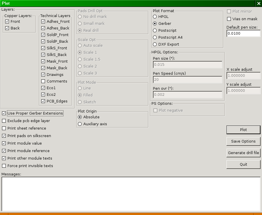

24 Nov 2012, 20:01
Next question:
How to export the PCB design into something like this:
I only get a very un-smooth postscript file (via print to file).
bpiphany
25 Nov 2012, 03:22
That one is generated from gerbv, KiCAD is really poor on exporting image files...
25 Nov 2012, 09:42
bpiphany wrote:That one is generated from gerbv, KiCAD is really poor on exporting image files...
Thanks!
Now, how do I export the file to read with gerbv?
:roll:
bpiphany
25 Nov 2012, 17:15
That is something absolutely central, this you've got to learn. The gerber files is what this is all about. File->Plot, and from there you should be able to figure things out =)
25 Nov 2012, 17:25
bpiphany wrote:That is something absolutely central, this you've got to learn. The gerber files is what this is all about. File->Plot, and from there you should be able to figure things out =)
Exactly at this point nothing works anymore. Pcbnew spits out a lot of files and when I run gerberv on them nothing happens...
bpiphany
25 Nov 2012, 18:55
"Open with" doesn't work with gerbv, the program only starts without loading the file. It usually sets the folder to the correct one when you want to open the file from within the program again... And to add the gerber files to the current project, you need to use the plus button at the bottom of the left hand panel.

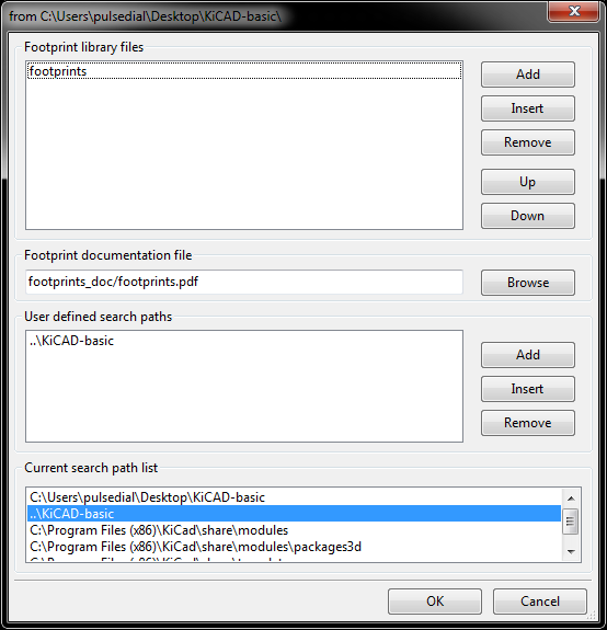

When I do this with the wiki tutorial I get
 Component [SW3:13]: footprint <CHERRY_PCB_100H> not found
Ibelieve i have the KiCAD-Keyboard-Tutorial-master's footprints.mod and components.lib setup correctly:
Yes I am currently in Windows :oops:
Any ideas?

Most problems are solved, now just one more thing:
What do I have to send to the PCB-manufacturer?
I know that there are some gerber-files to be generated (File->Plot in pcbnew),
but what exactly do I have to send to the manufacturer and what are the settings I need?
