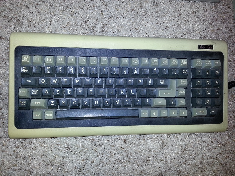

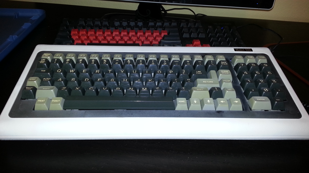

Keycat cleaned and before and after Model 925 whitened. Keys still not there but it was a first and I'm not sure how that works with non-white. At any rate, I was just putting the case in a bath.
Keycat works all around. Couldn't really get the spacebar on the 925 right although it's not useable to me anyway. Still, I'd like to get it right if anyone has any pointers. It's got long hooked white plastic stabilizers on each end in addition to the center white switch. They go down and back toward the user if I'm not mistaken. It took me so long to get it whitened my memory of taking it out is fuzzy.
