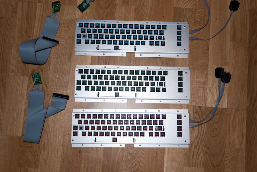

Update: now I have all the parts and have started to assemble the boards.
tlt
04 Mar 2013, 22:18
I have assembles the boards now and started to pack them. One of the controller was acting a little weird so I had to RMA it.

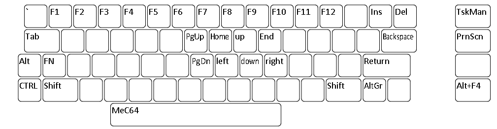

The keys on the C64 look something like this
The keys is mapped in to the standard scan codes in that position with this exceptions
If you hold down Fn (right/left arrows) you get this layer:
tlt l2.png (15.17 KiB) Viewed 9833 times
And if you press left shift and F7 you toggle into VICE mode (the layout is mapped so that it fits the VICE emulator)
What do you think about this? Any special requests? I'll give you the source code later, need to at least clean it a little :-)

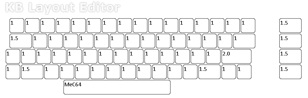

Here are the link to online keyboard edt.:
http://ne0.cc/laygen/#__%3A%3A0.25%20%2 ... C64%3A%3A7
tlt - could you please check out the correct sizes? thank you

CeeSA wrote:could you please check out the correct sizes? thank you
Looks right except for the space bar, should be looooong 9U ;-)

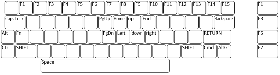

So you want the the same first layer but with the Fn on shift lock and that fn layer?
tlt
05 Mar 2013, 17:42
Moijk - VICE mode is mapped to work in windows but it might work fine in Linux to, have not tried that. It's not the default mapping on Mac so you have to reconfigure the emulator there.
The placement of the Fn key is just a matter of taste, I tried to imitate the Happy Hacking kbd Pro 2. With CeeSAs layout (fn on shift lock) you can put something else on the left/right key like GUI which is very useful on Mac or a control.

tlt wrote: So you want the the same first layer but with the Fn on shift lock and that fn layer?
yes please.
tlt
05 Mar 2013, 20:54
Shouldn't there be a Win key or a right control key in the lower right corner?
CeeSA
05 Mar 2013, 21:42
yes, I forget it - because I never use right control :)

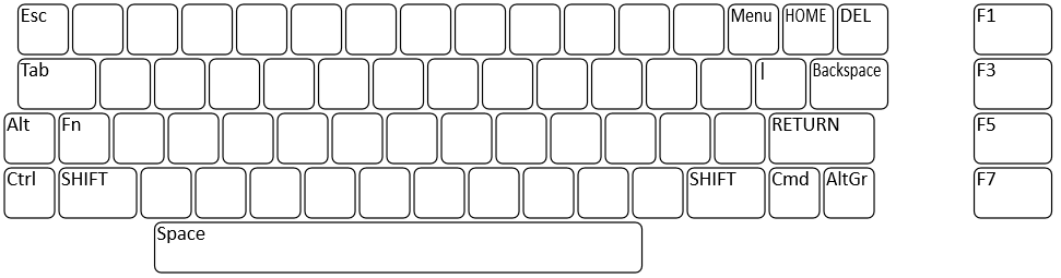

How about this layout for Mac?
Layer 2
Mac L2.png (14.27 KiB) Viewed 9815 times

remember that on a mac, CMD is what CTRL is to the windows people. So to find something on a page i do a CMD + F. Option (or alt) is like Alt GR on a pc.
http://img.gfx.no/958/958819/MacBook_Air_tastatur.jpg
(fn is only on laptop keyboards)
run stop = alt
c= = cmd
shift = shift
and
crsr up/dn could be ctrl
crsr r/l could be anything. I use the left anyway.
i guess the other keys will be mapped to the c64 version. which means i still got keys like <, >, ' @ * etc which is great for programming. and i see you changed the arrow up to | which is great.
On my apple extended 2 keyboard i lost the ' key, which made it pretty unusuable for programming. not sure if that was the adater or the built in keymap. And I recall my brother buying a expensive ergo keyboard back in the day (microsoft) which didn't have a <> char. which ment he had to bin the whole keyboard since it was unsuted for programming (and that was before internet, so i doubt he knew how to alter the keymap). So having the necessary keys is pretty important.
what the menu key does i have no idea.
