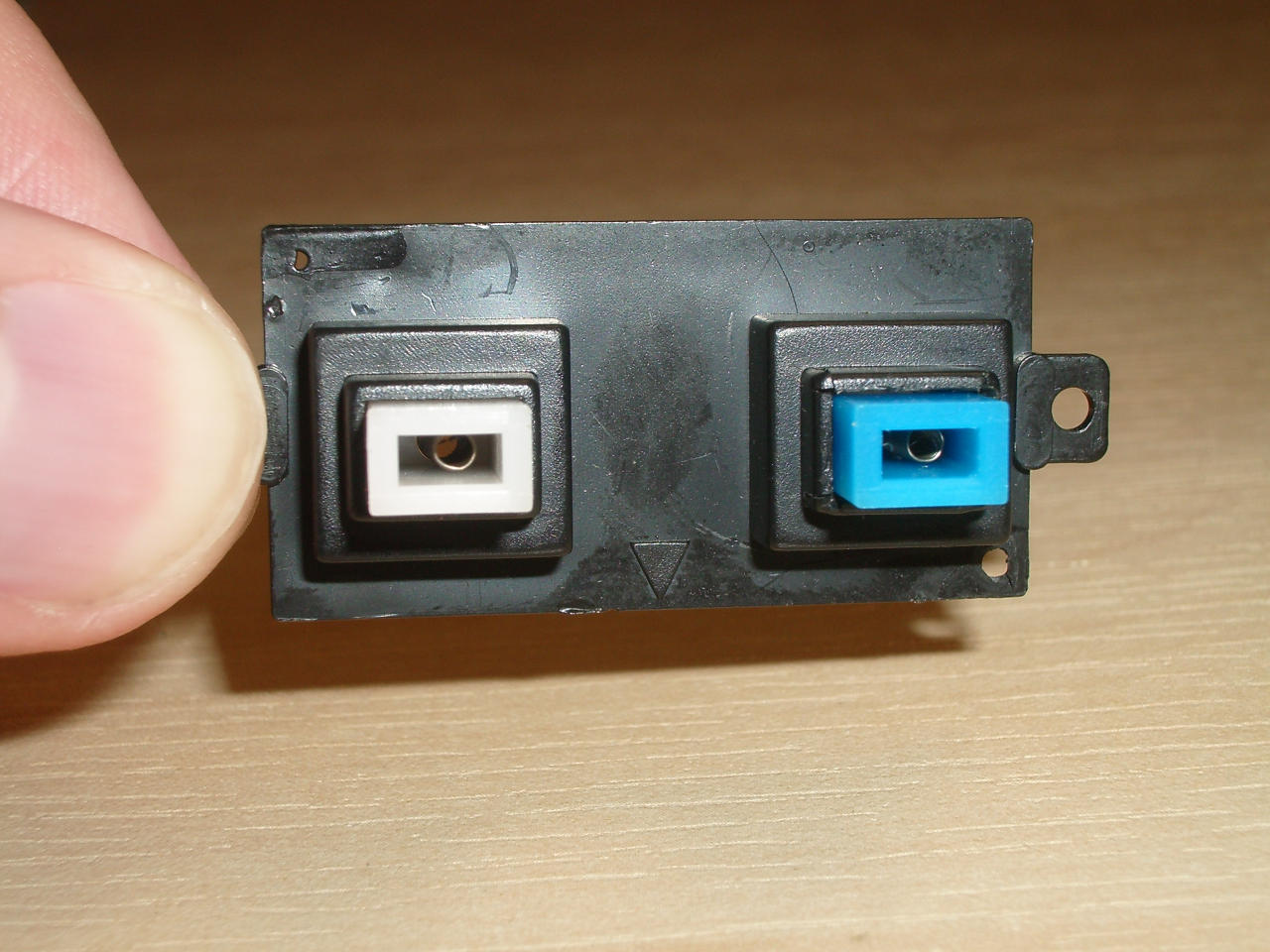

Anyway, it's a lot more interesting than it appears. There are two types of membrane (sub-slider) spring, for no reason — most are flared, but some are cylindrical. There are also two slider colours in the one from Ascaii, which roughly correspond with a bizarre variable weighting scheme where space, return, tab, left/right/down (but NOT up) arrow, numpad 0/./+/enter, and the modifier keys, are all significantly higher force (taller under-keycap springs).
Also, left shift and \ are in an ISO module: a snap-in panel that can be replaced with one with only the one slider shaft for JIS and ANSI:
OK-100M ISO module.jpg (170.9 KiB) Viewed 4556 times
Not much in the way of photos as my camera battery died within minutes; I forgot to charge it :(
More photos when I'm back in the office next week. Since mine is virtually NIB (it may have already been disassembled, as some internal screws are missing, and the rest are loose) I'll see if I can take a whole set of photos, but they won't be all that great.
