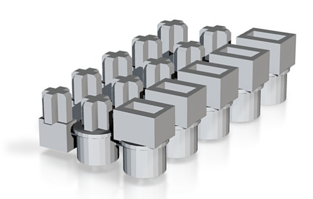

Kudos for the person who guesses the reason for the cherry to cherry mount....
22 Aug 2014, 01:15
For 7bit's all important Hyper7's top rows?
Or maybe you don't mean MX to MX, but one of Cherry's other mounts.
Am I right in guessing the other two are: Topre to MX caps, and Topre to Alps caps adapters?

Are the Cherry to Cherry adapters for keyboards with both kinds of switches, to make them all the same profile?

Cherry-to-Cherry: off-center caps lock?

Or a spin on that idea: off centre for G81 mods to fit on MX keyboards? That's be pretty handy. Although I wonder how stable it feels.

Maybe the Cherry to Cherry mount is for keyboards with mixed switches (Alps and Cherry MX) to keep them all on the same height when using a Cherry MX Keyset?
22 Aug 2014, 15:34
These are for Cherry stabilisers to be used with Cherry keys when using the extenders for the Alps switches.

The MX to MX-alike adapters are for my vintage home-made Memotech MTX Keyboard replacement... :-)
Also -> if I'm not mistaken, BBC Micro keyboard keycaps can then also be fitted to either Cherry MX or Alps. I will check when I get the adapters....

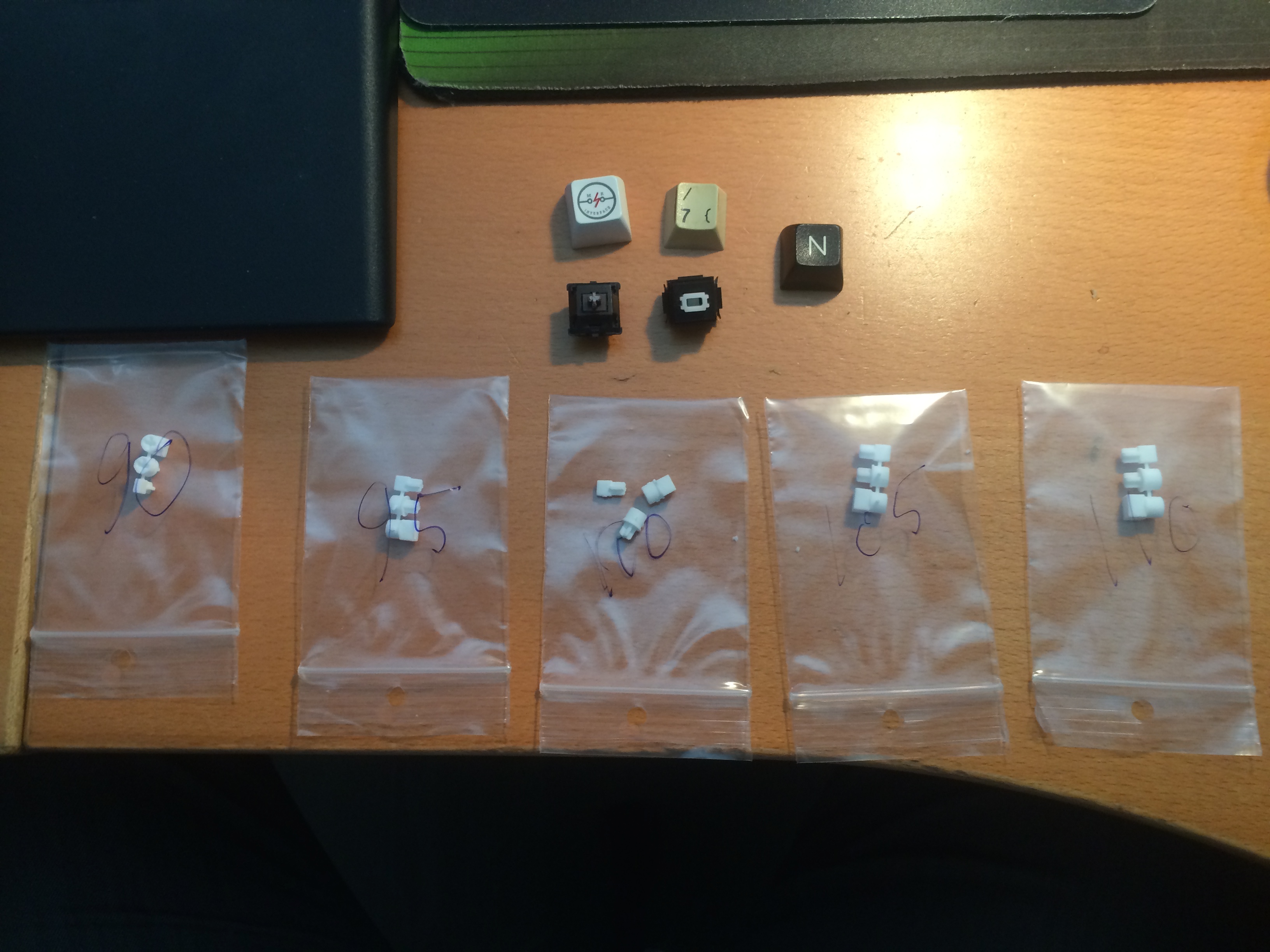

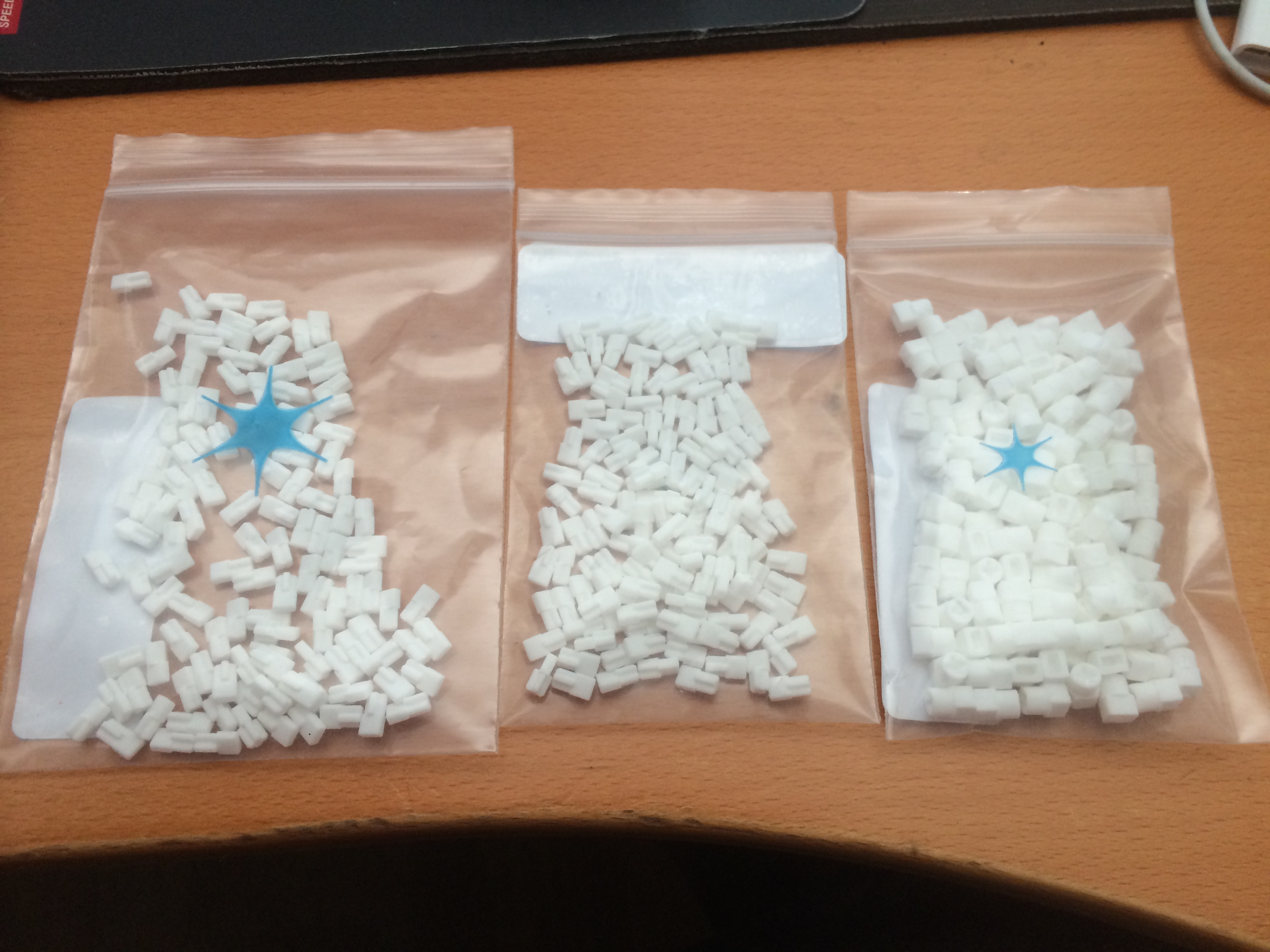

When is it ready? I'll have the adapters shipped from Shapeways next week. I designed the adapters in slightly varying sizes to check what the best fit would be. Then I'll create separate adapter grids you can order at Shapeways. I think I'll create grids with 120 adapters so you guys would have some spares :-)

Mrinterface
28 Aug 2014, 14:30
28 Aug 2014, 14:35
Our MX caps on Matias switches dreams are about to come true???
28 Aug 2014, 14:54
Northgate double shots on a cherry :)

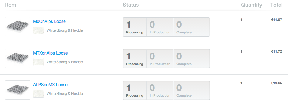

Mrinterface
28 Aug 2014, 16:59
Schermafbeelding 2014-08-28 om 16.56.58.png (75.31 KiB) Viewed 12948 times
Ordered them as 'loose' parts, so unconnected adapters...
Now we have to wait another week before shapeways delivers :-)
