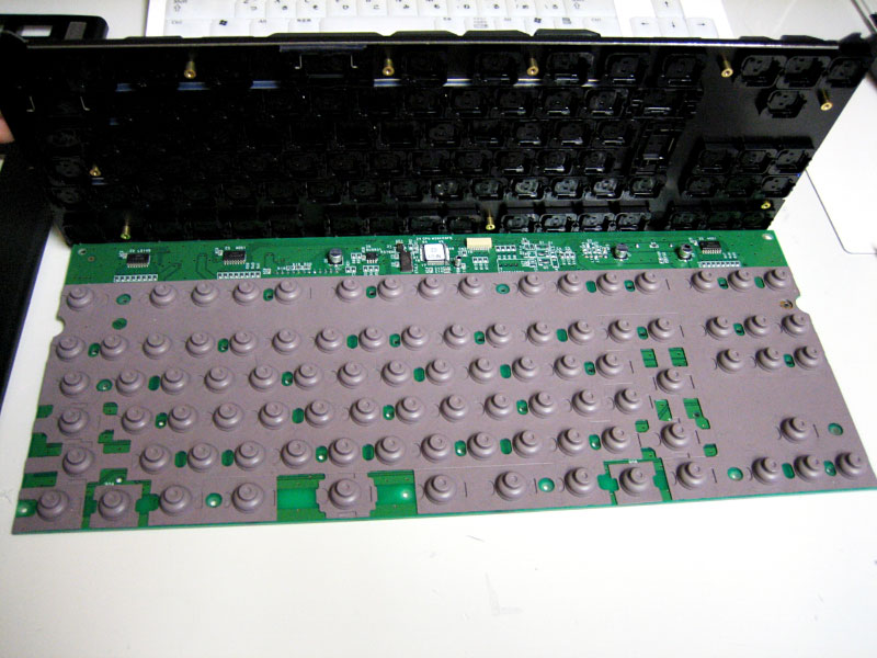

13 Jul 2013, 12:22
Isn't the HHKB a bit different to other Topre switches?
The main switch housing is moulded onto the plastic. Only the plunger can be removed, as opposed to the standard Realforce switch, which can be removed completely from the mounting plate.
Perhaps you can work it out. Have you poked around inside an HHKB?
Jmneuv
13 Jul 2013, 12:24
You swap around only the domies.
13 Jul 2013, 12:31
How do you get at them? By removing the plate I suppose, and then they are exposed on the PCB?
(Needs more pictures!)

that's from some guide i bookmarked:
13 Jul 2013, 13:11
Pic doesn't hotlink. Surprised to see it's still alive! Might want to host this on DT. Here's the link: http://www.geocities.co.jp/kousaku_situ ... rf012l.jpg
Wow, that really is quite the membrane… of rubber domes. Looks just like the innards of a crappy old white and clear Apple keyboard, and that thing's feel was wretched. Clearly, there's more to this than meets the eye.

Yea, i bet having a rubber sheet that costs 20 cents to produce instead of 10 makes all the difference.
-[°_°]-
13 Jul 2013, 13:43
I would need to cut some of the membrane... it should be actually feasible. Very tempting but still too expensive
Jmneuv
13 Jul 2013, 16:02
I guess with that many screws sandwiching the rubber it should theoretically be possible to even cut every dome to single unit.
