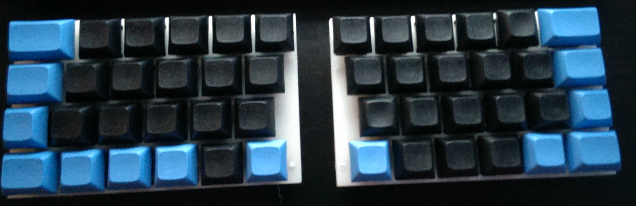

So I finally got some of the keyboard materials. I got my teensy, keycaps and switch trial.
I love the clear MX switch although it was a close call over the brown.
The DSA keycaps were great as well. Does anyone happen to have the dimensions of these keycaps?
I could measure them but would really like high accuracy and would rather avoid buying caliper if I can help it. The Signature Plastics site only has the dimensions for the 1*1 on their site.

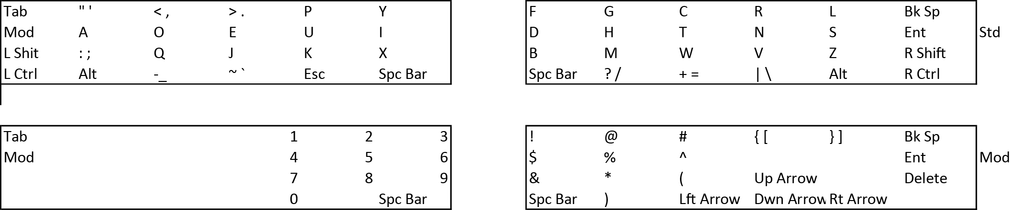

Thanks to Suka I have a keyboard frame for an early prototype. The goal here is figure out whether the staggered layout works for me. I have assembled the keys in a 4 *12 Matrix.
I have attached images of the layout as well as the frame itself. My goal is to use the mod key to access the second layer.
I have managed to get Hasu's code and played around with the GH60. What I am struggling to do is to code the teensy 2.
Can anyone help me customize the GH60 code so that I can get this keyboard working?
Again thanks Suka for the frame, greatly appreciated

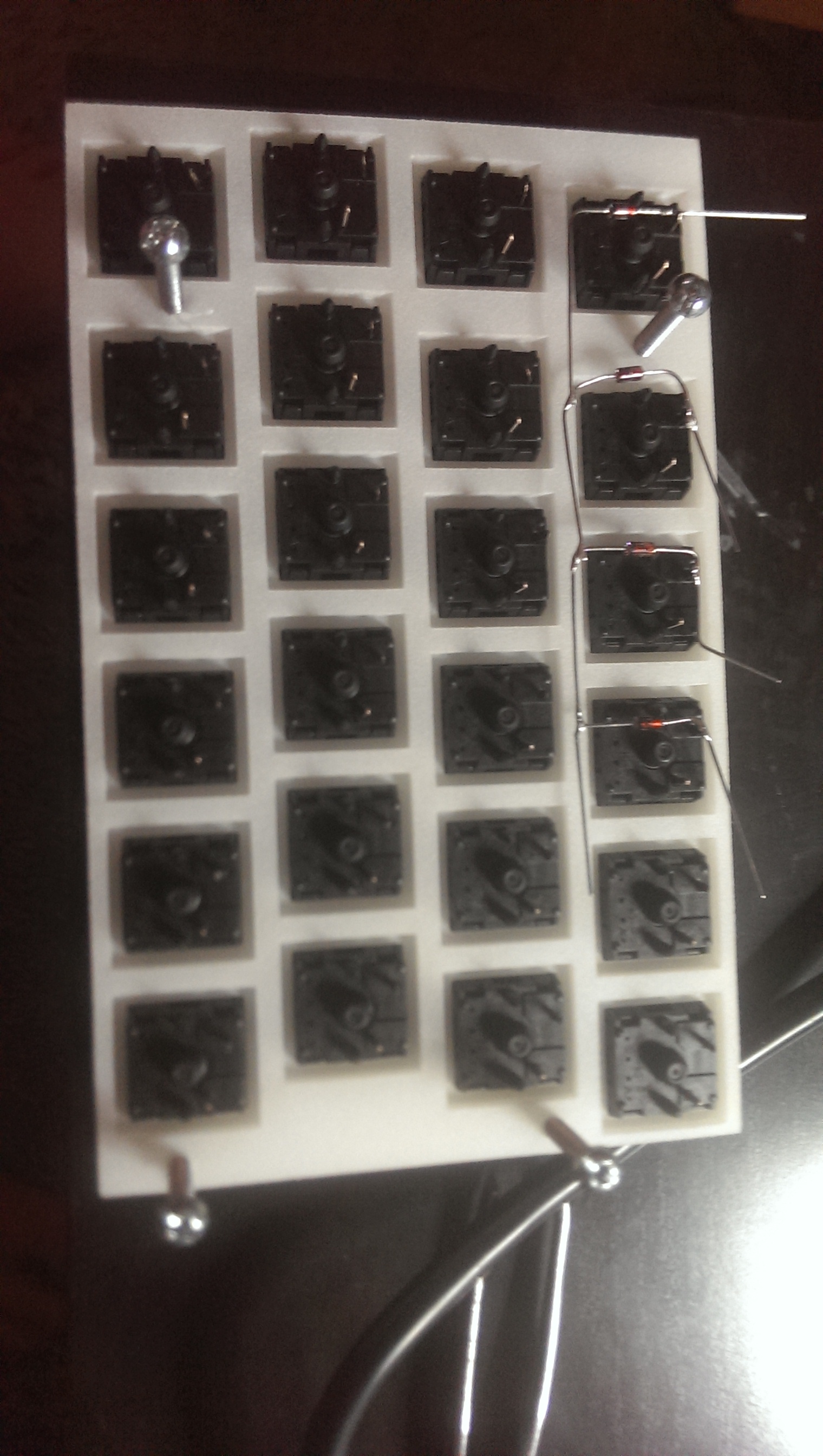

pjmelon
- Main keyboard: Thinkpad
- Main mouse: Trackpoint
- Favorite switch: MX
The frame is 3D printed plastic (Suka can confirm material) Took a picture of the underside so you can see how it is mounted. It is very tough and has little flex.
I am starting to do the soldering now so will post it once it is all done. I may have been a little ambitious as to how quickly I could solder it all together. Moving house in two weeks so hopefully I get the basic soldering done before then.
- 2013-08-27 20.32.19.jpg (853.92 KiB) Viewed 7348 times

Hopefully this will make a good tutorial for matrix making and the appropriate modifications to the GH60 code. Suka generously sent me similar prototypes (symmetrically staggered!) and I have spare switches mounted ready to experiment. Once I have another Teensy and know how to code it…

Nice! I did not expect you would actually build a board straight away with these frames, but if you like it that way, fine
In my designs (either split or single board) I connected the columns of both halves to get away with a 8x6 matrix needing 14 pins on the teensy.
Code for either my own or tmk_firmware is on github, put configuring rows and columns is really fairly easy if you know the basic logical operations on binary data. I put way too much effort in using F-Pins for columns and D for rows (also forgetting about LED on D6!) which makes neater code but a mess to solder all connections, but as Matt3o stated before basically any pin is fine. Only if you need certain special features (PWM for led, interrupts on PS/2 lines) make sure to reserve these pins for their future use.

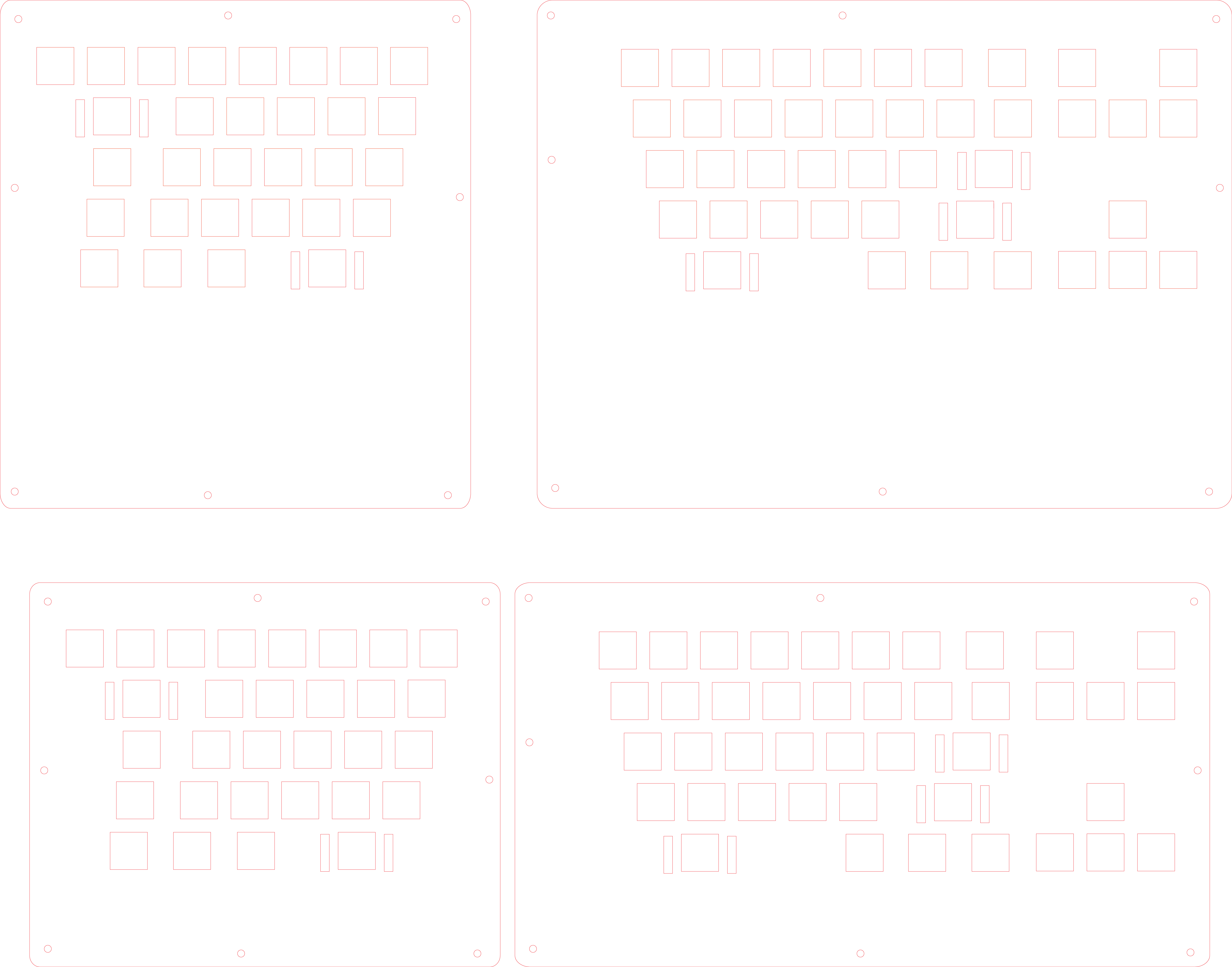

Well it has been a while. I moved house so have been a little distracted. I have played around with Suka's prototypes and have come to the following layout choice. The overall key spacing should be similar to Suka's but I added a few extra keys. Let me know what you all think of this. The two red buttons at the bottom are the mouse buttons and the rectangle the trackpad.
- Keyboard Base_orientation5layout.png (33.79 KiB) Viewed 7176 times

The asymmetry would drive me nuts (because I have an unhealthy obsession for keeping things balanced) and the trackpad looks so small, but I expect you've tested these basics and have chosen what works for you. The overall split arrangement with symmetric stagger is definitely strong.
pjmelon
Sorry meant trackpoint and not trackpad.
Symmetry doesnt bother me, it is really only because it is split that you notice it. Most keyboards are right hand heavy with keys you just dont notice them as much.
Planning to get the layers cut at Big Blue Saw in aluminum as the price is the best (~$200). The Top and bottom plates will be cut out of aluminum sheet while the middle will be made out of two 0.25 inch aluminum layers.

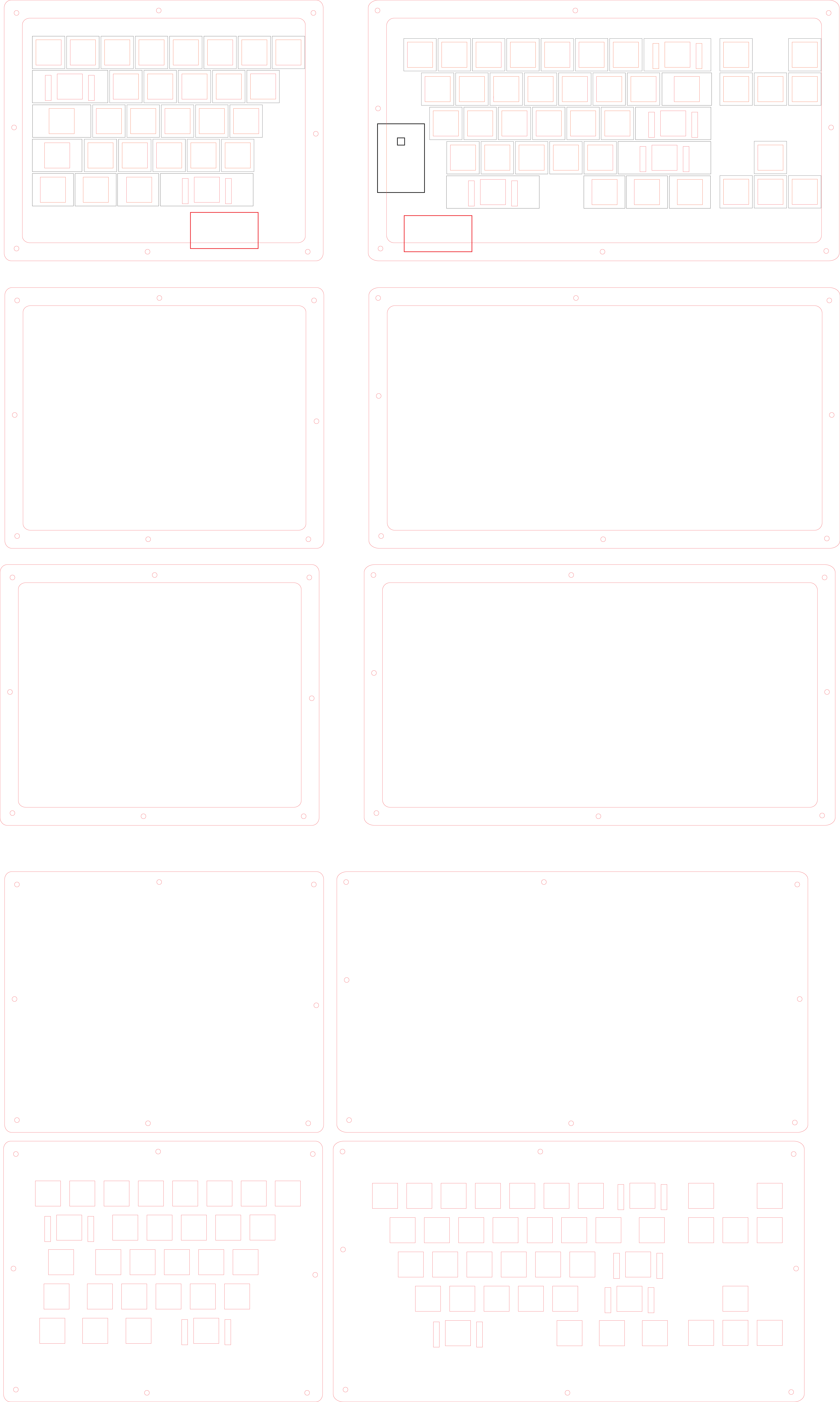

So I am choosing to stick with aluminium and go with 2mm sheet for the top and the base and for the two middle parts will be 4.76 mm thickness each (9.5 mm total).
Works out to be fairly pricey but I think it is worth it and that the clearances are adequate.

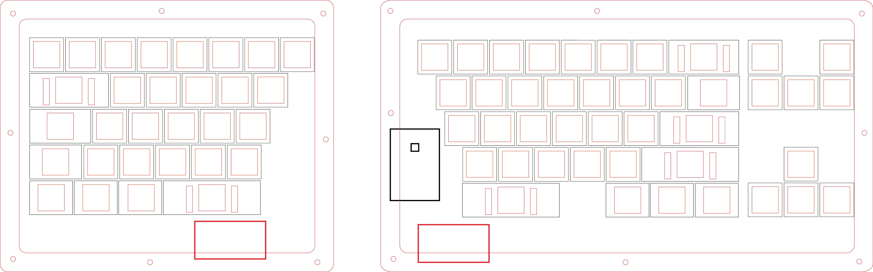

Ok, up to my final decision before I get it sent to get cut. Both my laptop keyboard and usb keyboard have a palm rest and was looking to replicate it. Here is a comparison between the two, one with a palm rest and one without.
Opinions?
Opinions?
- Comparison.png (138.14 KiB) Viewed 7040 times

I use a hard, flat acrylic wrist rest and like it. Having one seamlessly part of the keyboard would be nice as well.
If you go with the rest, you may want to file down the sharp edge that will be facing you. Also, since it will be supporting the weight of your arms, it may be good to have an additional support screw in the (horizontal) middles near the bottom row of keys. A couple other things to consider is the wrist rest will give you more internal space for wires, components, etc., and add weight to the keyboard (pro or con depending on your preference).
pjmelon
Weight is not the biggest concern for me. As for the sharp edges will have them covered with something. I will also think about adding a beam in the middle for support, it is a good idea and will reduce flex in the keyboard.
