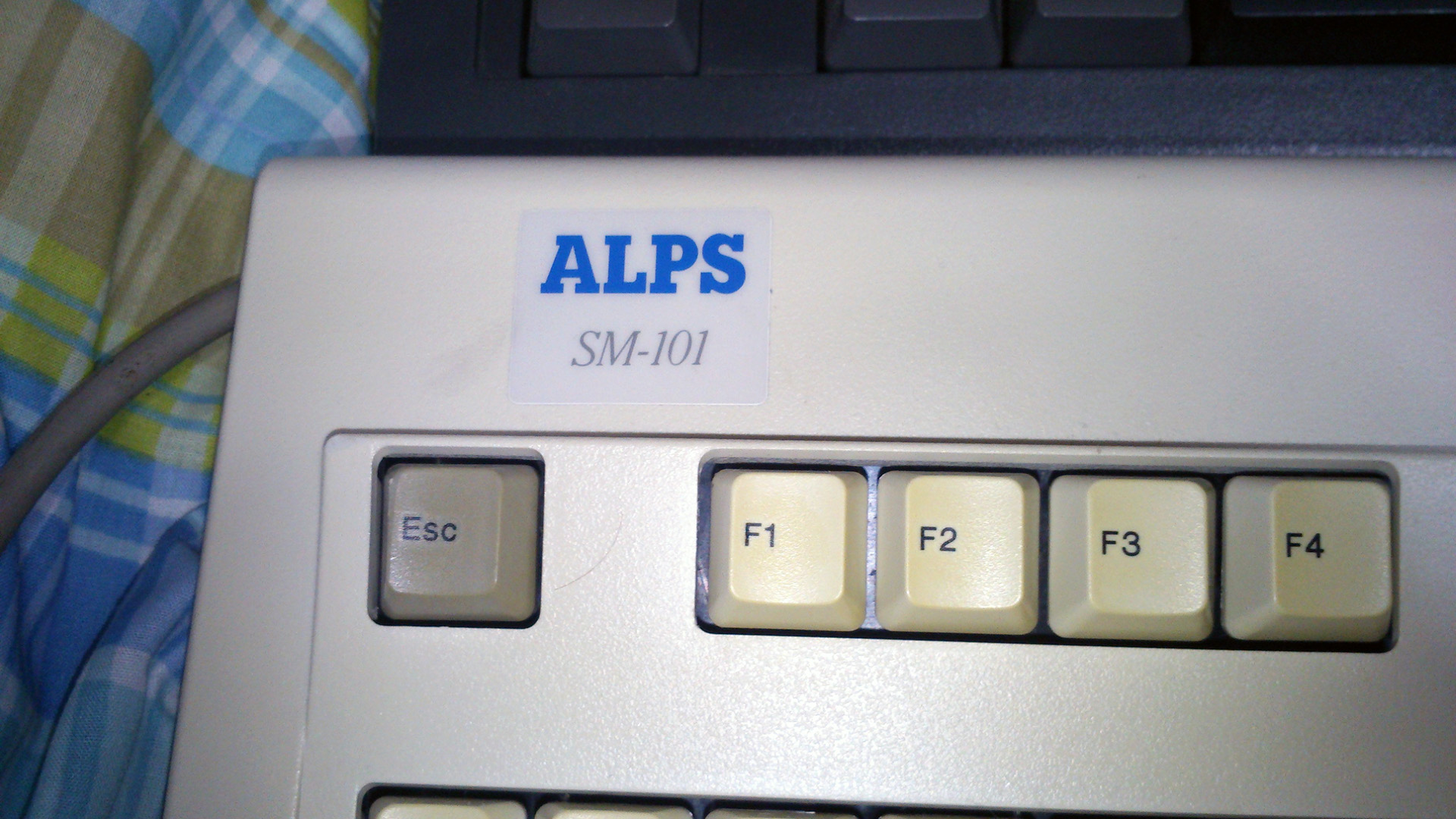

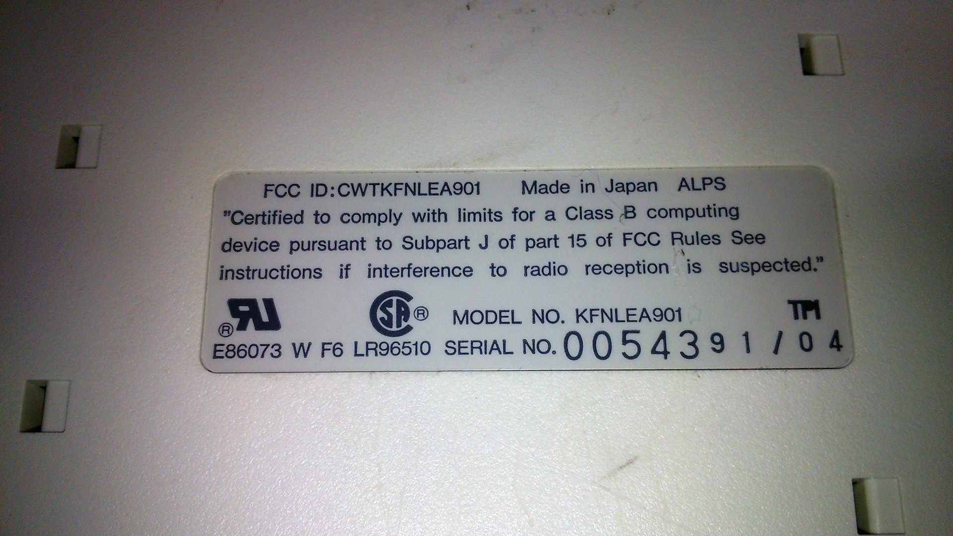

And now I've gotten my hands on an Alps SM-101, which is essentially an ANSI version of the Teradrive board.
One of the most shoddily built metal spring keyboards I've ever laid my hands on. But, that doesn't really affect the feel...
So, let's get to that. More preload than I'd like, but peak force is quite nice. Feels a bit frictiony, and the tactile point just feels... odd - almost as if I were stretching the spring a bit before it's forced to buckle. (Although, my board may be worn out. The keycaps are worn down to the point that they don't even have their nubs on F and J any more (you can see they were there, but can't really feel them)!)
Noise is quite quiet for what it is. Quieter than MX Blues, and definitely quieter than any IBM or variant BS.
I think I'd class it as better than Cherry MX Blue, mainly because it's a lot smoother, but MX Blue seems to have less friction. And, I'd class it about the same as an IBM Model M (for completely different reasons, though - this seems to have the stiffness about where I want it, but the tactility seems quite a bit lower, whereas a Model M is too stiff, but the tactility is good. Neither has light enough preload, though). Beam spring and Model F 122 are better, though, in my opinion.
I will withhold full judgement, though, until I've either found an AT to PS/2 adapter, or gotten myself to Micro Center to get another. (Damn thing is AT, and I don't have anything left here that actually takes AT...)

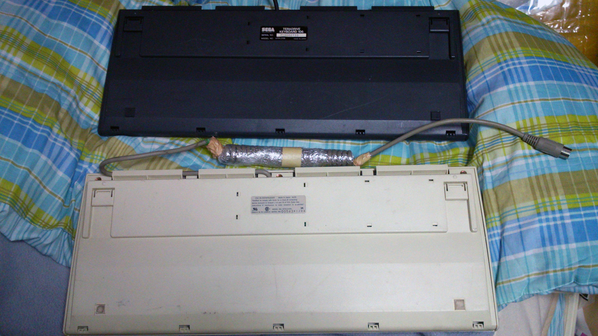

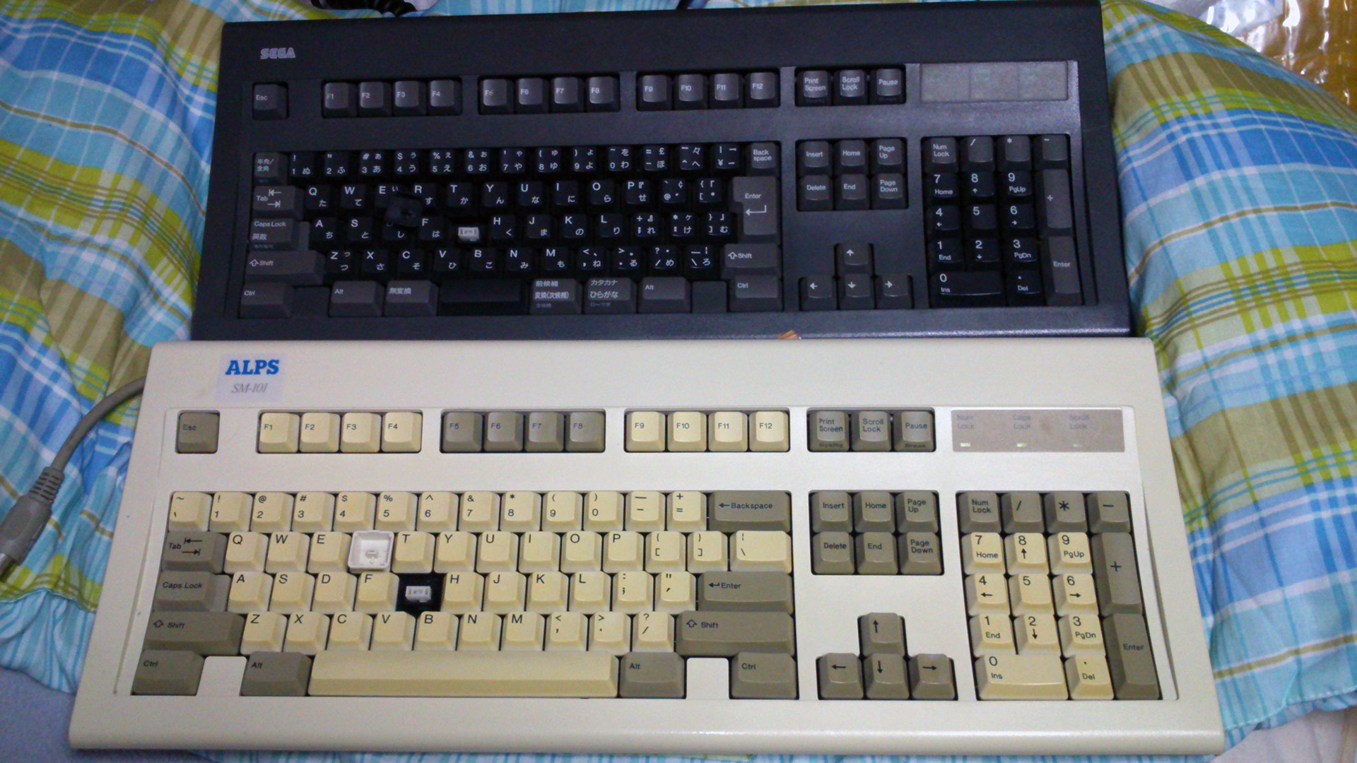

06 Dec 2012, 23:52
Very nice comparison. Identical except for the color.

13 Dec 2012, 23:23
Is that a Teradrive board?
phetto
Elite
13 Dec 2012, 23:34
Icarium wrote:Is that a Teradrive board?
Yes :)
