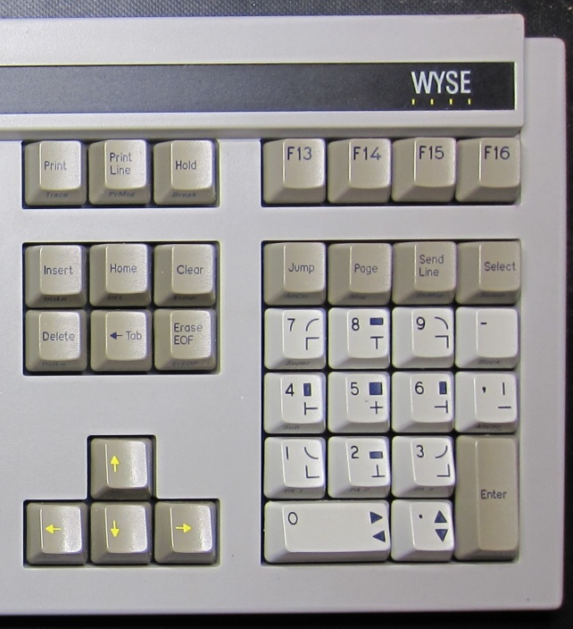

Here's the numpad of a WYSE WY60 3161 keyboard with the same legends...

Nice find. Is the Wyse a drop-in replacement for the IBM, I wonder? Those caps look application specific, don't they? I always see ASCII art when I look at them. They're well laid out for it. The first place I saw that, beyond my computer, was teletext on TV…

The keyboard wasn't a drop-in; it's a different protocol. But the complete WY60 terminal could've been a drop-in for use with a variety of hosts, hence the variety of keyboards available for it - ASCII, ANSI (VT100?), and 3161.
