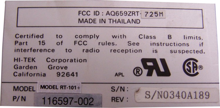

klikkyklik wrote: I noticed in your list that you indicate blacks as clicky. I have an RT-101+ board with Hi-Tek blacks that are not clicky. They are tactile and fairly stiff.

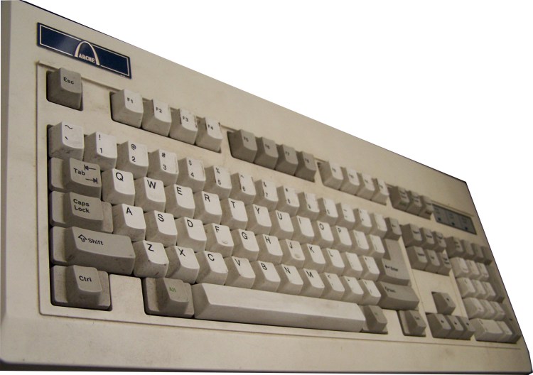

It's an old Arche board. Unfortunately I don't see a date on it. Considering that I'm fairly new at the keyboard game and haven't yet removed a space bar, I'll have to do a little research to find out how to do it properly with these Hi-Tek's. I'll see if I can get to it after work today (about 11 hours from now).

After watching your nice video and hearing the higher-pitched click, I started doubting my memory and just made provisions to go grab the board to type on it again. It definitely does not have the click yours does. There is a clack on the key bottoming out, but that's it; there is no way these switches could be considered clicky.
As far as the space bar, if you can give me some pointers on how to pull it without a key puller or what-not, I'm all ears. The only thing I have key-puller-wise are two of those plastic ring styles. I'll get a "proper" wire-type puller in the future, but for now that's all I have.
If I had to guess on the date, it would be maybe 1994'sh.

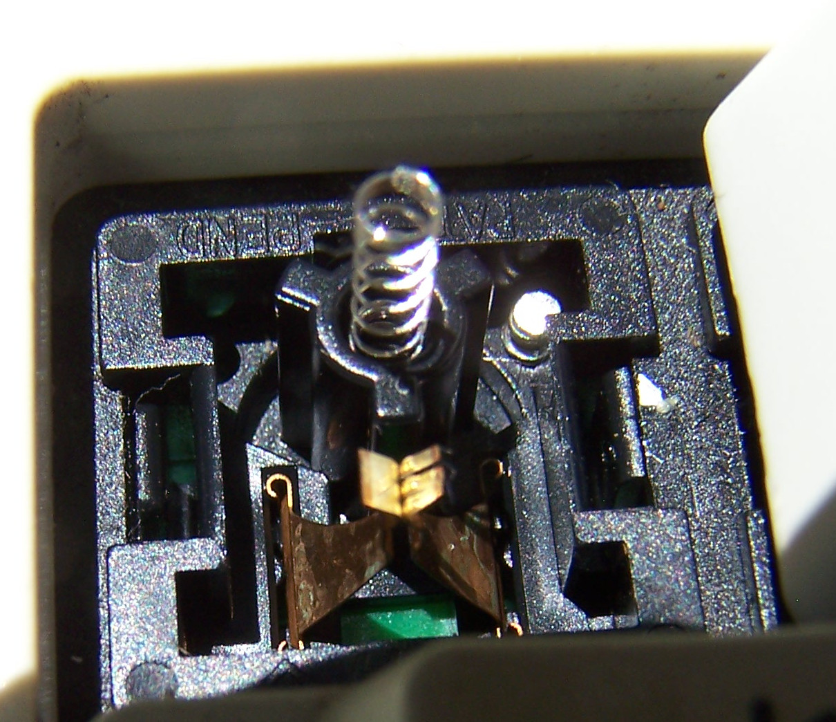

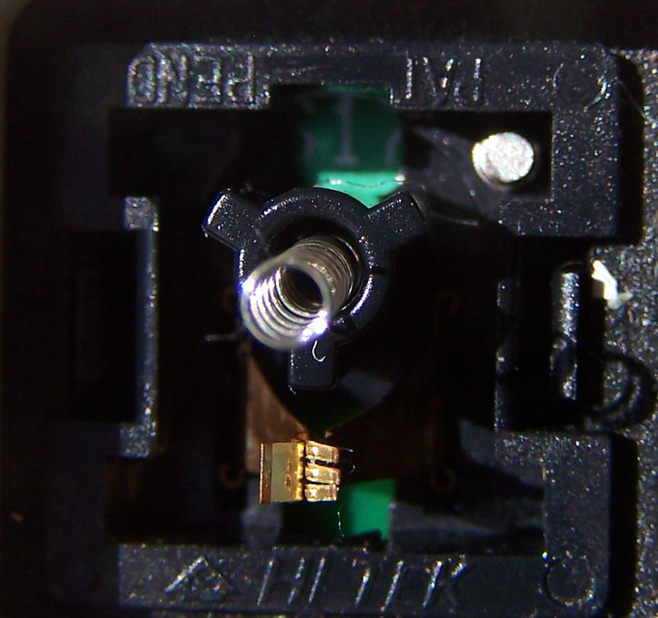

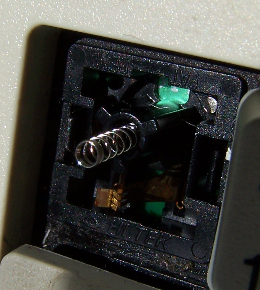

Going by your images, yours definitely has the characteristics of a tactile switch with the double-kinked contact leaves and the narrow separator bar. Good find.
If you really want to confirm that it's not a clicky variant, just look for the trailing arm at the back of the switch as pictured here and here (lambda-shaped white plastic thingy...). If it's not there, then I am almost certain you have discovered a new tactile variant :)

Here are some more shots of the switch. There is no evidence of the little white trailing arm gizmo. If anyone would like better (cleaner!) pics for reference, I can try to do that.

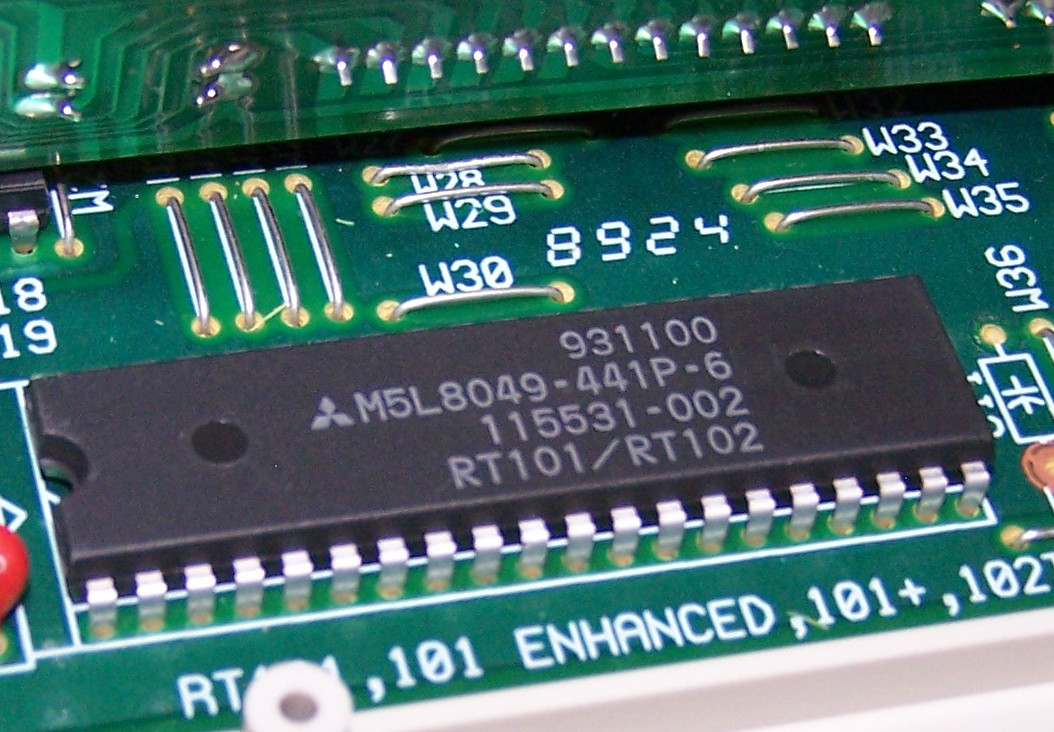

The date is on the PCB itself; it takes the form of four seven-segment digits for YYMM.

According to this it'd be 1989, but ... 24 for MM?

Could it be YYWW?
24th week of 1989?
21 Oct 2014, 00:15
Argh. I keep writing MM instead of WW. Must have got a bit of 002 stuck in me ........
Yes, week. This should help Sandy's NBM Hi-Tek switch cataloguing efforts. It's useful to get the date, as in most cases we don't have that data, and it would give us a clearer idea of the history of the different variants.

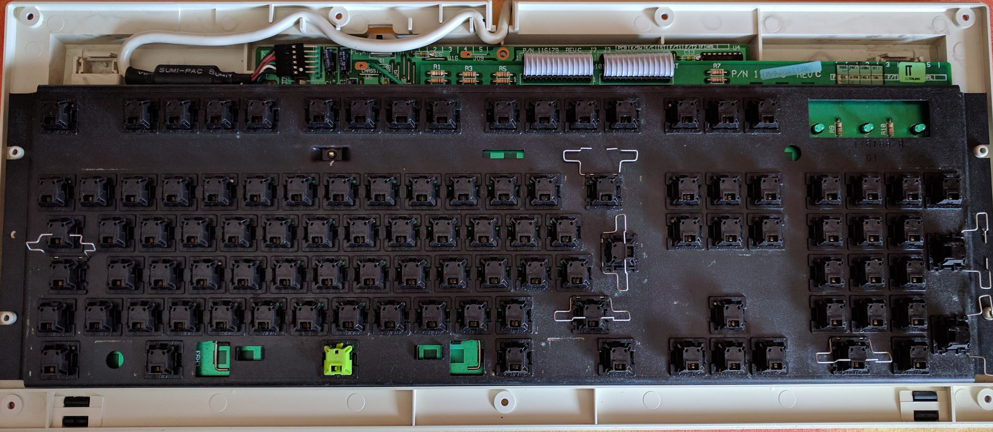

Here’s a 122-key XT board.
Heavy tactile gray switches + even heavier linear pea-green switch.

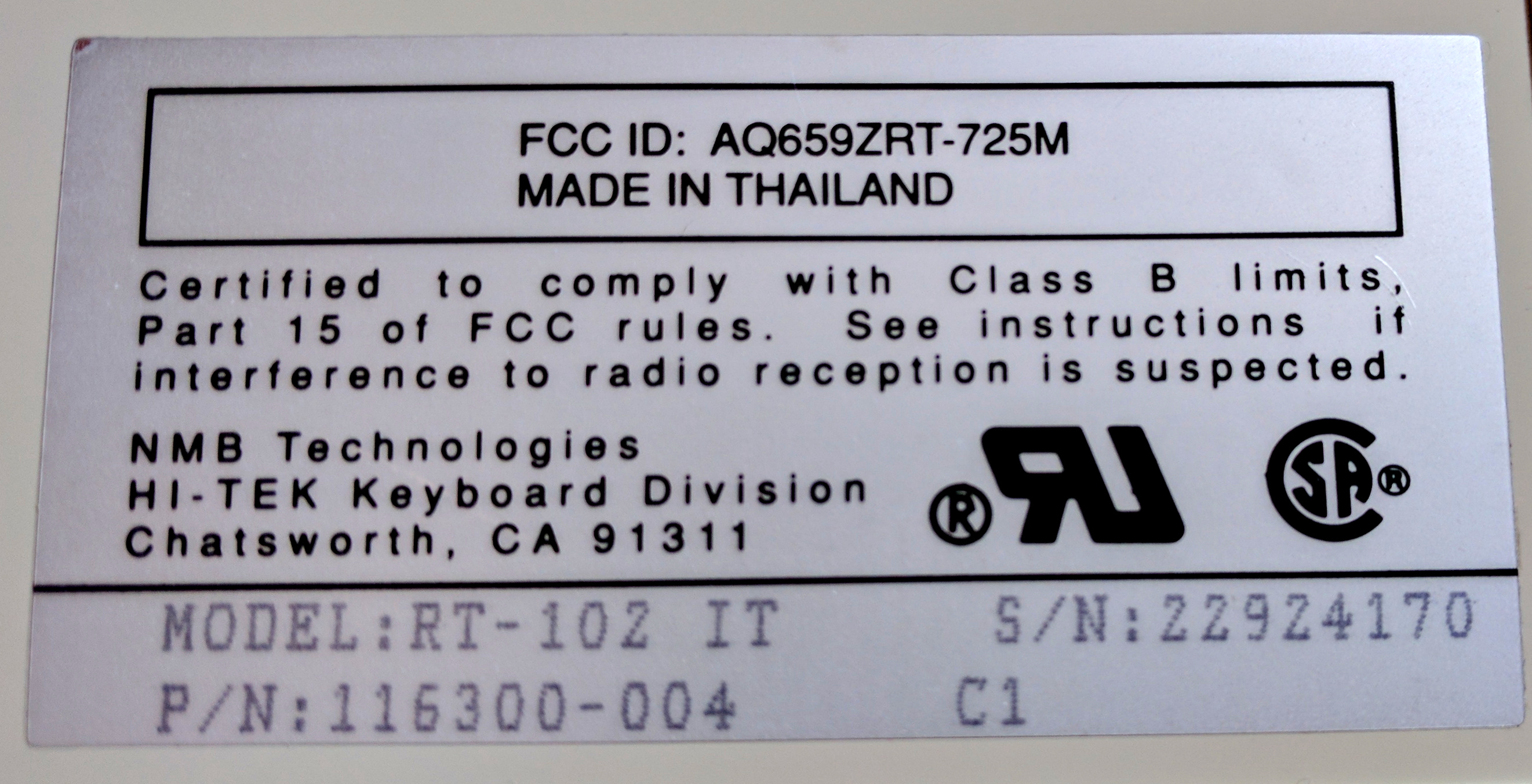

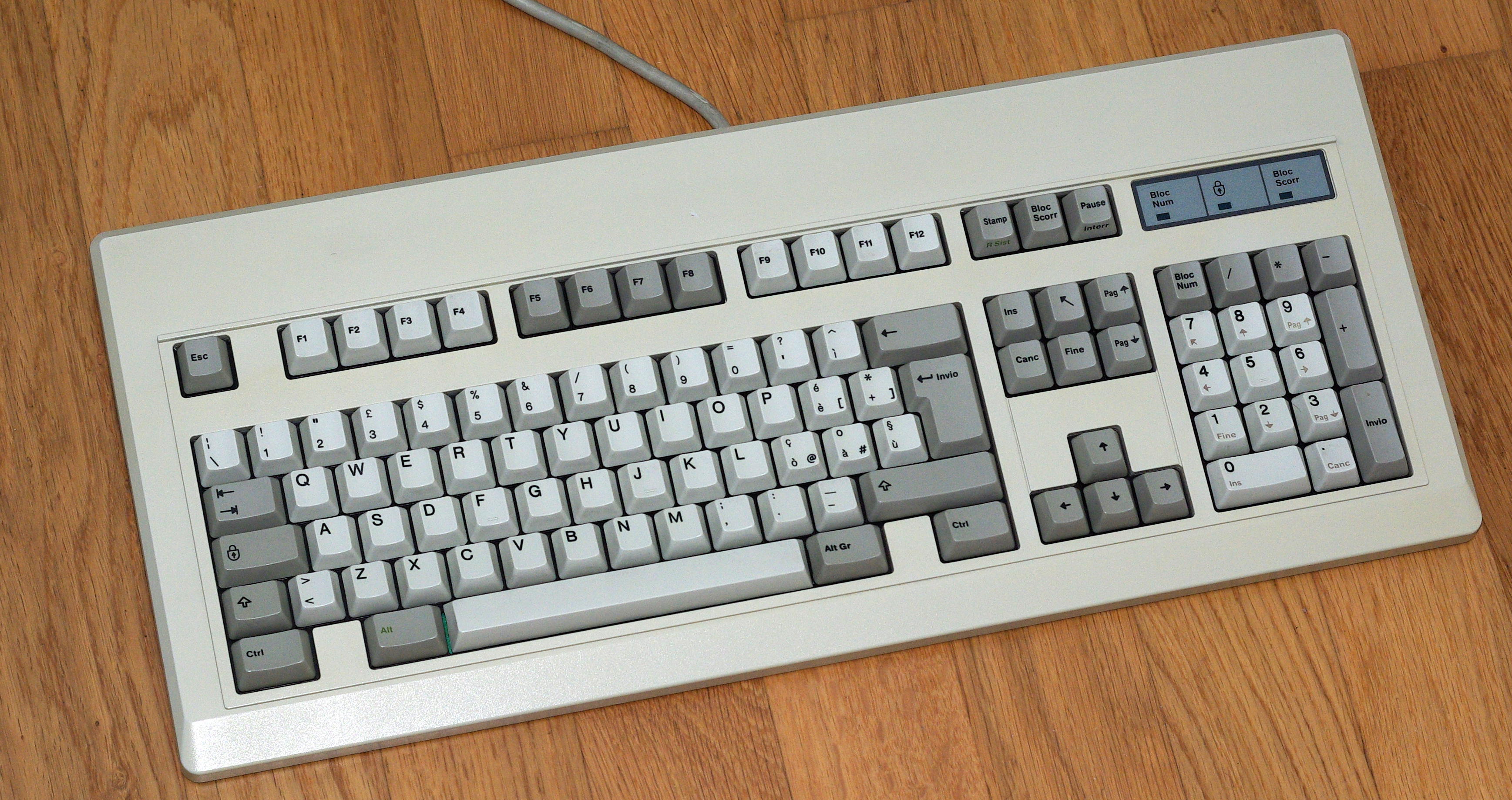

27 Jun 2017, 21:27
Necropost, I got this clean 4th gen. NMB RT-102 IT the other day with black two-eyed tactile Hi-Tek 725 series switches like klikkyklik's example. The tactility is wild with short keytravel and very imminent tactile feedback combined with a rather heavy keyweight that I have not measured. This is a completely different experience to the clicky Taran RT-101 I got from Chyros. According to the markings inside the case this one dates April 1989.
