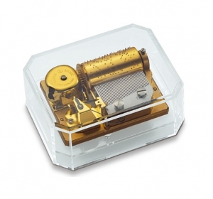

Normally yes. For example, the pins on the drum of an old musical clock would be called Nocke. Nocken is the plural as well as a synonymous word.

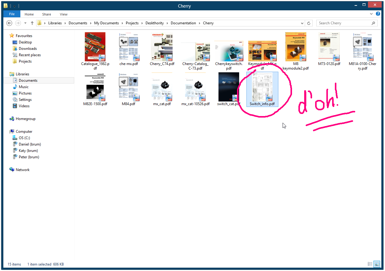

What's funny is that I recognise that page but I don't remember reading half of what's on it. I'll have to check whether I really do have that file already — I probably do. Interestingly it mentions the click sound.

PS: D'oh!
