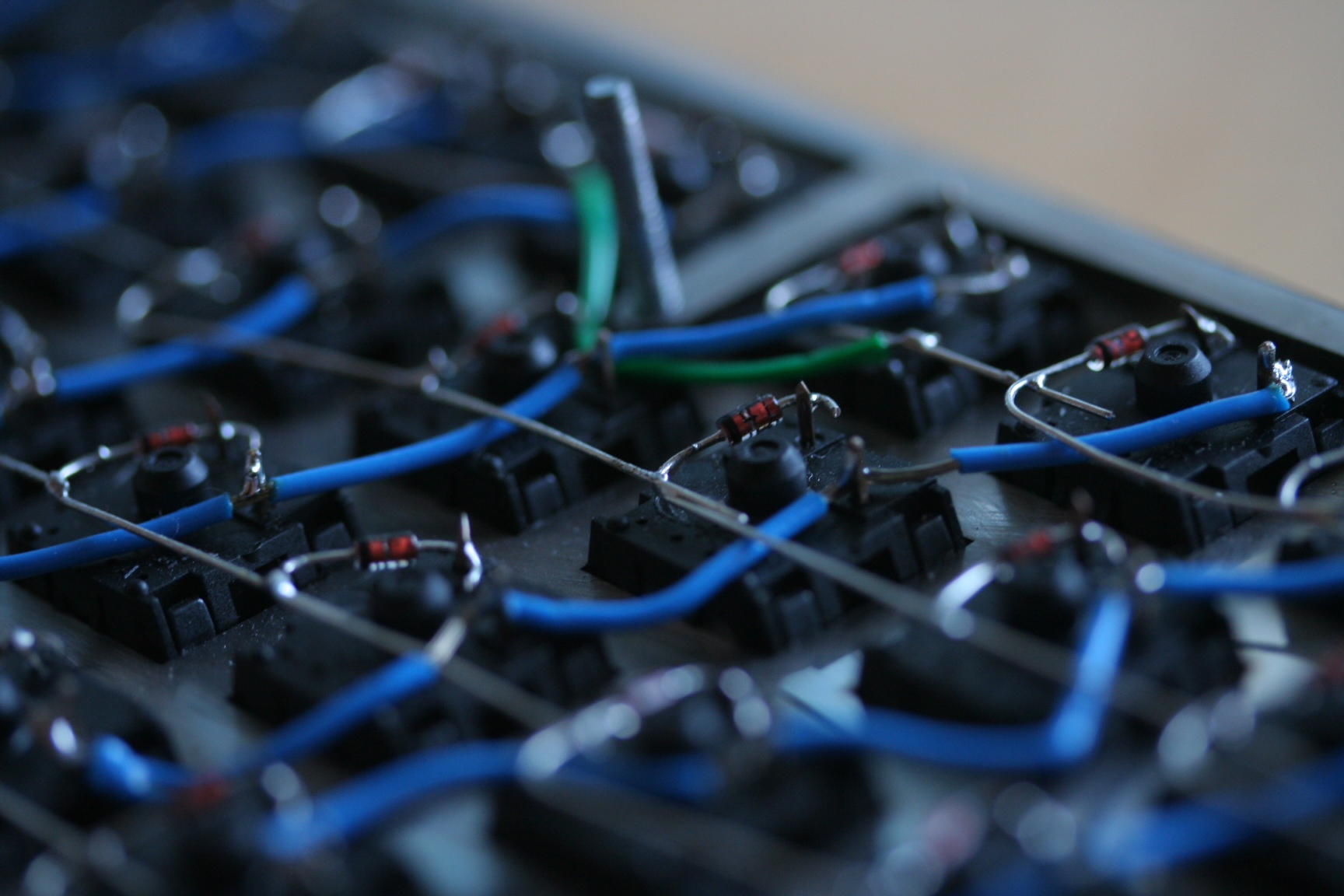

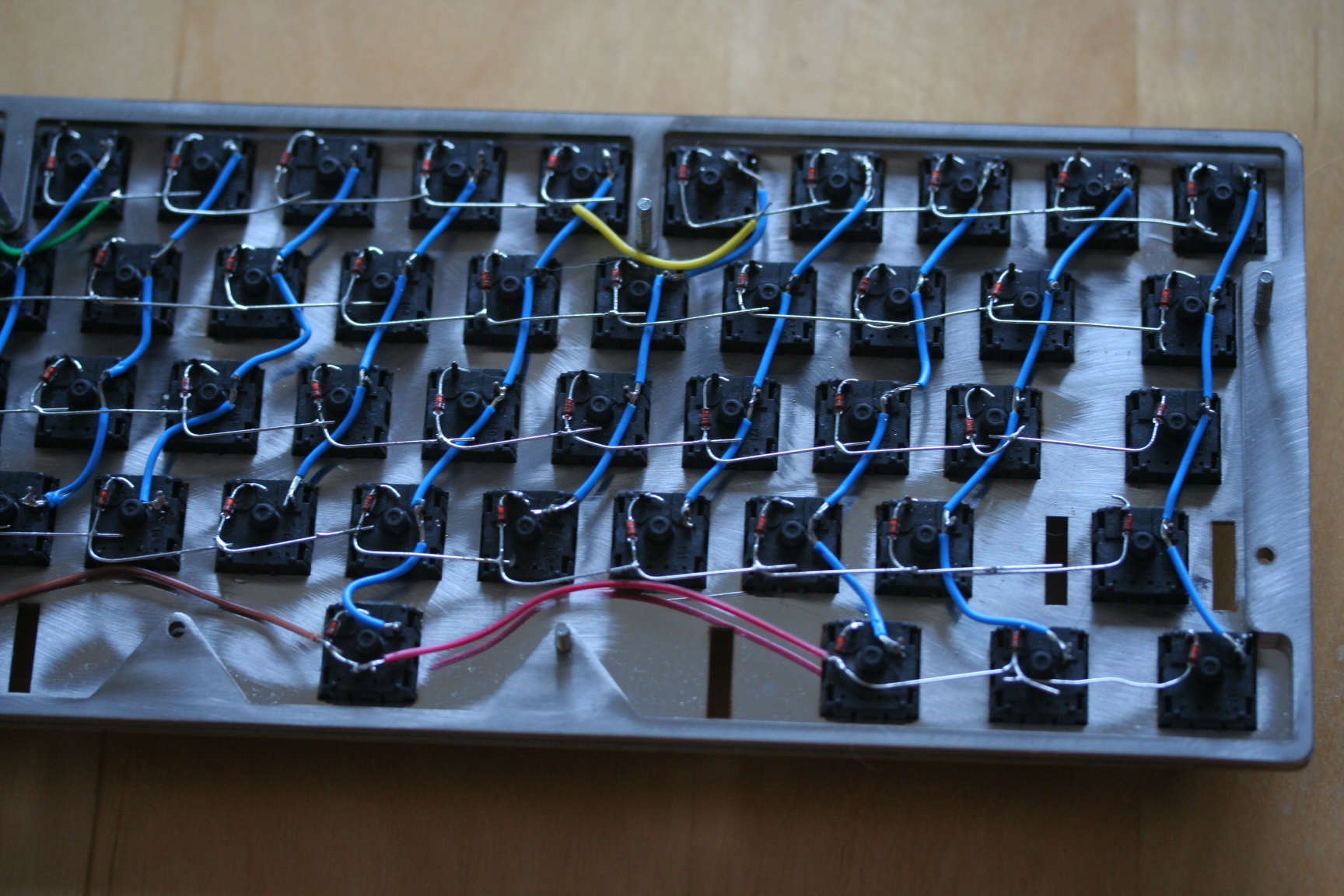

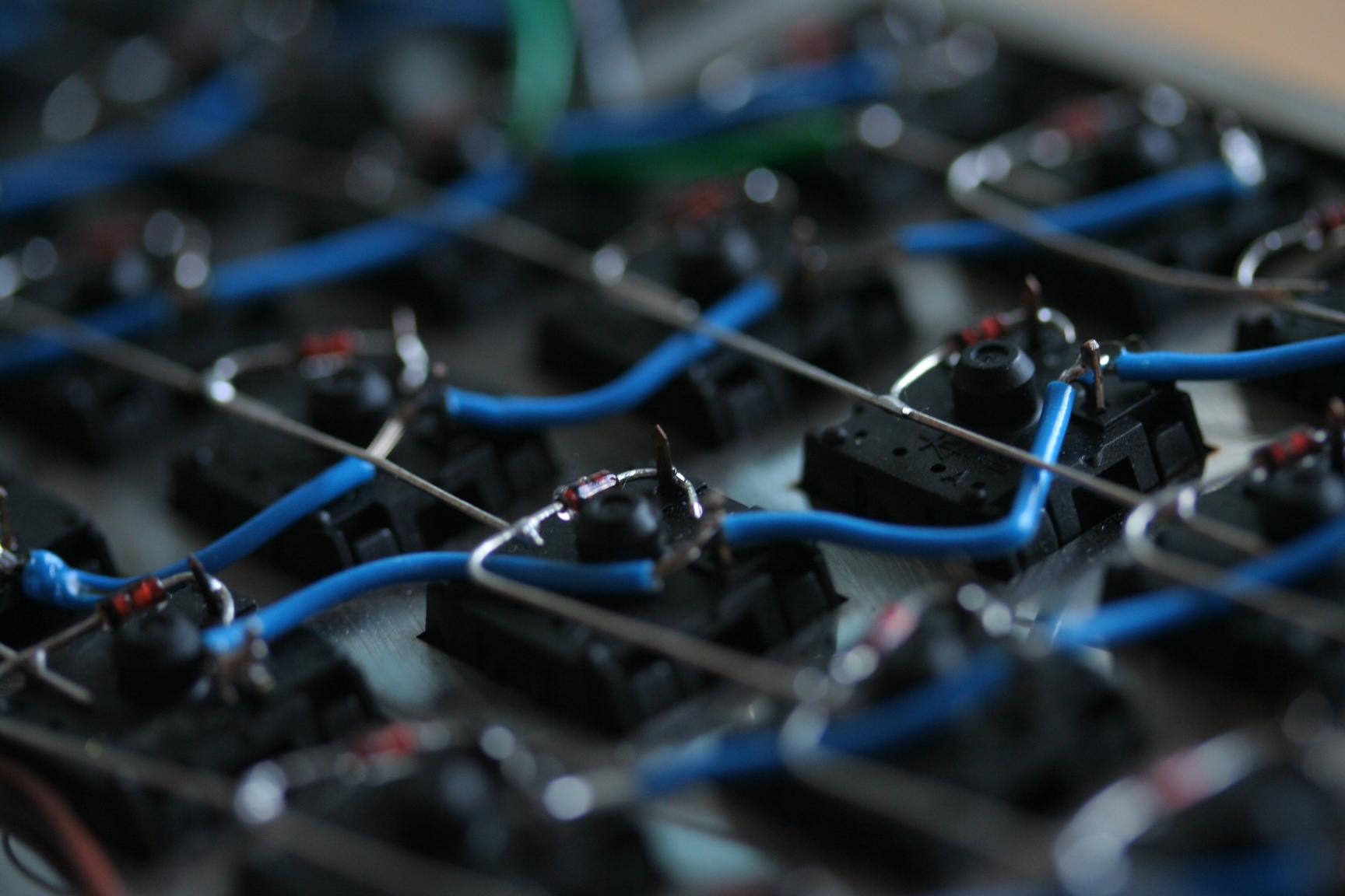

matt3o wrote:if I remember from one of your pictures you have loose wires connecting the rows/cols. my suggestion would be to make the wires very tight. Can you take a close up of your hand-wiring job?
Diode porn!
Love how a camera can make sloppy work look nice!
And a more informative shot to answer your question:

You seem to have an expensive camera (or a good skill and the appropriate lens)
25 Nov 2013, 23:31
The trick is to shoot looking into reflections. And for arty blur, go wide open with a quick lens. f/2.8 in this case.

your wiring is not that bad. the wires are okay, the problem is more with the diodes I believe (connections are a bit messy). Also I see some spots were cols go dangerously close to rows.
I would also rewire the yellow one. Use a smaller wire, go under the current matrix down from row 1 to below row 2 and up again to row 1. Cut all wire ends if they are too long (again I see at least a couple of dangerous spots from here). Be sure that the sides and the bottom of the case are well insulated. It might be that a wire shorts on the side and not on the bottom.
If that's not enough you can try to insulate the connections with epoxy glue. If you want you can send it to me and I'll try to review it.
26 Nov 2013, 00:24
All good points. I'll redo the yellow wire and get snippy with the loose ends near case edges, etc.
Quite miraculously, it all worked the first time I tested continuity and again when I put it together with the Teensy. So I let my enthusiasm race me on instead of taking my time to finish things off with finesse. Pretty confident I should do it better this time.
As for the Teensy, I'd like to fix it in place really, as the plan is to put Bluetooth components in place down at the back as well. Like your next move in the similarly stepped case HHFox!
