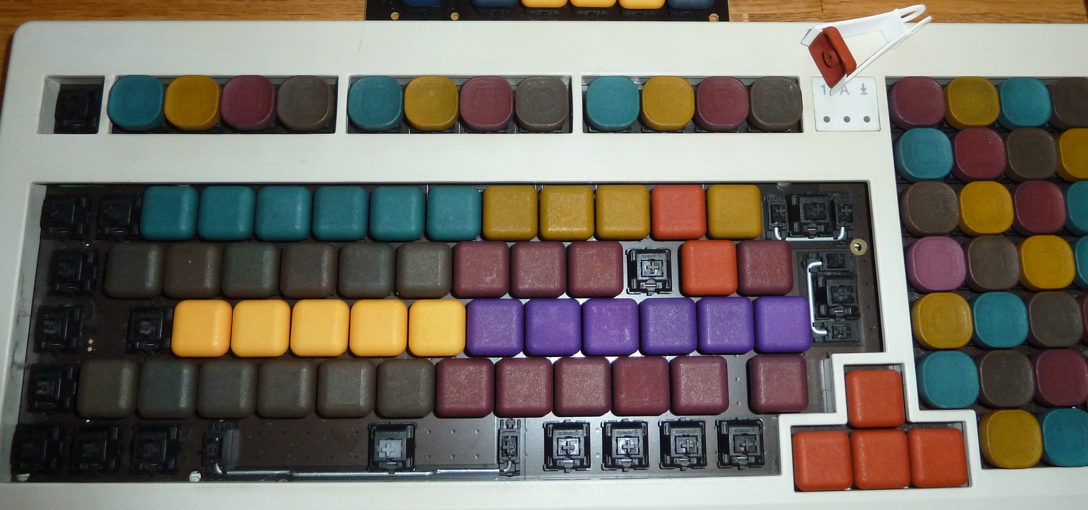

Wait and see for yourself :D Gotta work on the font cutouts, the tiny pieces really are a pain to get right - for backlit caps there is something much cooler coming.
Muirium wrote:Are you ready to try larger sizes, to cover a whole standard layout? Or dare I wonder Alps mount? The biggest problem with Matias switch customs is getting just the caps and layout that you want.
Size does not matter, contrary what some people believe ;) Larger caps or other mounts are easy to create, I actually just ordered some Alps but have no access to a Topre, sadly.
I was just playing with the different shapes, and think I might go with the typewriter style rounded ones and the flatter candy shaped for a full board first, eliminating another 5mm of height compared to DSA.
The biggest issue I see is that the surface of the PA is quite rough when untreated, something I personally do not mind at all, and what actually seems to help in getting good colouring result through dyeing. There are possibilities of finishing the caps to get a smooth surface, but for example mechanical tumbling has limitations if there are embossments or tiny rounded details like in the masks or skulls.

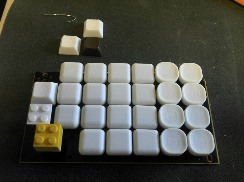

But first the boring stuff:
I think I'll go with the central square ones first.a After trowalization (barrel finishing) the surface is just smooth enough to feel very nice, will be interesting how the minimal height looks in a board.

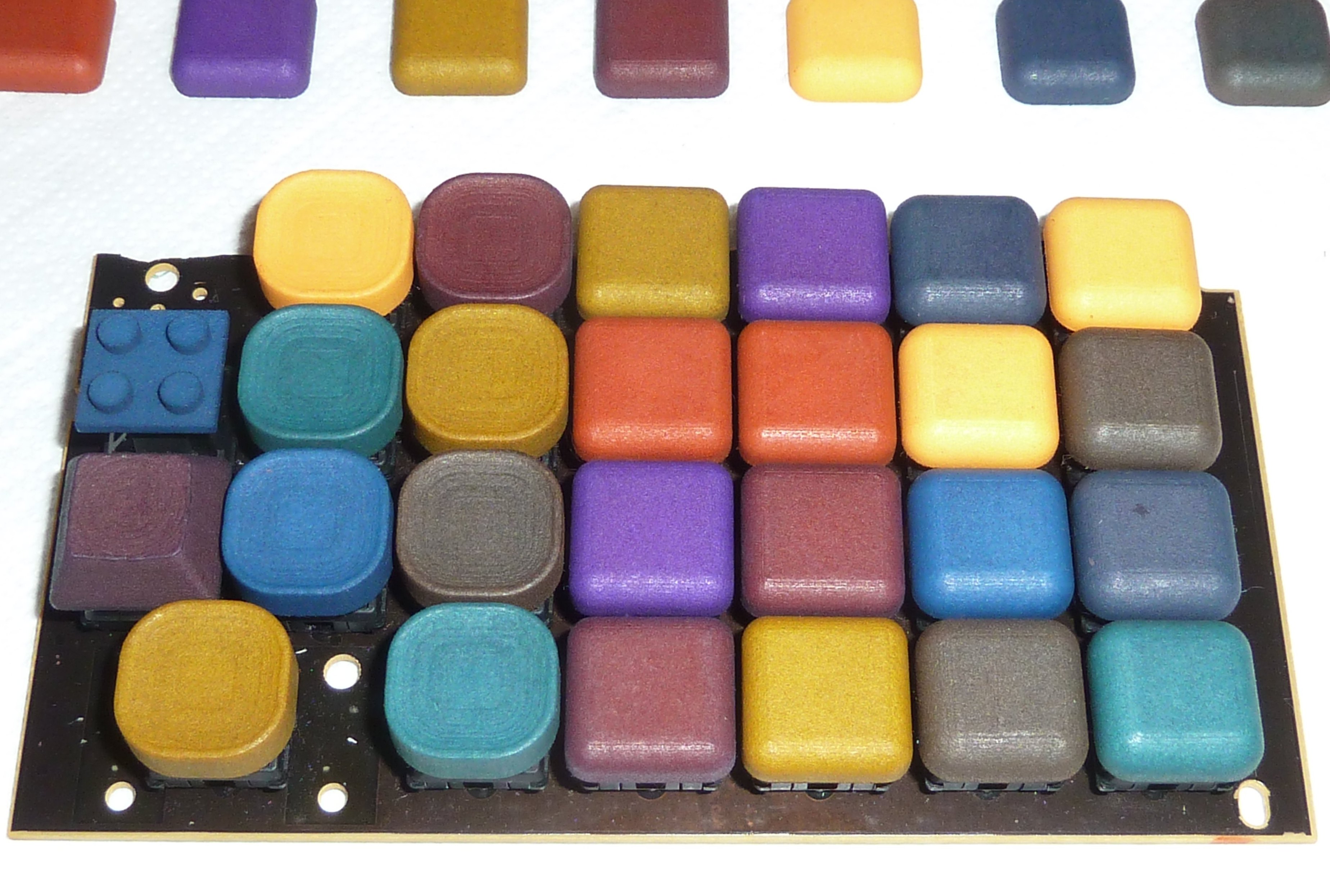

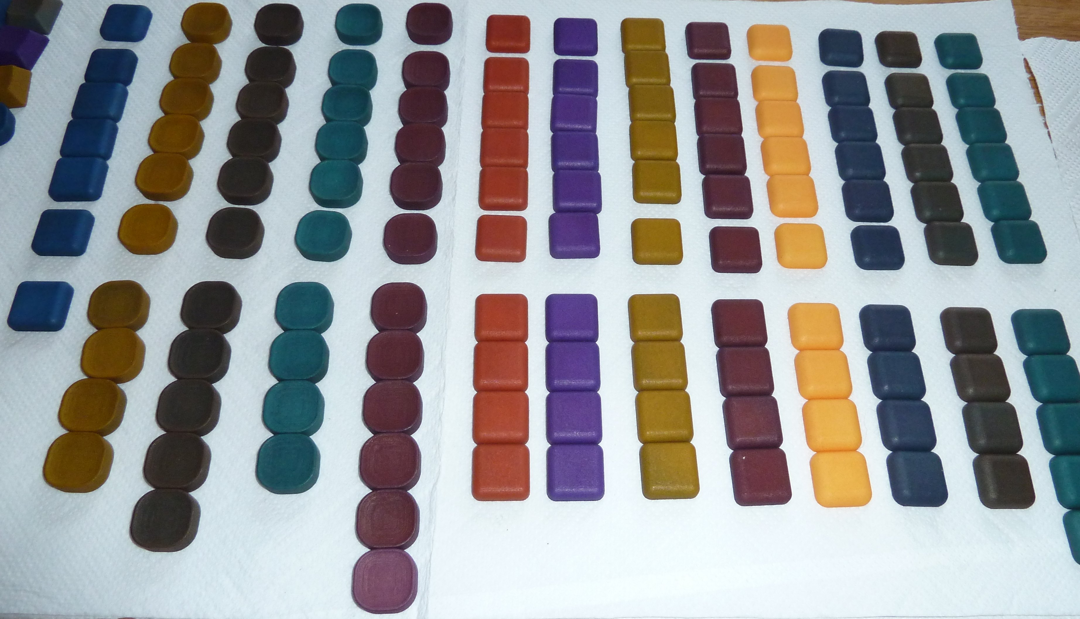

How did you know that theme was coming? I was actually was aiming for "TRUVS - The Retro Unicorn Vomit Sweets" :lol:
Nice thing about the PA parts is that they can be dyed pretty nicely, albeit the outcome is not always what the color looks on other pieces or on the packaging, for that matter. Only very few colors don't seem to work, but especially when the surfaces are finished the result can be quite interesting: The end result is a lot darker/dirtier looking and more retro than shown on the flash images, but very even and only the slightest hint of the slices from 3D-printing can be seen on rounded areas after the tumbling.

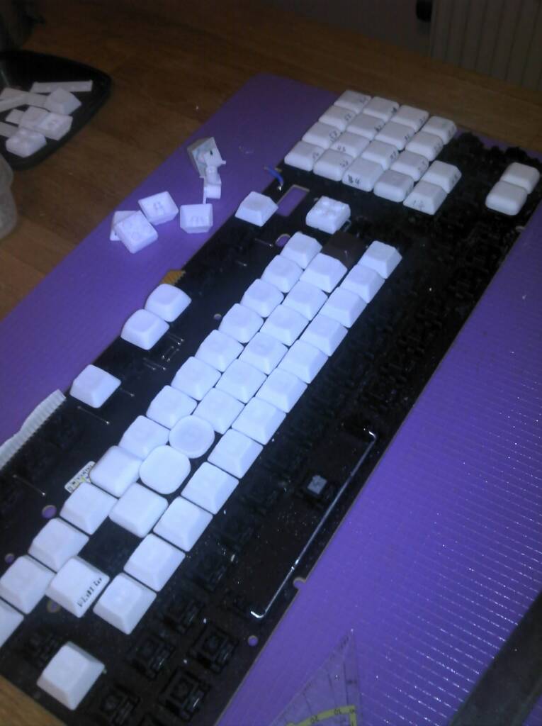

11 Mar 2014, 18:23
There you go from lame to fame :)
Thanks suka for the caps!
Plaster
Sanding
More plaster and more sanding.
Silver!

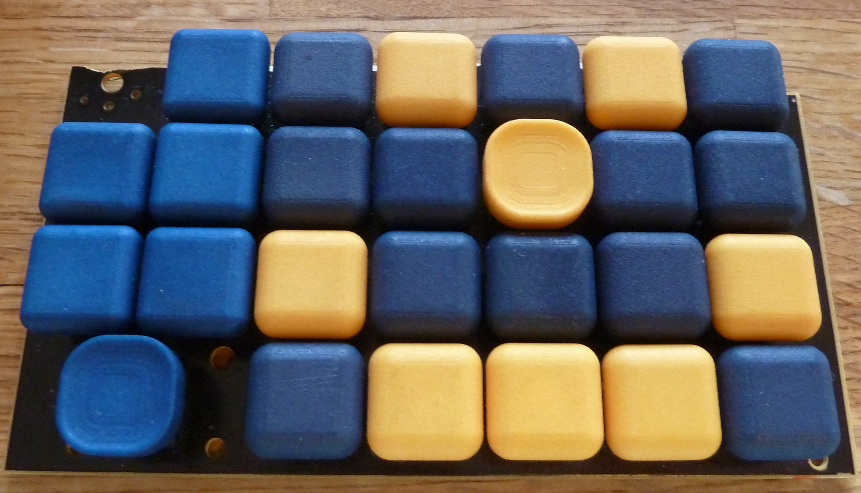

Colored keycaps make you
* SMILE *
* SMILE *
Would be looking better on a darker board, I'm sure, but the minimal height is nice - will try to convert my HyperNano with them on the weekend for further testing.
