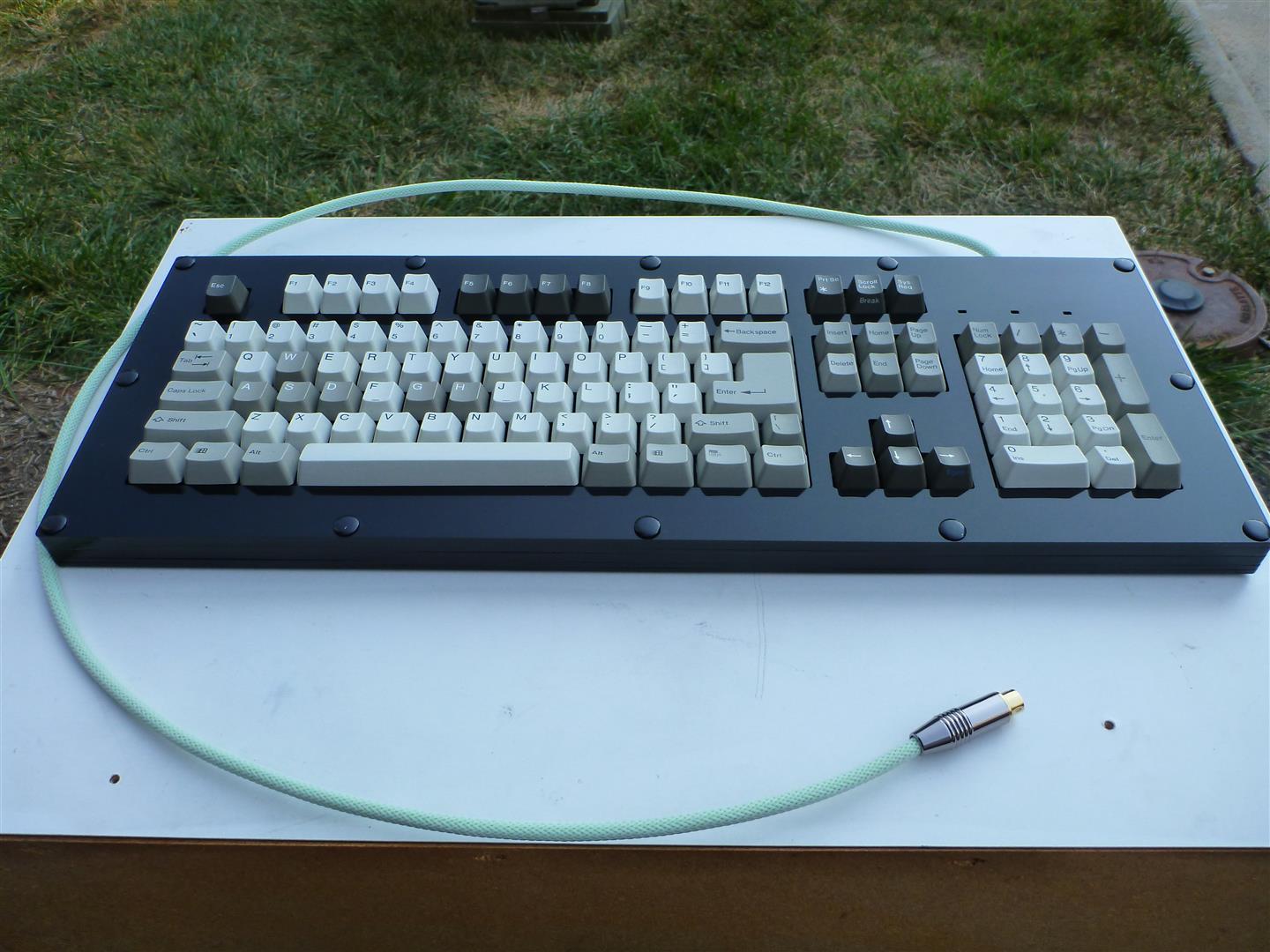

Are Matias switches backwards compatible with older Alps keyboards? Can I use these to mod a Focus FK-2001 to use quiet click switches?
10 Jan 2014, 15:01
Greystoke wrote:Are Matias switches backwards compatible with older Alps keyboards? Can I use these to mod a Focus FK-2001 to use quiet click switches?
AFAIK, they should be completely interchangeable. Pin-compatible, keycap-compatible and have same outer dimensions of the switch housing. I dunno if you could swap the top housing - but you can't always do that on vintage Alps either.
Because Alps switches can be opened from the top, you don't need to solder. You could open with tweezers and swap in the new slider, spring and click leaf. Opening would risk exposure to dust, though, and I find Alps to be a bit sensitive to that, but YMMV.
bhtooefr
10 Jan 2014, 16:55
As far as I know, no parts are interchangeable between Matias and Alps, but whole switches are fully interchangeable.
Greystoke
11 Jan 2014, 02:39
bhtooefr wrote:As far as I know, no parts are interchangeable between Matias and Alps, but whole switches are fully interchangeable.
Thanks for the info! I've got a couple of custom cases for Focus keyboards on the way, and donor parts from both a FK-2000 (9-key directional arrows - FTW!) and a FK-2001. I've built one so far, and it's pretty solid, but I think I'd like to try one with Matias quiet-click switches.
