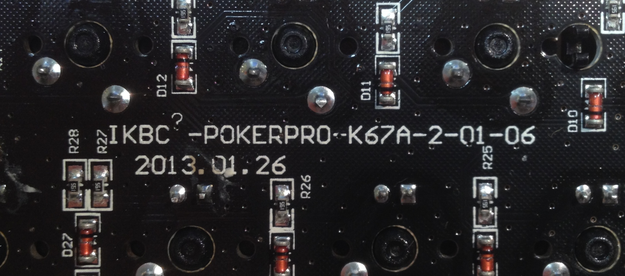

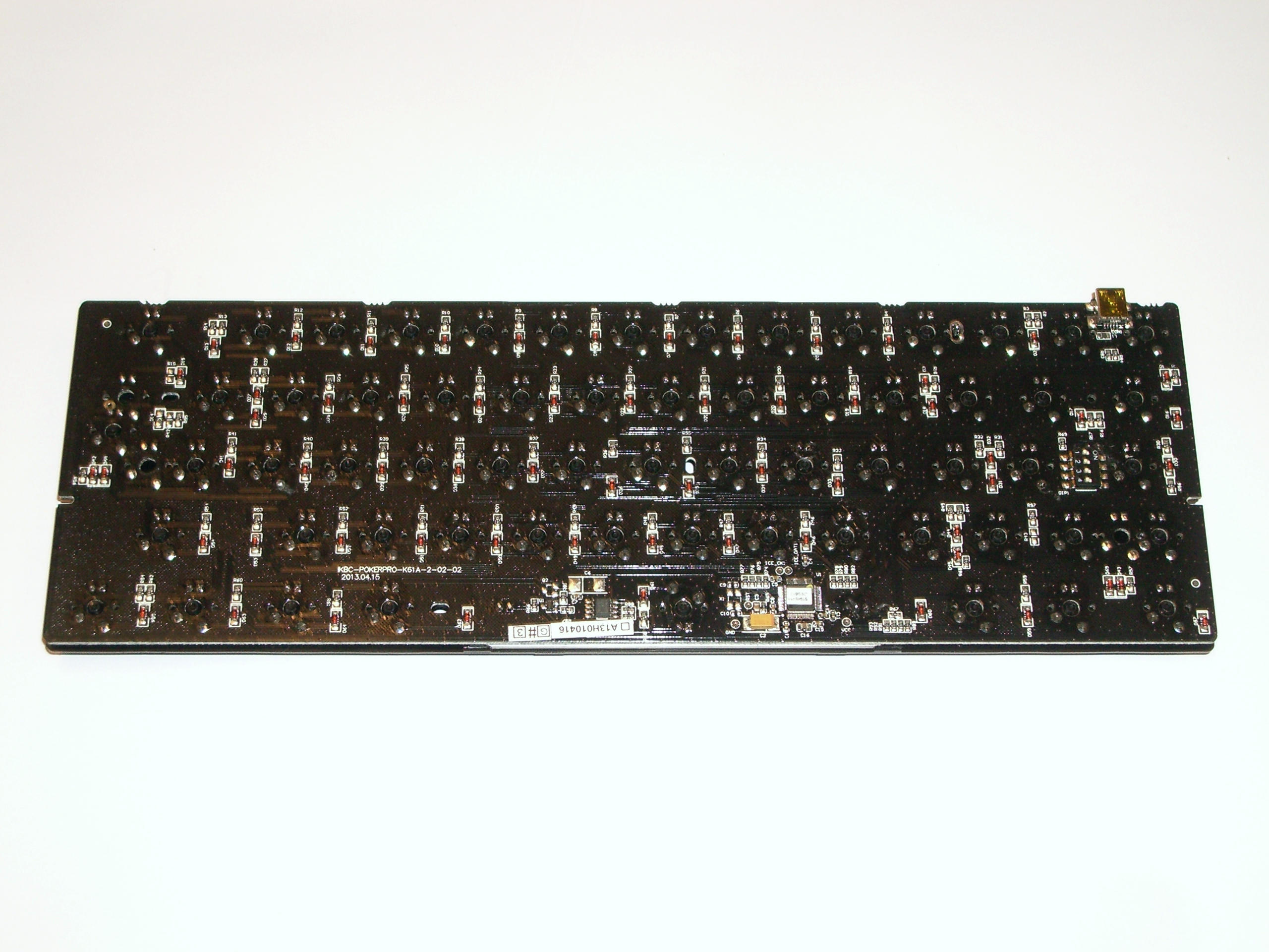

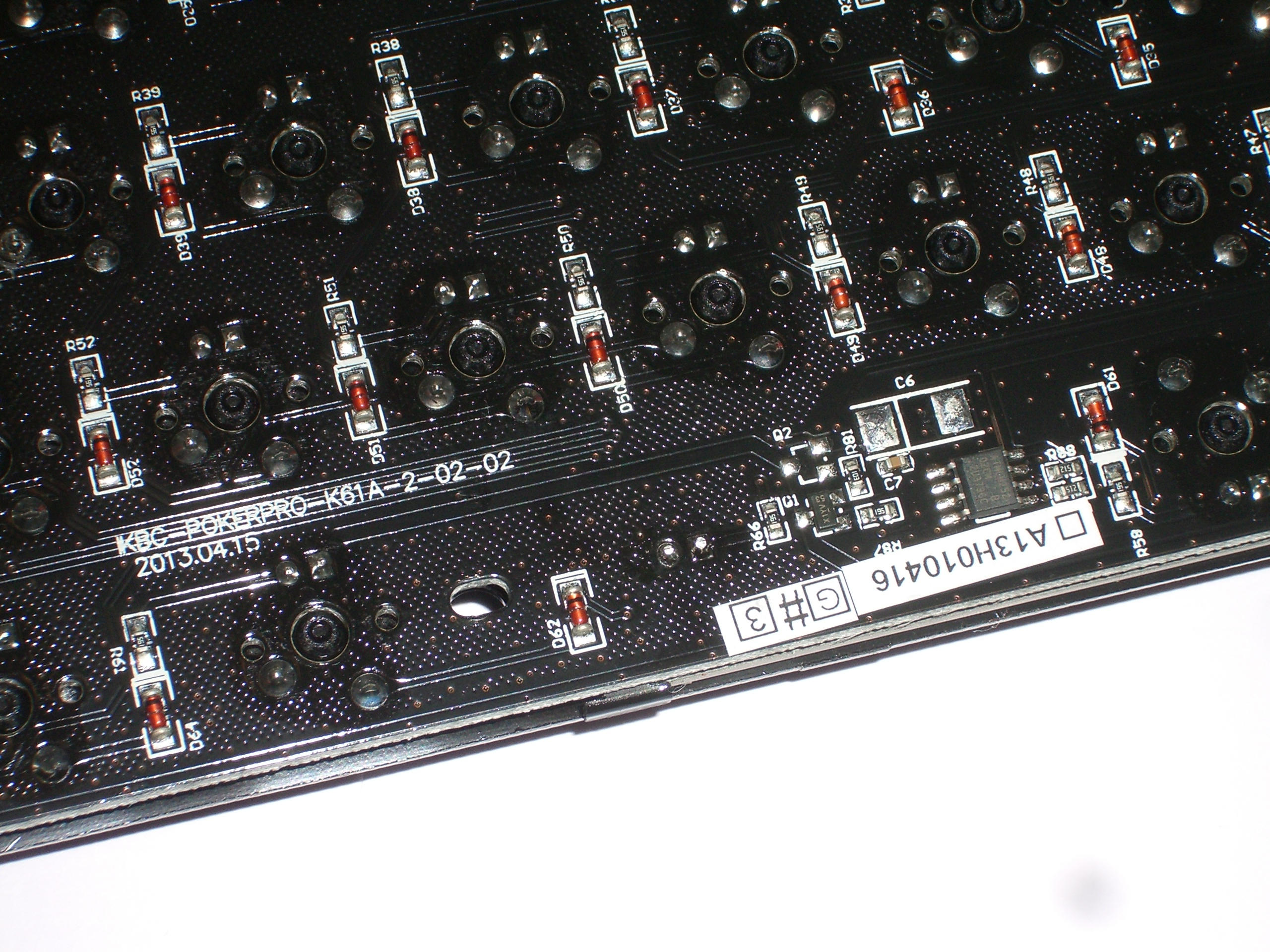

So, as I had some time ahead of me, I took a look at the PCB and not so surprisingly, it reads POKERPRO, as showed below:
date printed on the PCB of the KBT Pure Pro
KBT Pure Pro date.JPG (590.85 KiB) Viewed 14336 times
As on yours, there is a date printed on the board: 2013.01.26. Is this a design date or a manufacturing date; I have no idea. It is interesting to note though that even if the KBT Pure Pro is backlit, and Pn layer works as expected, the date on the board is anterior than the date on yours.

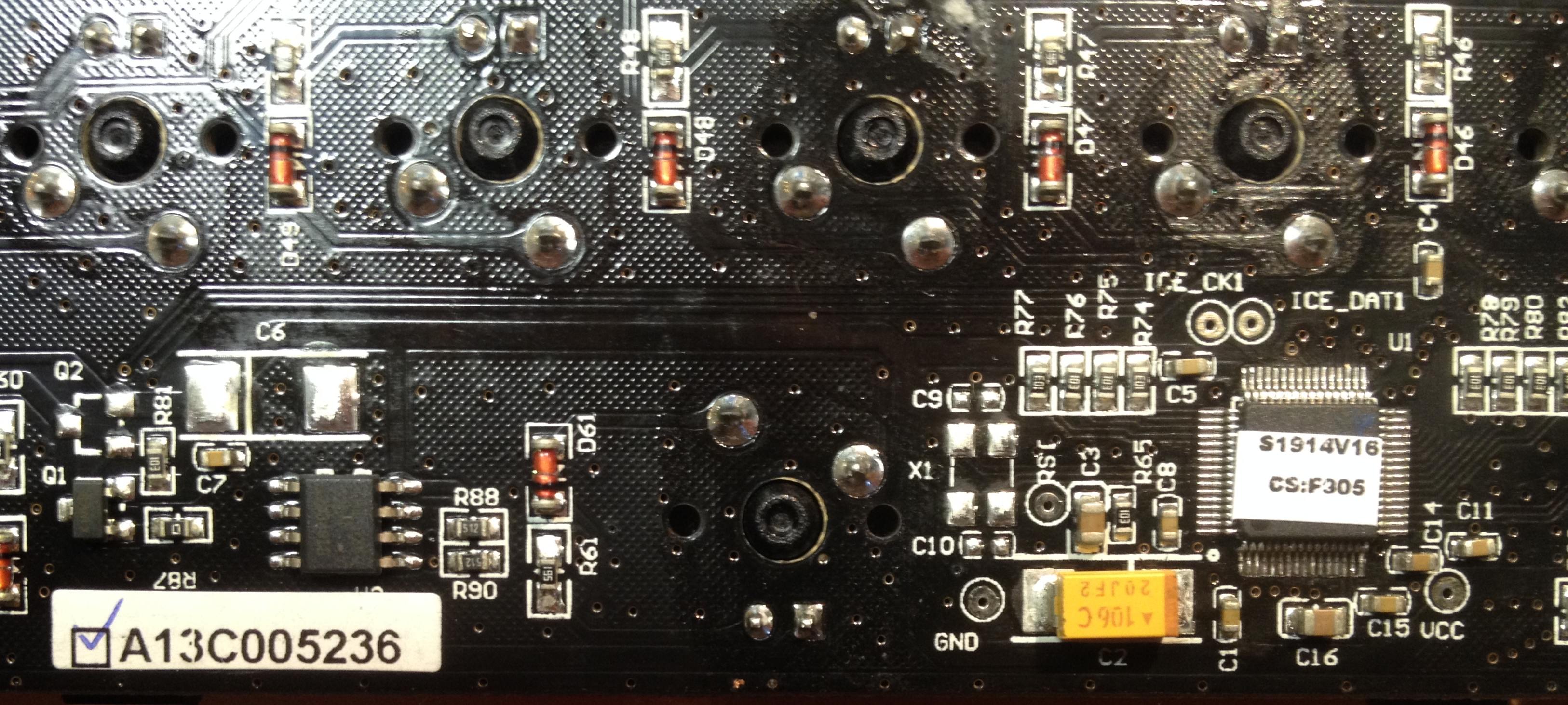

KBT Pure Pro PCB.JPG (939.76 KiB) Viewed 14336 times
Various labels on the PCB of the KBT Pure Pro
KBT Pure Pro PCB chip.jpg (665.19 KiB) Viewed 14336 times

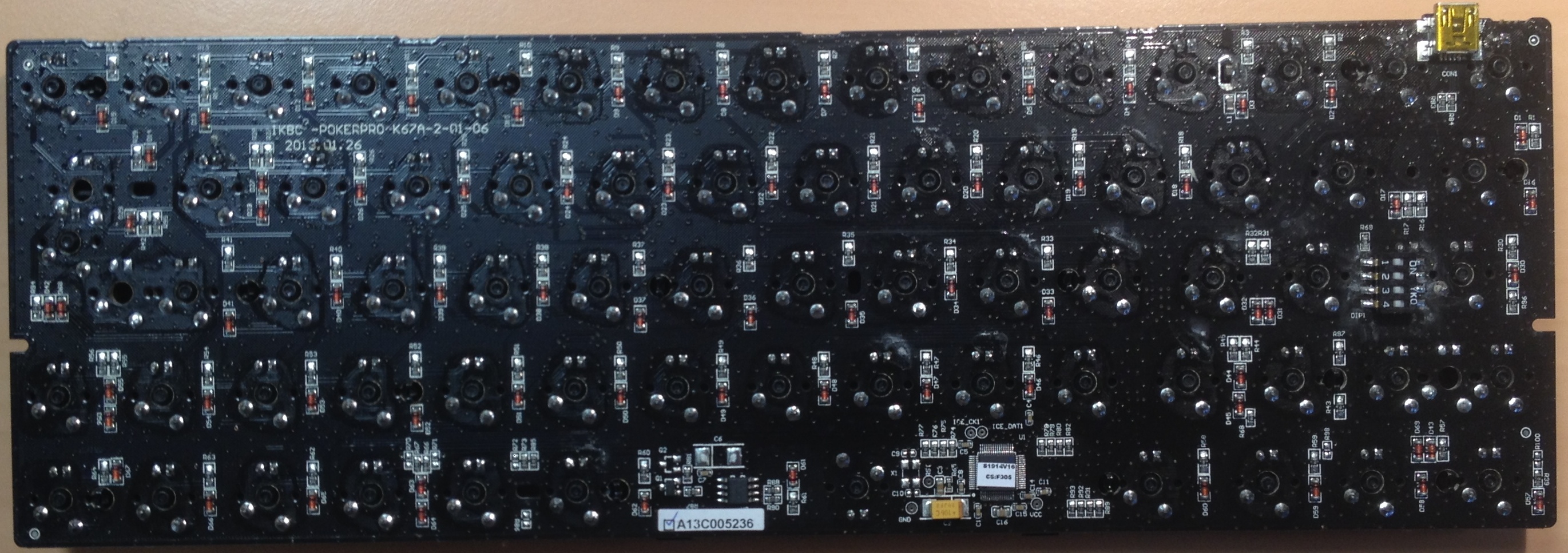

PCB
Lame photo of the Poker II PCB.jpg (473.09 KiB) Viewed 14313 times
Another lame photo of the Poker II PCB.jpg (823.6 KiB) Viewed 14313 times

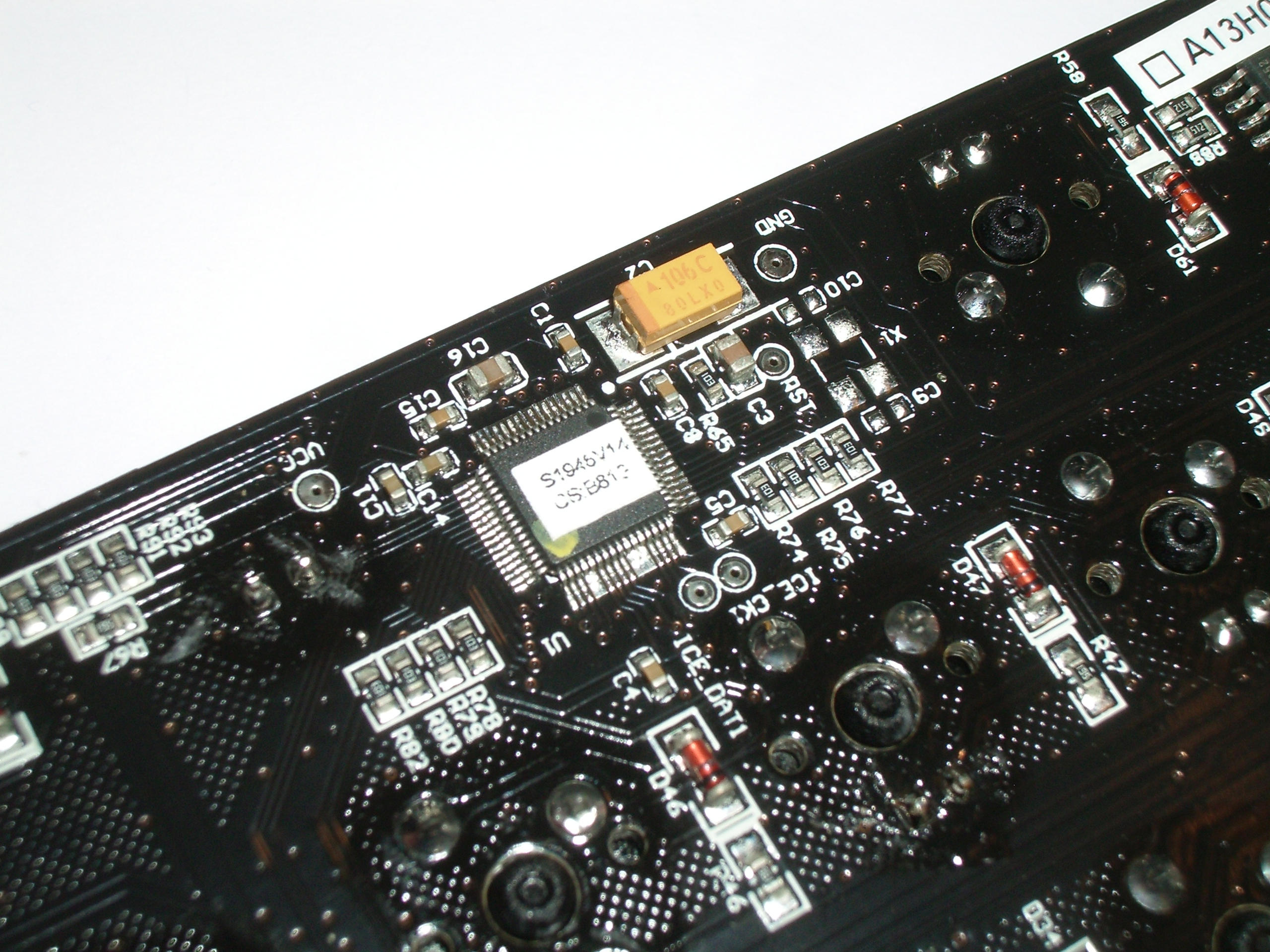

Controller
Poker II controller.jpg (657.63 KiB) Viewed 14313 times
Although the photo sucks, the writing on the controller chip's label really does have bits missing: that's not my camera doing that.

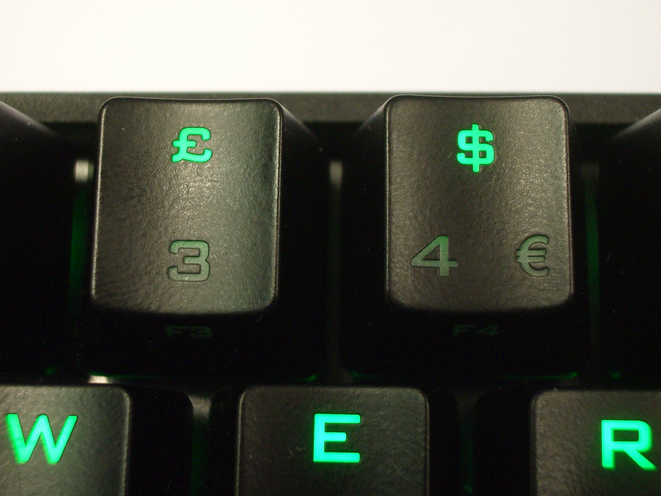

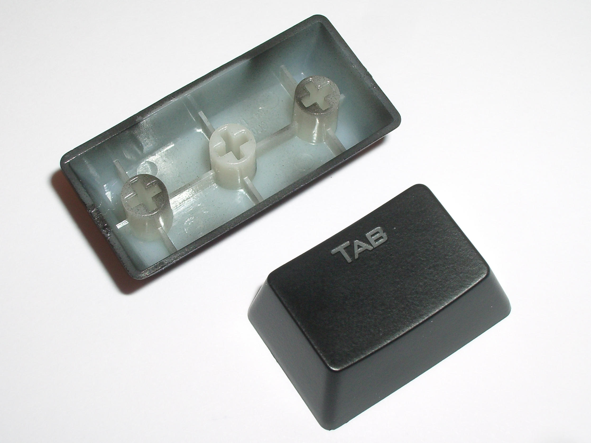

ABS painted backlit keycaps
A decent photograph of the Poker II ABS legends.jpg (417.99 KiB) Viewed 14313 times
Poker II keycaps.jpg (242.53 KiB) Viewed 14313 times

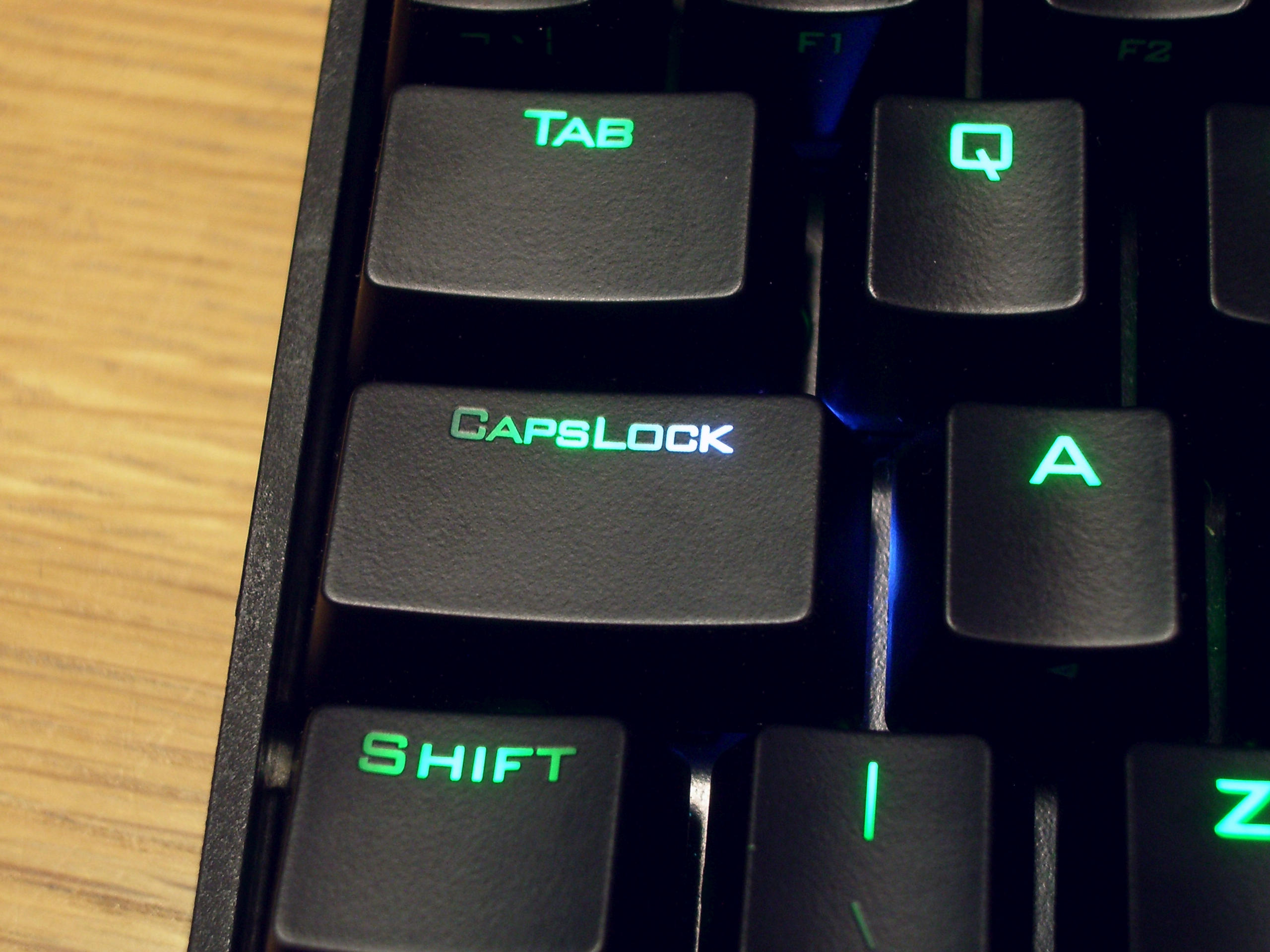

Edit: the Poker is starting to look like it has a bigger Vortex than Alps ......
http://deskthority.net/news-reviews-f4/ ... ml#p110129
The non-backlit version has no window for the Caps Lock. That particular backlit version has a Caps Lock LED window, even though the caps lock LED (situated next to the switch) shines through the keycap legend next to the backlight LED on backlit Poker IIs without the window:
Poker II with caps lock LED lit.jpg (454.63 KiB) Viewed 14313 times
It looks like they redesigned this thing with every batch!

The PCBs of my current Pure Pro and your Poker II look very similar indeed. The controller seems to be the same (well, same shape and nb of pins, that doesn't say much but you know), only the layout is different as the Pure Pro has a few more switches (arrow keys). Other than that, the painted ABS keys of the Pure pro look exactly the same as those of the Poker II's.
