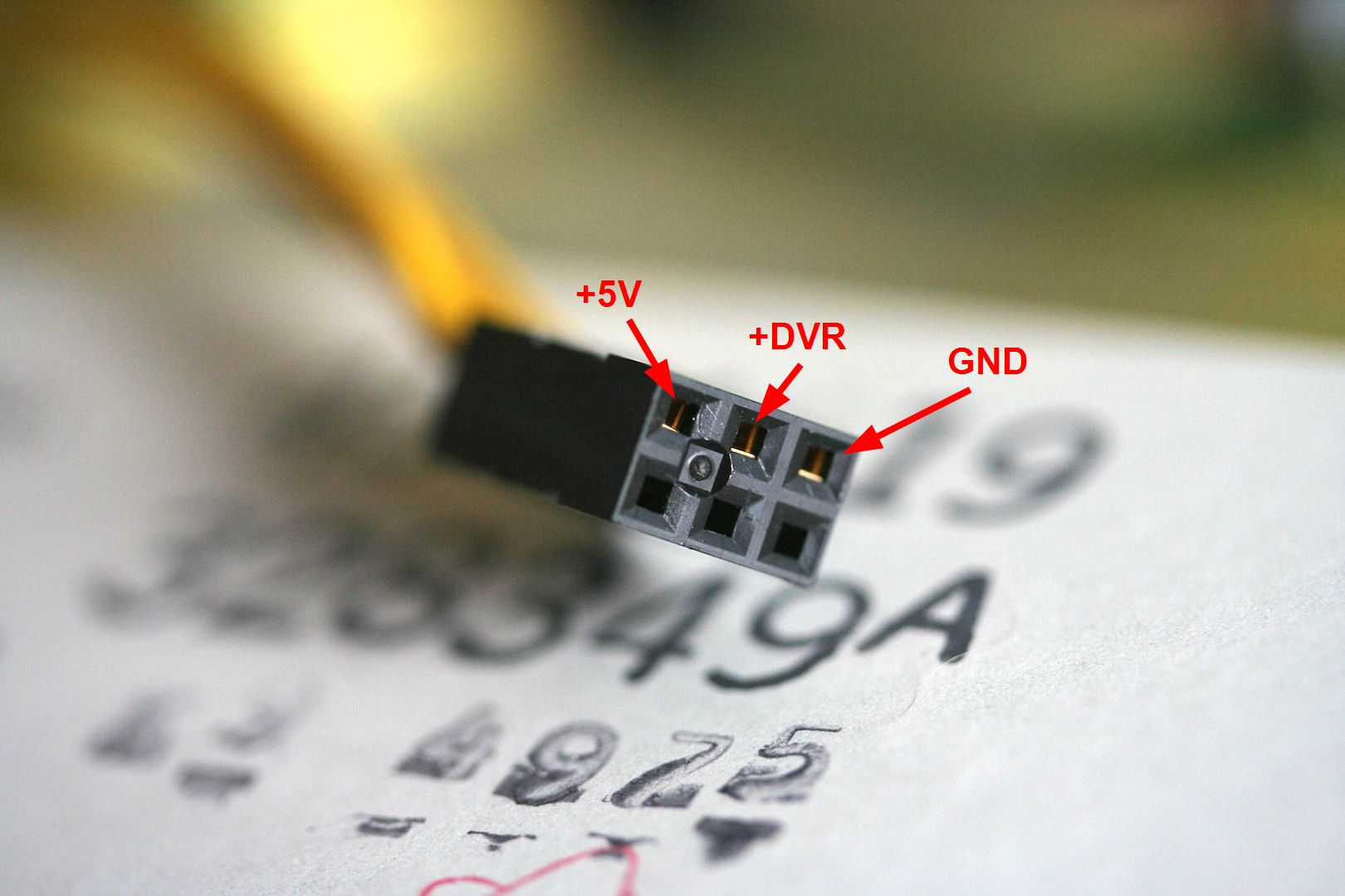

Thanks for tracing them through! Wonder what DVR stands for?

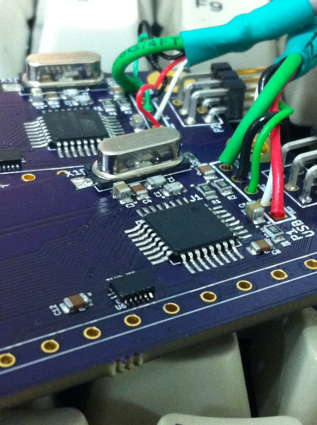

Nope it's not an ISP header; the boards use the ATmega32U2, so come from the factory preloaded with a DFU bootloader, so I've never bothered to put an ISP header on them.
The pinout I have is as follows:
So the problem is the +5V and GND need to be diagonally opposite. I don't want to risk using a GPIO as +5V or GND, as it may suck more current then the GPIO wants to source/sink. So I think a pin swap (move GND to the next row) on the connector is probably the easiest; those pins can normally be popped out of the sockets with a couple of jewellers screwdrivers or similar. Either that or bridge the GND pin on the controllers to the next row.
Layout:
2 4 6
1 3 5
1 = Vcc
2 = GPIO
3 = GPIO
4 = GPIO
5 = GPIO
6 = GND

it could be OVR - not sure. too small to know for sure.
i've never had a problem moving a pin or three. a good picture of where they need to go is all we need.

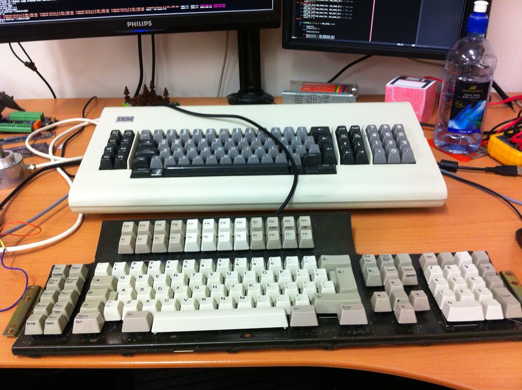

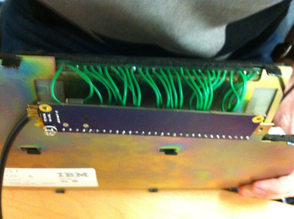

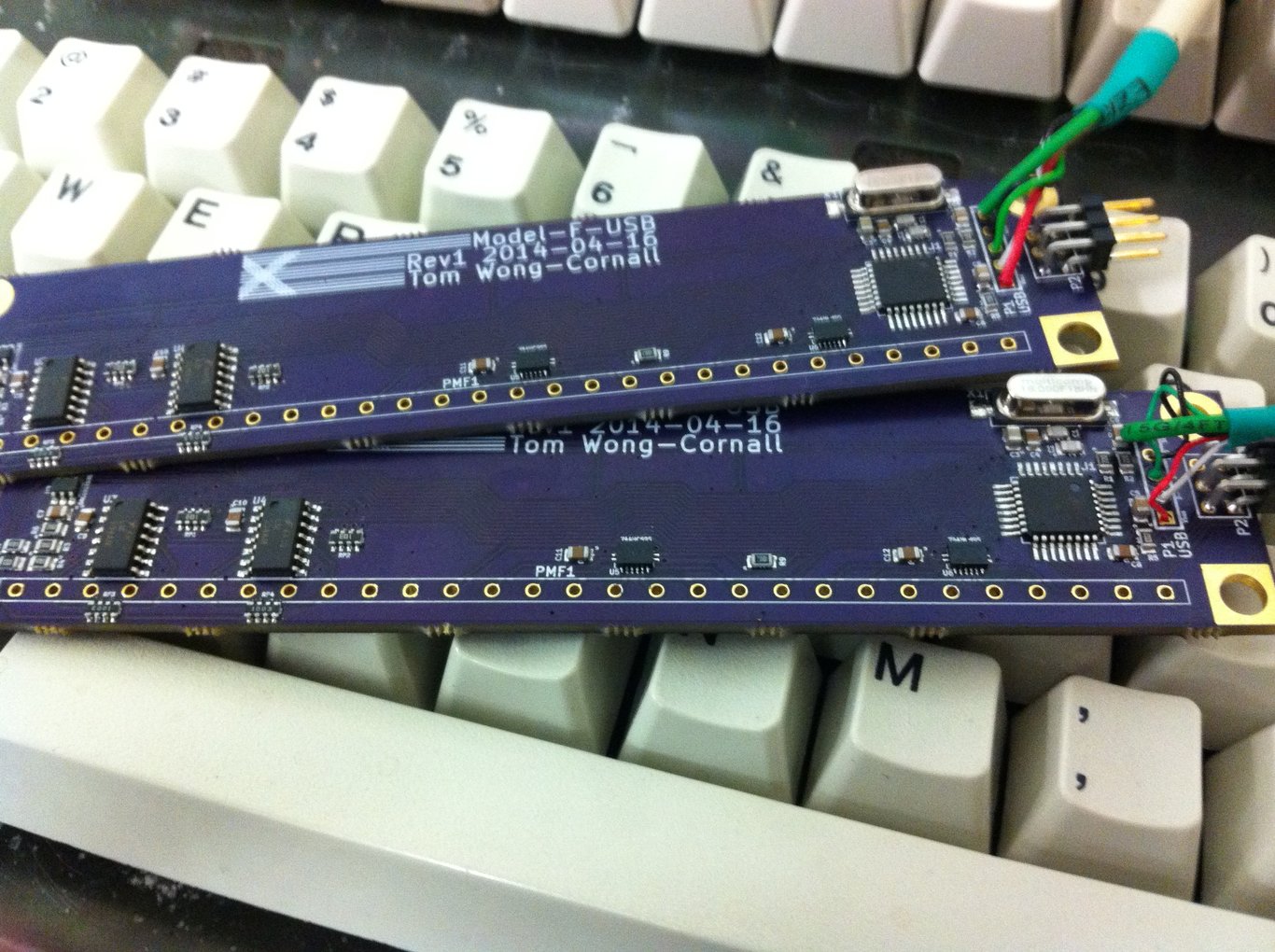

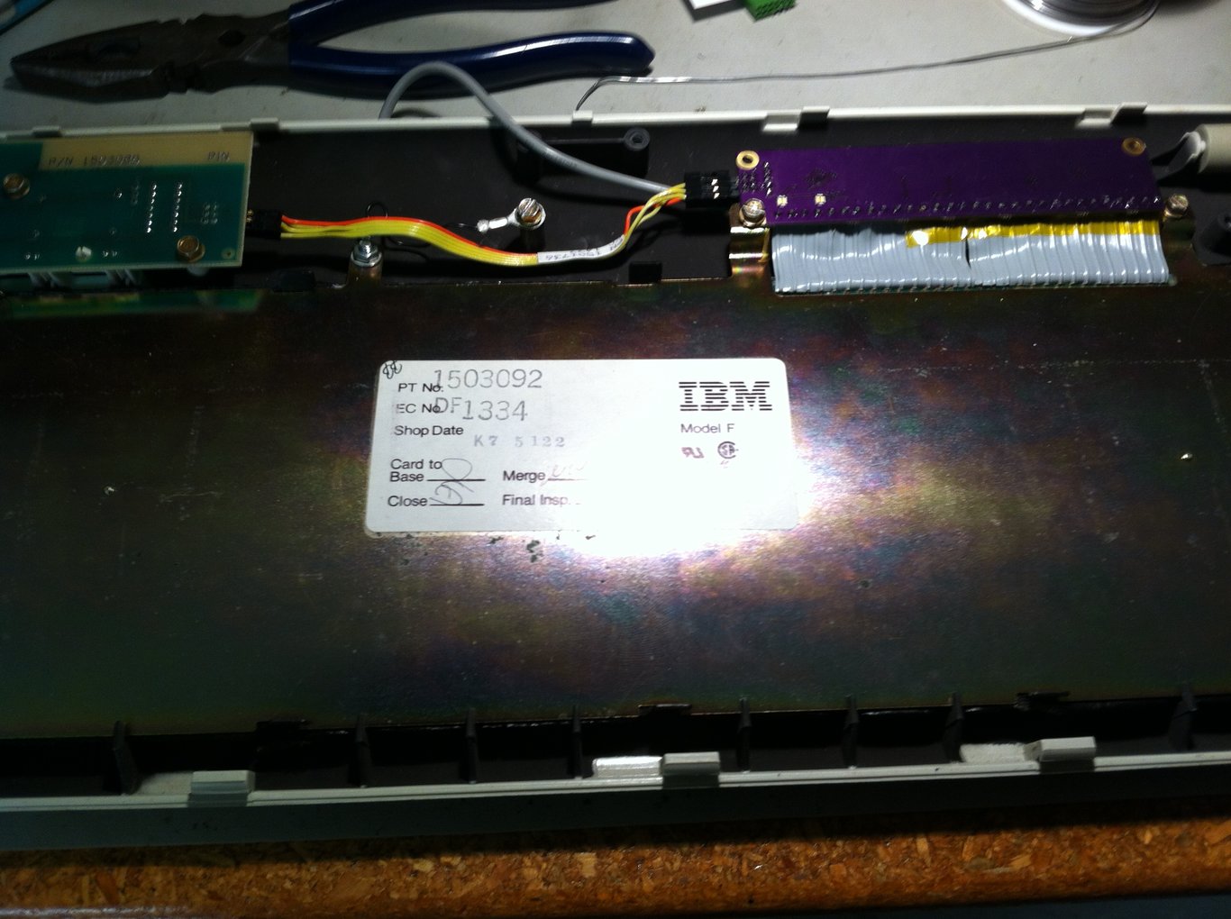

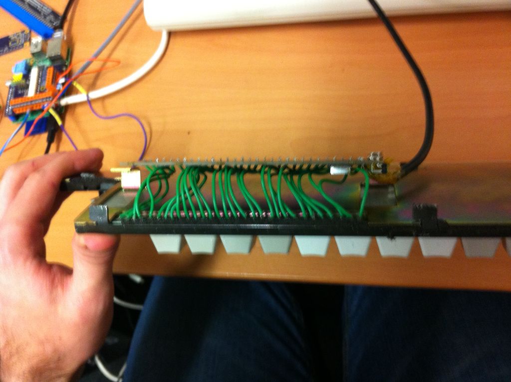

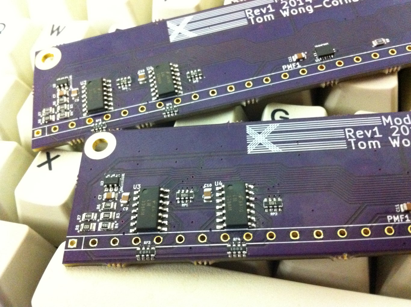

Well finally managed to find some time to add enough smarts to the software (util and firmware) to handle variable-sized keyboards of different sorts (everything was hard-coded before).
I soldered one up, then attached it to my 122-key terminal.
It works! (This post typed on it as proof

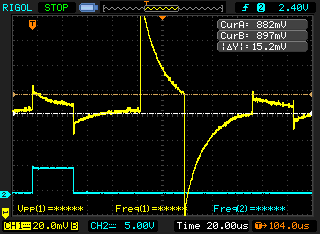

Pretty well too. There's a couple of tweaks to make, mostly resistor values; the key-capacitors don't drain fast enough after each pulse, I was getting situations where the key in the same column but next row was getting wiped out if both were pressed. I think this is down to a) my key-drain resistor divider being too high-impedence to drain a whole 8 rows as fast as 4 rows were draining, and b) the capacitance of each key is higher in the Model F compared to the beamspring, making it easier to sense. For now, to fix the problem, I've just increased a delay value inside the code to wait between pulsing each column; in the beamspring it was about 10us, for now it's closer to 50us. This means our 650Hz scan rate drops down to about 500Hz. I'll try tweaking the resistor values to see if I can get this back down.
The auto-calibrate part of the firmware needs to be fixed as well, as its logic is backwards for a Model F (pressed keys produce higher voltages than unpressed keys, the reverse of beamsprings).

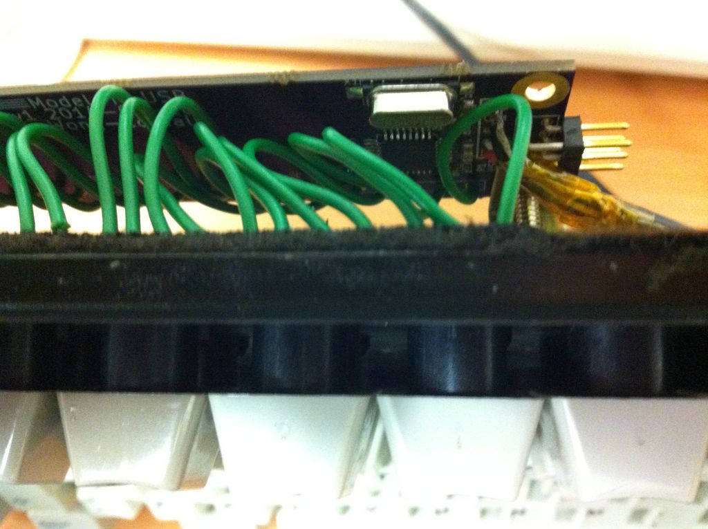

Here's a picture of a scan (don't worry about the blue line, that's just a single column being strobed): You can see the nice big jump when you hold a key down. Very easy to measure.

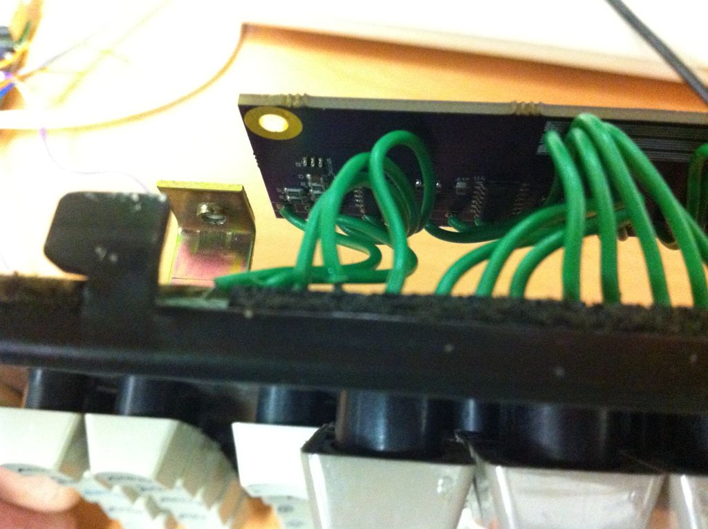

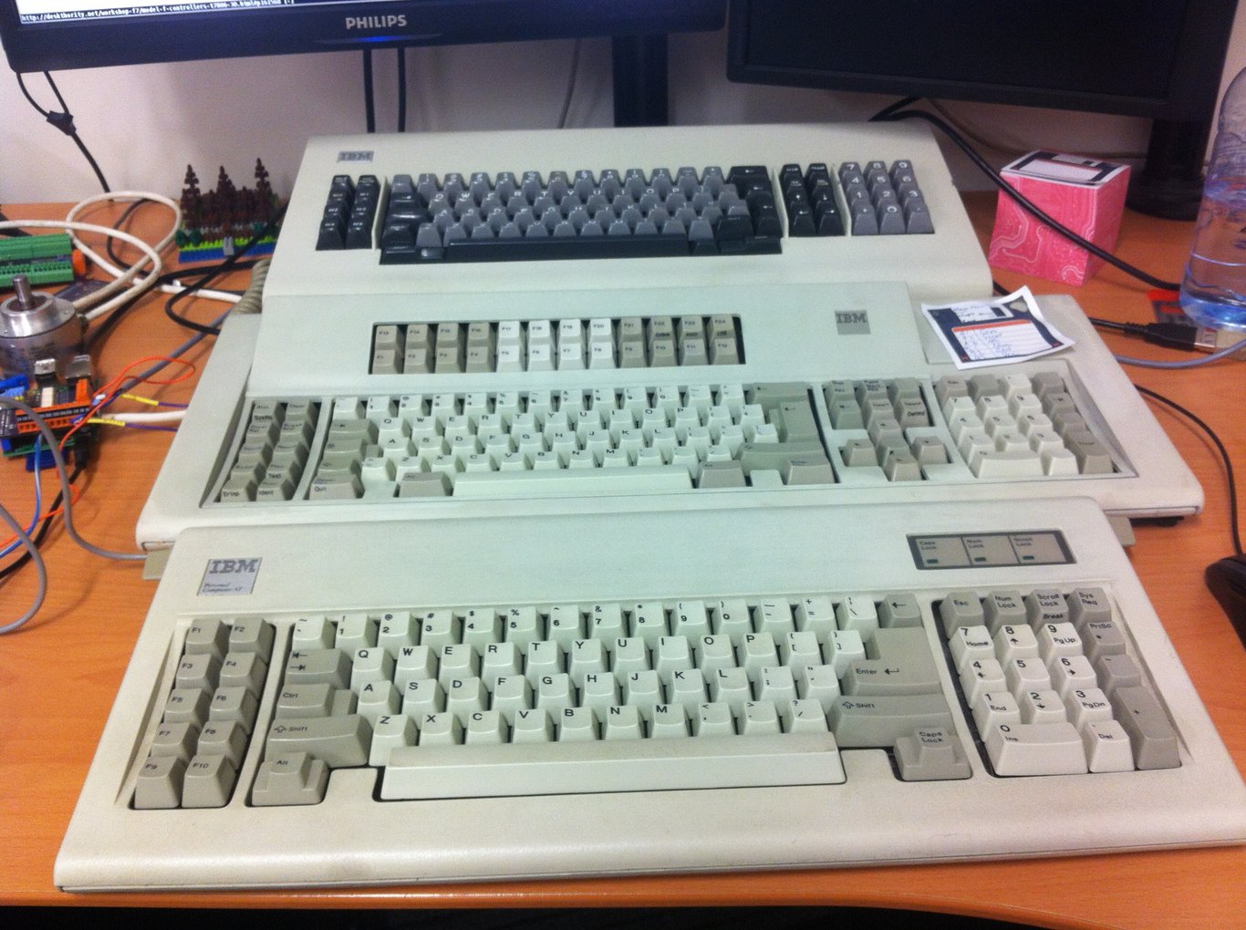

And some crap pics of it fitted to my 122-key terminal. Apologies for a) the green wires (long ago when I was first playing around with the board I accidentally snapped the brittle single-core ribbon cable) and b) the crap photos from my crap phone.
Looking at those pics now I'm surprised it works with all the crazy green wires everywhere. I suppose the Model F just has high enough thresholds (bigger capacitors) that it's much easier to sense.

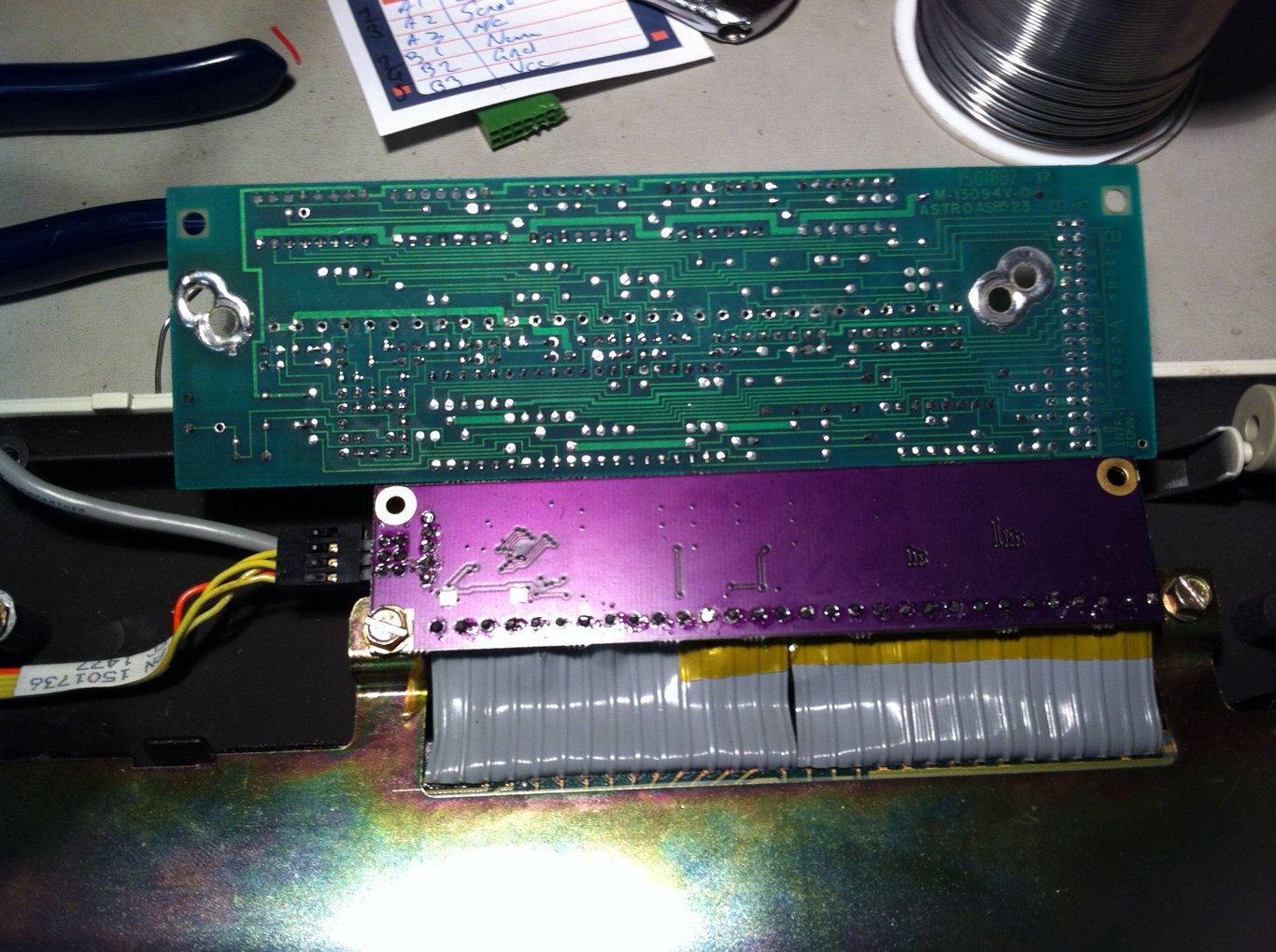

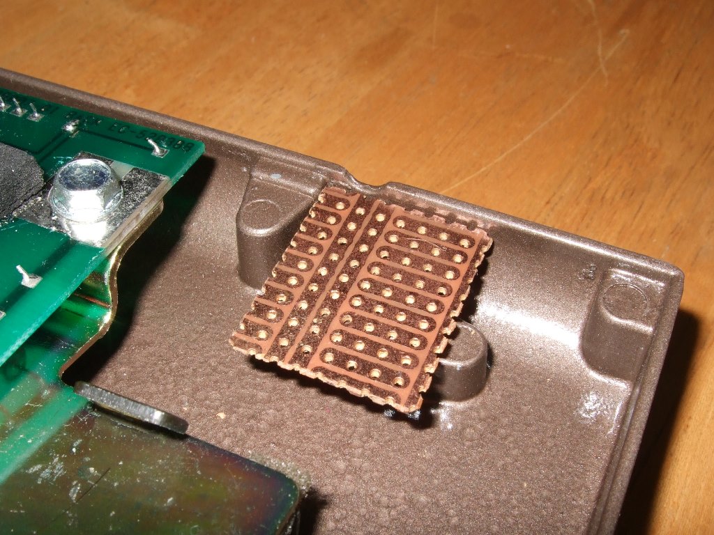

I've heard others curse the old ribbon cables too. It is difficult to find ribbon cable with .156" pitch. I might try to make some by sandwiching solid core between vinyl sheets and running that through a laminator. If it works well, I'll probably do another group give-away. What gauge wire do you think would work best?

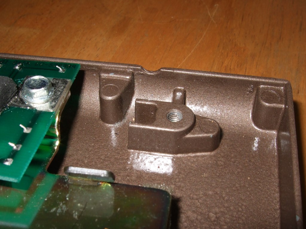

I have a couple microUSB sockets comming in the mail. Guess where i plan on putting it.

Ooh, that's a lovely hammered bronze/copper paint job on your Kishsaver, wcass.

I will use one or the other depending on how each fits (the first sits higher than the 2nd). I'm trying to reduce or eliminate trimming the case. I ordered from Mouser.Muirium wrote:Micro USB sockets? Got a link? I was looking for those literally this afternoon for another project!
And it's not half bad an idea for a Kishy, either…
http://www.mouser.com/ProductDetail/TE- ... oZwQ%3d%3d
http://www.mouser.com/ProductDetail/FCI ... 8XVWvEtwKs

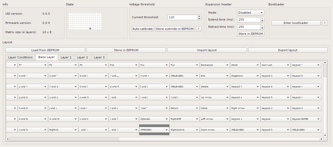

Yes I might need to add another knob to the GUI util to control it. Either that or have multiple hex files/binaries for Kishsavers and everything else—I already do this through the makefile for the beamsprings boards and others (it's all one codebase for me).

Fancy GUI
Yeah, I want an arbitrary number of layers with fallthrough capability (so you can do things like switch Capslock and Ctrl). I support a lot more keyboards, so I also want things like combining keymaps to make a Colemak layout for multiple keyboards (without having to redefine it for each new keyboard I support).

Fancy GUI

Fancy GUI
Not sure I'll do EEPROM saving though, might not have enough space for the tables I want to include.
I've got four layers at the moment (base plus three remaps). With a 16x8 (128 nodes) matrix and 1-byte scancodes, this means half of my ATmega32U2's EEPROM is used on the mappings, and there's a few more bytes here and there for storing the voltage reference, expansion port modes, layer entry conditions etc. I imagine I'll have a healthy amount of EEPROM leftover for macro support once that's added. What else were you thinking of putting in the EEPROM? I assume you have a whole 1K to play with as well.

Sorted out the autocalibration as well. Really confused myself with active-low and active-high terminology; the LM339 has open-collector N-channel outputs, so the row inputs to the µC are the opposite of what the keyboard is (Model F→active high, Beamspring→active low) ... d'oh!
Getting used to typing on the Model F, it's nice having so many F-keys and a proper numpad, but still miss the sound and feel of the 3727 Beamspring with the solenoid firing

dfj has found that some boards do drift, probably due to the diodes/voltage refs (temperature).
Our design has a min expected increase threshold vs. the unpressed sense value per key. So far this has worked well for the Model F boards tested (Unsaver, Kishsaver, 50 key, 122).

xwhatsit
- Location: NZ
- Main keyboard: IBM 3727 beamspring (converted to USB)
- Main mouse: What's a mouse for?
- Favorite switch: Beamspring
Ah right; dfj's controller probably drifts due to all of the diodes and stuff like op-amps, which wouldn't be particularly temperature-stable. The capacitance itself changes very little, so the LM339A comparators which I use for thresholding (which have massive gain, being comparators and aren't really subject to temperature drift) keep giving the same results, more or less. The DAC I'm using (DAC101S101) is pretty stable too. The key-drain resistor divider might change a bit, but that's not critical so doesn't really affect things if it did (it already flails about wildly as keys are strobed).
I can see the analogue stuff might be a bit painful to stuff into 1K! Sounds very cool. I was just going to aim for equivalence with Soarer's converter in terms of macros; I'll be very excited to see what you produce!

Now fitted inside my PC-AT (typing on it now, man I need to fix that heavy spacebar, it's ridiculous).
Holy balls, never ever want to desolder/solder one of those ribbon cables again. Need to find a better method for testing these when I start making them for other people. Who ever EVER thought through-hole technology was a good idea?! IBM had already used surface-mount in the 60s (with the Apollo landing guidance computer), why didn't they stick with a good thing!
Melted the ribbon cable a bit, hence the kapton tape (just in case): Close-up showing comparison with old controller, and pin-swapped ribbon cable connector for LEDs (they work by the way; quite amusing to tell the expansion header that it's to operate in "Beamspring Solenoid" mode and watch the Caps-Lock LED blink away for every keypress): Oh yeah and my current desk. All running off USB with ibm-capsense-usb controllers of some description (that's my new name for the project, can't call it "beamspring-usb-5251" anymore—maybe I should set up a combined thread once I hit v1.0). I didn't bring the other beamspring (5251) in from the next room, as my desk is rather full.

All the best riddles are written on floppy disk. The curved indent on the active note looks suspiciously like the footprint of a drinking glass!
In any case, have a good one, Xwhatsit. Your controllers look beautiful and I'm right chuffed to be putting one to the Kishsaver test! Cheers!
Now, about that software… (Is this the latest version? Ditto for the graphical utility? I'm on OS X…)

My coaster is actually a proper floppy disk. There's piles of the things at work; down here in the antipodes we only recently got CD-ROMs of course.
The GUI util is still under a bit of development, finished adding the column-skip feature to avoid shorts on things like Kishsavers (my boards unfortunately cannot autodetect which columns are live and dead, as I use serial-to-parallel shift registers for my column drives, instead of GPIO, so I can't set them as inputs with pullups to check). Also need to add the extra stuff (expansion port, column skips) to the import/export file format.
Should be done in the next day or two, then I'll round up a Windows machine and a Mac OS X machine and get the utils compiled for a proper release.
Murium's controller is on its way, hopefully in two or three weeks we'll know if it mounts OK inside a Kishsaver
