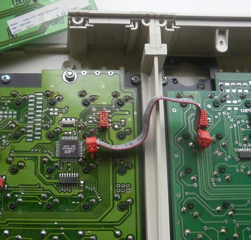

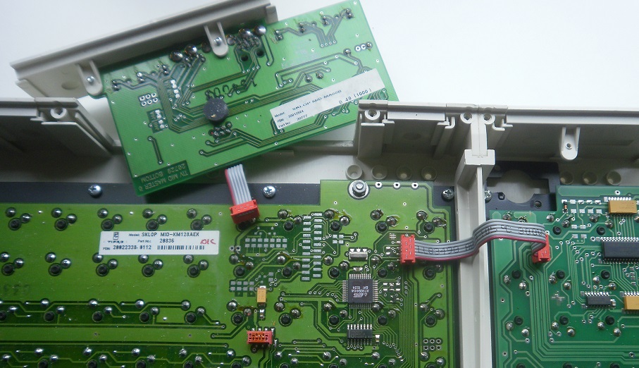

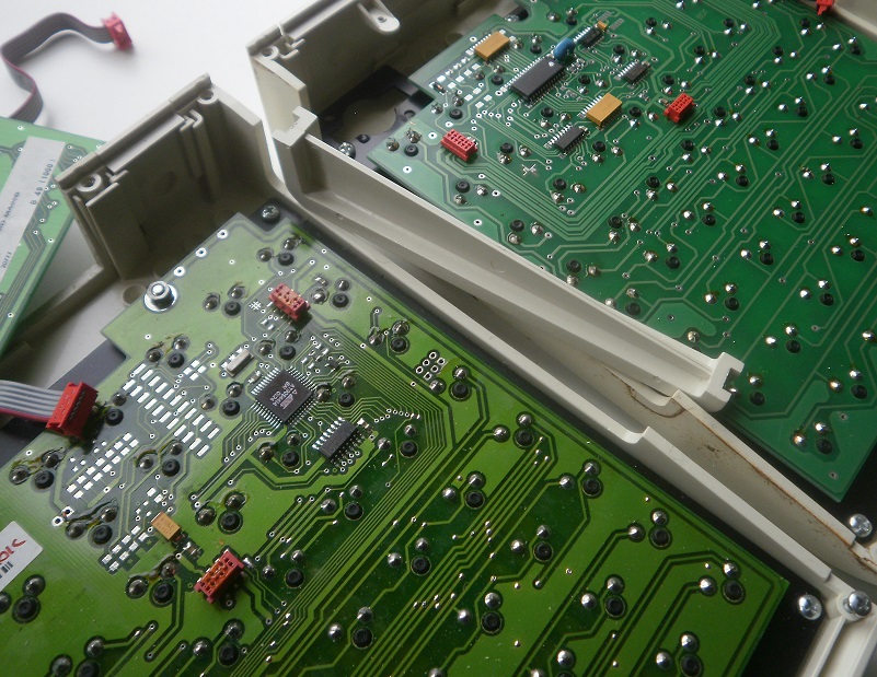

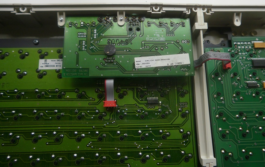

And now to help you to understand how Tipro MID keyboards are connected
(I reckon I could and surely should have fed the wiki, but well...)
here some photos:
Tipro MID innards 01.jpg (197.9 KiB) Viewed 7905 times
Two Tipro MID units connected together. The additional PCB in the left unit is the controller.

Controller removed, its connection to the PCB was the small red square socket at the bottom of the pic. The ribbon cable between both units is their internal connection. When they are connected, the Tipro ChangeMe software will identify them together as one keyboard.
Tipro MID innards 03.jpg (120.49 KiB) Viewed 7905 times
Connection cable removed, showing the "Tipro bus" with which both keyboards were connected. Tipro keyboard PCBs have such a "Tipro bus" socket on each side, allowing it to build virtually endless keyboards (I think I read somewhere about twelve as a maximum, maximum I tested was five).
Tipro MID innards 04.jpg (246.48 KiB) Viewed 7905 times
The plastic "joiner" with which units are physically put together (leaving just enough room for the ribbon cable when the bottom plate is in place). It fits exactly where the plastic side covers of both keyboards have been removed.
And please, please: read posts at least twice and make sure to understand what is said before asking new questions.

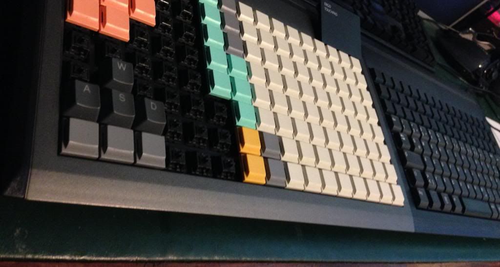

I just opened the 2012 tipro TMC FREE it is so nice. I don't think I can change. Picture to come
I've connected them and I think this looks awesome. I swapped the gray bezel for the black on the near side and I might try the grey for the black on the far side too! I'm not going to get another board now. If I get anything it'll just be one or two 8x4 for either side. Image
time to go key shopping :mrgreen:

doing a similar thing as jond keyhack but I want to keep it modular and daisy chain them so I can chose which keyboards I want to use .
may set two or three up

Cool stuff. I'm ordering a soldering iron now aswell to remove the beeper and I may get the old staggered TMC from ebay so I can test out different switches later. Blacks with o rings are much better than just blacks. I think the enter and shift buttons are a little hard to press so I'm after a solution to that in the same way that kbdfr did his/hers

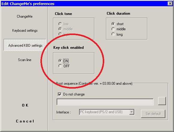

as for the beeper you can switch it off in the software "I think"
jond_keyhack
13 Jun 2014, 19:51
collector of junk wrote: as for the beeper you can switch it off in the software "I think"
It doesn't allow it for pre=programmed keys/
13 Jun 2014, 20:26
ChangeMe key click.jpg (56.82 KiB) Viewed 7471 times
Now guess what you could do...
