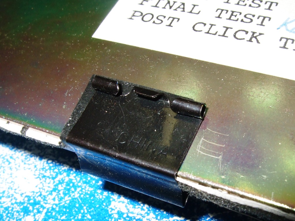

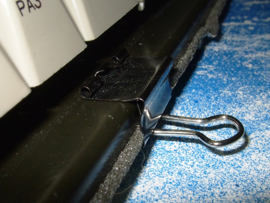

wcass
22 May 2014, 17:36
I've also used standard office supply binder clips. If you try it, cover the "teeth" with electrical tape so it doesn't scratch your plates.

Something you might try ... remember those binder clips I brought up a while ago? Look for the 3/4" wide, 3/8" thick ones. Put an inch long strip of electrical tape into the "mouth" of the clip so that it goes as deep into the corners as you can get it. The tape should be just inside the clip on all sides. Clip this over front and back plates; it should be a tight fit, so why not leave it on? The silver metal "handles" can be removed by squeezing each handle perpendicular to how you would normally squeeze the two together. You can use this to supplement the sliding notches or in place of a malfunctioning one.
My XTant project will be using just two bolts (under the "home row") and 8 or 10 of these clips.
