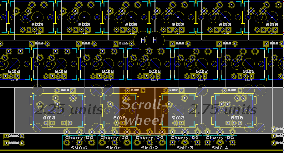

19.05-3.3*2 = 12.45 mm.
This should be enough to fit between 2 switches in a 1 unit gap!

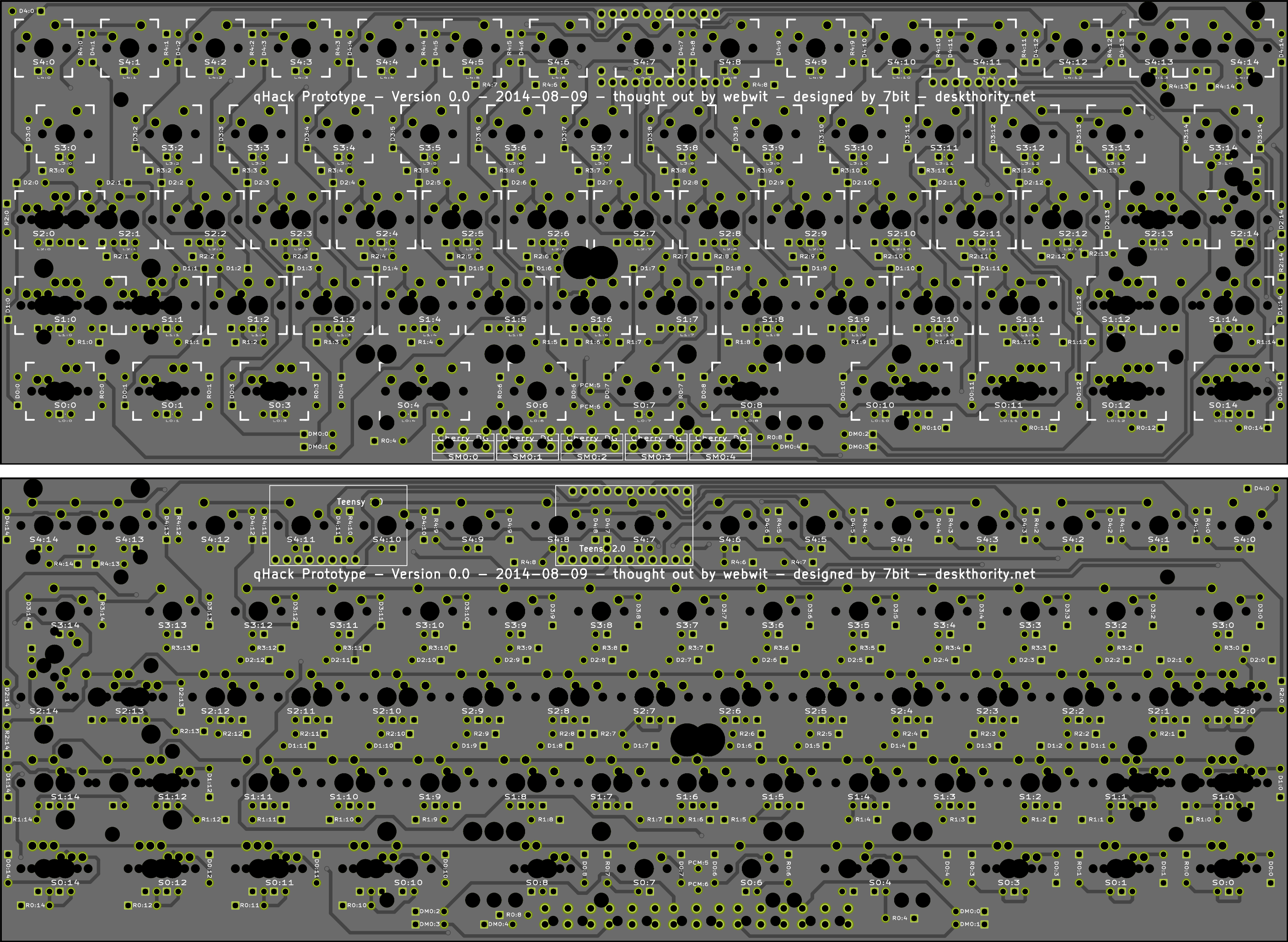

Here is what I have with still the Cherry DG switches:
The upper-row of solderpads are for sideways mounting, so buttons are pushed from the front, and the lower-row is for upright mounting (pushed from top). The later can be moved up a little bit.

I've added 2 pads for the scroll-wheel encoder.
I've got 4 pads at the keyboard-Teensy left for indicator LEDs.
One goes to the normal Caps Lock position (left of ASDFG) and another one to the leftmost bottom row modifier. I plan to add an LED to the top right key and another to the bottom right.
Any other position would have to be hand-wired.

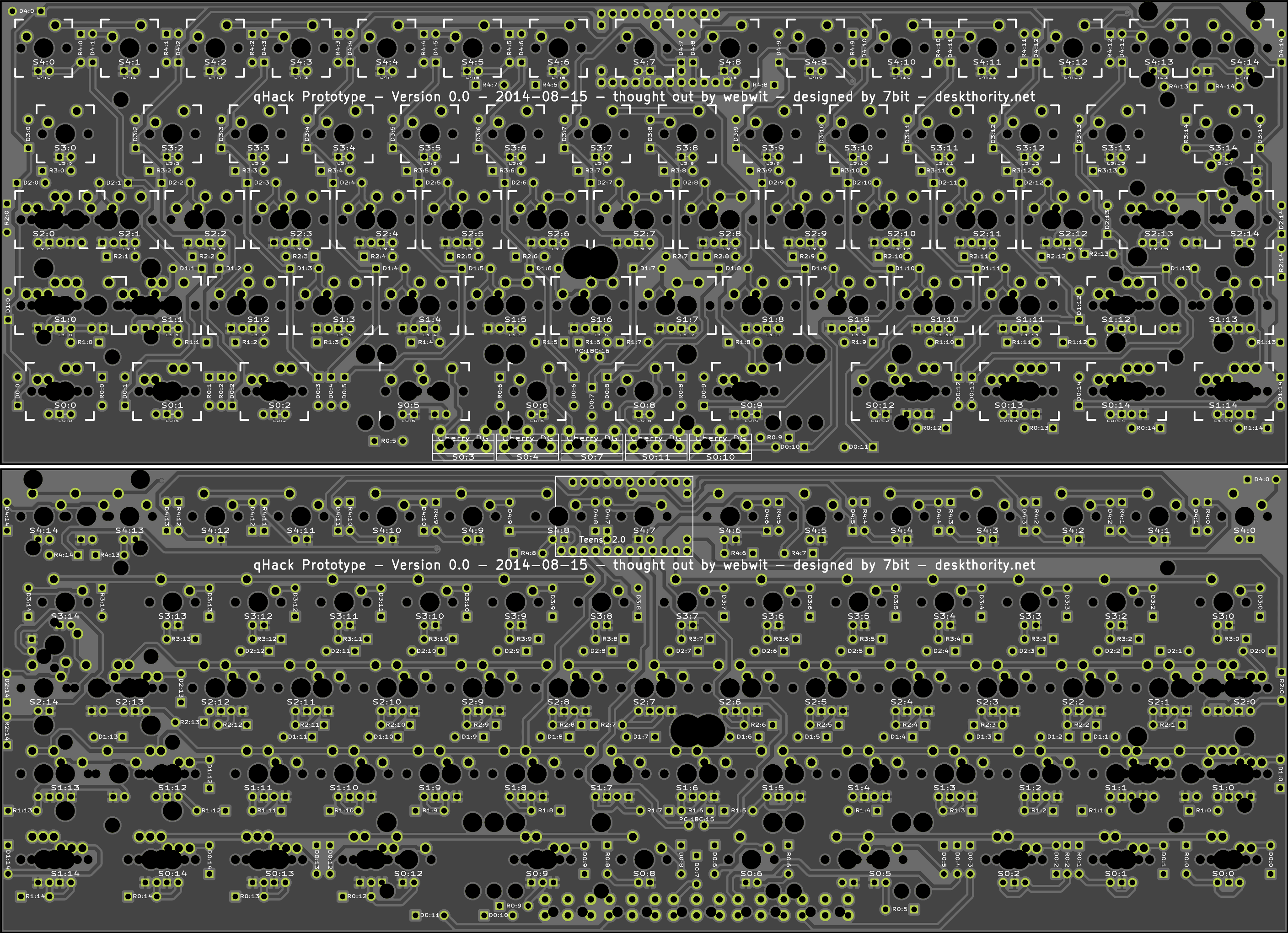

16 Aug 2014, 14:44
Version with only one controller:

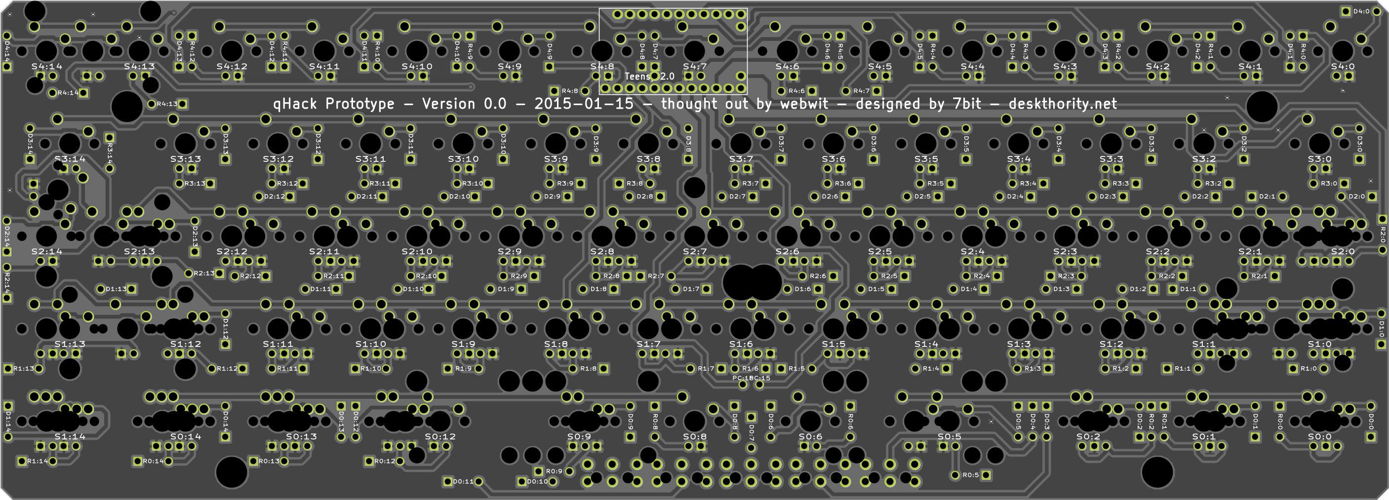

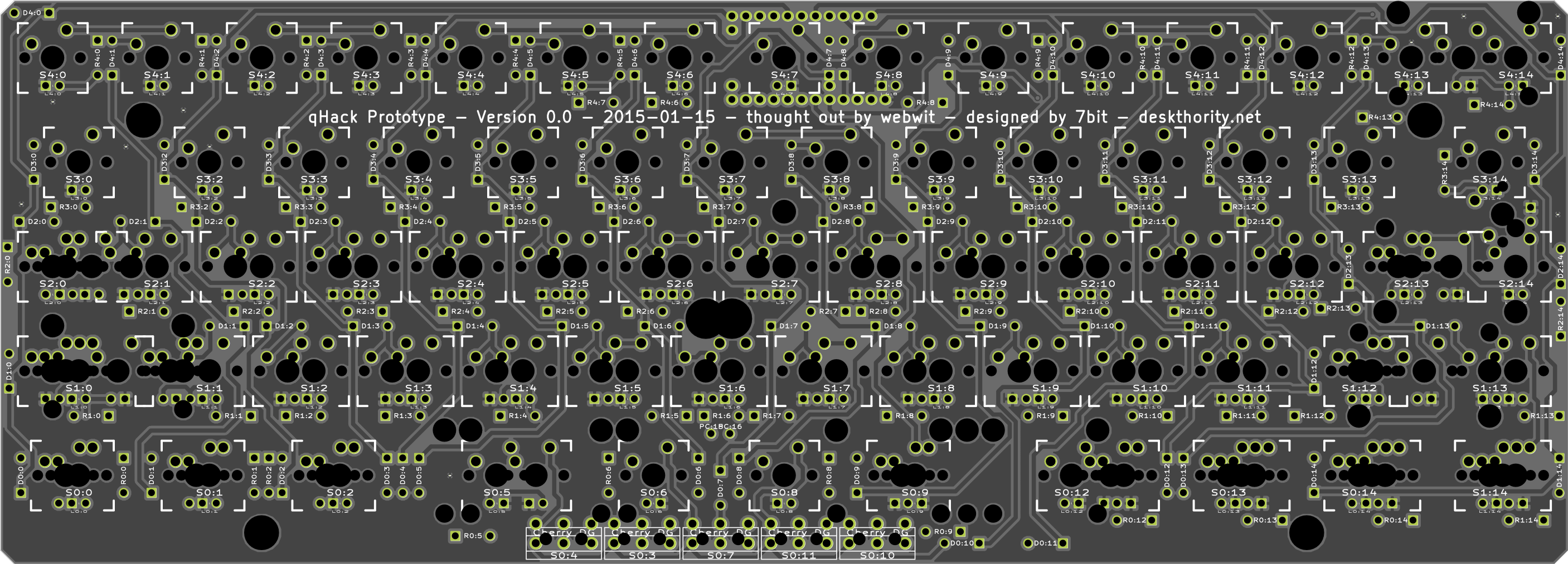

15 Jan 2015, 22:14
The latest version:
:ugeek: Image
