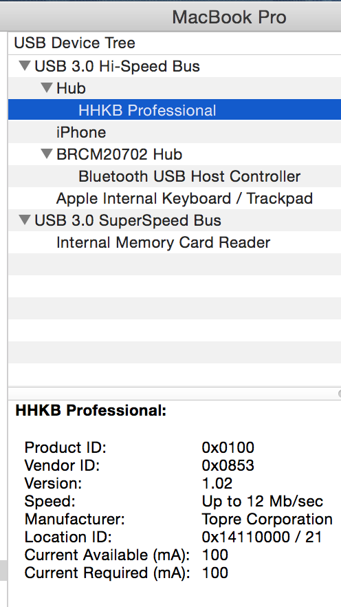

30 Jun 2015, 20:17
Ah, slippery old USB. Here's what I'm on about:
USB Chart.png (102.96 KiB) Viewed 7951 times
Mac OS X includes a System Info utility that, among other things, can enumerate the USB devices on your system. Here's my USB 3 equipped laptop running with an iPhone 4S in one port and my HHKB in the other. The iPhone is connected at USB 2 speed (480 Mb/sec) while the HHKB is all the way down at 12 Mb/sec. It's far from the only keyboard I've seen down at USB 1.1 (or even 1.0?) speeds. Most do that. The system can supply a lot more bandwidth, but most keyboards negotiate for a slower connection just like this. Including the MacBook Pro's own integrated (but USB native) keyboard!

Ah... What you are talking about *is* Full Speed on that HHKB, Muirium.
The spec has the following speeds:
Low Speed (1.5 mbit/s) -> Full Speed (12 mbit/s) -> High Speed (480 mbit/s) -> Super Speed(5gbit/s)
It gets more confusing when you see that both Low and Full Speed were part of USB 1.0, but there are a lot of USB 2.0 devices out there that are actually only Full Speed - USB2 devices have to be marked as a 'USB 2.0 High Speed' controller in order to actually support the 480mbit data rate. If it doesn't explicitly state it, it's Full Speed despite being a USB2 device. As a result, 'Full Speed' sits in a funny spot where technically it is USB1.0 but in practical terms it really sits in both USB1.0 and USB2.0.

Sorry, apparently I had it wrong as well. I didn't realise that full speed (12) was allowed also within USB 1.1 specification. TIL that 500mA is also allowed in 1.1.
It looks like keyboards invariably use at most full-speed (12). [The korean boards can actually only do low-speed, i.e. 1.5Mb/s - still plenty enough for a keyboard though.]
This is largely irrelevant for the actual capabilities (so I'm just indulging in a pointless banter), but what I meant is whether the devices (claim to) conform to USB 1.1 spec or USB 2.0 spec (regardless of the speed they're using). This is not possible to see from OS X's utility (which is one of my gripes with it). The atmega32u4 and the new fancy ARM chips are certainly capable of conforming to USB 2.0, although they only support full-speed (12). For instance in TMK one can set whether it's supposed to pretend to be 1.1 or 2.0 (as I admitted - not that it makes any difference).

    |     "bcdUSB" = 512
    |     "locationID" = 340787200
    |     "PortNum" = 5
    |     "IOCFPlugInTypes" = {"9dc7b780-9ec0-11d4-a54f-000a27052861"="IOUSBFamily.kext/Contents/PlugIns/IOUSBLib.bundle"}
    |     "SupportsIPhoneOS" = Yes
    |     "bDeviceProtocol" = 0
    |     "Preferred Configuration" = 3
    |     "PortUsingExtraPowerForWake" = 500
    |     "USB Vendor Name" = "Apple Inc."
    |     "Device Speed" = 2
    |     "idVendor" = 1452
    |     "PortNumberOffset" = 0
    |     "USB Serial Number" = "af3a46c60b555f85ffd4292b4d411f5fbbe9b82d"
    |     "IOGeneralInterest" = "IOCommand is not serializable"
    |     "Requested Power" = 250
    |     "kCallInterfaceOpenWithGate" = Yes
    |     "Low Power Displayed" = No
    +-o HubDevice@14100000  <class IOUSBHubDevice, id 0x1000012b2, registered, matched, active, busy 0 (6 ms), retain 11>
      |   "sessionID" = 12720613171712
      |   "iManufacturer" = 0
      |   "bNumConfigurations" = 1
      |   "idProduct" = 90
      |   "bcdDevice" = 256
      |   "Bus Power Available" = 250
      |   "bMaxPacketSize0" = 64
      |   "iProduct" = 0
      |   "iSerialNumber" = 0
      |   "USB Address" = 2
      |   "bDeviceClass" = 9
      |   "IOUserClientClass" = "IOUSBDeviceUserClientV2"
      |   "bDeviceSubClass" = 0
      |   "locationID" = 336592896
      |   "bcdUSB" = 512
      |   "ExpressCardCantWake" = Yes
      |   "PortNum" = 1
      |   "Ports" = 3
      |   "bDeviceProtocol" = 1
      |   "Device Speed" = 2
      |   "idVendor" = 1033
      |   "Requested Power" = 50
      +-o HHKB Professional@14110000  <class IOUSBDevice, id 0x1000012bb, registered, matched, active, busy 0 (82 ms), retain 10>
            "sessionID" = 12720865950447
            "idProduct" = 256
            "iManufacturer" = 1
            "bcdDevice" = 258
            "Bus Power Available" = 50
            "bMaxPacketSize0" = 8
            "USB Product Name" = "HHKB Professional"
            "iProduct" = 2
            "iSerialNumber" = 0
            "USB Address" = 9
            "bDeviceClass" = 0
            "bcdUSB" = 272
            "locationID" = 336658432
            "PortNum" = 1
            "non-removable" = "yes"
            "USB Vendor Name" = "Topre Corporation"
            "Device Speed" = 1
            "idVendor" = 2131
If that's not good enough for you, someone built a Mac port of lsusb I could be badgered to install if really necessary. Which it isn't, as we're all cool with the low speed USB shenanigans of keyboard controllers now…
flabbergast
01 Jul 2015, 00:20
To elaborate my pointless contributions, the "bcdUSB" is the USB version number the device is claiming to use (binary-packed-decimal). So: 272 -> 1.1; 512 -> 2.0; 768 -> 3.0. E.g. your iphone is using USB 2.0, and HHKB is 1.1.
01 Jul 2015, 00:32
Yeah, that squares with the bandwidth figures in the GUI. Off the top of my head, all these keyboards and controllers are USB 1.1: CM NovaTouch, Ducky Shine 3, Soarer's Controller/Converter, Xwhatsit's Controller, Matias Ergo Pro, HHKB, Topre Realforce, and Apple's own. That includes a few boards with integrated USB 2 hubs: the hubs are USB 2, but the boards controllers still attach as USB 1.1. Think I saw one USB 2 native daredevil recently though. Perhaps it was the Cherry MX Board 6.0. I'll check it when I'm next home. Only got the HHKB with me.
