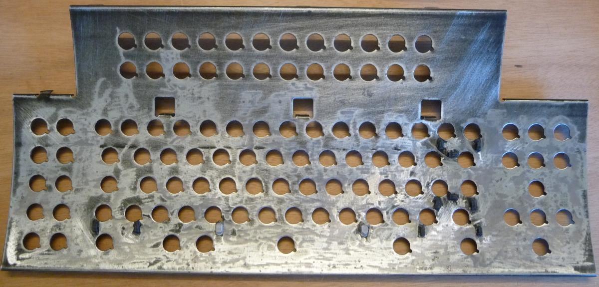

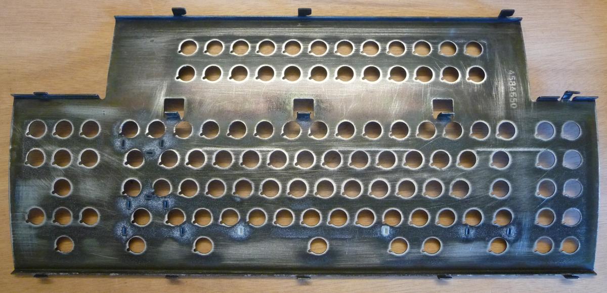

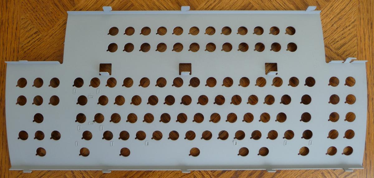

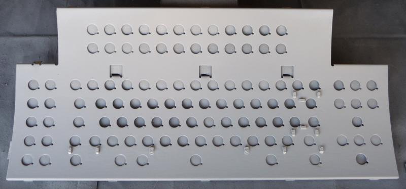

I made good progress over the weekend. First, I removed all of the rust from the top plate, using a bandfile for the heavily-rusted areas and emery cloth for the rest.
There was a lot of foam crusted onto the back of the plate, so I sanded the other side as well.

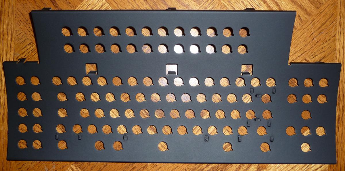

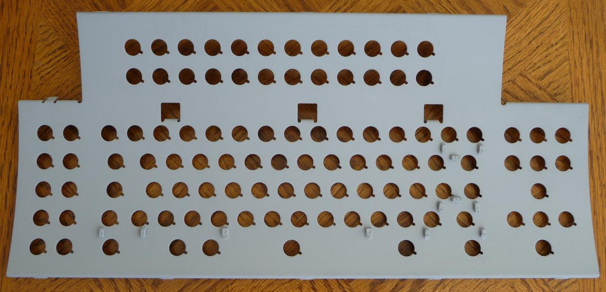

Next, I used two coats of an automotive primer with rust inhibitors to thoroughly cover both sides and all edges.
After drying overnight, I sanded lightly and followed up with two top coats.
That flat black paint cures completely in about one hour in the hot Texas sun, at which point you need oven mitts to handle the plate. While I was waiting, I punched out a new layer of foam.

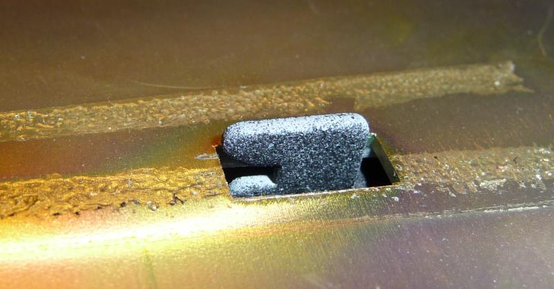

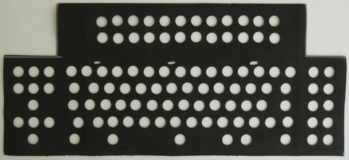

This is the foam I chose. I've experimented with different foams, but I've found that this soft, thin (1.6 mm) foam works best. If you take apart a Model F, you will see that the foam between the top plate and the barrel assembly is squished down to a fraction of a millimeter, so not much thickness is really needed. I used a 12.7 mm (1/2") punch, which is about 1 mm larger than the diameter of the barrel. This seems to give enough room to accommodate the indexing projection without making a separate cutout for it.

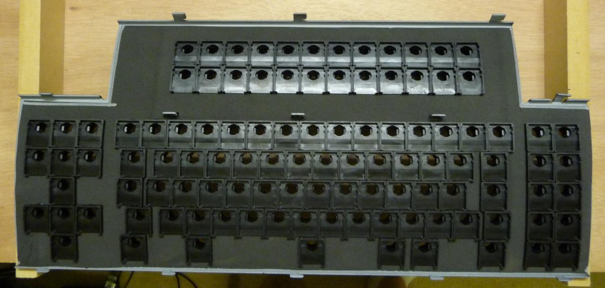

As I mentioned, a lot of the old foam was left behind, including on the barrels. Cleaning these up will be the next order of business.

@quantalume: Those are nice clean punches on the foam layer! Could you give us some details about the punching method? For example, the brand of punch, what kind of mallet or hammer, and what kind of backing (pine wood, etc.) when punching the holes. Did you sharpen the punch or just use it "as is"? I used a lab "cork borer" set, but I found that I needed to resharpen the borer after making just a few holes (cork borers are made of relatively soft brass rather than steel).
It is interesting that you used such thin foam (1/16 inch). I used 1/8 inch silicone foam on an XT, but it was a struggle sliding the plates into position. I was thinking of using 3/32 inch next time, but it appears that 1/16 inch might be enough.
EDIT: PS: How did you mark the hole positions on the foam? Template? Spray paint through the barrel plate? Other?

Sorry, I guess I left out a few details. To mark the holes, I used the standard procedure of taping the foam to the back of the plate with loops of cellophane tape before painting.
This foam is really soft, so you must use care not to tear it when removing it after marking.

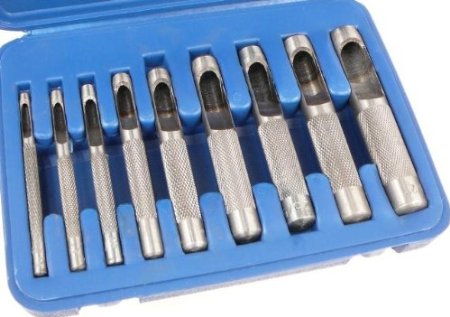

This is the type of punch I used:
I did sharpen it before use with a set of needle files. To actually perform the punching, I lined up the punch by eye and then hit it a few times with a small hammer. Then, maintaining pressure against the foam, I rotated the punch 360 degrees before lifting it off. This makes for a really clean hole. I used a piece of soft pine for backing. You want to avoid multiple punches over the same spot of wood in order to achieve clean cuts.
Regarding the foam thickness, this is the first time I've tried something this thin on a tall barrel plate (one with function keys above and steel hooks in the middle). I'll let you know how it works out when everything is back together.

@quanalume: Thanks for revealing your trade secrets! It all makes sense after seeing it written down. The combination of soft pine backing and rotating the punch 360 degrees after a few hits with the hammer certainly appears to work very well.
Lining up the punch by eye is not trivial. I had trouble centering mine on the paint spots. It would be easier if the spots were bigger than the punch, but I was also cutting separate holes for the indexing projection. I suppose if you are encompassing the index hole with the main barrel hole, you could use the index hole as an extra guide for the punch.

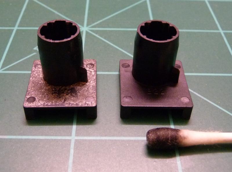

I cleaned the barrels in soapy water first, but the foam residue stayed behind. You can see how they look before and after cleaning with an isopropanol-soaked cotton swab.
I'm sure it wouldn't hurt anything to leave the residue, but I'm a perfectionist.

A parts XT i got off ebay had the exact residue on the barrels, i would have also liked to have used isopropanol but i did not have any. A long few soaks sorted it out :).

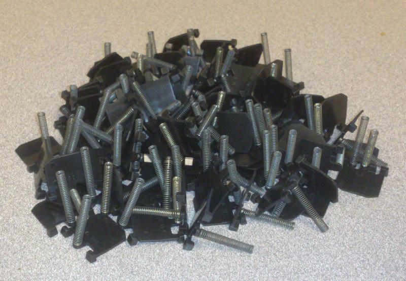

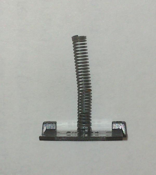

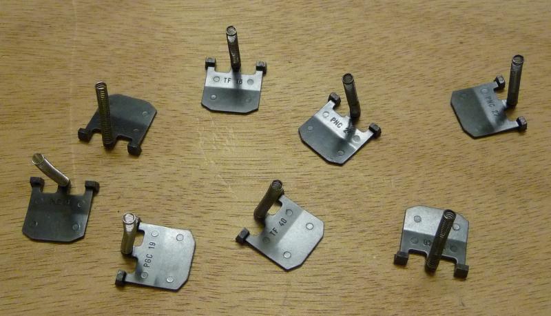

The pivot plates needed cleaning; many of them had pieces of foam or other crud stuck to them. I soaked the plates and springs in alcohol for 20 minutes, then wiped each one individually with a microfiber cloth.
A couple of the springs were bent, so they will need to be replaced. It's not fun when you find out after wrestling the plates back together that you have one or more keys which don't click, and you then need to take everything apart again.
Heartbreaking is what it is, and I have done it dozens of times.
Probably the most annoying part is that all the key stems have to go on and off each time.

Yep. The other thing which is frustrating is when the malfunctioning spring and pivot plate look exactly like all the others and you have no clue why it doesn't work, even after swapping stems and barrels. Possibly the spring is just "tired." What I may do this time is assemble a standalone stem and barrel and then test each pivot plate and spring before loading it onto the plate.

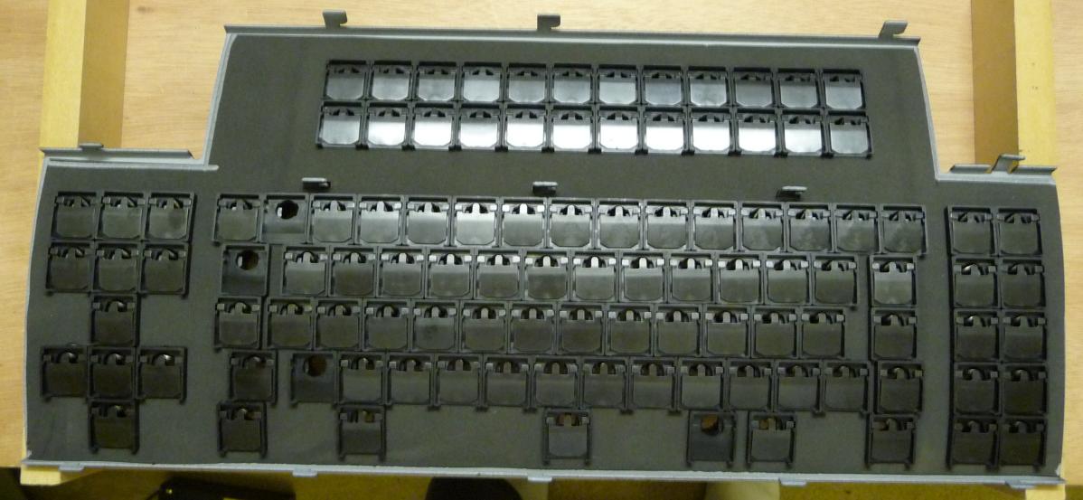

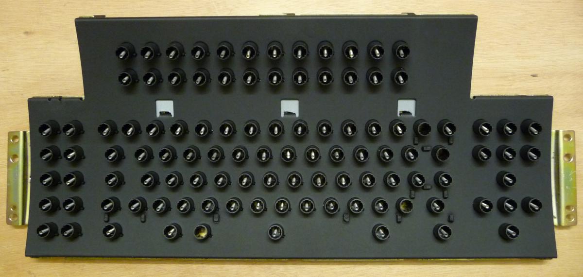

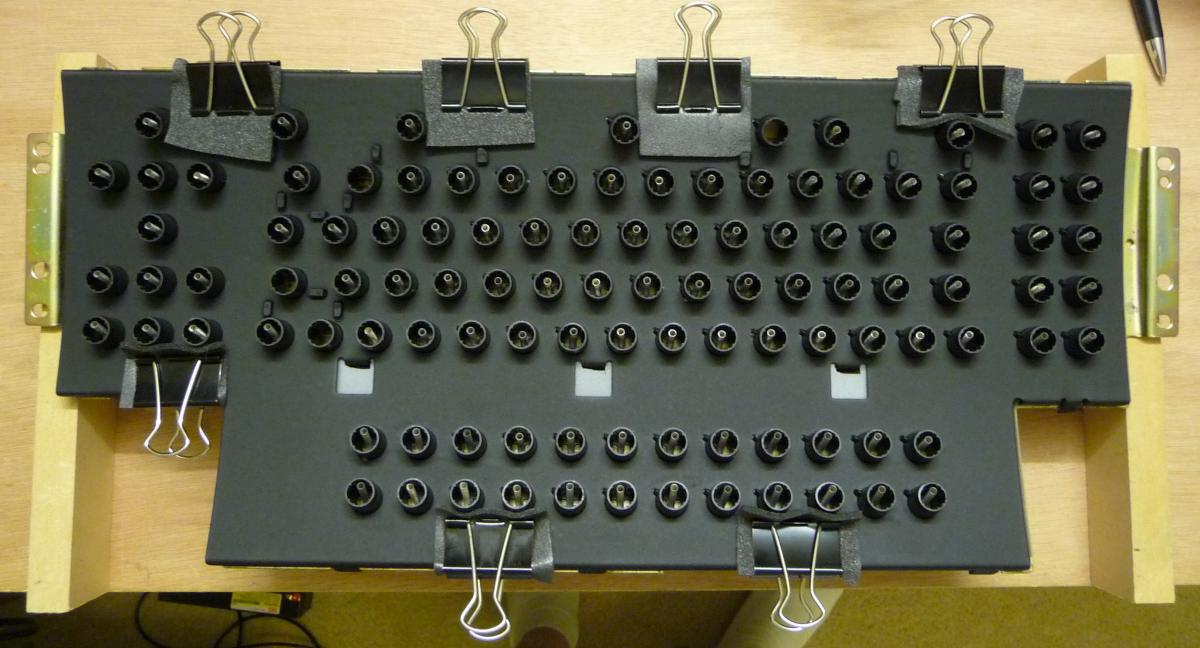

I started putting everything back together. First step was loading the foam and barrels onto the top plate.
The holes in the plate were a little tight because they now have four coats of paint on them. I think next time I'll sand the holes a little (or use less paint).
I loaded the springs and pivot plates into the original configuration. I'll think about changing the layout another time.
There were 8 springs which were distorted in one manner or another and didn't make the cut.

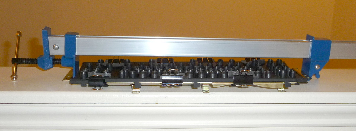

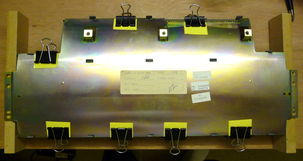

I carefully lined up the backplate without disturbing the pivot plates and clamped the pieces together with binder clips. I used mylar under the clips on the back side...
...and foam under the clips on the front side.
This allows the back to slide under the clips while protecting the front from damage to the paint.
It's a good idea at this point to make sure that the relationship of the tabs to the slots in the backplate will allow proper seating. You can see here that the tab is poking through enough so that it will catch when I start to slide the plates together.
Thanks to a tip from prdlm2009, I used a clamp from Harbor Freight Tools to coax the plates together. A hammer works pretty well too.
The foam under the clamps did a good job protecting the paint.

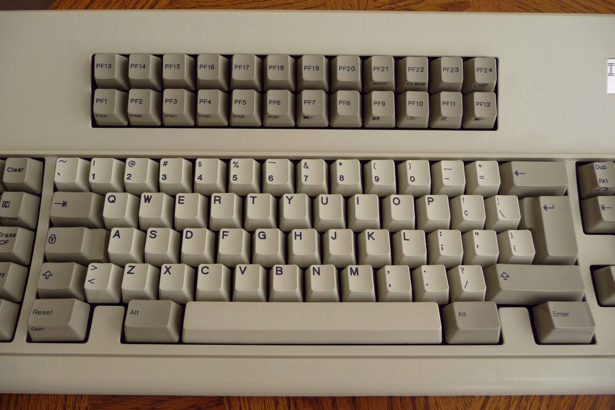

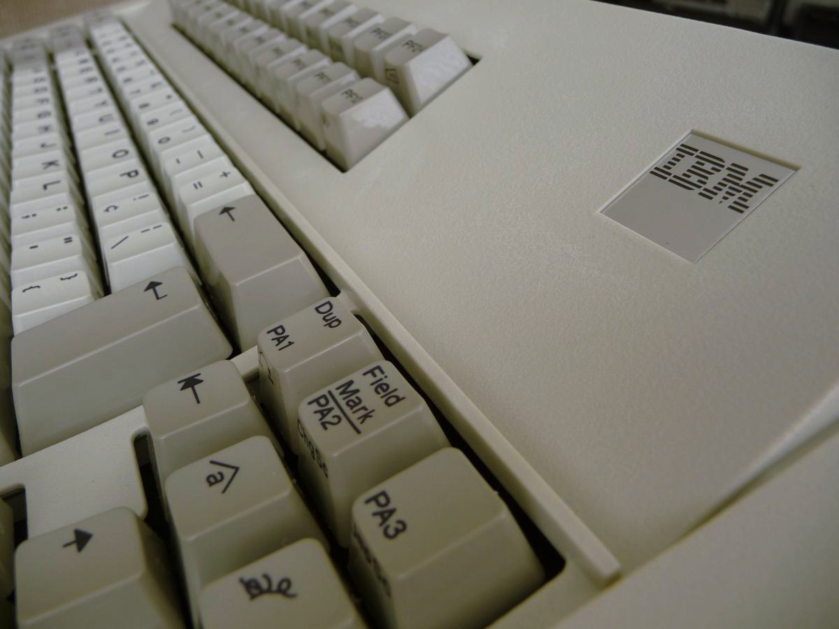

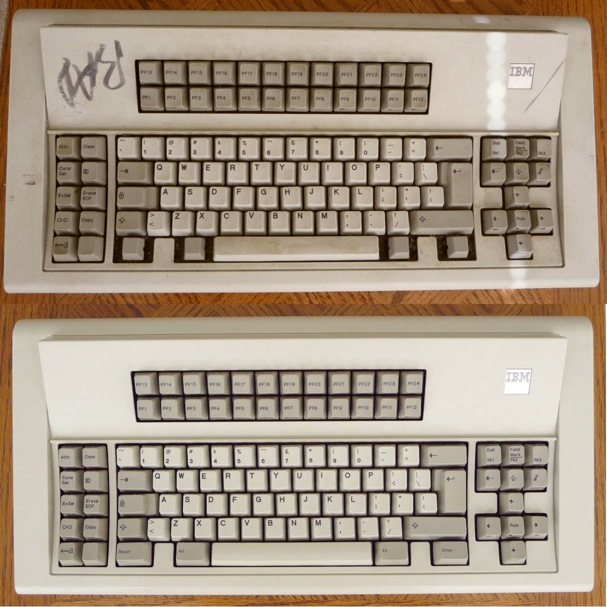

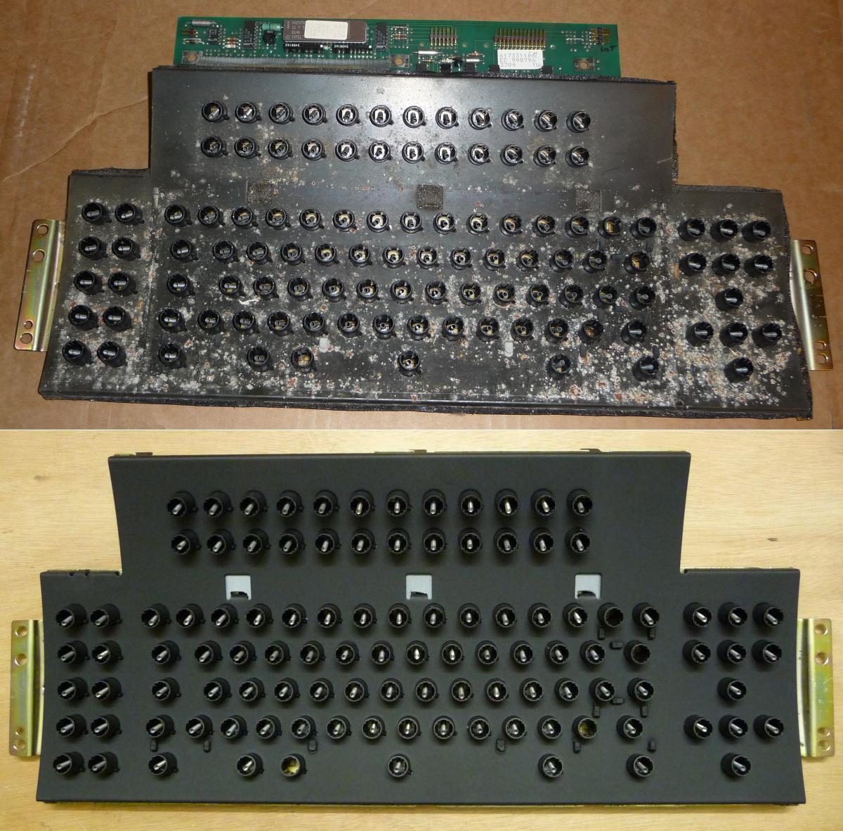

I'm pretty much finished with the restoration and reassembly. I thought I'd post a couple of before-and-after photos...
...as well as a couple of close-ups.
All of the keys click uniformly, and the barrels seem to be tight enough. I think I'll continue to use the 1.6 mm (1/16") neoprene foam as I've had good results with it, and it makes reassembly a lot easier than the thicker foams I've tried.
I want to thank all of the members of the community who previously took the time to post photos and advice regarding Model F restoration, including prdlm2009, Pyrelink, fohat, Hypersphere, andrewjoy, Parak, wcass and others. A special thanks goes to Muirium, whose gentlemanly unselfishness made it possible for me to acquire this board in the first place. And, of course, thanks to Cindy for uncovering all these old boards and saving them from the shredder.

Looks very nice, good job! I'm jelly.
01 Nov 2014, 20:14
That is amazing work , it looks almost new better than new in fact as that paint job on the plate it was better than the orginal, good job :)
