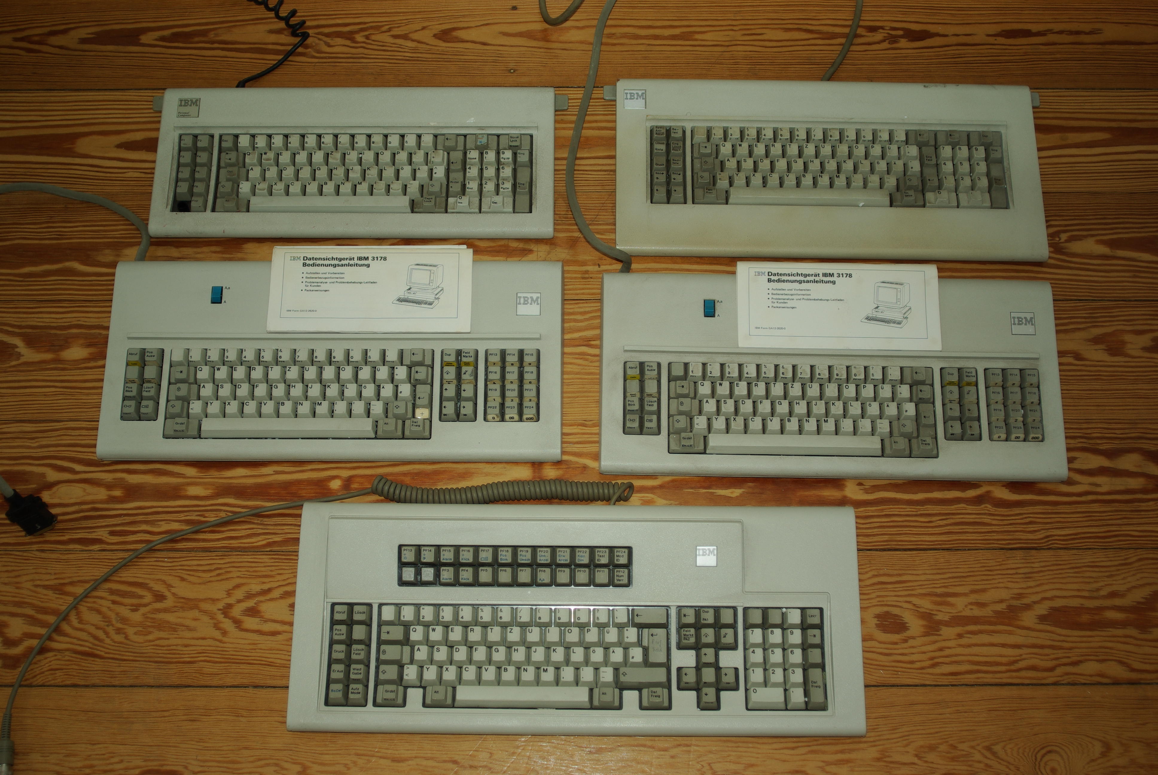

and I thought this could be the place to help me identify an IBM keyboard I bought the other day.
not so sure actually... :? I´ll have to get mine up from the basement.
Looks just like this though:
http://www.seasip.info/VintagePC/ibm_6110344.html
mine looks very similar:

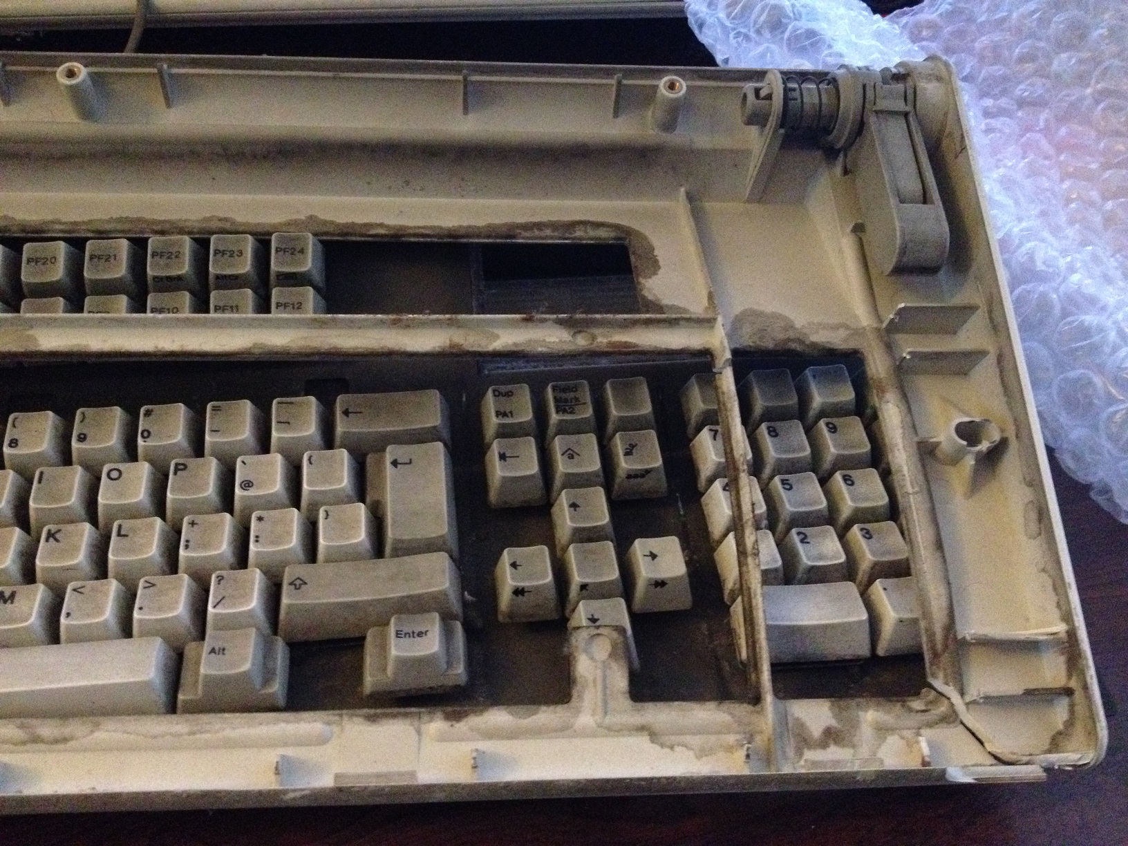

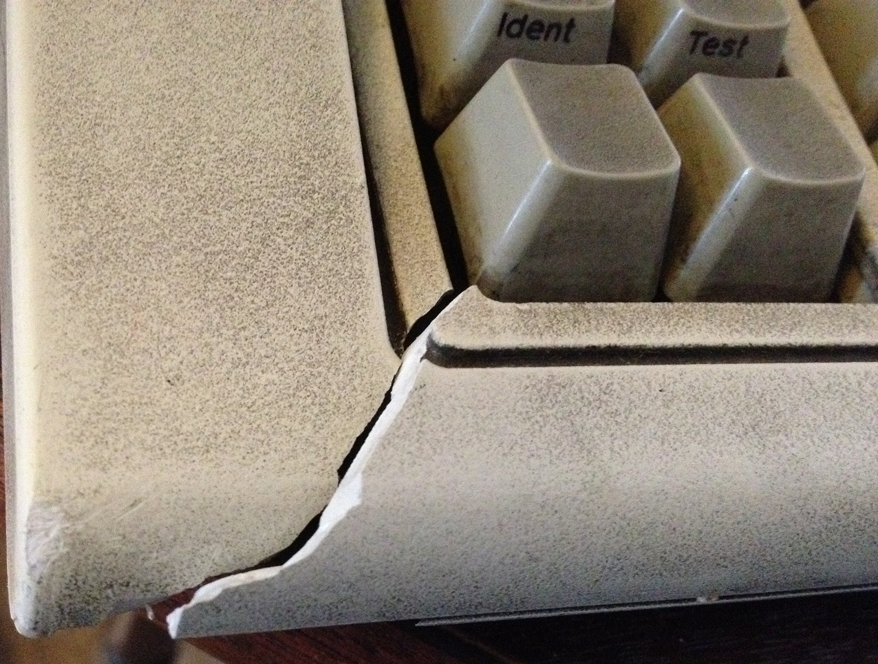

The keyboards have arrived! unfortunately the model F has been damaged during transport, dfespite being wrapped in bubble wrap and with polystyrene in the box
quantalume
28 Oct 2014, 15:31
That's too bad. What has been damaged? Was it shipped entirely within the UK?
komodo
28 Oct 2014, 15:35

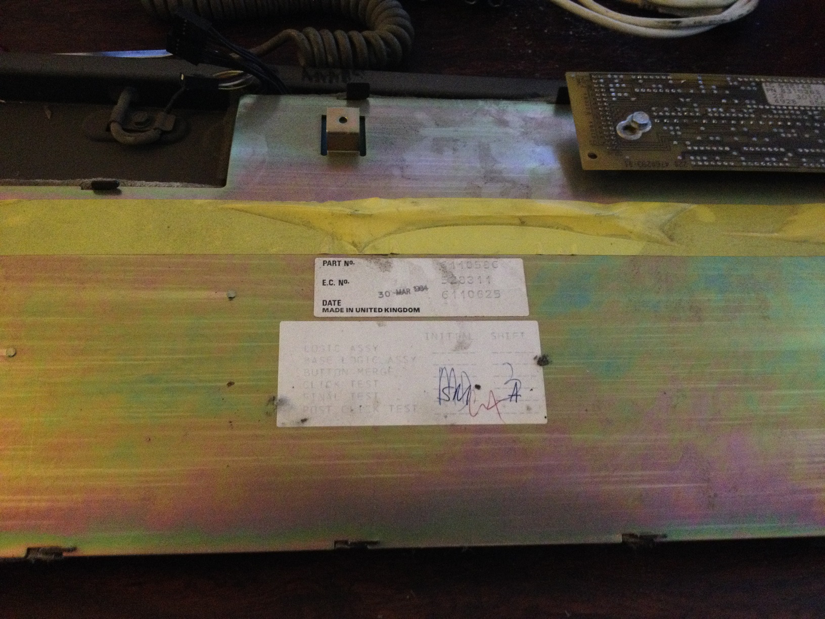

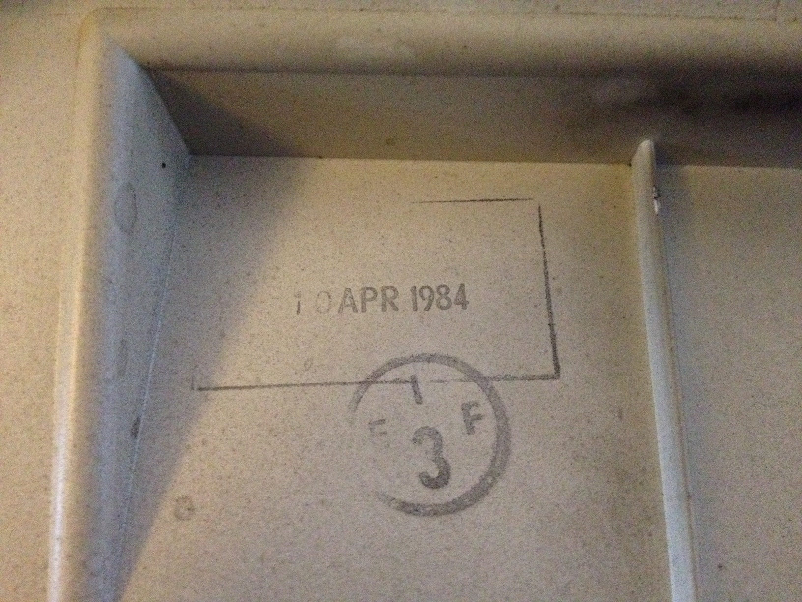

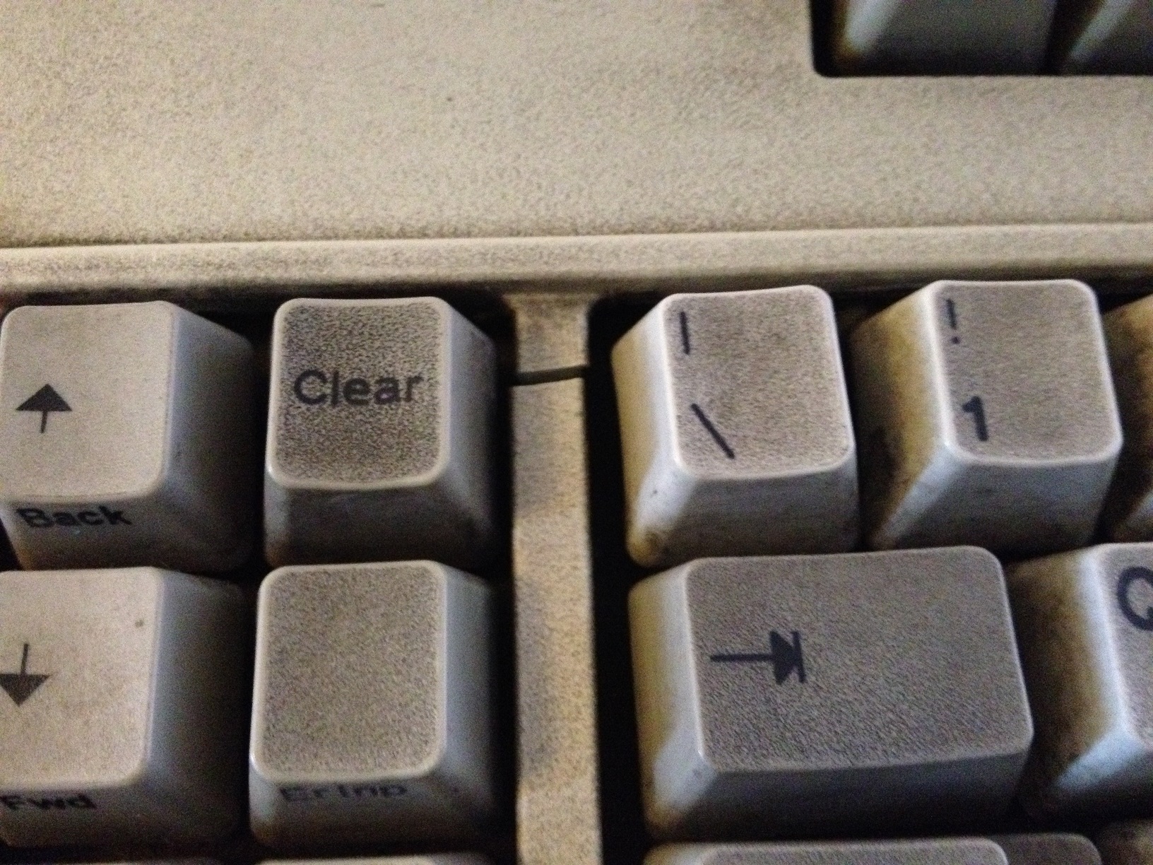

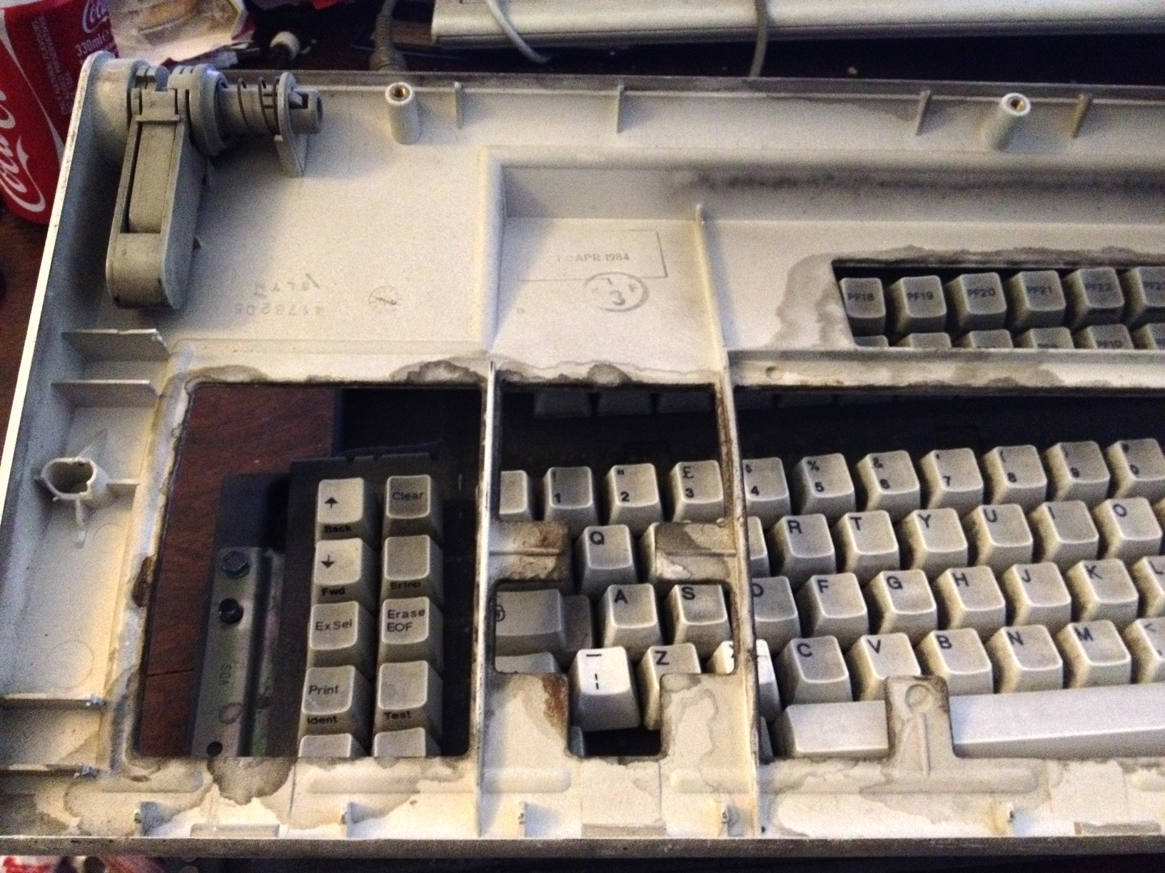

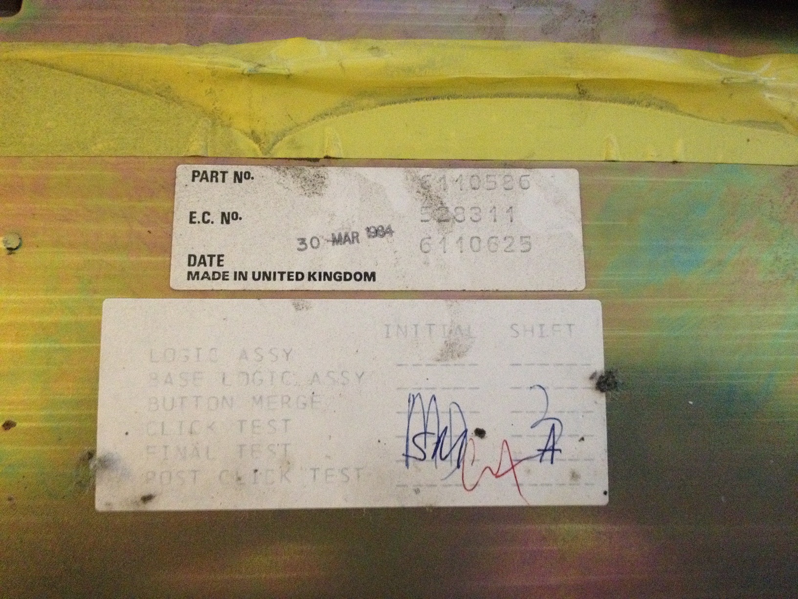

ive begun disassembly, here is the damage and the the inside of the top plastic cover
damage
damage
corner
corner
internal date
internal date
inside 1
inside 1
inside 2
inside 2
komodo
28 Oct 2014, 15:36
yes shipped just within the UK. Its a bit of a shame, i know it can be repaired but ah well

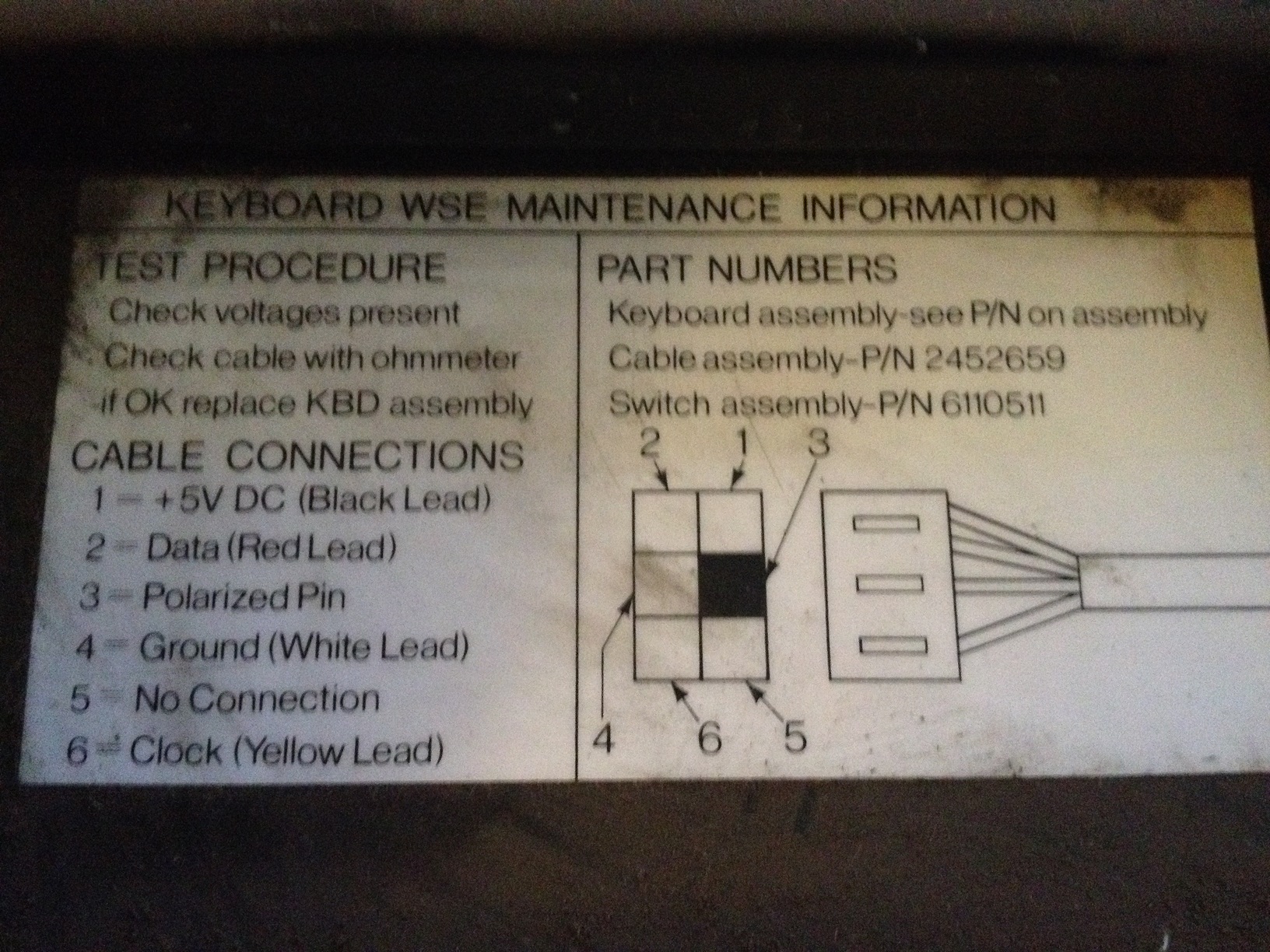

By the way, how should the jumper switches be set on the bottom of the keyboard?
quantalume
28 Oct 2014, 15:46
It's unfortunate when something like this survives for 30 years only to get damaged on the last leg of its journey. :( I'll keep an eye out for a replacement. The jumper switches shouldn't matter. I removed mine entirely.
komodo
28 Oct 2014, 16:03

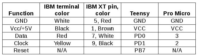

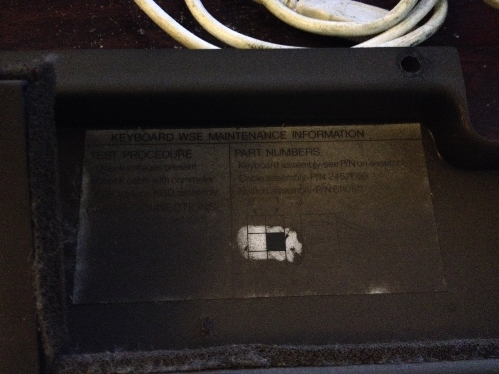

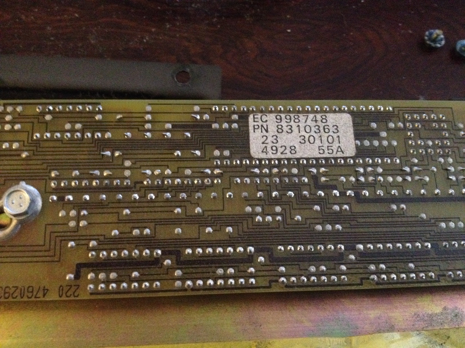

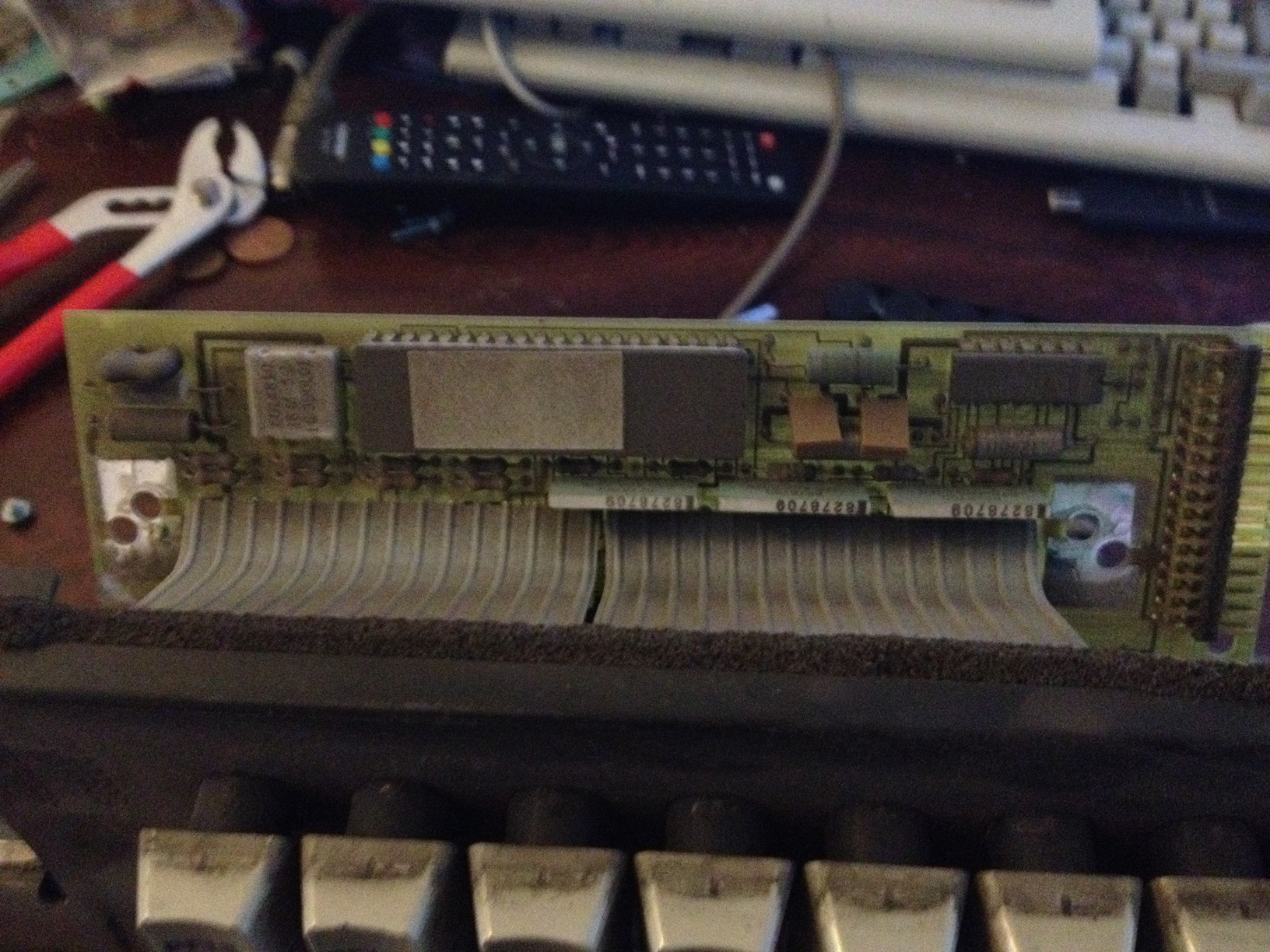

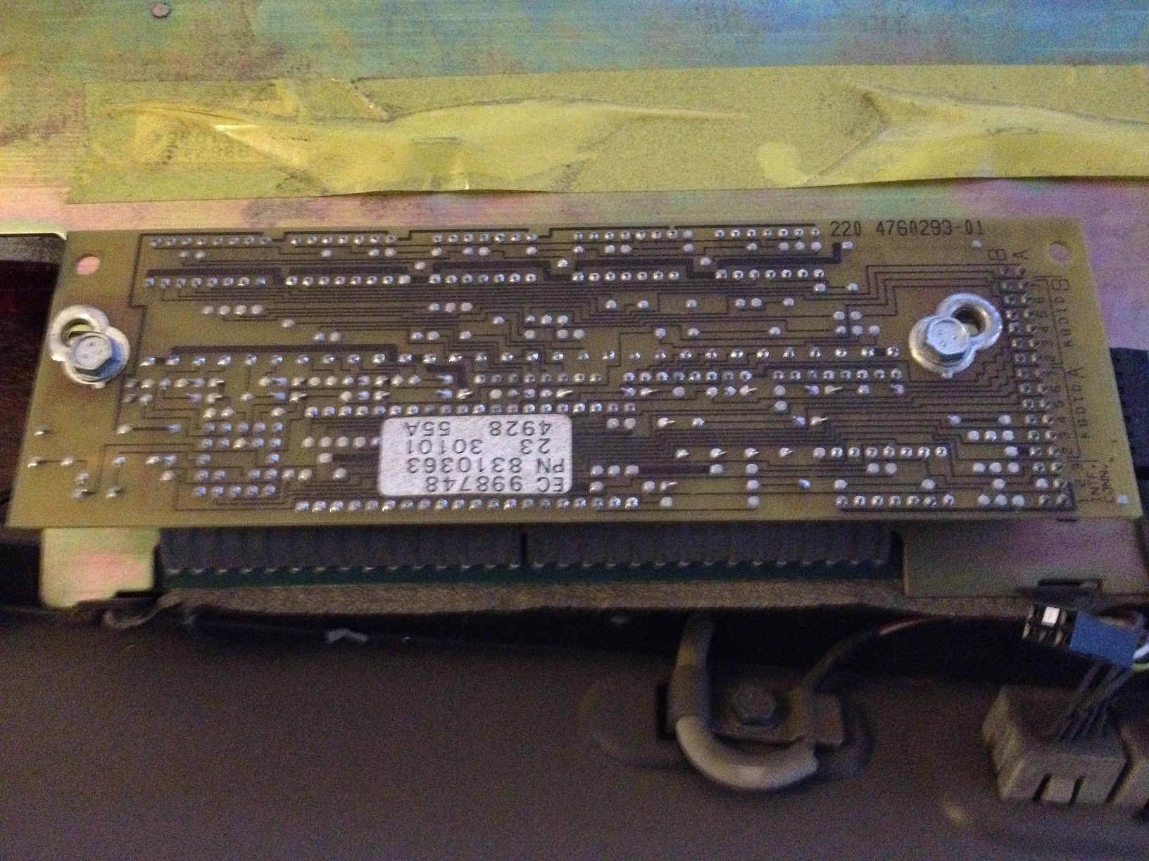

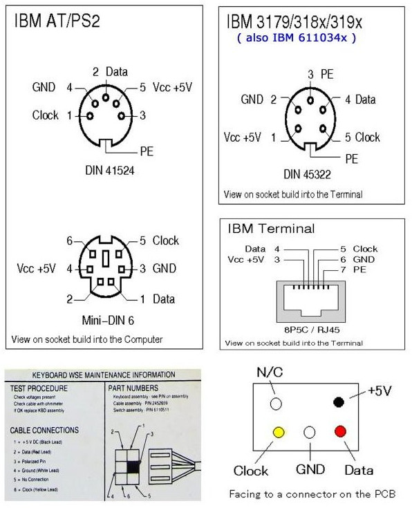

ill probably just leave them disconnected internally then. It looks to me like the foam mat has had its day, but its good enough for now, so next step is to see if the electronics work by making the soarers converter. I now have to puzzle out the instructions for that! More photos below.
Dirt/dust
Dirt/dust
cleaned maintenance instructions
controller
controller
rear of keyboard
rear of keyboard
rear of keyboard 2
rear of keyboard 2
controller 2
controller 2
controller 3
controller 3

Seems those cases are prone to crack, since POTV experienced something similar with one.

This should help with the wiring.
Soarer connections.jpeg (30.56 KiB) Viewed 8390 times
Soarer wiring.jpg (88.46 KiB) Viewed 8390 times

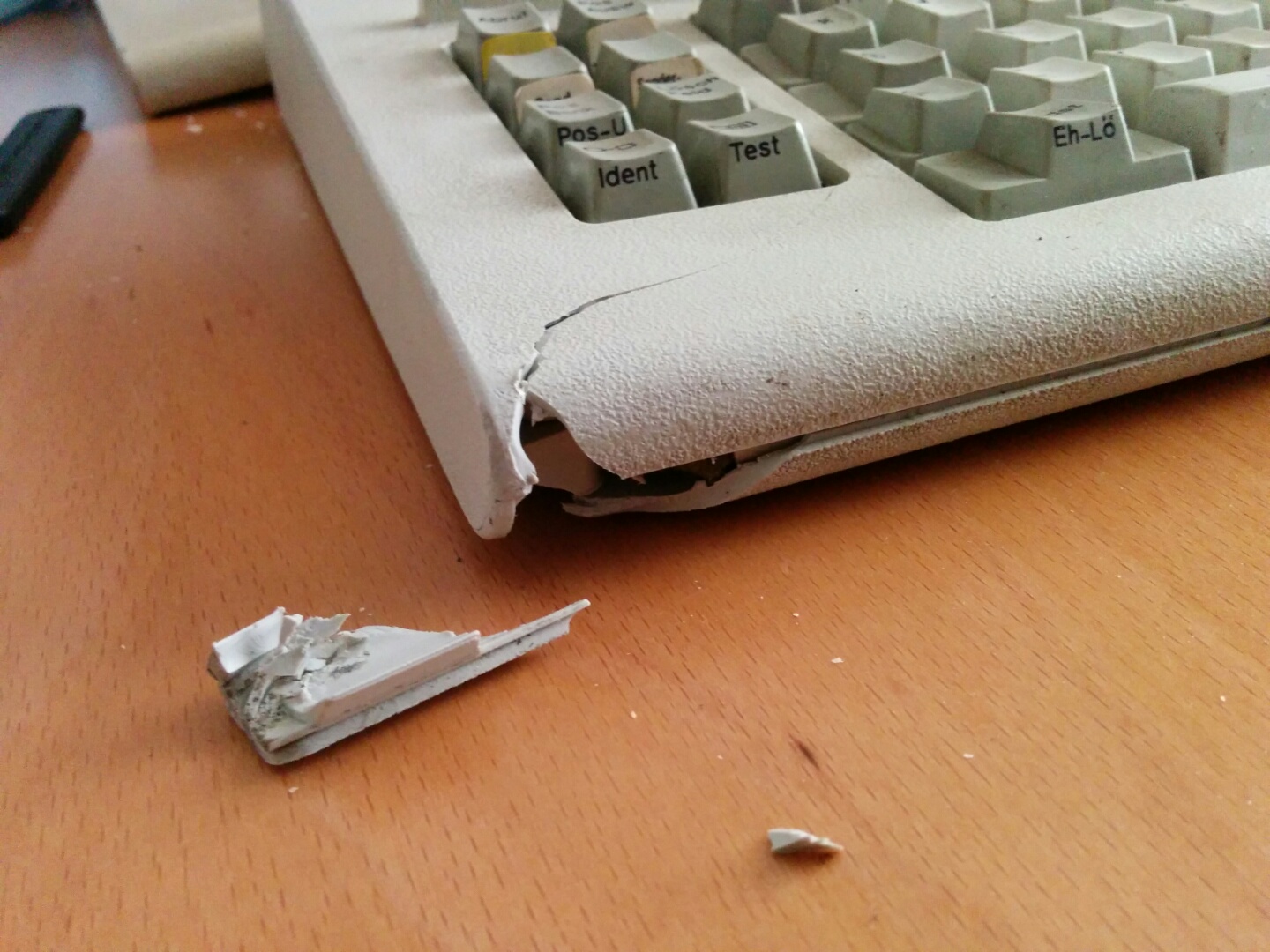

yes that is very dissapointing, I had a very similair experience when I sent Halvar two F´s well packaged within Germany via DHL and one ended up looking like this:
same corner of the keyboard too as it seems...
