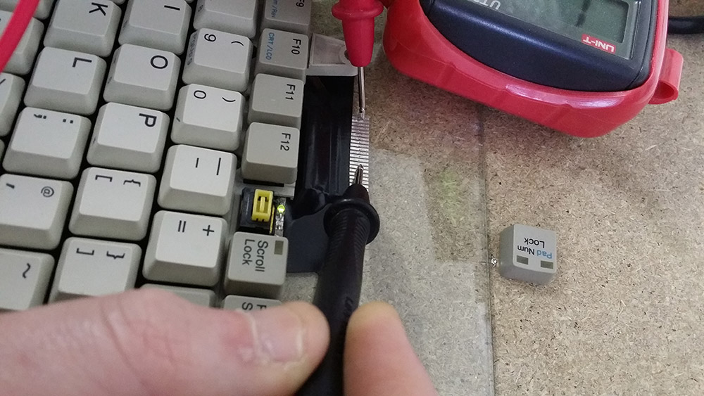

I have just done some more probing with a meter and it seems all the rows are connected together. I also probed between pin 12 (PB4) and Pin 16 (PF6). The keypress does not register with the positive probe on pin 12 and the negative on pin 16, but swap the probes around with positive on pin 16 and negative on pin 12 and it works.
Interestingly the working keys react to a key press with the probes in any position.
The conclusion is that the LEDs are blocking the keys, presumably if I bridge over the diodes the keys will work. I could test that theory and if it's correct then break the circuit and wire in the LEDs to the teensy with a common GND. Correct?

ViciousPenguin wrote: I have just done some more probing with a meter and it seems all the rows are connected together.
That should not be the case, unless maybe if all keys are pressed. I this were true, no keys should work at all. How and where on the circuit did you measure that? Did you measure a resistance between them at all? How high?
That actually looks to be how it's supposed to be. Pin 16 is a strobe (output port on the teensy), Pin 12 is a sense (input port on the teensy). So positive on pin 16 and negative on pin 12 is correct. The other way around might be blocked by a diode, I don't know. There seem to be only 7 diodes on the PCB (D1 to D7), I don't know where they go logically in the circuit, the pictures of the PCB are too dark / too low-res to follow traces even where they're visible.
R1 to R4 are probably for the 4 LEDs.
Could mean that there are no diodes on those columns, but there are some on the columns that don't work.
There are 4 LEDs and 7 normal diodes on this board. If anything, the normal diodes should be part of the matrix, and the LEDs should be connected to their own circuits, in line with their resistors. So I would start by bridging the normal diodes and see what happens. Alternatively, you could transpose the matrix in the software (make the row pins the column pins and vice versa) and test that.
Also, could you re-check the LEDs? Are the resistors R1 to R4 connected to the LEDs, and where does the other end of each resistor and LED go? I still have trouble believing that they are part of the matrix.

Super fantastic Success, it works!
Turning the matrix around fixed it. Here's the config file as it is now having been transposed.

The LEDS are definitely part of the circuit...
Caps Lock = PB4
Scroll Lock = PB0
Num Lock = PD7
Pad Lock = PB2
I can only surmise that the polarity changes on the relevant pin when the caps lock etc is pressed which in turn lights up the LED. I expect I can take them out the circuit as mentioned before but they will have to wait for the time being though. Next I need to sort out the FN1 layer........
