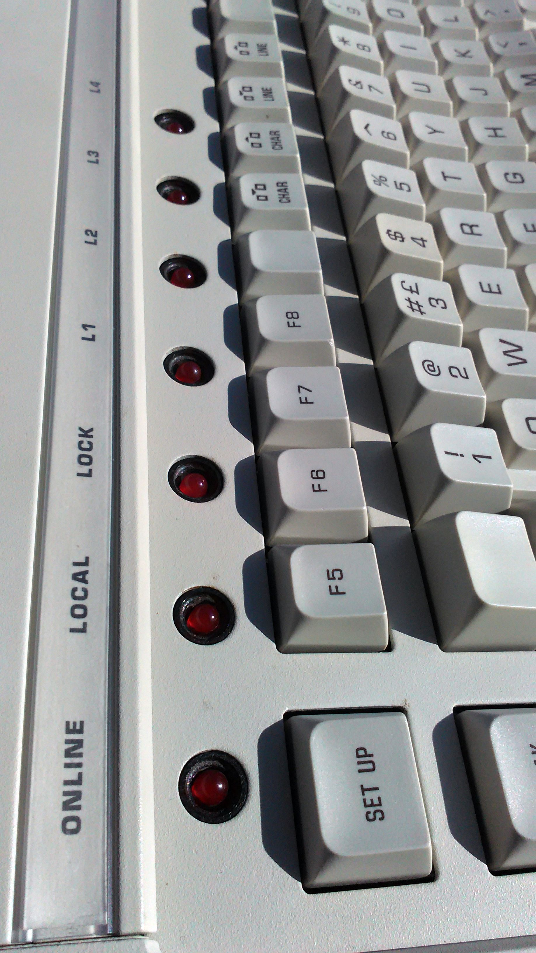

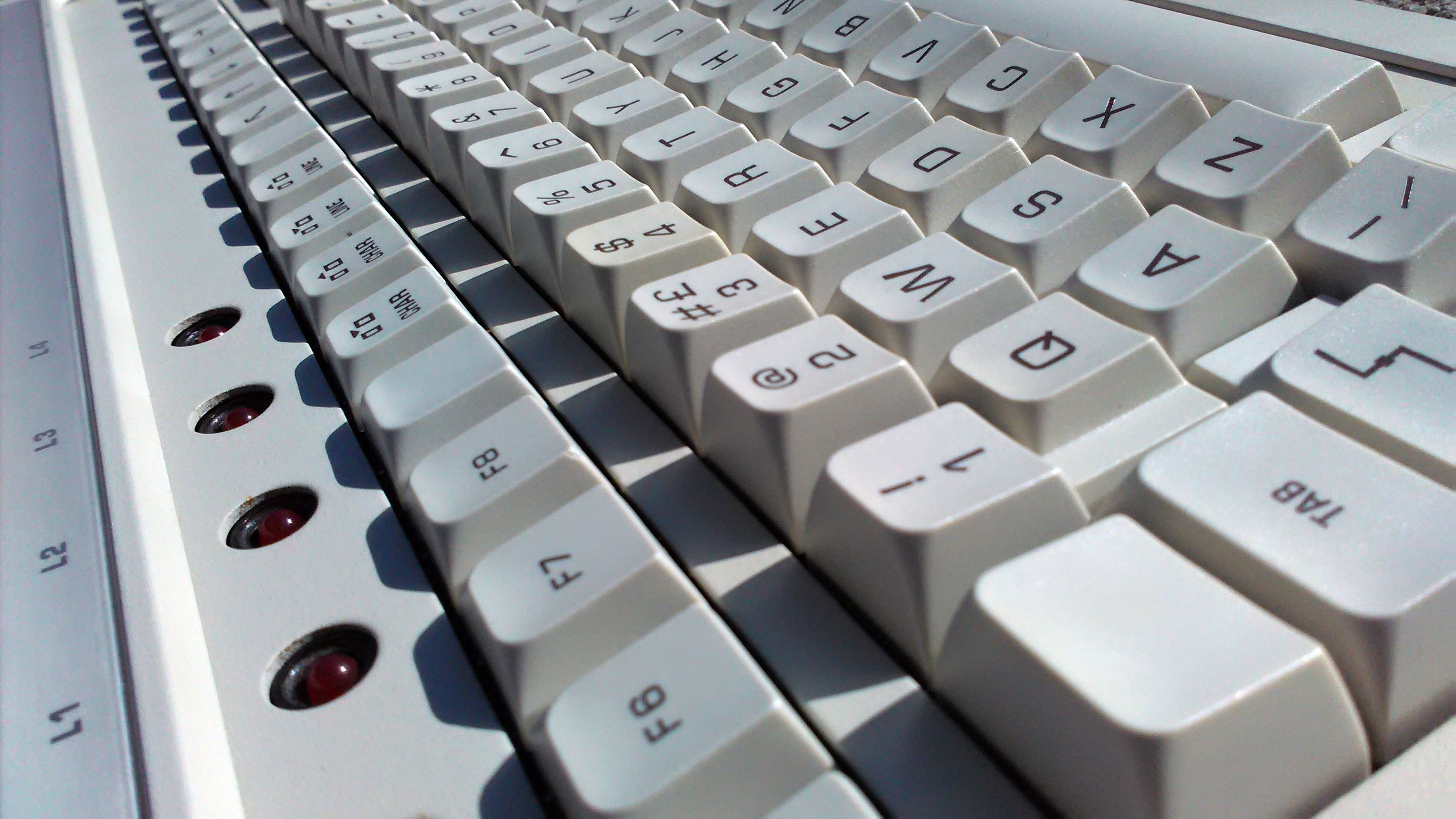

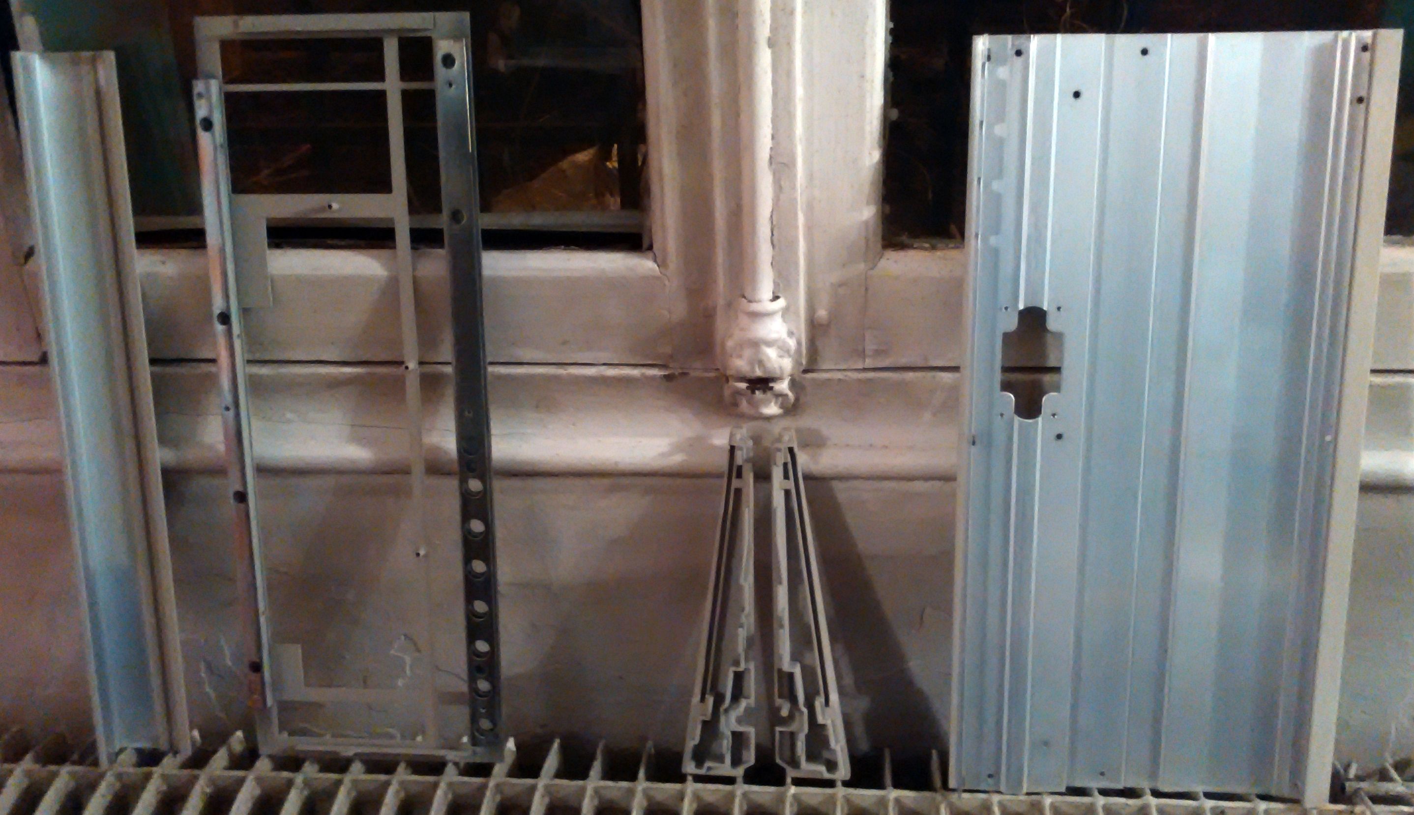

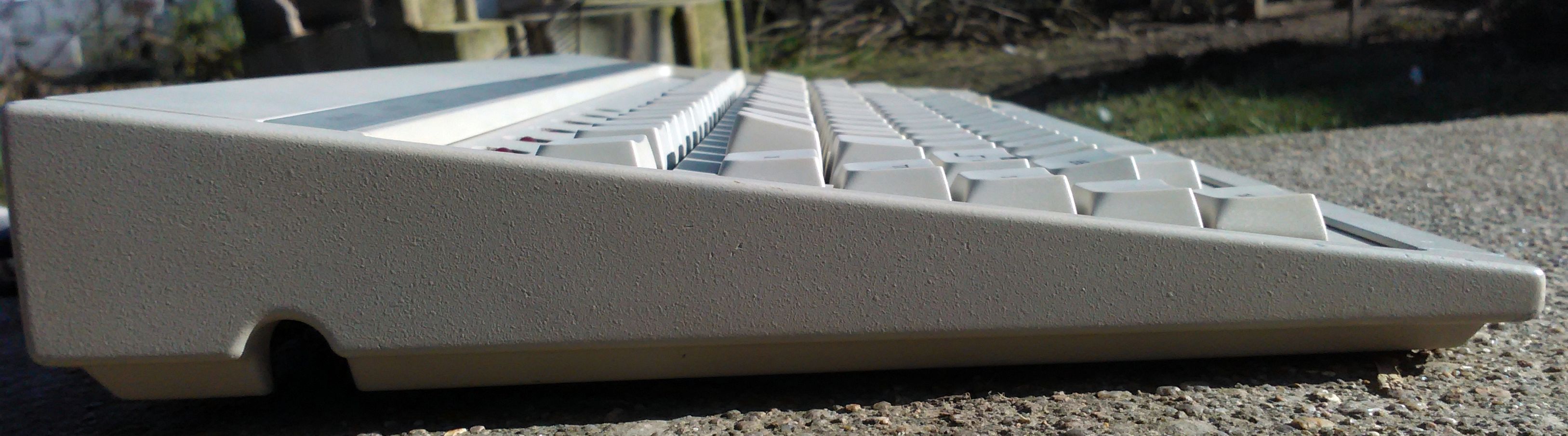

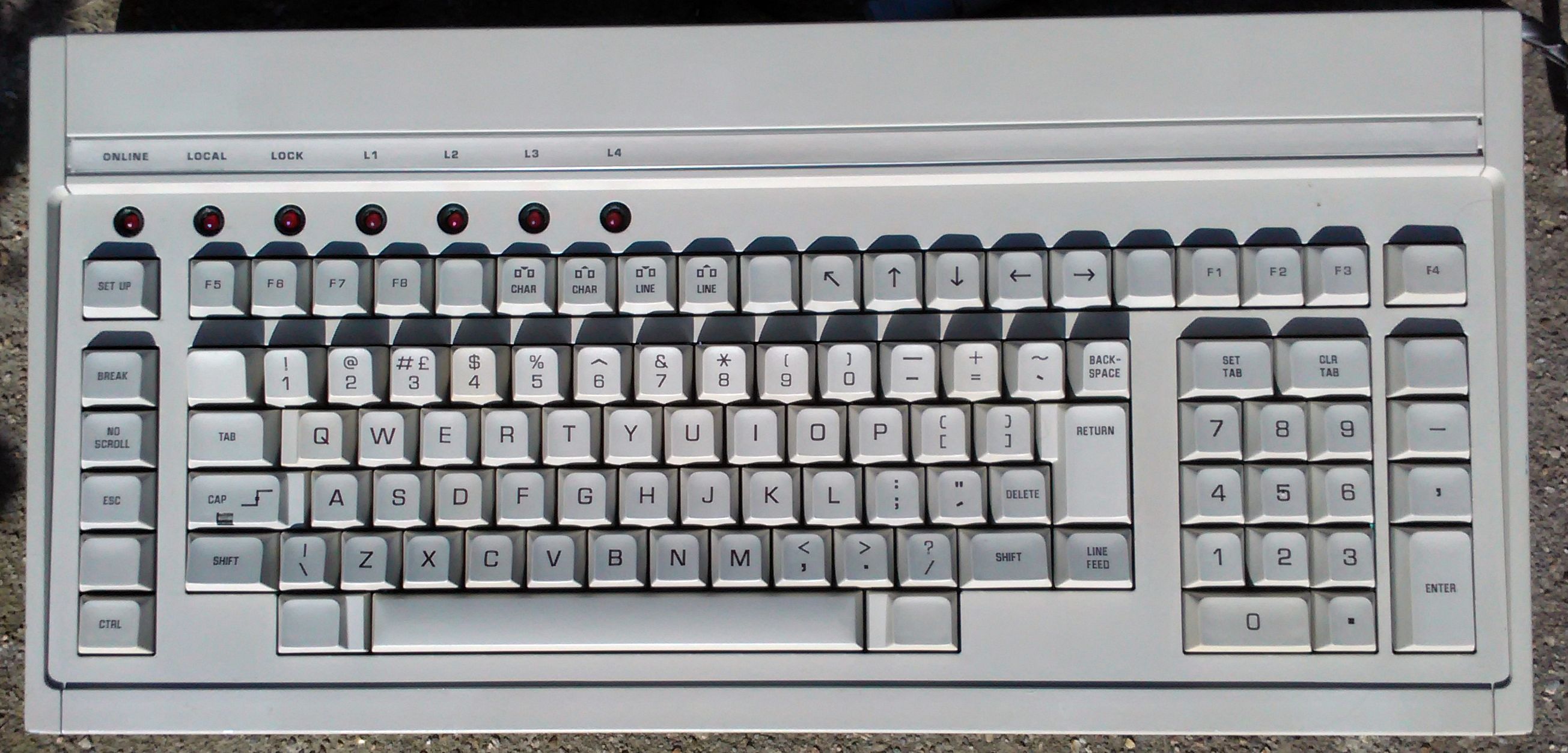

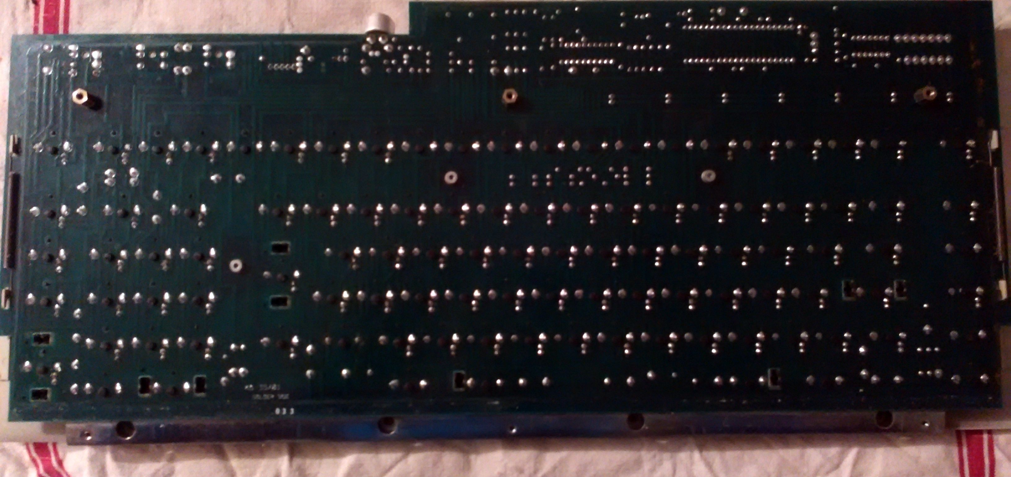

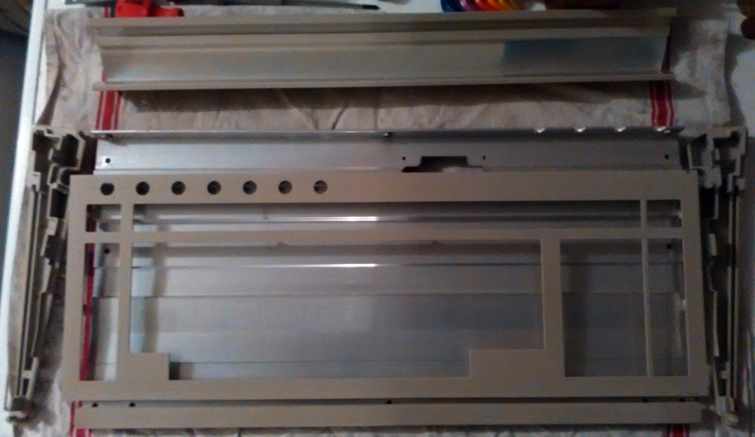

The Philips restaured :
overview, pcb, case
sides
details
Got regular DIN plug but not recognised by PC

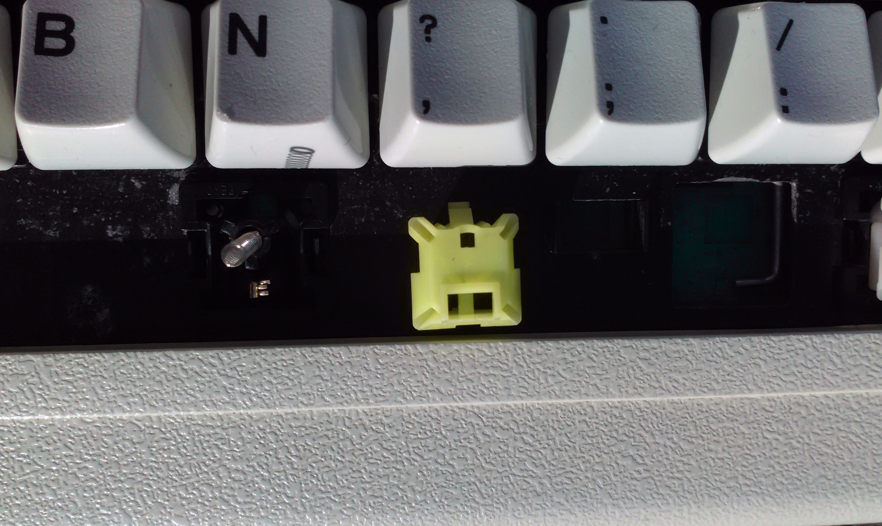

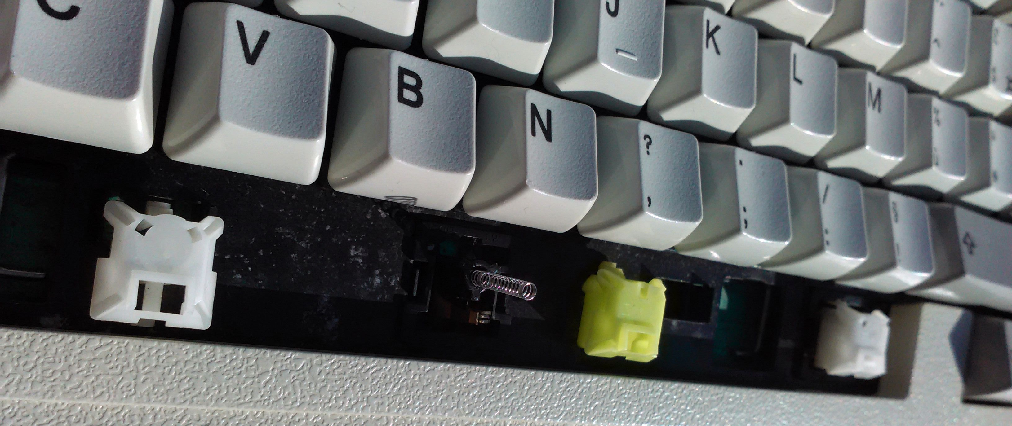

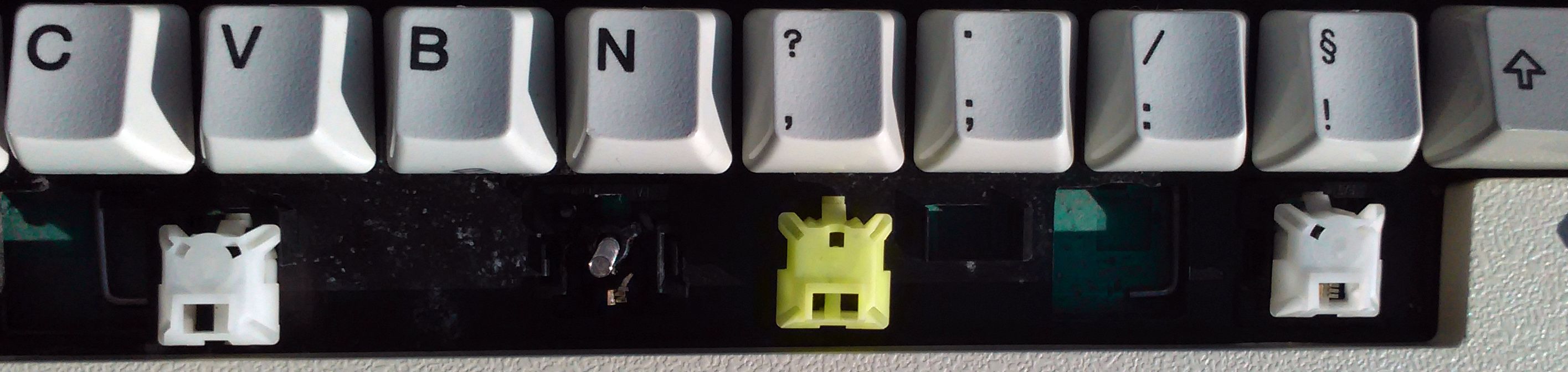

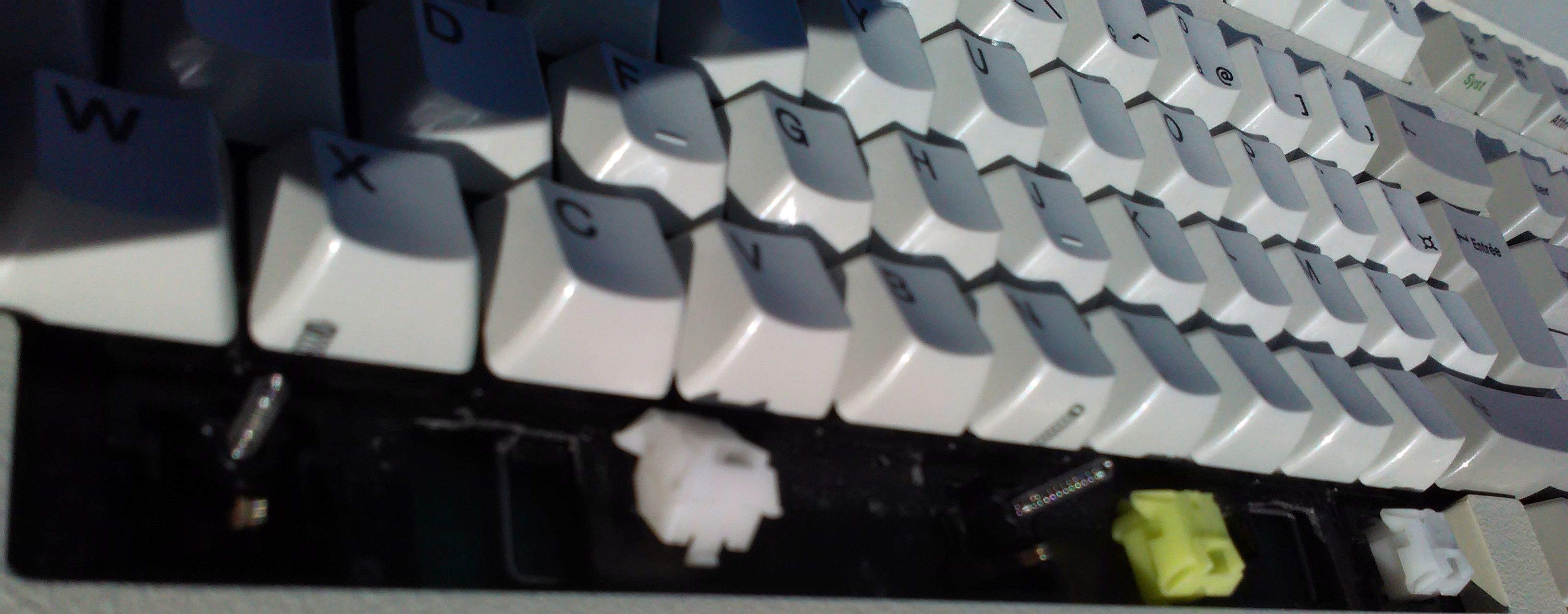

Daniel Beardsmore wrote: I knew there would have to be at least one more undiscovered space invader switch — one-eye yellow! Two-eye yellow is supposed to be lighter, but one-eye yellow is clearly heavier!
Plus there's that weird dark green/teal Alps SKFL that may or may not be a real switch — it seems to be there as part of the stabiliser, rather than as a switch, but even more confusingly, it looks like the LED hole of the other switch is full of hot glue or an LED or something.

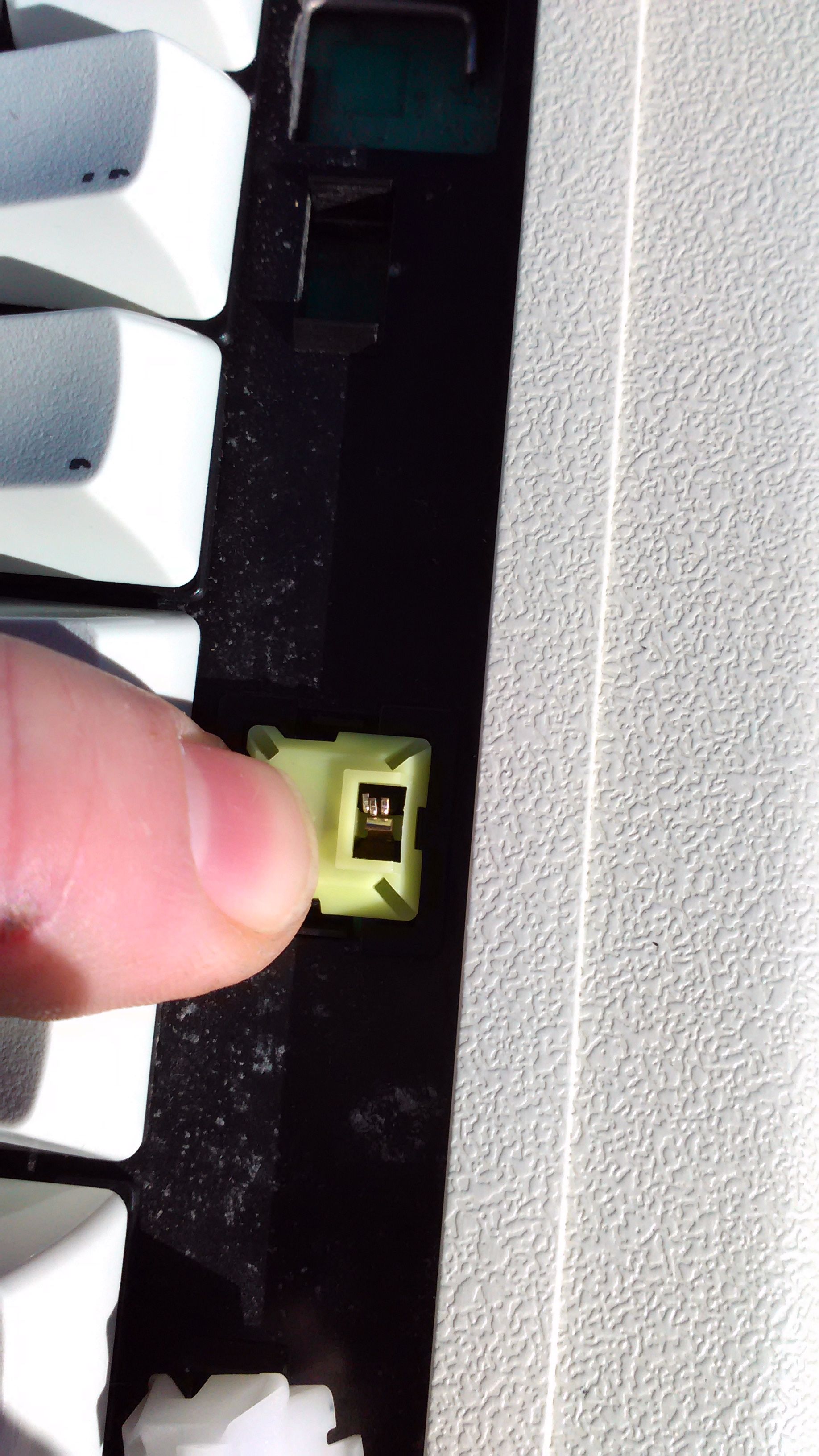

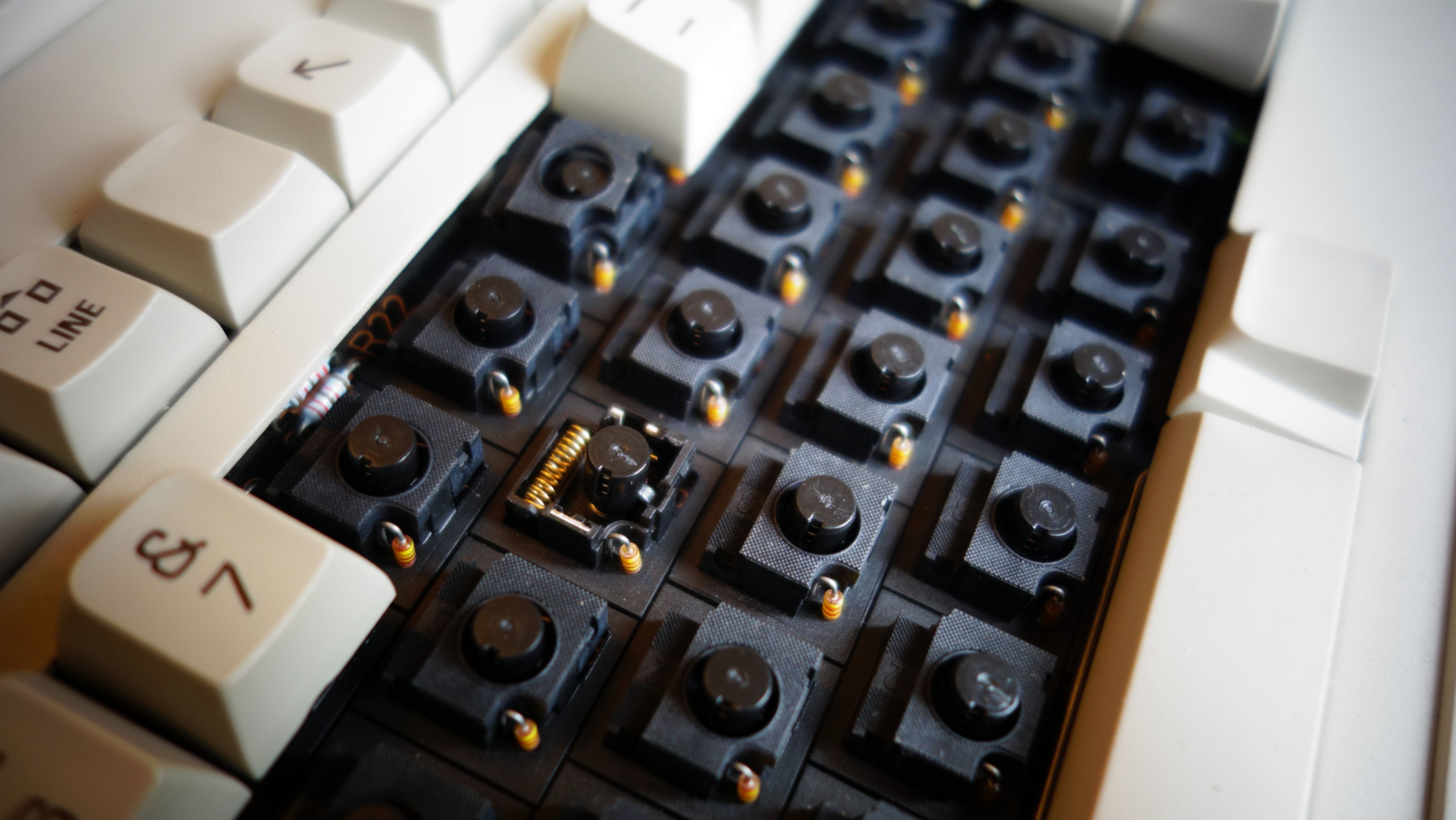

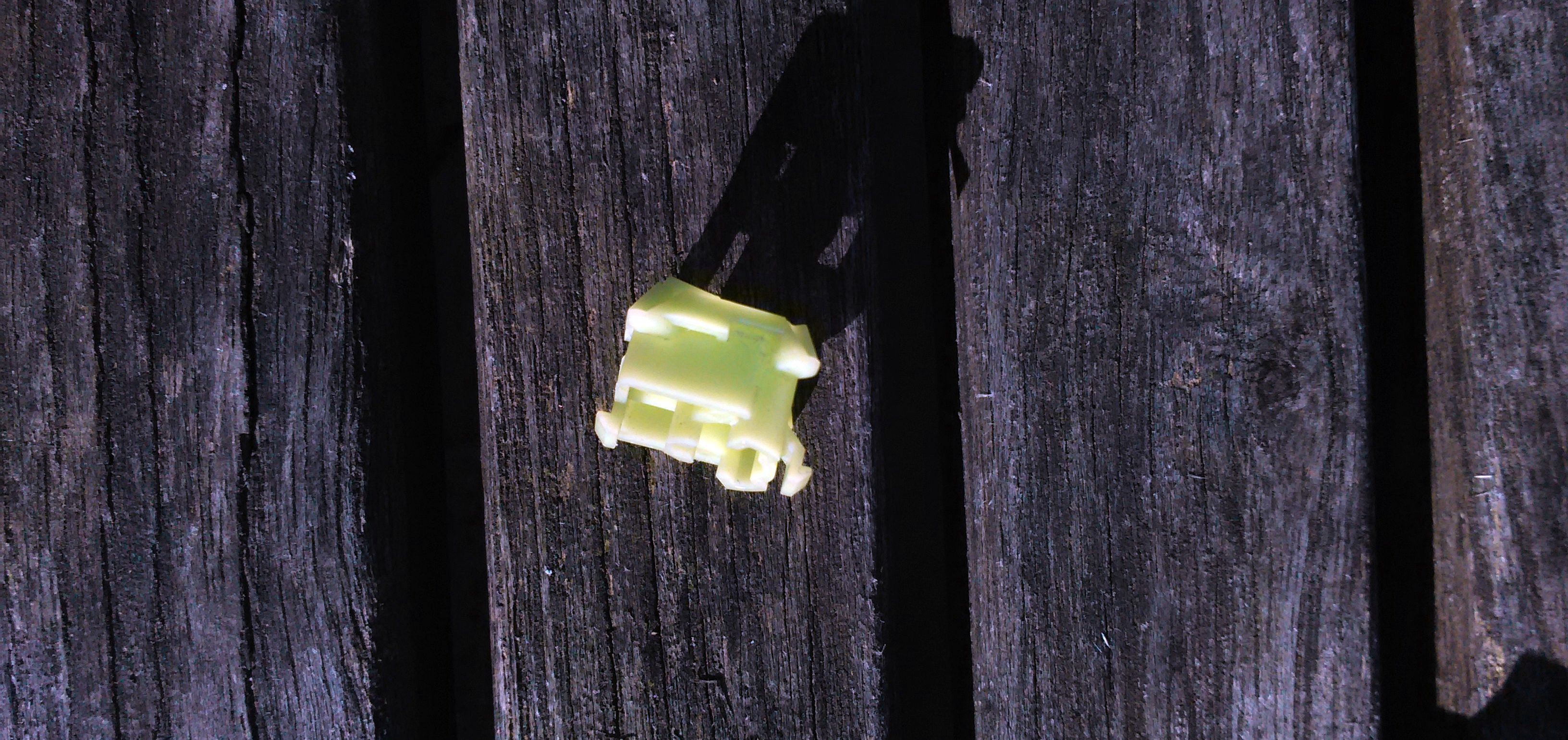

One-eyed yellow :
The metal leafs under that one have displaced a bit before as you can see in last pic, but still contact is ok, with proper tools like proper pliers, the little ones for electronic I presume..
I don't want to modify anything from this one until I find how to plug in my PC before !

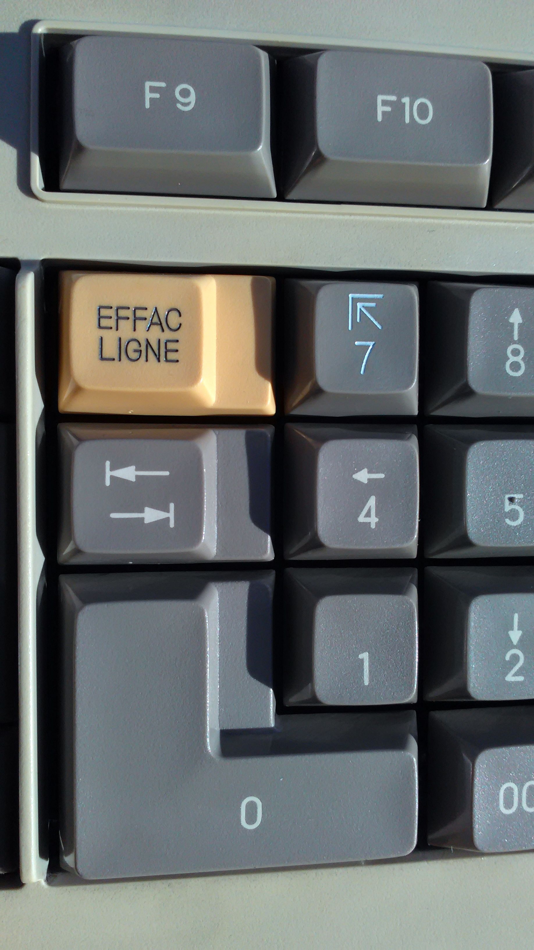

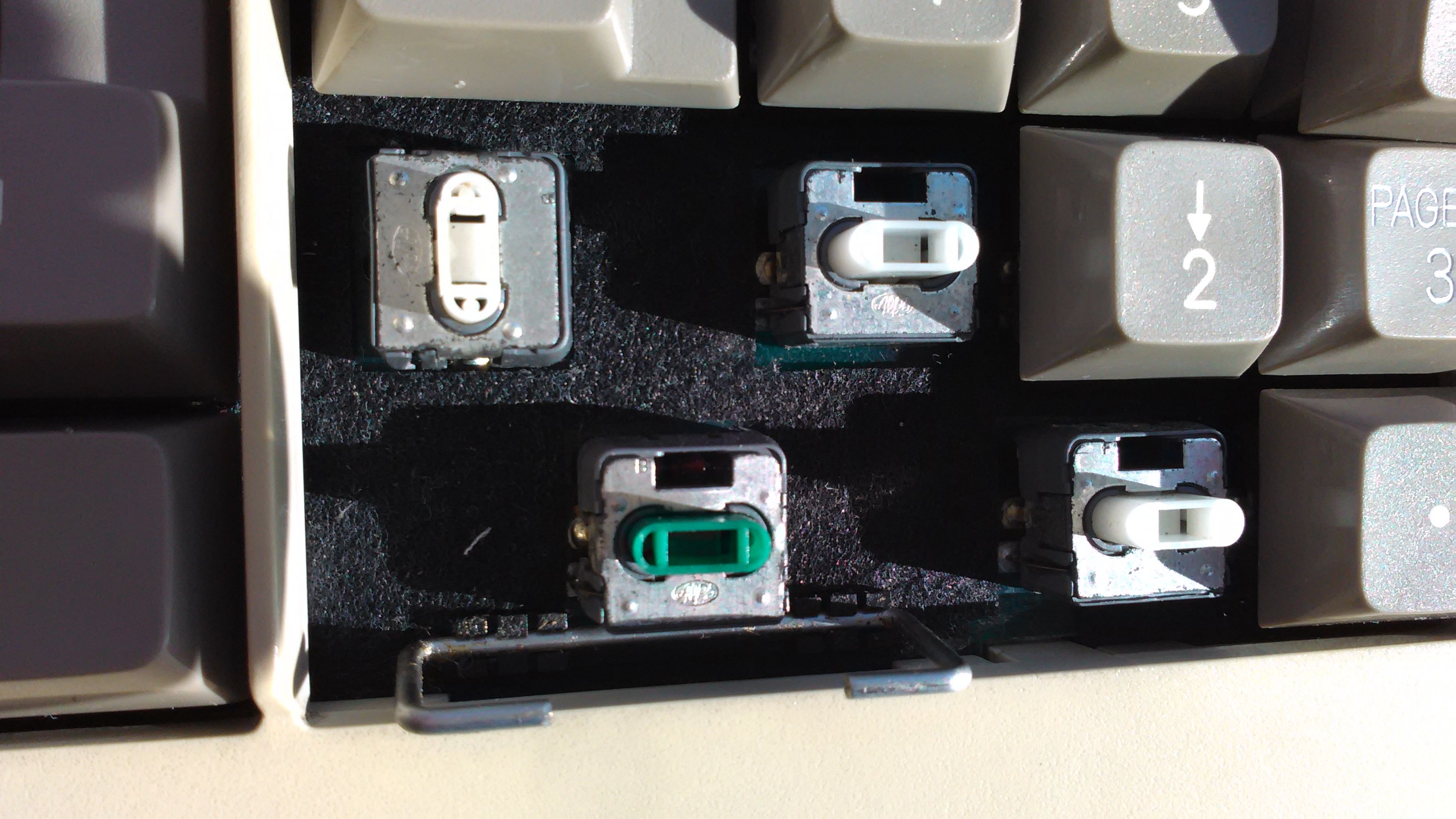

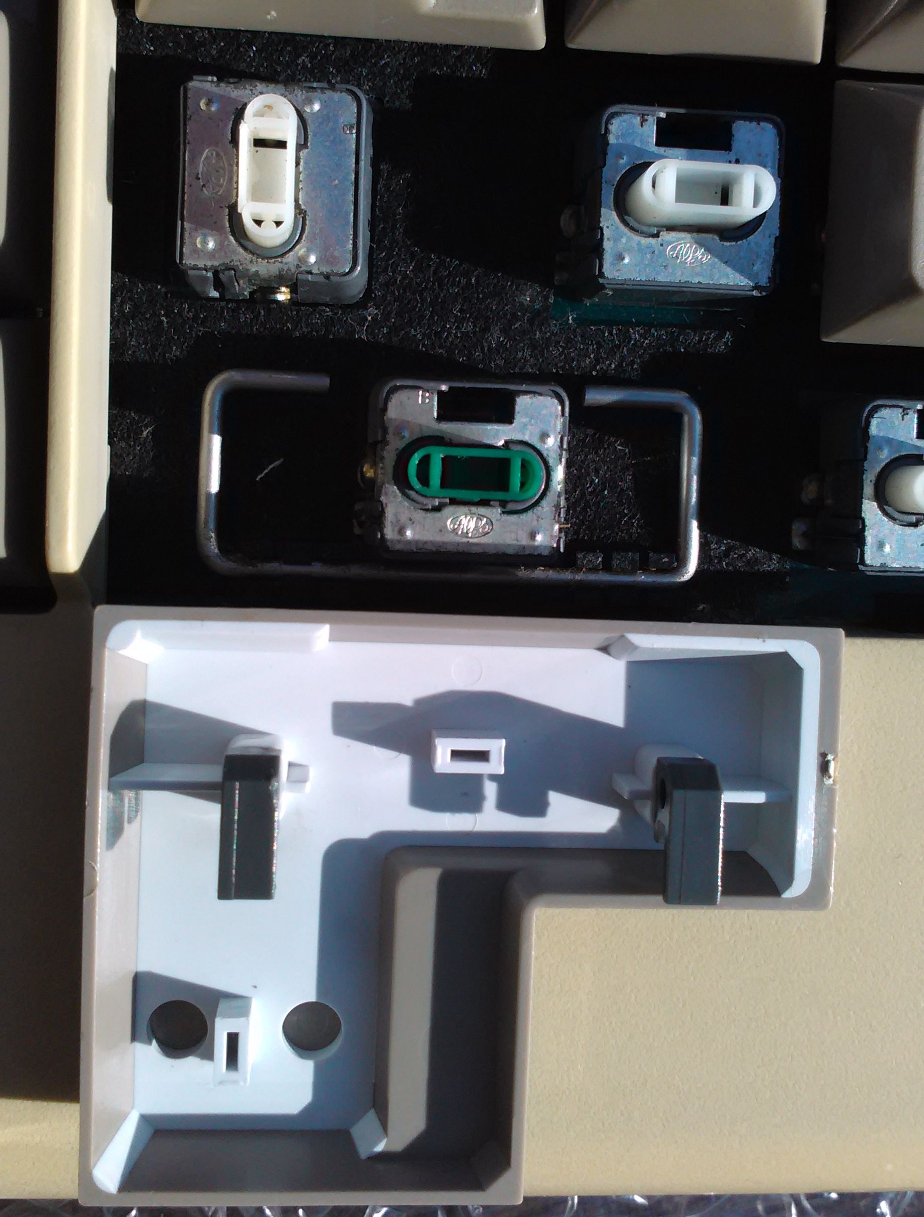

And weird dark green/teal Alps SKFL :
No led or glue but two switches for this big ass 0 key !
07 Feb 2015, 15:45

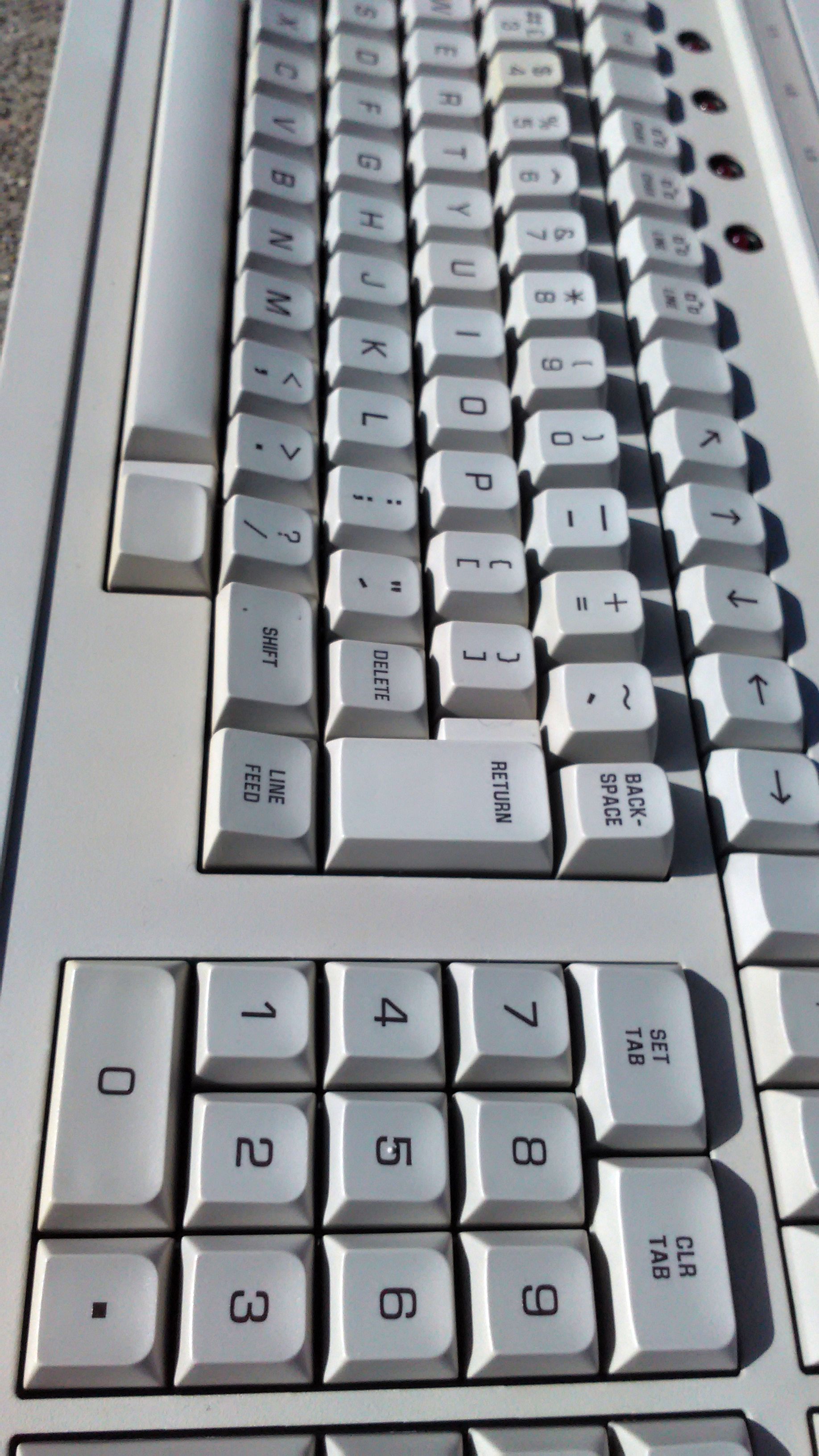

I was just seeing something that wasn't there. So, it's a dark green switch. Some keyboards do use empty switches or even functional switches for stabilisers, so I'm not clear on what Canon were doing there. What does the green one feel like?
Also, you can see from that photo that the custom (language-specific?) keycaps are engraved.
07 Feb 2015, 18:14
I'm guessing that the green switch is not connected to anything - just soldered to keep it on the board.

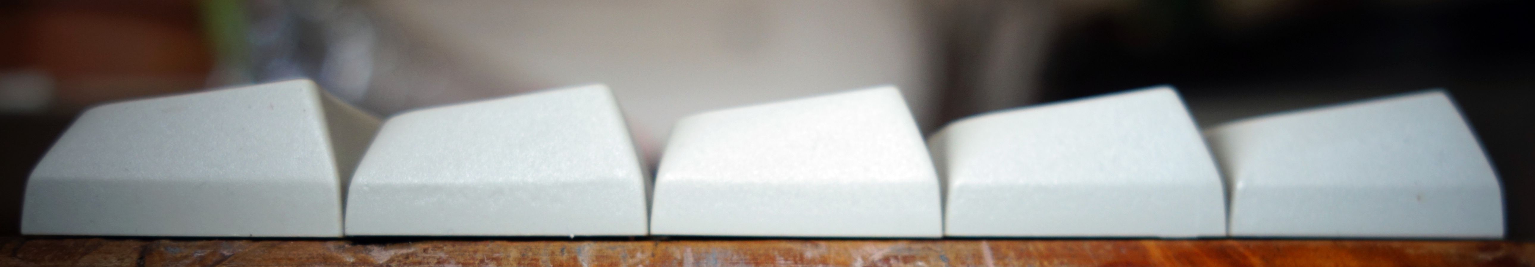

How are the Philips keyboard's keycaps? It is difficult to see, but it looks in pictures as if they are a hybrid of cylindrical and spherical, though mostly flat with edges on left, right and back.
It is not the first keyboard that I've seen that has had the numeric keypad in all one profile while the alphabetic keyboard has been contoured. I wonder why they do the keys different.

Case of this one is totally metal, very heavy one

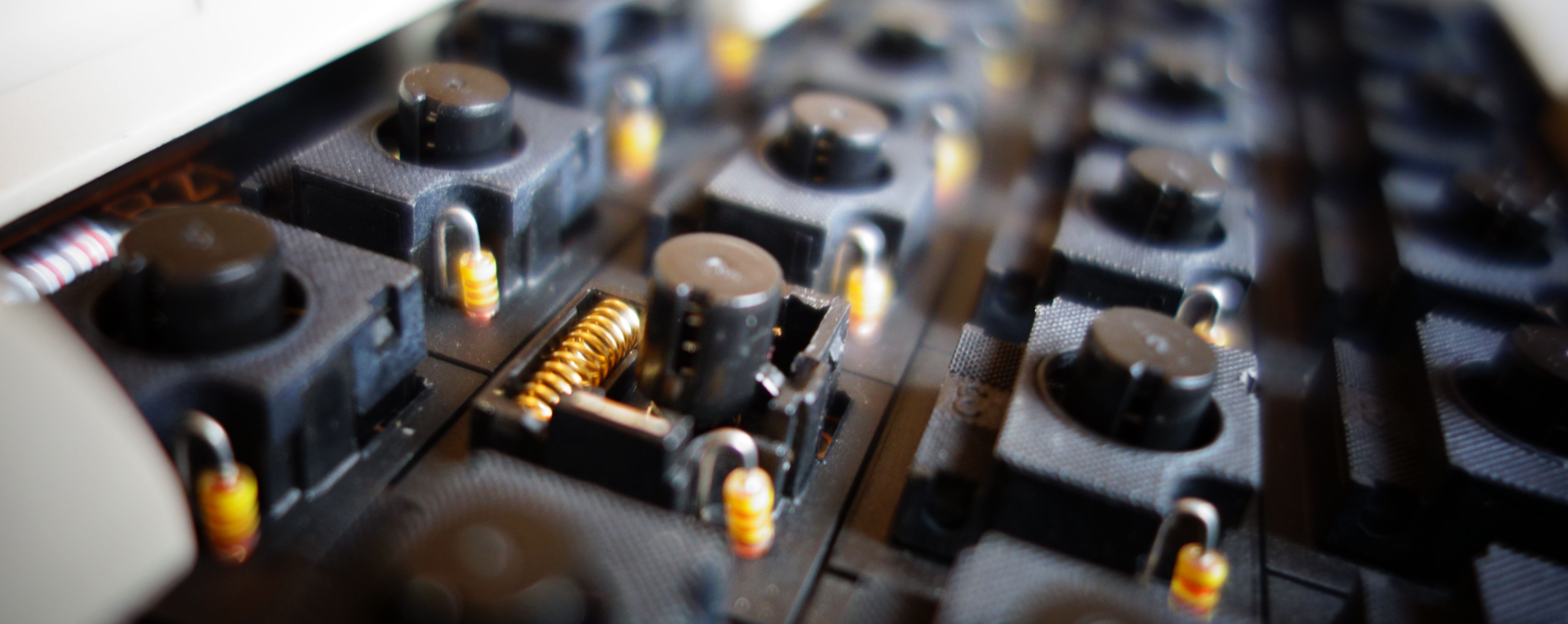

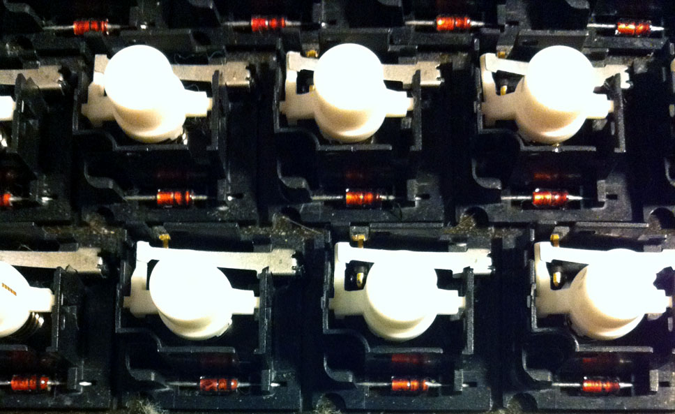

I have another keyboard with this switch (at least from your pics I'd say it's the same).
ImageLoewe. TBT 02 Keyboard by triplehaata, on Flickr
I'll try to dig up my Nokia Data keyboard to see if the pinout is the same. The housing seems very similar. Even the mechanism (leaf spring contact vs. coil spring contact) has the same principle.

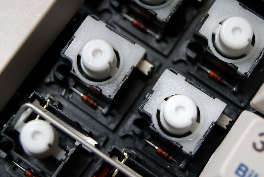

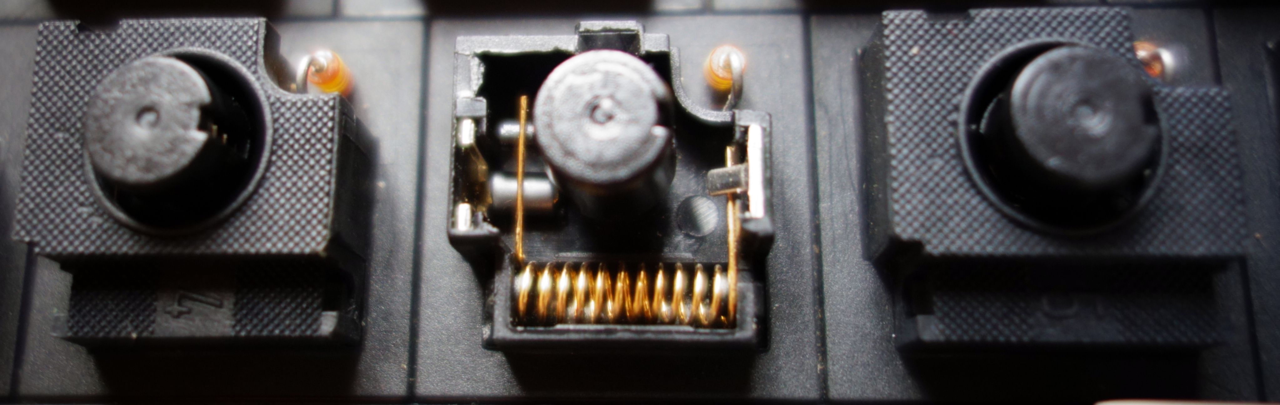

The switches opened( partially at least)
seems to be exact sames..?

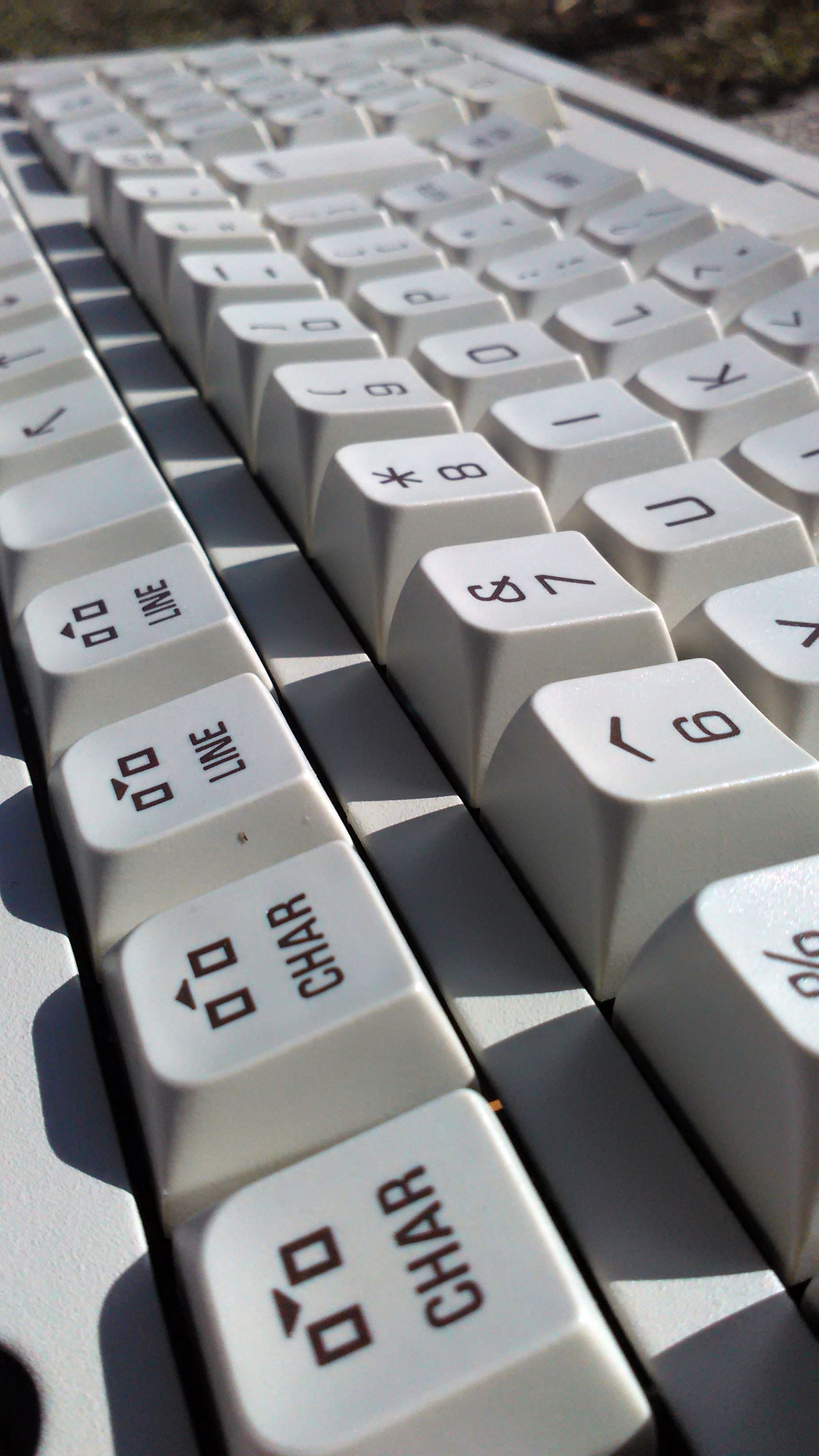

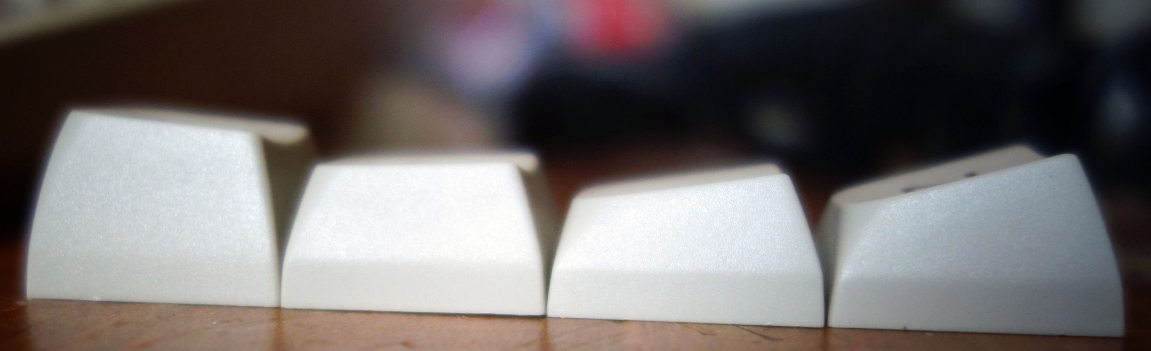

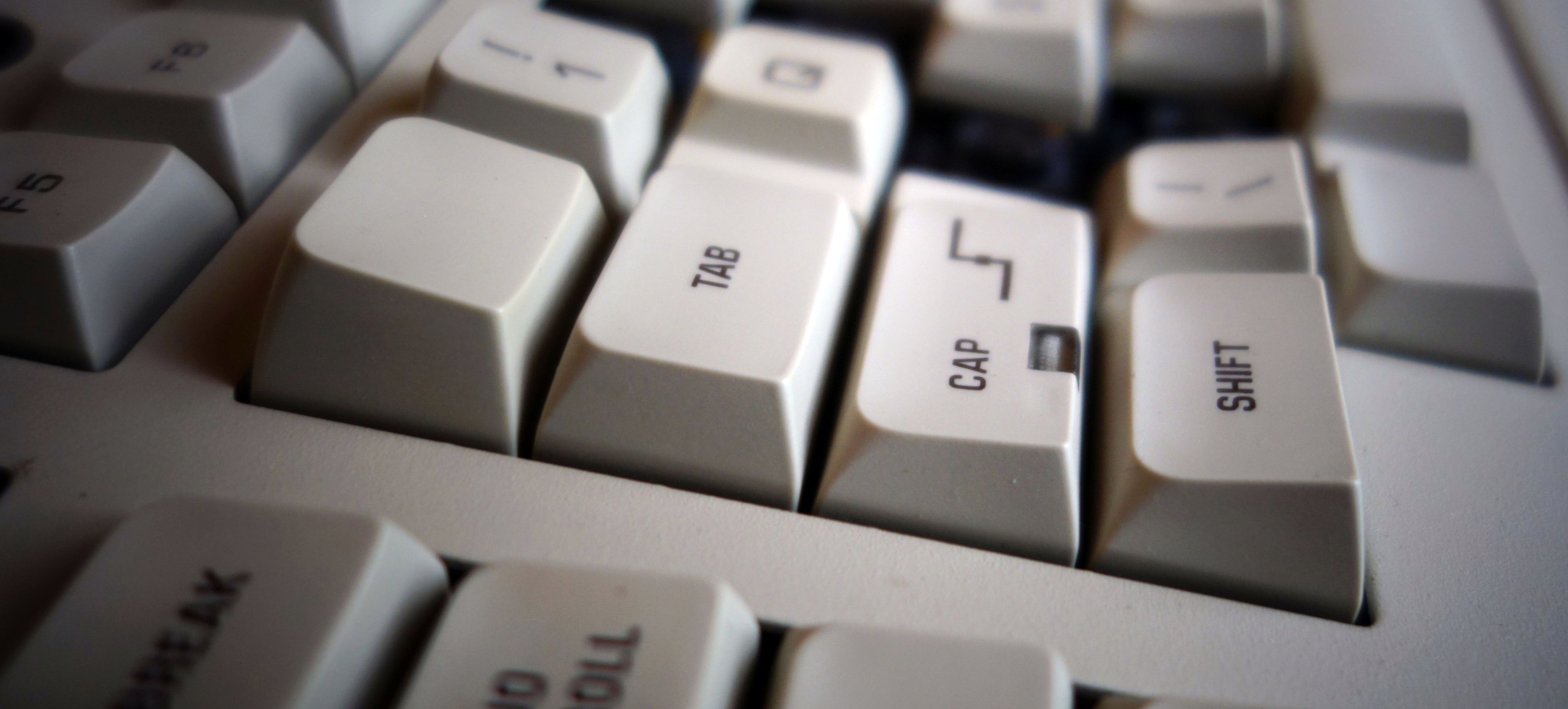

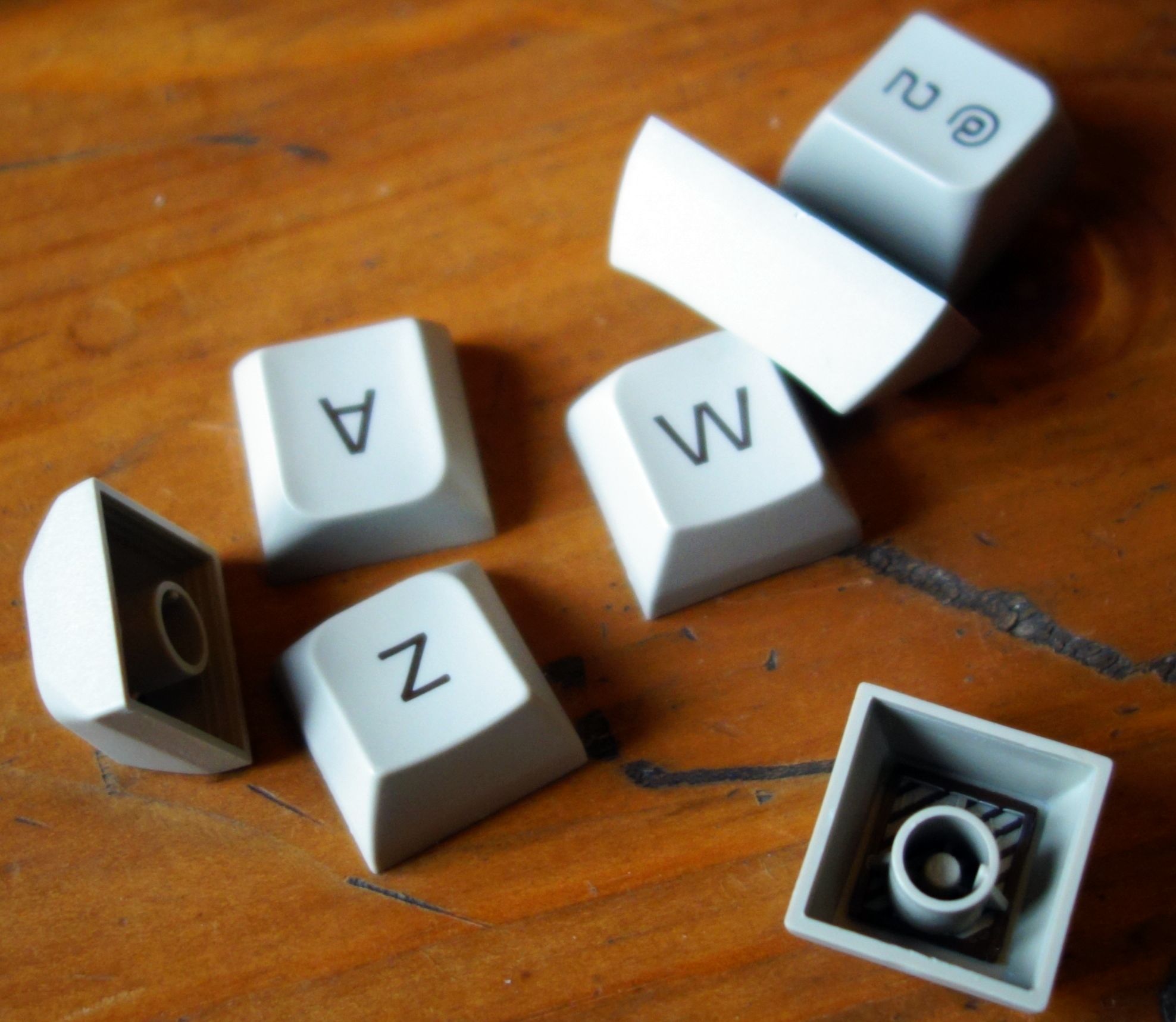

The caps profile
That caps lock cap
08 Feb 2015, 17:01
I want to cry …
No, you and HaaTa have the same switch.
The switch used on the wiki to illustrate the "ICL switch" (that I linked to) is a different switch.
This is sixty's unidentified keyboard (internally marked "SWEDEN" but with German keycaps):
This is intealls's Ericsson:
They might be related, but they're not the same design. Yours lack the diode position across the front (and are using the LED hole for the diodes) and the switch bases are larger and touch each other.
Both seem to have a slider that lifts up a metal contact, but while one has what seems to be a gold-plated spring (surely totally overkill) the other just has a flat spring.
There's a good chance that they're related, but I'd like stronger evidence. I'm doubting that ICL ever made them.

So, let's get rid of this stupid ICL name, because there's actually a product code on the switches!
ImageDSC_1568 by triplehaata, on Flickr
ImageDSC_1570 by triplehaata, on Flickr
RMD 973
I don't recognize the logo on the right (the three backslashes). A quick google of the switch code gives me nothing relevant. Once the logo can be identified, that will likely help a lot.
These switches are lightly tactile. A bit heavy (a tad frictiony though, more so that MX, but probably less than NMB Hi-Tek).
Unfortunately, all 3 switches (white slider with top casing, white slider without top casing, and dummy red slider without top casing) all have the same RMD 973. The red dummy switch has one of the pins clipped off it seems as well as a little rubber spacer between the leaf and the opposing contact (instead of a little gold spacer for contact) to prevent the switch from switching. The red dummy switch also doesn't have the arm to move the leaf spring.
I see no differences between the switch with and without the top casing (other than the top casing). The top casing interferes with the stabilizer bar, which is why it's not used for stabilized keys.
