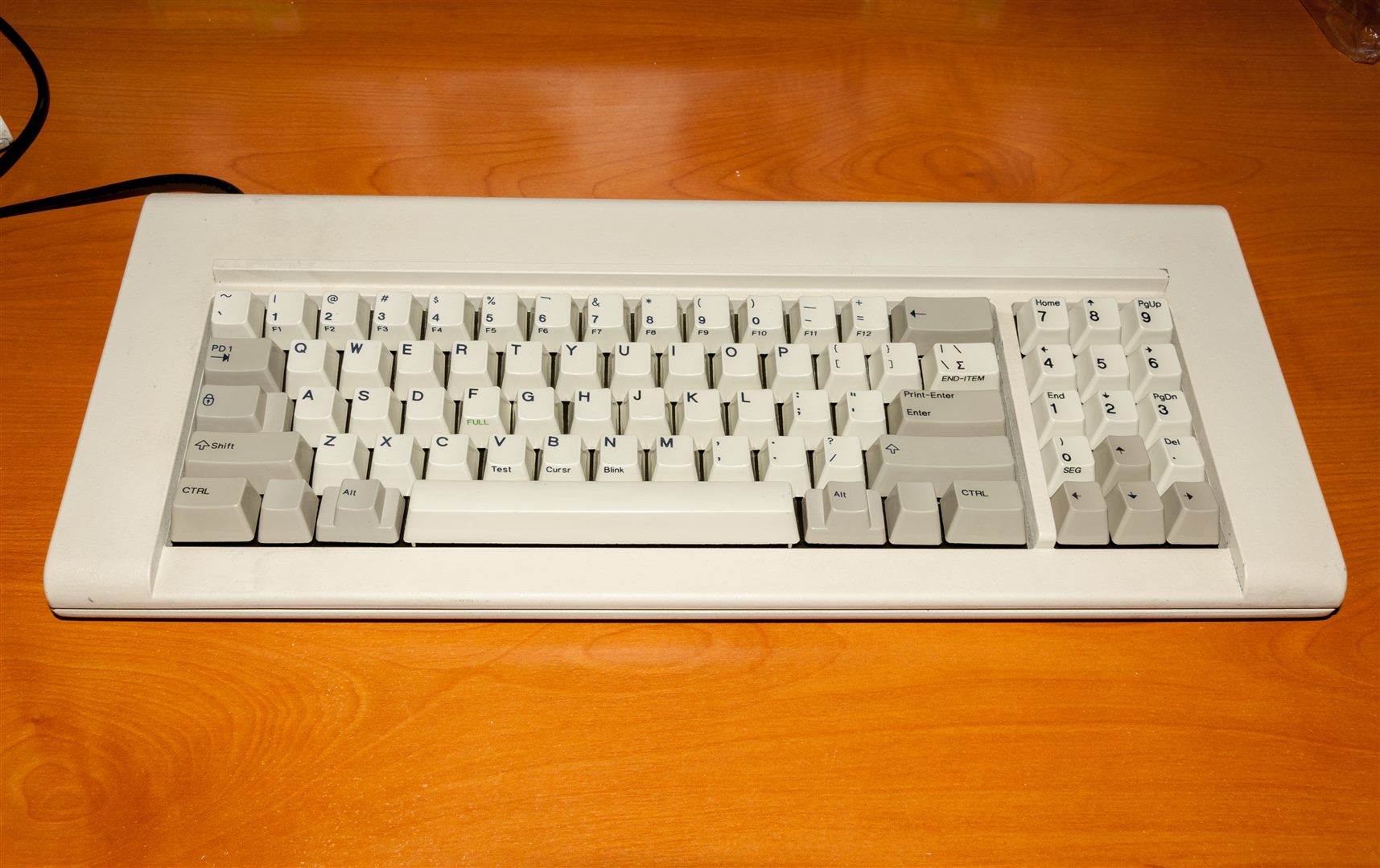

Does anyone want to use their own xwhatsit controller or buy a separate controller themselves for their F77 or F62? I am ordering the prototype quantity PCBs this Sunday evening (all of which require soldering a controller to the capacitive PCB). You would probably save just $10 or so on the order because the prototype boards are more expensive in low quantities. The keyboards will come standard with a USB controller included - this is just if you wanted to use your own controller.
The HHKB style split right shift PCBs will all require separate controllers given their lower quantities.

Sorry wyatt. Given the other larger Model F sizes are relatively widely available and often sell for $120 or less, they are not economical to produce in low quantities. I would check out eBay for an F122, F107, or PC AT. An F101 would be of similar size to the relatively more plentiful F122, F107, or PC AT.
I suggest ordering an F77. The F77 is approximately an SSK-sized Model F keyboard, just without the function keys being separate keys. You can make it look like my attached photo or make the right side's 15 keys be like the layout of an SSK (Print Screen, Scroll Lock, Pause, Insert/Del/etc., cursor keys). You can program the extra key between the right alt and right ctrl on the F77 as a Function key so you can press Fn+1 for F1, etc.

Ellipse wrote: I suggest ordering an F77. The F77 is approximately an SSK-sized Model F keyboard, just without the function keys being separate keys. You can make it look like my attached photo or make the right side's 15 keys be like the layout of an SSK (Print Screen, Scroll Lock, Pause, Insert/Del/etc., cursor keys). You can program the extra key between the right alt and right ctrl on the F77 as a Function key so you can press Fn+1 for F1, etc.
No thanks. I really like having dedicated keys for functions - while a SSK would be quite nice, I really don't fancy a keyboard without the dedicated home/end/page up/page down/insert/delete key cluster. It's tempting, but I'd rather go for one with a closer to standard layout. Maybe some day, though :)
