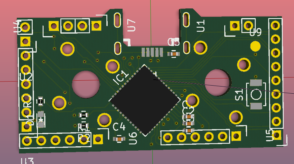

14 May 2016, 12:58
matt3o wrote:
pomk wrote: Hi all, I've been following this thread closely and I wonder if something like this could be useful?
This is an interesting concept. What are the exact dimension of this board? You would also need to consider other switch orientations (namely upside down :)) and compatibility with alps.
The board is exactly 1U x 2U, so 19.05 x 38.10.
With the through hole variant of the mid mount connector (thanks Matt_ for pointing out) I think that the routing will be a bit easier as the footprint is considerably smaller, it should also allow for upside down switches and alps switches without clearance issues. The mid mount connector sits flush with 1.6mm pcb bottom. The pcb connector can be moved up a bit if you want an island, although the cable connector already has a clearance of 2mm if I recall correctly and the pcb connector stick out by 1mm from the pcb outline. I can try to make the footprint for the through hole variant and see how much room we would have for routing.
I think that talking about islands is not that helpful, but rather what the compatible bezel sizes should be for a layered case.

Pomk's design looks appealing but uses pin headers with 2 mm pitch. They (and the corresponding receptacles) are a bit harder to get than 2.54 mm pin headers. Pomk's design also needs a through hole USB connector.
Isn't Pomk's board wider? Will it fit under 6.25u symmetric space bar? Not that I care about fitting under space bar at all, but it was the initial requirement.

- pomk's layout: basically OK, if it will fit / can be routed. My personal minimal requirements are
1) careful placement of USB lines' pads (best would be between the USB connector and MCU, or at least not very far).
2) routing: basically OSH Park's design rules. The reason is that they're by far the best source of (usually) quality PCBs in very small quantities (for DIY people). Means 6mil trace width, 6mil spacing (the larger we can do the better; power/gnd lines at least 10mil), 13mil via drill, 27mil via dia. {The vias are a bit bigger than what the chinese fabs usually require, but the big advantage is that even if the drill hits are slightly off it's still OK.}
pomk
15 May 2016, 19:11
I was not able to route it using the OHS design rules without creating a small island :(
Should have more than enough space to go with 2,54mm headers as well.
Note that this was just a feasibility study and the board should be routed with a lot more care than what I gave it now.
flabbergast
15 May 2016, 19:31
BTW the three 0.1uF caps are supposed to be physically close to the three VDD/VSS pairs of MCU pins (that's why there are three caps).
Now when it looks like there will be space: for the 2.2uF caps, if 0603 footprints will fit, it would be better. These are caps that stabilise the voltage, one for the regulator output, one for the usb input. These caps should be the best (parameter-wise) we can get, and a bigger footprint means we can easily get caps with better voltage rating. {Voltage rating: the max voltage a cap can see and *not* blow. The bigger the better for these caps, to survive potential voltage spikes.}
EDIT: More comments about the onboard caps: the board *won't work for sure* without at least the 2.2uF on the voltage regulator output. It will probably work without the 0.1uF ones, although reliability may vary. The 2.2uF between USB 5V and GND is there to protect the MCU from spikes on USB (can happen e.g. when plugging in).

Wait, I count 34 pins, don't we need like 41 pins? Also, I think we should have in-switch LEDs as well as diodes for the switches, or am I missing something here?
Matt_
15 May 2016, 20:13
I have to admit I don't quite understand the purpose of the switch pads. For builds with no PCB, where the controller is meant to be soldered under switches? Are we not losing lots of space (and possibly pads along the edges of the board) going that way?
vvp
15 May 2016, 20:29
Cumulative capacitive loading on USB power lines should not exceed 10 µF. That is the limit of the USB specs. If I understand it correctly we are now at 2*2.2 + 3*0.1 = 4.7 µF. So there is still space to increase the capacitors but not more than about 2 times.
-[°_°]-
15 May 2016, 20:46
mohitgarg wrote: Wait, I count 34 pins, don't we need like 41 pins? Also, I think we should have in-switch LEDs as well as diodes for the switches, or am I missing something here?
technically we would also miss ALPs compatibility
pomk
15 May 2016, 21:33
Just a feasibility study. Also no need for diodes, as those would be in the main pcb, for hand wired use I would add small holes near the pads so that you can easily wire them up to the whole matrix. Upside down alps is easy to add, for both orientations one would need to move the usb connector up a bit.
