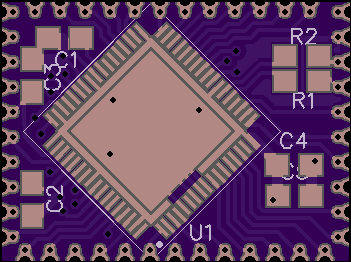

suddenly have this idea to make 20x20mm castellated module (1.27mm pitch) and just soldering it to PCB with whatever form factor is required. Or even to the sense card.

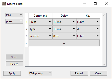

Feature parity!
So I kept my part of the promise, finally.

Macros! Congratulations and thanks for all your hard work. I hope to have a need for a few CommonSense controllers one of these days.

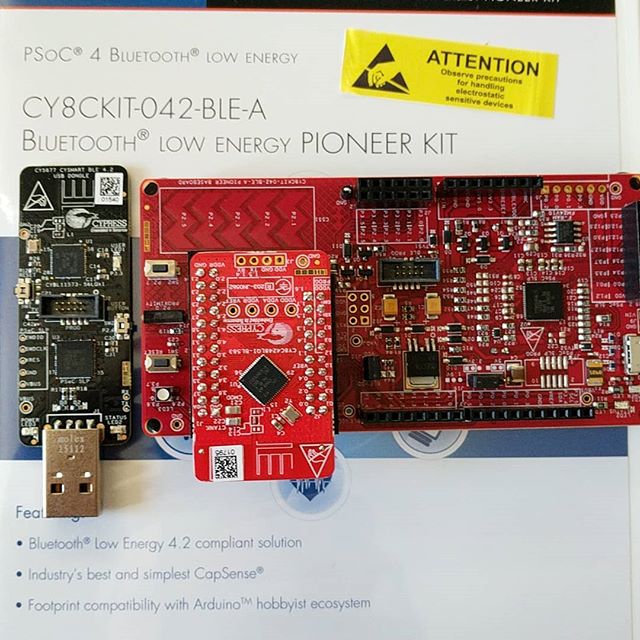

DMA
05 Apr 2018, 04:34
https://www.instagram.com/p/BhLAcDchf-k/
First BLE model F in the world.
It's typing gibberish because it's an XTant layout and profile soldered to F122 PCB.
But it has 18 KRO. Over BLE. Which is, I'm reasonably confident, is also first in the world.

18x13.5mm castellated module for soldering to breakout PCB.

Nice. Smaller than 1U. It could fit in that space between Esc and F1.
I will see if I can draft a matrix up.
What layout would you like to see? 104, SSK, or something else?
