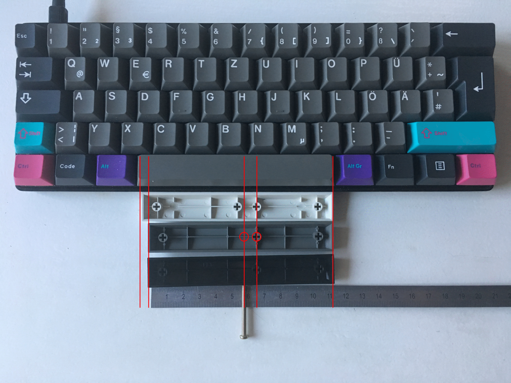

07 Aug 2017, 19:58
regarding the stem positions of the 6U spacebar.
do they really interfere?
there are two 6U spacebars on the picture. one is pbt from a 1800 and the other one is abs from a german gmk dolch gb. the beige one and the one on the poker are 6.25U.
to me it looks like center and off-center stem position of the 6U spacebar doesn't interfere at all. is there another off-center position for the stem that i'm not aware of?
anyway, i still hope the 6U off-center-stem spacebar will be a part of the gb
manzel
07 Aug 2017, 20:04
The problem is that these do not interfere with each other but with a switch housing of a switch mounted in the other position.
PlastikSchnittstelle
07 Aug 2017, 20:06
AHH, OKAY!
thanks a lot, again, learned something :)
