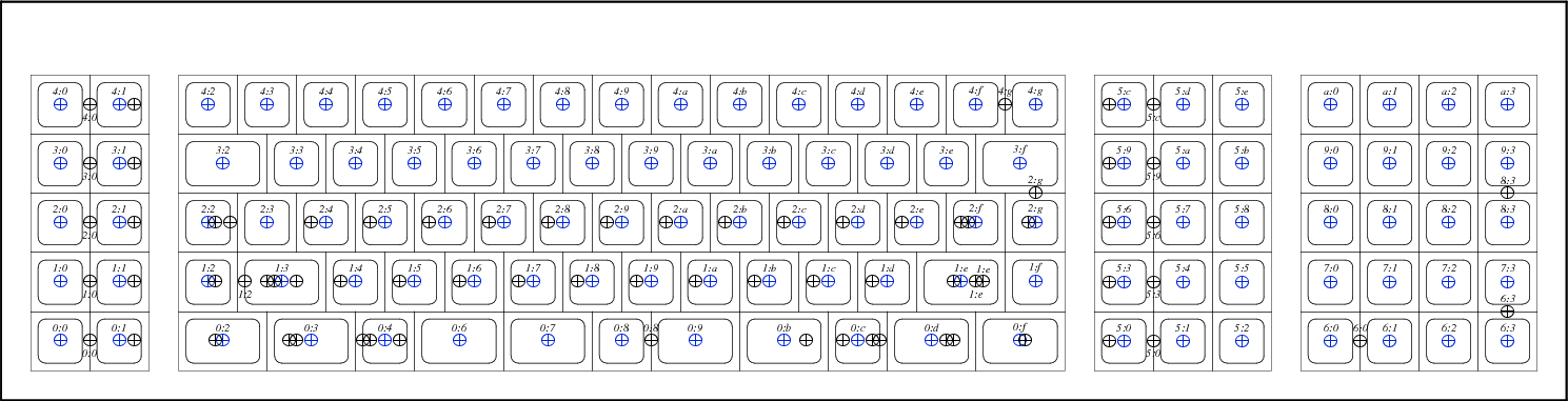

How about a 70% PCB in addition to all 60% and 75%? Lets combine two good concepts into the ultimate compact keyboard. Herer are my quick design drafs on that.
30 Nov 2012, 17:12
simkev wrote:How about a 70% PCB in addition to all 60% and 75%? Lets combine two good concepts into the ultimate compact keyboard. Herer are my quick design drafs on that.
Something similar to your design is already in the pipeline...

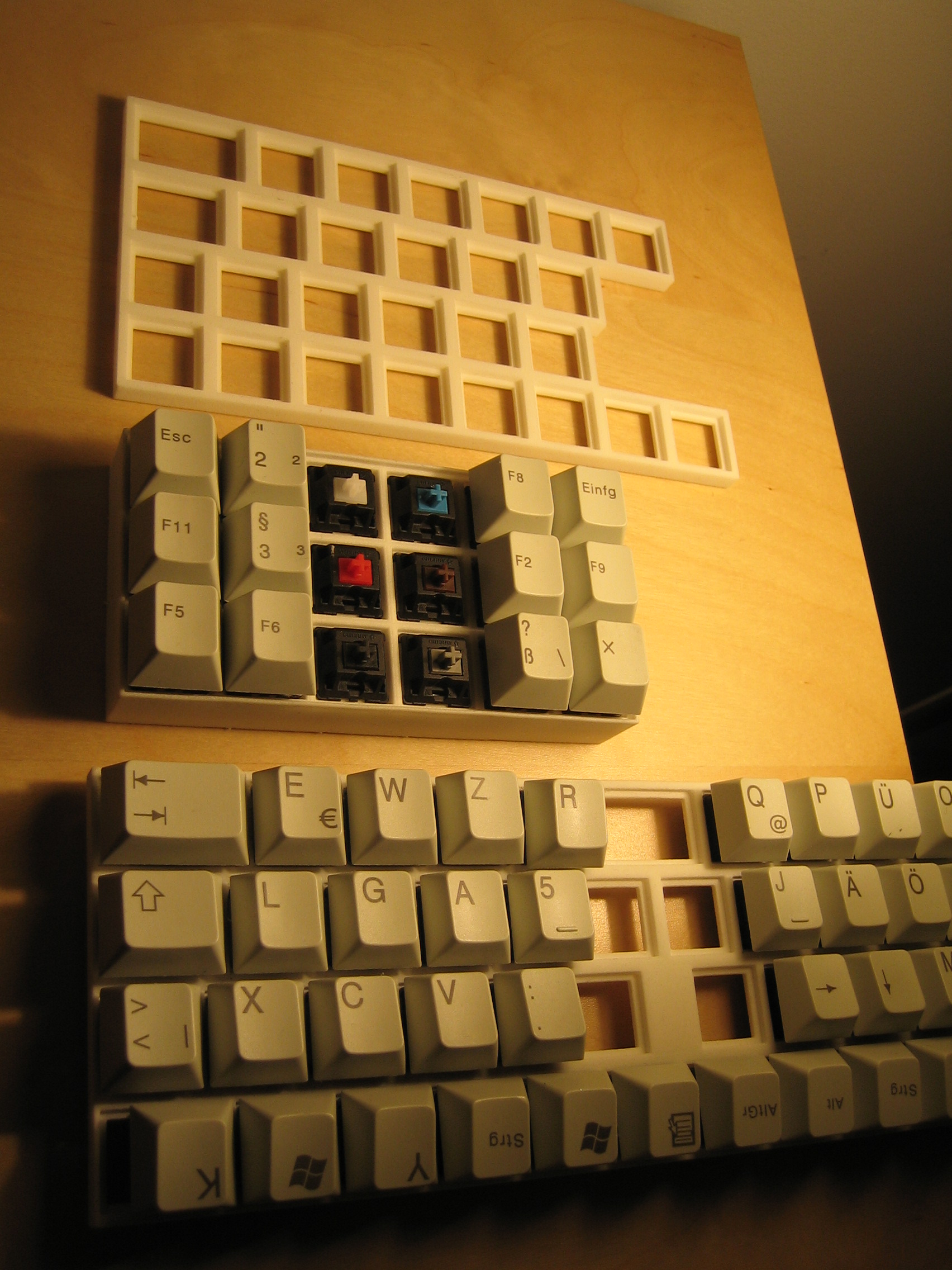

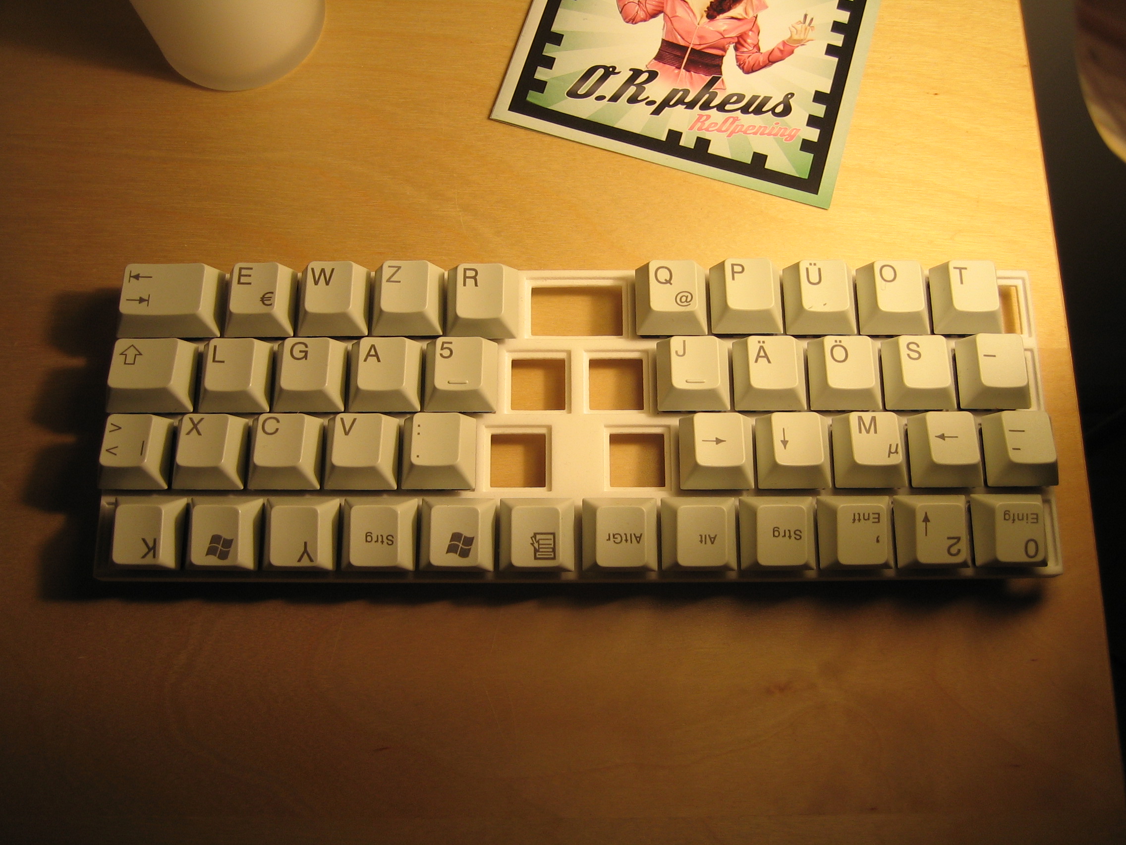

Inspired by these designs I quickly prototyped a simple variation of the 7bit version since I always wanted to have another keyboard with my custom AdNW layout, but more portable than the split BlueCube that still is my daily work equipment.
A complete layout hides beneath - but ignore all letters
And after a few minutes of simulated typing I must say it feels pretty impressive: Not quite perfect like a split board in my opinion, but the symmetric stagger together with a larger hand separation makes typing feel very close to that freely adjustable setup. And the clean looks of it plus the tiny footprint will make this my next project, I guess :D - how convenient that I ordered spare teensies in advance, but which switches shall I use?
Which switch? And split again?
The middle part will house trackpoint and teensy, and I feel confident that minimalizing down to only 5 columns per hand is the right way to go - I haven't been using the outer pinky columns anymore since switching to AdNW.
Guess 7bit will then have the honor of picking a name for this design once finished after starting this whole idea again, and kindly organizing my supply of switches.

Suka, that is impressive, as usual. Is there any chance you could make the files for that plate available? I want one.
suka
frobiac
30 Nov 2012, 18:06
Ascaii wrote:Suka, that is impressive, as usual. Is there any chance you could make the files for that plate available? I want one.
Thanks - sure, I can post the blender 3D sources or STL's for direct use at shapeways next week. But for now I did not design a full case around it yet, to be more flexible and produce cheaper :)
