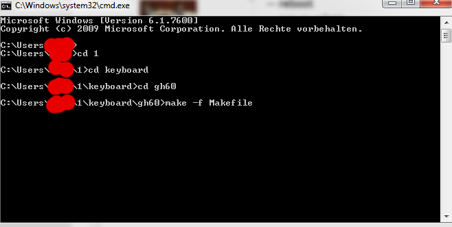

You can run win xp or 7 on a virtuell machine to compile.
btw this my cmd window, I have win 7 and it works perfect
2015-08-30 09_28_16-C__Windows_system32_cmd.exe.png (24.66 KiB) Viewed 8031 times

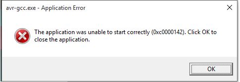

I also get the same problem as other people earlier in this thread, I cant compile any firmware. When I enter the command I get the same application error as MayonaiseInstrument and cmd prints the same (I think) as LeandreN got and posted on page 8 and 9.
I have tested to restart my pc, run cmd as administrator, run it on multiple machines, one running windows 7 and one 8.1.
I would prefer to be able to compile it myself as I'm not totally sure in how I want the layout yet or have not written a full custom version of the code designed around my preferences. (the error occured both when I tried to compile a first try of my design and with the TMK_keyboard "out of the box", only extracted but not modified)
I guess it must be something that we three all do in common as we're all beginners to programming and we all get the same or similar error message.
Hope someone have an idea, would be awesome to be able to use my cystom made (atomic) keyboard. :)

Hag.com wrote: Now I just go to the directory with the code and use the command make -f Makefile without touching winAVR. Is it being used automatically by that command?
Yes. Think of the Makefile as a recipe telling the compiler(s)/linker what files to compile and how to put them together. make is the program that reads the recipe and runs the compiler and then the linker.
By the way - since you reference the error messages appearing in this thread - did you actually try the suggestions that are there?
First, mcturtles reported that this fix has worked for him. It pretty much means that the tools that winavr includes are really old, and need some fixing up.
If you prefer not to "fix up" the winavr, but instead go with a clean install of the current versions of the tools, you can install cygwin (or msys) and avr-gcc: install first "normal" cygwin (be sure to install "devel" tools (make, ...)), and then also get newer avr-gcc compiler, for instance from here.
flabbergast
06 Sep 2015, 21:05
Yes. Think of the Makefile as a recipe describing what files to compile and how to put them together. make is the program that reads the recipe and runs the compiler and then the linker.
If you prefer not to "fix up" the winavr, but instead go with a clean install of the current versions of the tools, you can install cygwin (or msys) and avr-gcc: install first "normal" cygwin (be sure to install "devel" tools (make, ...)), and then also get newer avr-gcc compiler, for instance from here.[/quote]
