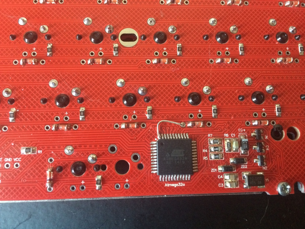

I finally had some time to put mine together. Like others, had keys that would not register... damn. Time to go through the check: Switch tested good, diodes on the board tested good, voltages at test points were good... I couldn't figure it out. After replacing some diodes that didn't fix the problem, I finally got the hang of how the board is routed. I then tested some pins off the IC and found a whole bank of the matrix without a connection. Completing it manually worked... so I kludged together this:

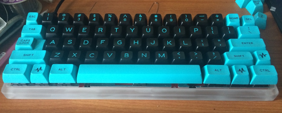

It works perfectly now. After everyone's trouble with the mounted components, I assumed my problem had to be the same... but it appears that the board itself is bad. I'm fortunate to have extensive DIY electronic experience; keyboards are much easier to trouble shoot than audio gear (I can leave the o-scope in the closet). Anyway, here's the glamor shot:
