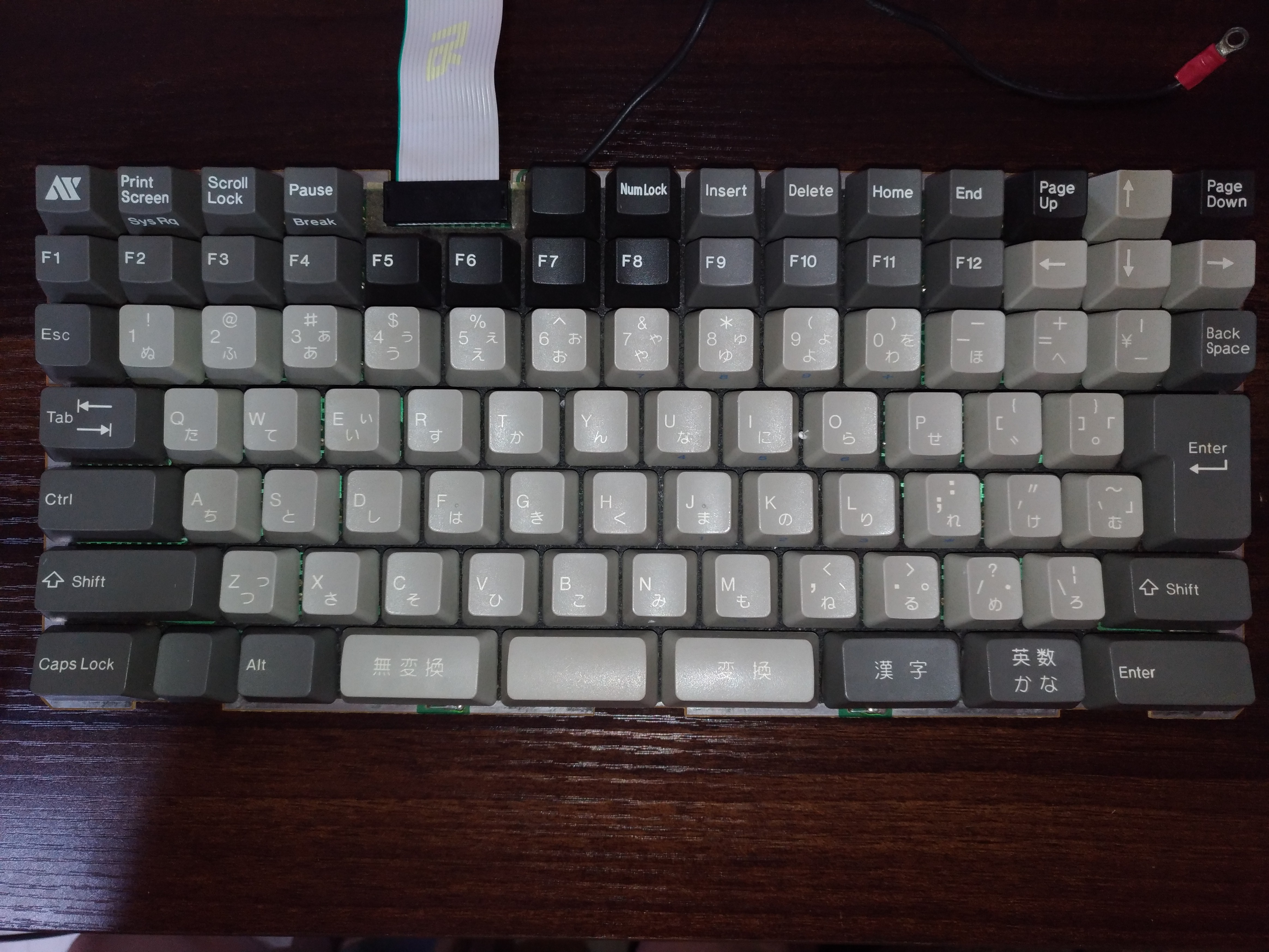

Alps SKFL,SKFL Compact
From Mitsubishi laptop computer

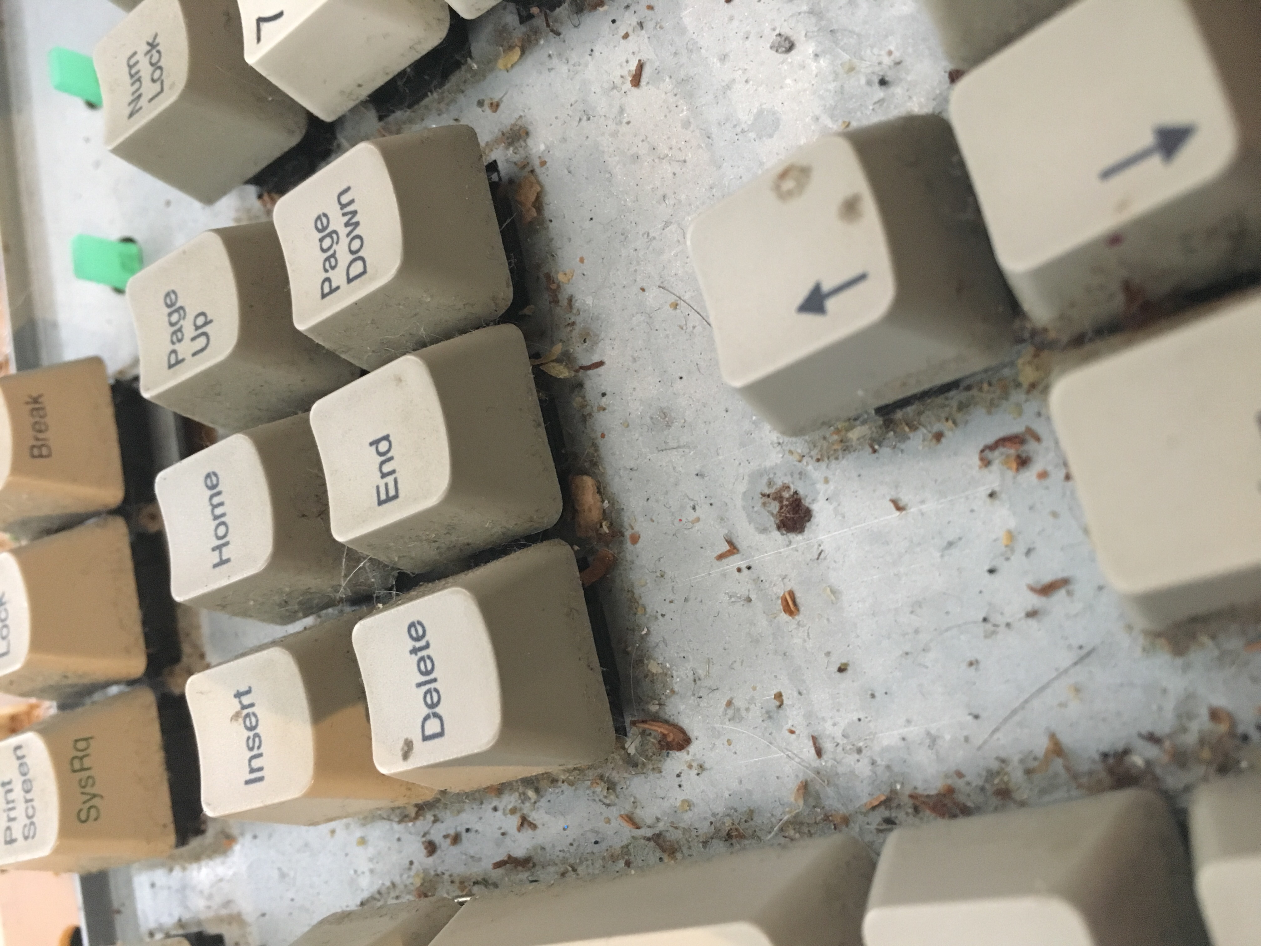

Just recently I acquired a DC-2014. It apparently had been stored somewhere for a long time......*with one of those flexible key board covers in place*. Happy happy joy joy, the switchs are in near NOS condition.

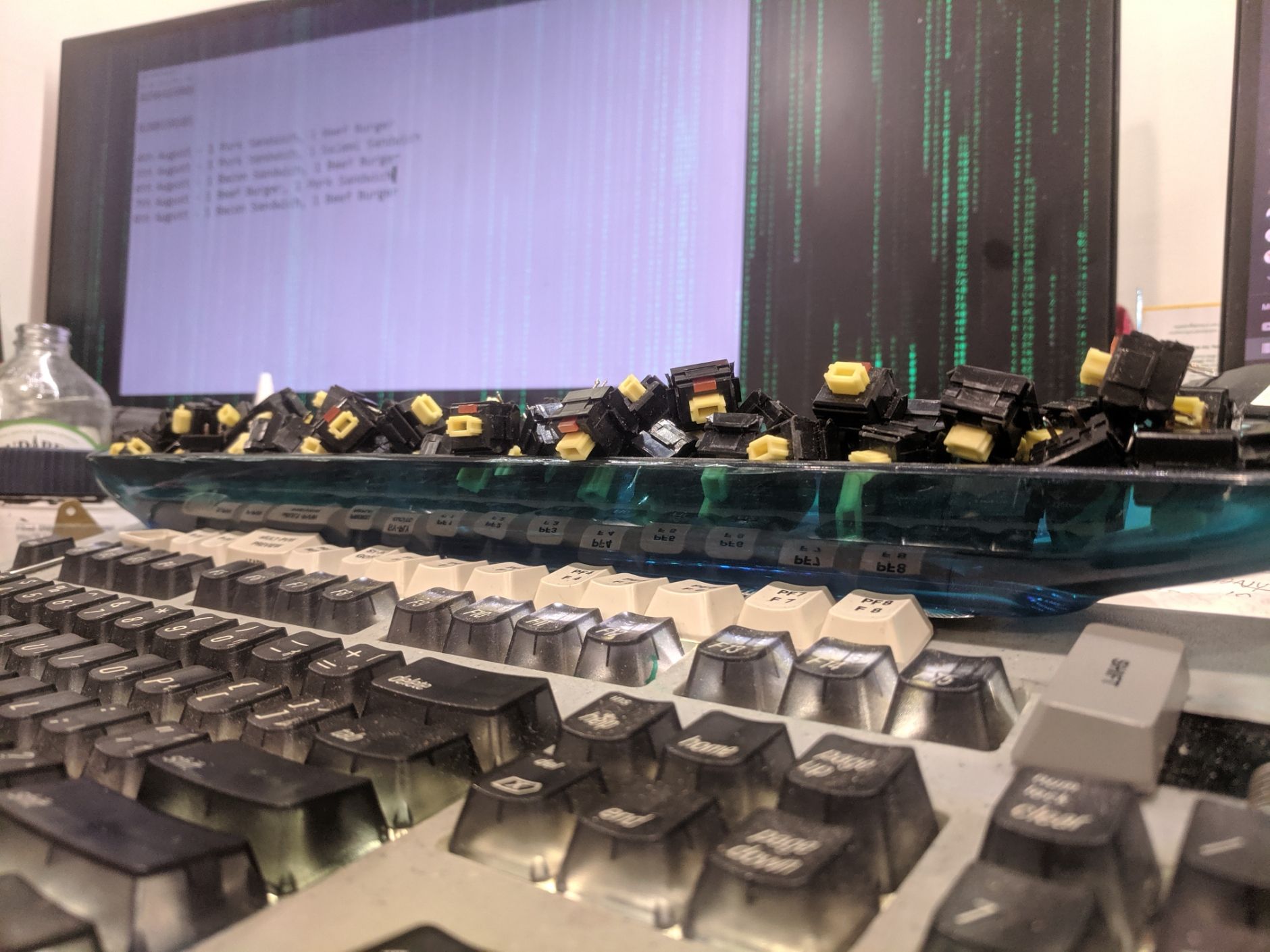

I've disasembed all of my orange alps with help from chyros (thanks btw :D) while I'm waiting for my ultrasonic cleaner to be delivered. I was wondering what I should put in the ultra sonic cleaner. I have read that you should not clean the sliders because it takes off the factory lube, but I cannot see any on them right now. I alps bought some dupont dry lube. Should I use that? I've read really mixed reviews with lubrication on alps. should I clean the springs or the tactile leaves?
05 Aug 2019, 10:35
Rezene wrote: 05 Aug 2019, 04:48 I've disasembed all of my orange alps with help from chyros (thanks btw :D) while I'm waiting for my ultrasonic cleaner to be delivered. I was wondering what I should put in the ultra sonic cleaner. I have read that you should not clean the sliders because it takes off the factory lube, but I cannot see any on them right now. I alps bought some dupont dry lube. Should I use that? I've read really mixed reviews with lubrication on alps. should I clean the springs or the tactile leaves?
I'm doing an experimental piece on Alps lubrication exactly to try and prove or disprove what does and doesn't work. I've got it scheduled for late september though, so it'll be a little while longer.
In the meantime what I CAN tell you is that if you sonicate anything, be sure to at least END with a good rinse of deionised water. Most people just sonicate in it to begin with, or use something like Decon.

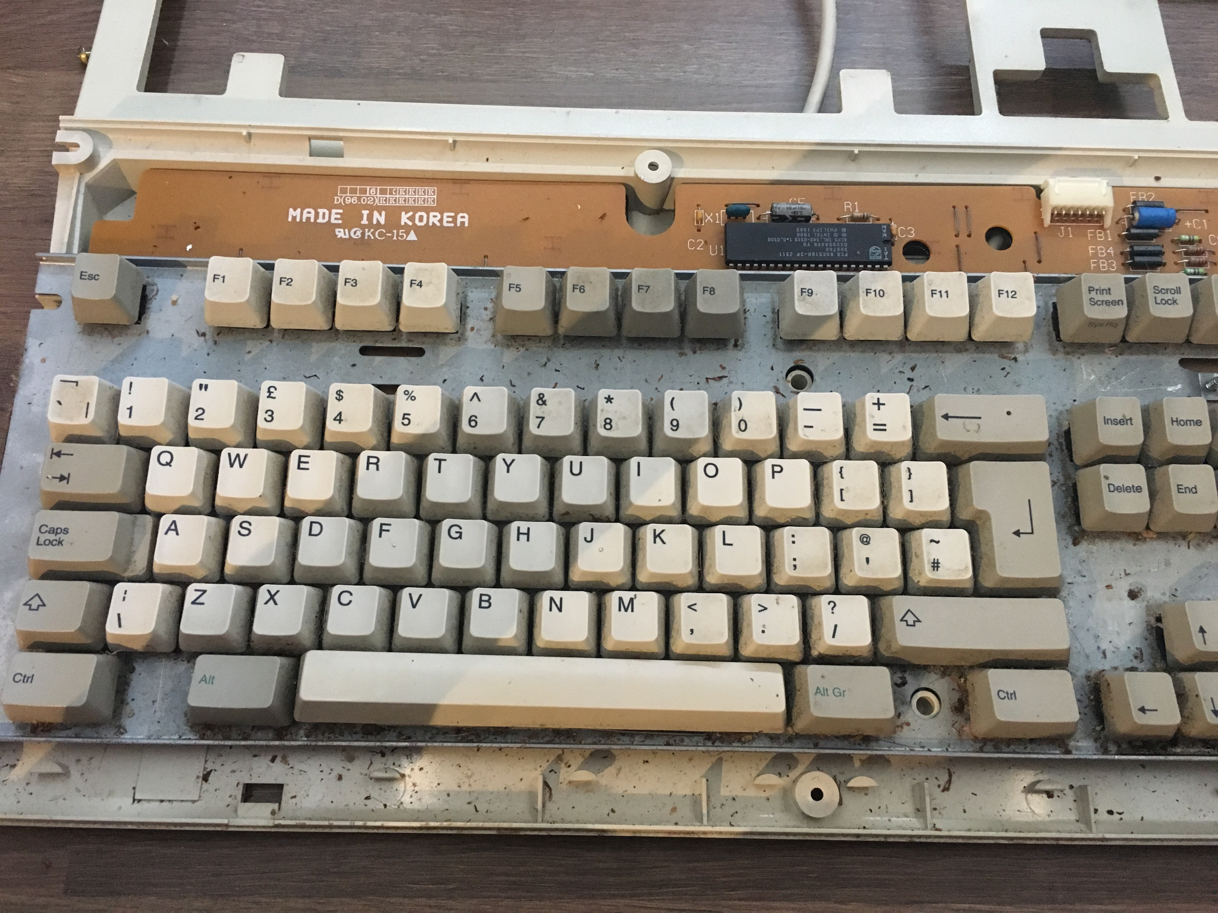

Donnelly20
06 Aug 2019, 22:27

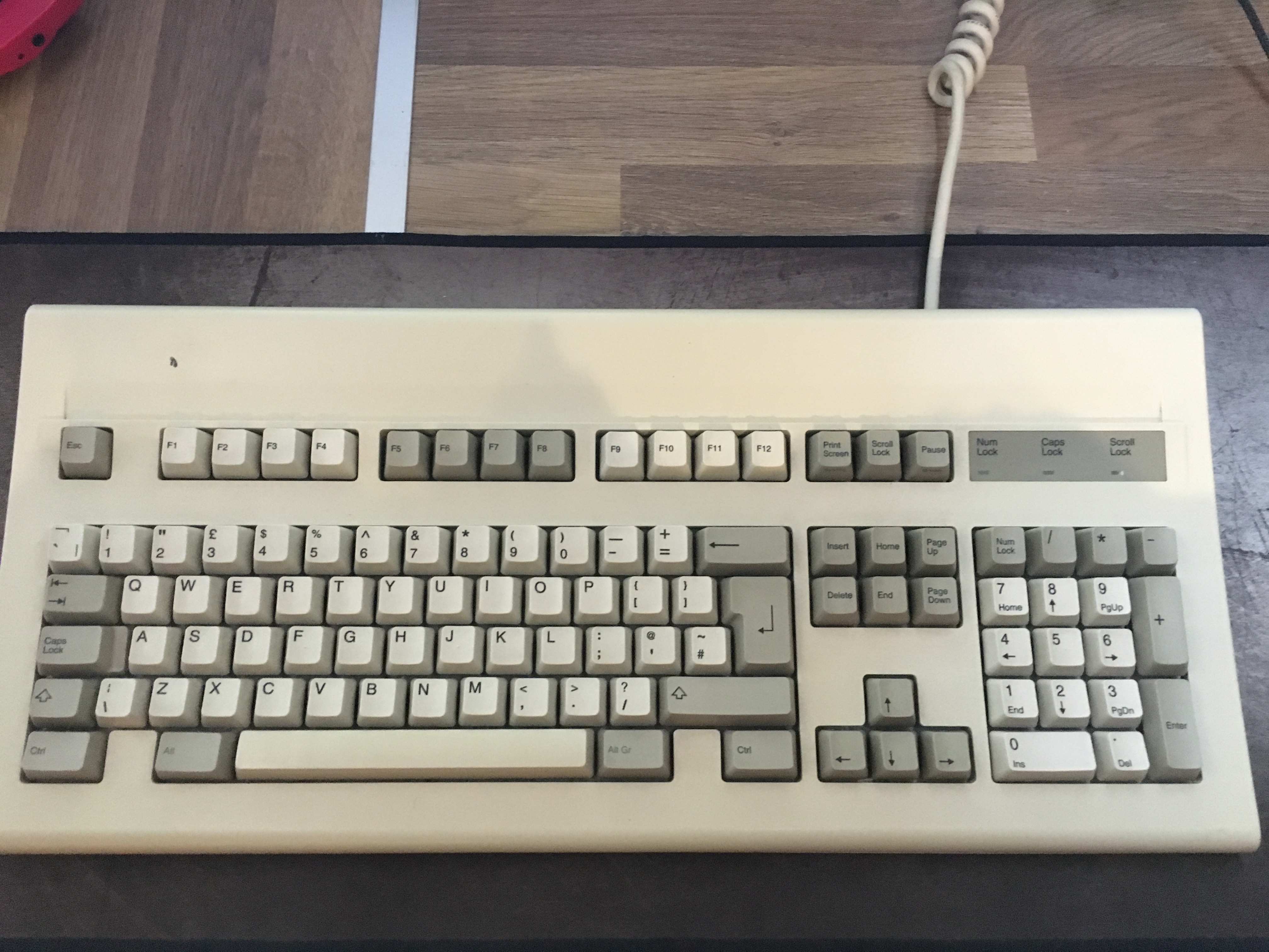

Im relatively new to alps boards, whites being my first ever alps switches and here is my board with some before and afters. Its an Alps made AT102.
Its a really nice board before i got it i was using a gateway 2000 and before that a corsair k70 and i can already say i prefer the White alps to the cherry reds in the k70.
As i said im a beginner with alps boards i gave mine a once over and opened a few switches that felt scratchy.In the future i may plan to fully dismount all the switches as i would like a project and the corroding mounting plate gives me the incentive, i was planning on stripping its paint but i was not sure what to replace it with and also maybe change the switches to blue alps .
Suggestions gladly considered :D

cli
10 Aug 2019, 15:50
Donnelly20 wrote: 06 Aug 2019, 22:27 Its a really nice board before i got it i was using a gateway 2000 and before that a corsair k70 and i can already say i prefer the White alps to the cherry reds in the k70.

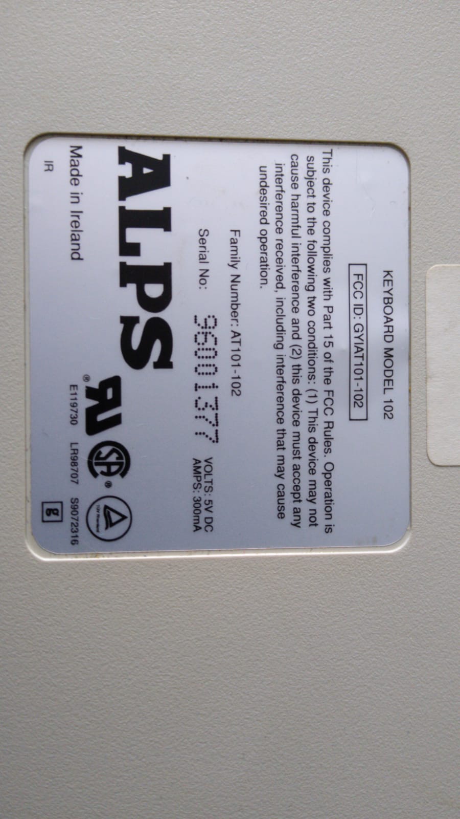

Alps Bigfoot boards are quite nice. Although the Dell AT101's made by Silitek look the same they are lighter then the Alps Bigfoot (1.44 kg vs 1.66 kg, I weighted them few days ago).
You can fix scratchy switches by lubing the sliders. On Youtube you can a find a video how to lube Alps switches, it's made by fellow member Wodan. I use a plastic lunch container instead of a Ziplock bag, add 10-12 drops of dry PTFE and shake it for few minutes. I then dry the sliders for few days before assembling it back in the switches.
Succes!

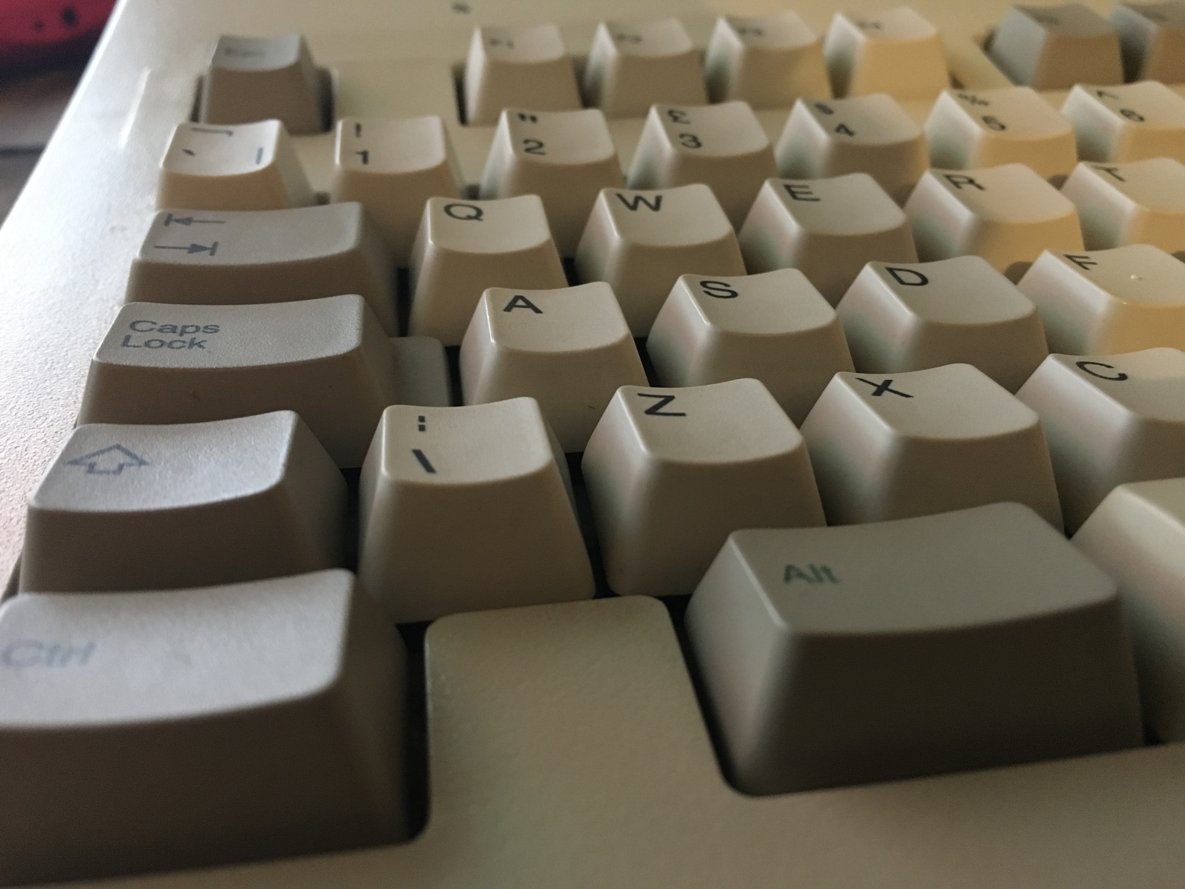

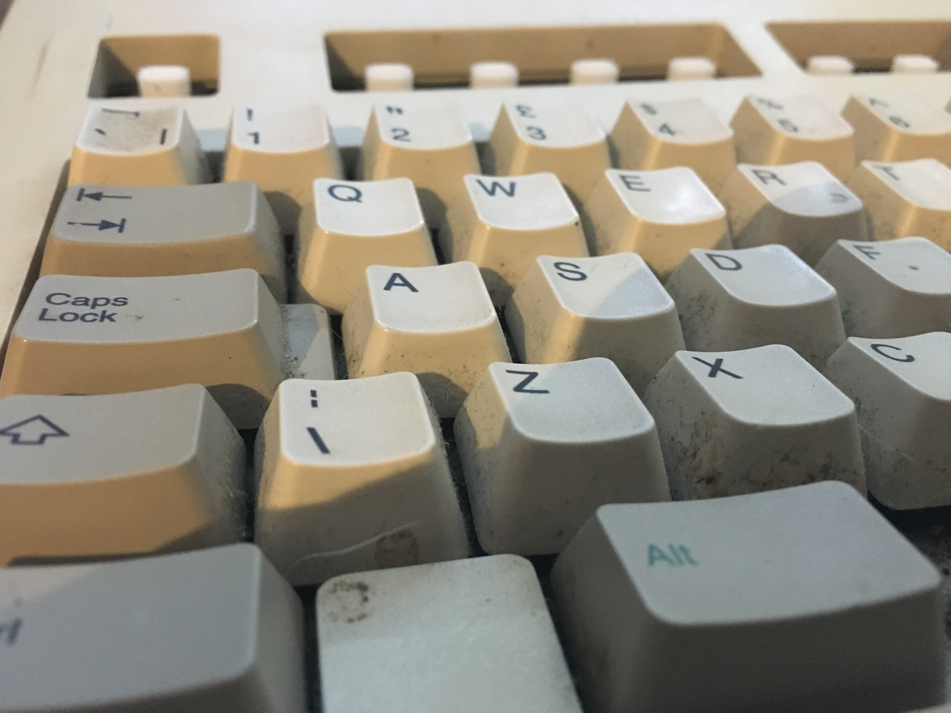

19 Aug 2019, 17:31
Hello everyone!! I have a question regarding Apple's m0116.
I've got this keyboard recently, and after disassembly, I found that this one has multiple different switches.
It seems that it has orange, salmon, and cream switches?
I do not think somebody had modded this one.
Is this a common phenomenon for m0116?
Thanks in advance!
