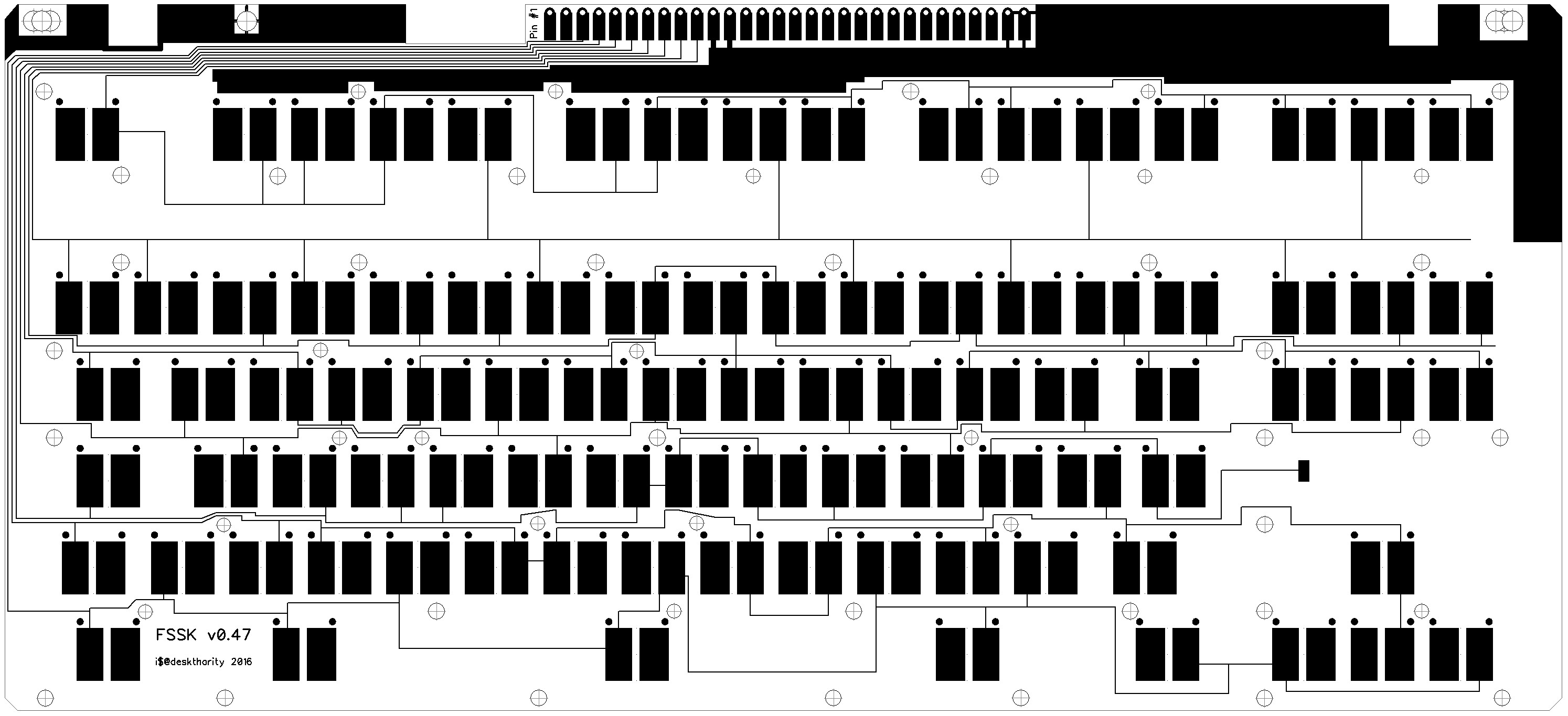

wcass wrote: Is there room for the case bolts? The two rectangular cutouts at the top/back of the back plate.
You mean space of the case part to mount the screws. You are correct. I missed that. Actually, the connector may be in the way !
Again, your comments saved the prototype.
Immersion gold is probably overkill.
This was the only option offered to us in the web page !
idollar
i$
05 Jan 2016, 07:10
__red__ wrote: That's actually a pretty good price. Who are you using?
http://www.pcbway.com/
idollar
i$
05 Jan 2016, 07:12
Also notice that the pcb will be 0.4 mm. This means that the keyboard will be approx 0.2 mm higher than normal.
I will try a plate with this thick and test the complete set in the case before ordering.

idollar wrote:Also notice that the pcb will be 0.4 mm. This means that the keyboard will be approx 0.2 mm higher than normal.
I thought the F was .8mm?
That will double your capacitance. Is that intentional?
idollar
i$
05 Jan 2016, 12:38
Yes, it is.
Bending 0.8 will be difficult.
If the prototype is to sensitive, we could always run a second test with smaller pads.
__red__
05 Jan 2016, 12:41
I've been poking my working F with an oscilloscope this morning and I'm just writing another post about it.
At least with the stock controller methodology I'm pretty sure it will make it easier to detect. The detection window is pretty short compared to the rest of the duty-cycle.
idollar
i$
05 Jan 2016, 13:48
__red__ wrote: I've been poking my working F with an oscilloscope this morning and I'm just writing another post about it.
Yes, a very good idea.
The link to your post follows: http://deskthority.net/workshop-f7/alte ... 12533.html

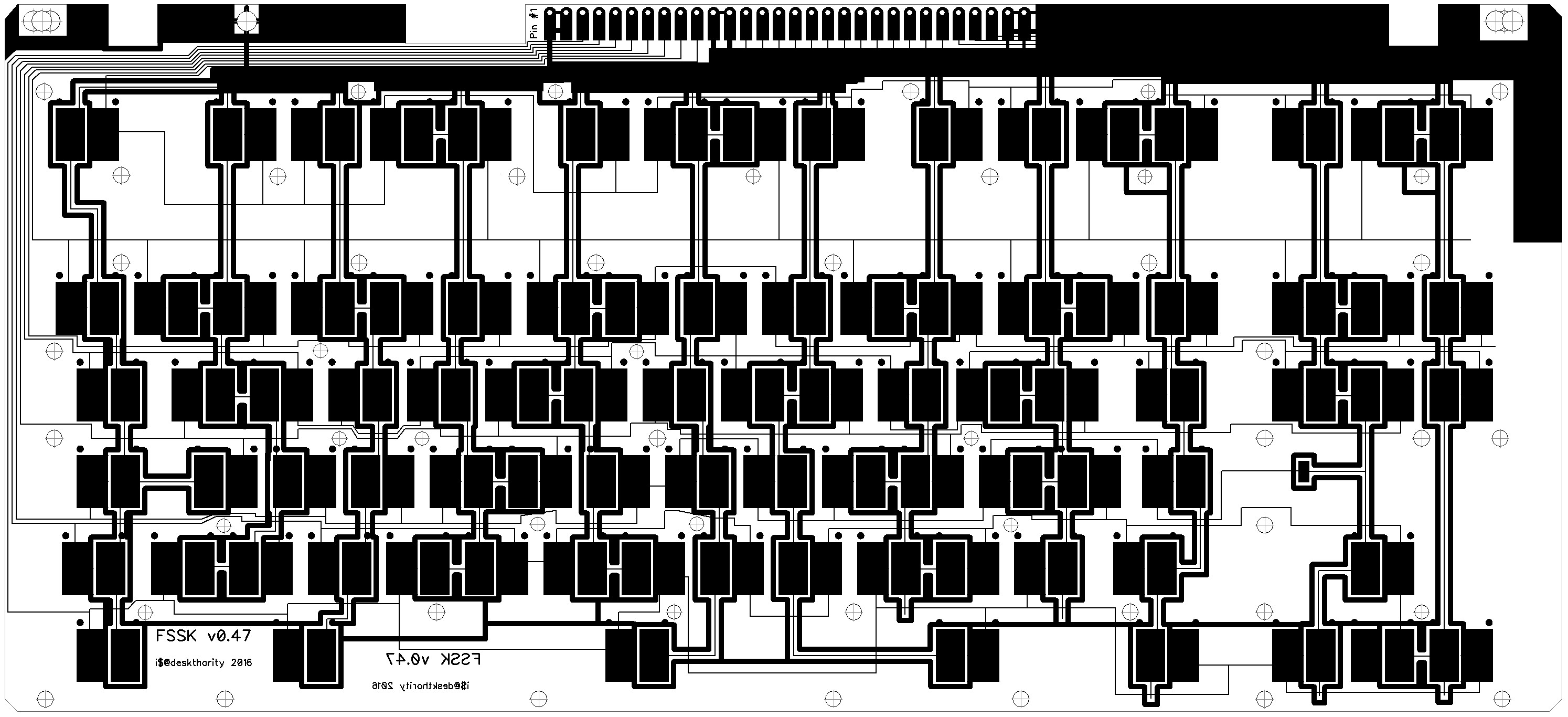

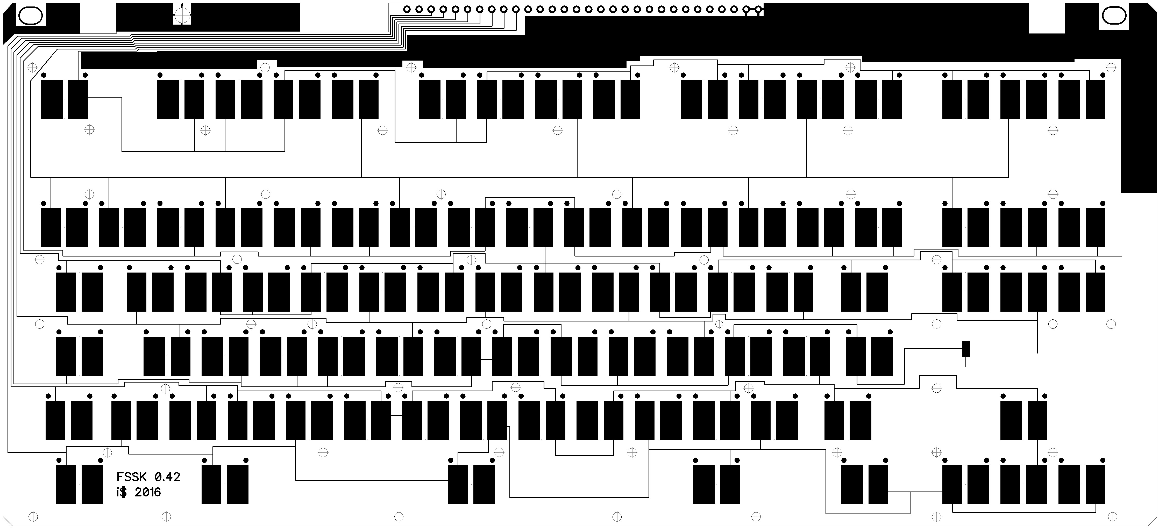

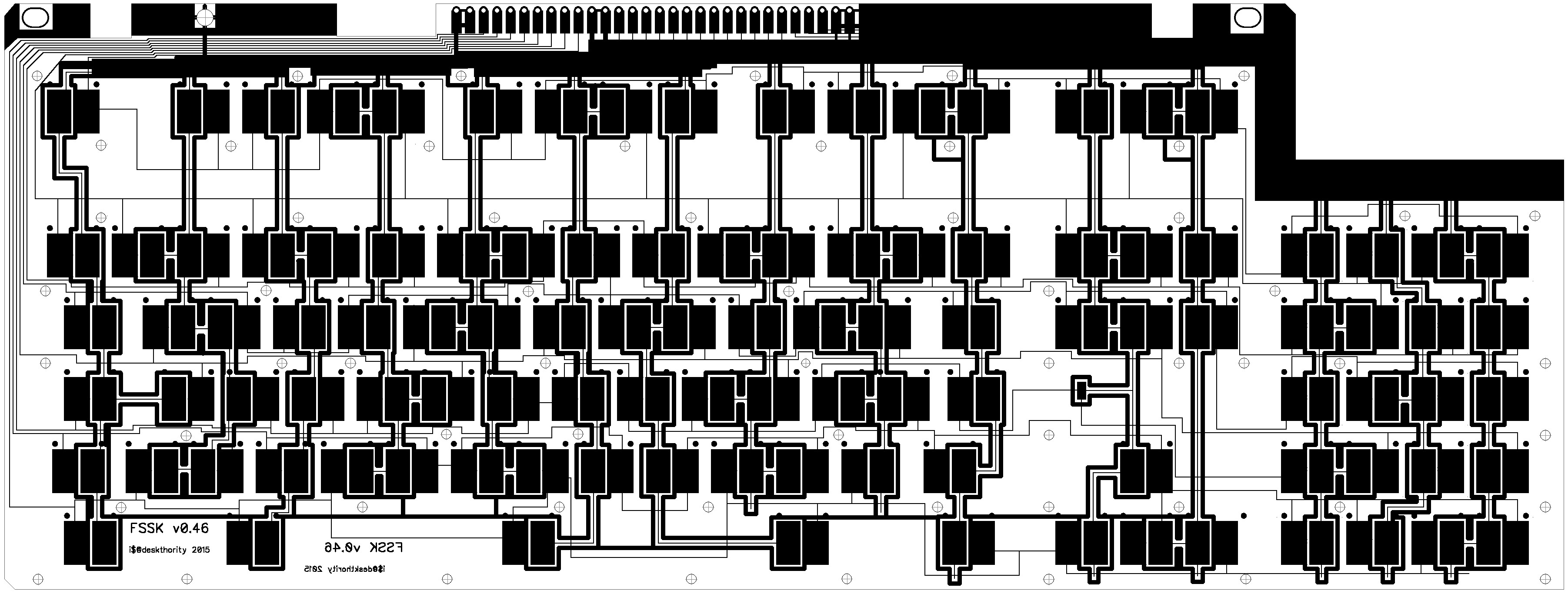

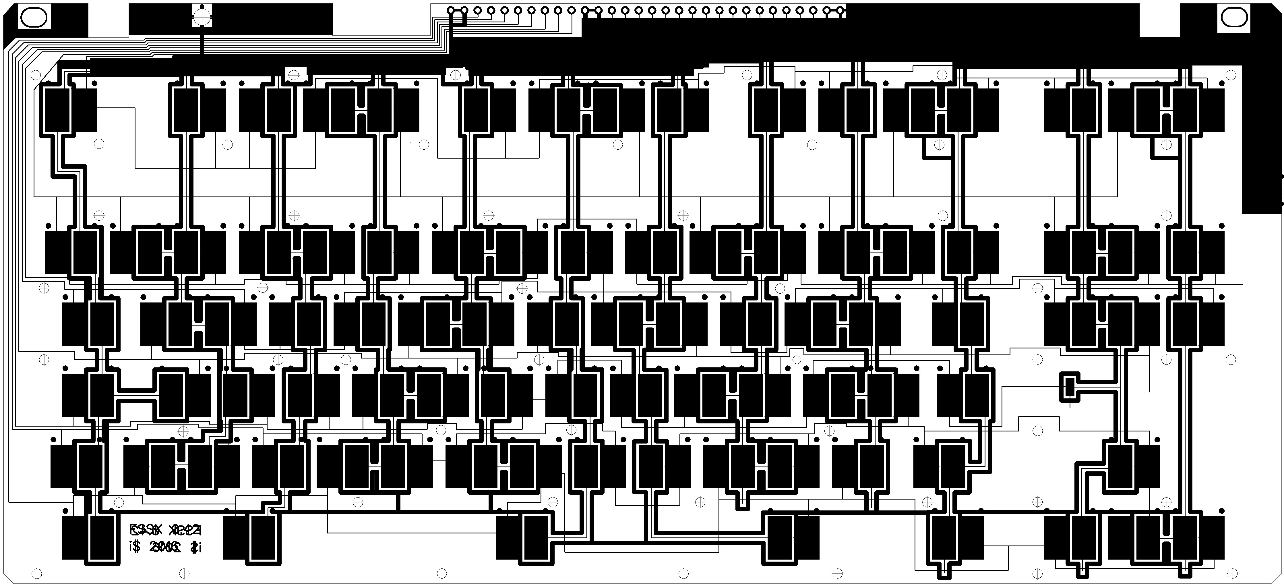

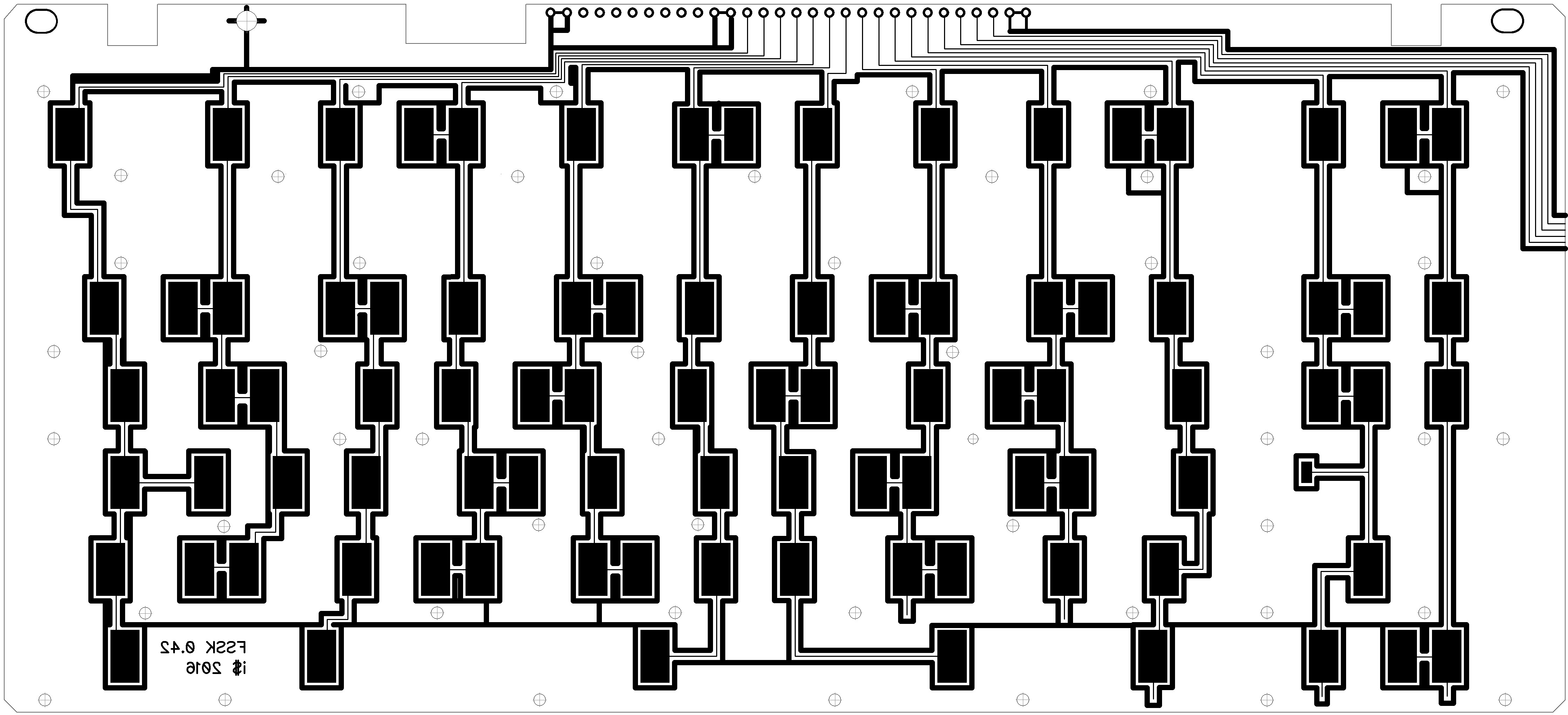

Following the updated version 0.42 for your review:
FSSK - Diptrace v42 - top.jpg (729.98 KiB) Viewed 9795 times
FSSK - Diptrace v42 - bottom.jpg (811.64 KiB) Viewed 9795 times
FSSK - Diptrace v42 - both.jpg (994.97 KiB) Viewed 9795 times

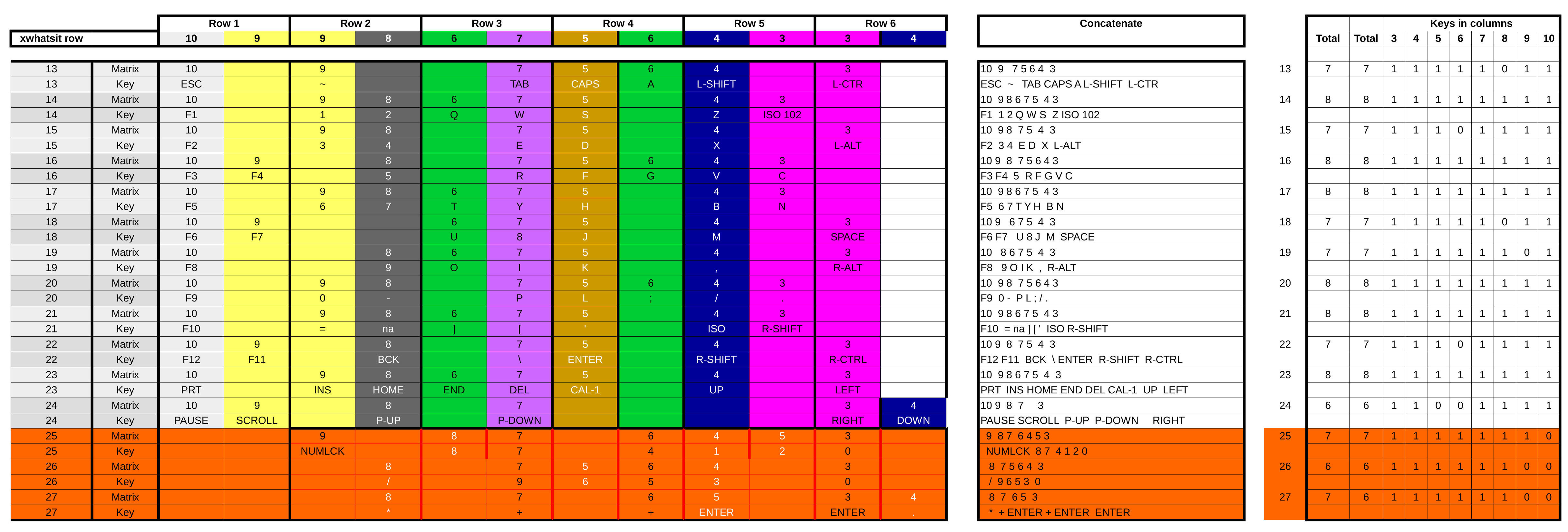

Edit: The key design follows:
Design 0.42.jpg (885.63 KiB) Viewed 9696 times

wcass
05 Jan 2016, 18:00
I'm not sure you noticed that row traces and the USB connection are on opposite sides of the controller. If the USB is pointed at the cable connect hole, the row traces are on the right.
You can flip the controller around and point the USB connector to the right, but make sure you have room. Or we could use __red__'s controller - but then we would want to change the trace spacing and connection method - and we would be testing two things at the same time.
idollar
i$
05 Jan 2016, 19:22
wcass wrote: I'm not sure you noticed that row traces and the USB connection are on opposite sides of the controller. If the USB is pointed at the cable connect hole, the row traces are on the right.
Yes, I have noticed it.
The problem is that the columns for the FEXT (Extended) shall leave on the right of the PCB, towards the numpad. If I order the PADs the way around, the amount of column traces will increase at the top of the PCB as they have to cross all the top area, making impossible to route the row traces. It was already very difficult to route the left-top part of the PCB to accommodate the holes.This is why I took this decision.
There is no need to flip the controller. If we use a ribbon cable, it could be soldered with the controller pads pointing to the centre of the case. The USB plug will still point to the right side, but a longer USB cable will do.
We will need a solution to secure the USB cable. The connector is very weak and will break in this position if we do nothing.
chzel
05 Jan 2016, 19:31
Perhaps a zip tie around the right screw post would be enough. It will make the cable inside quite long, but it will be secure. Or a P-clip, but that would leave the case gaping a bit.

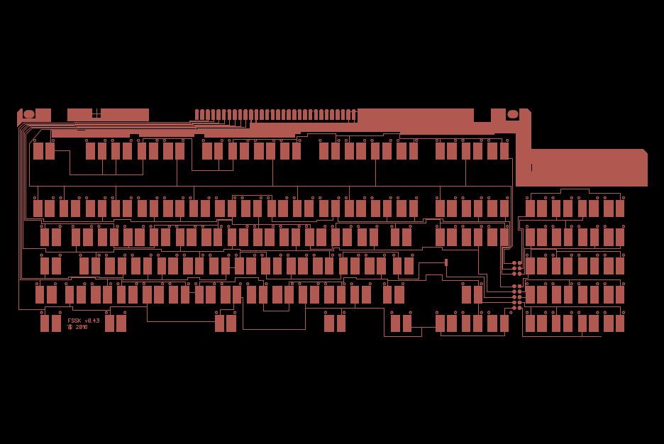

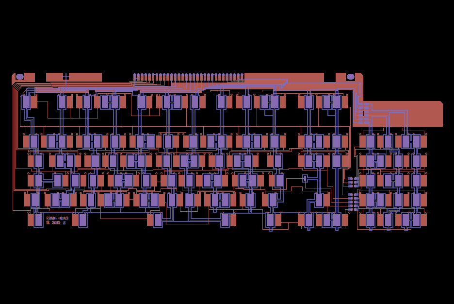

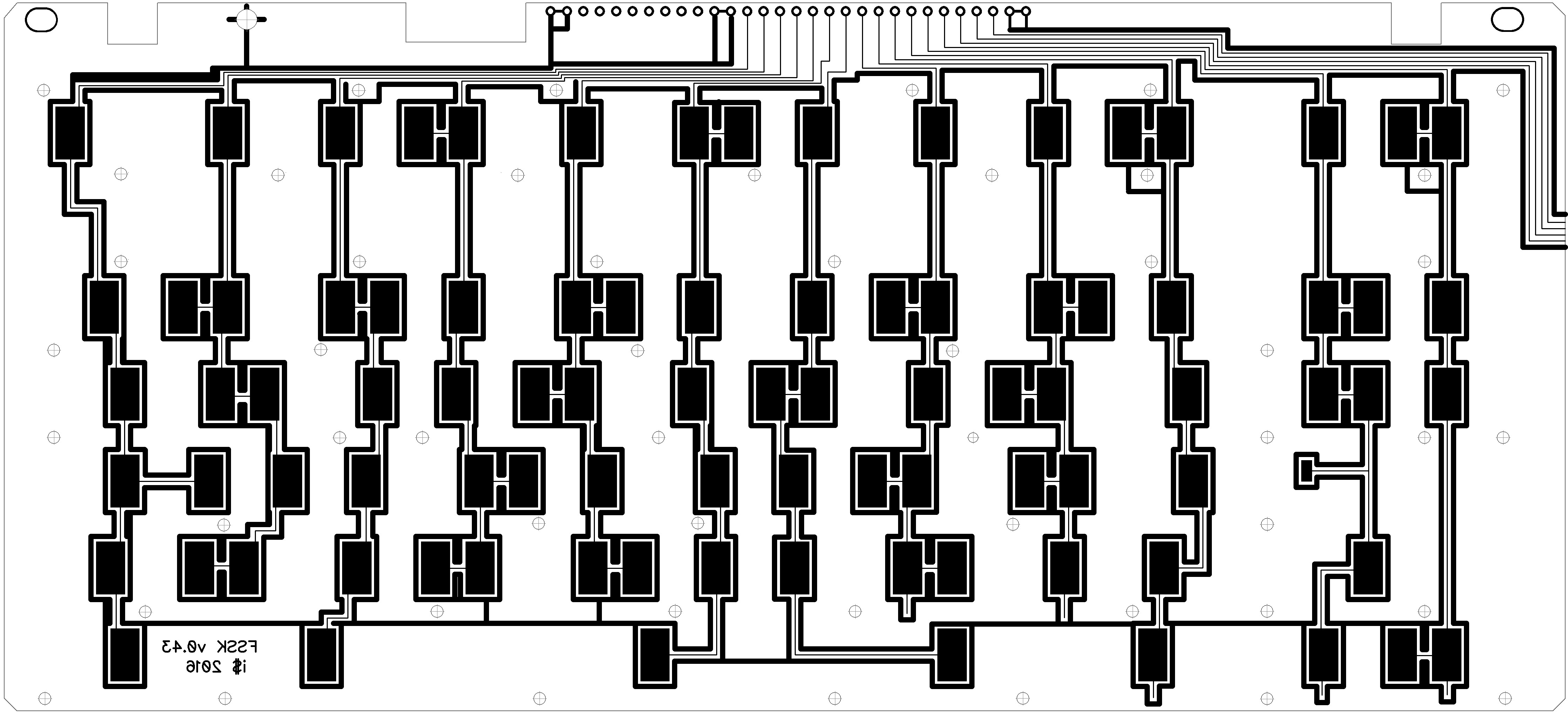

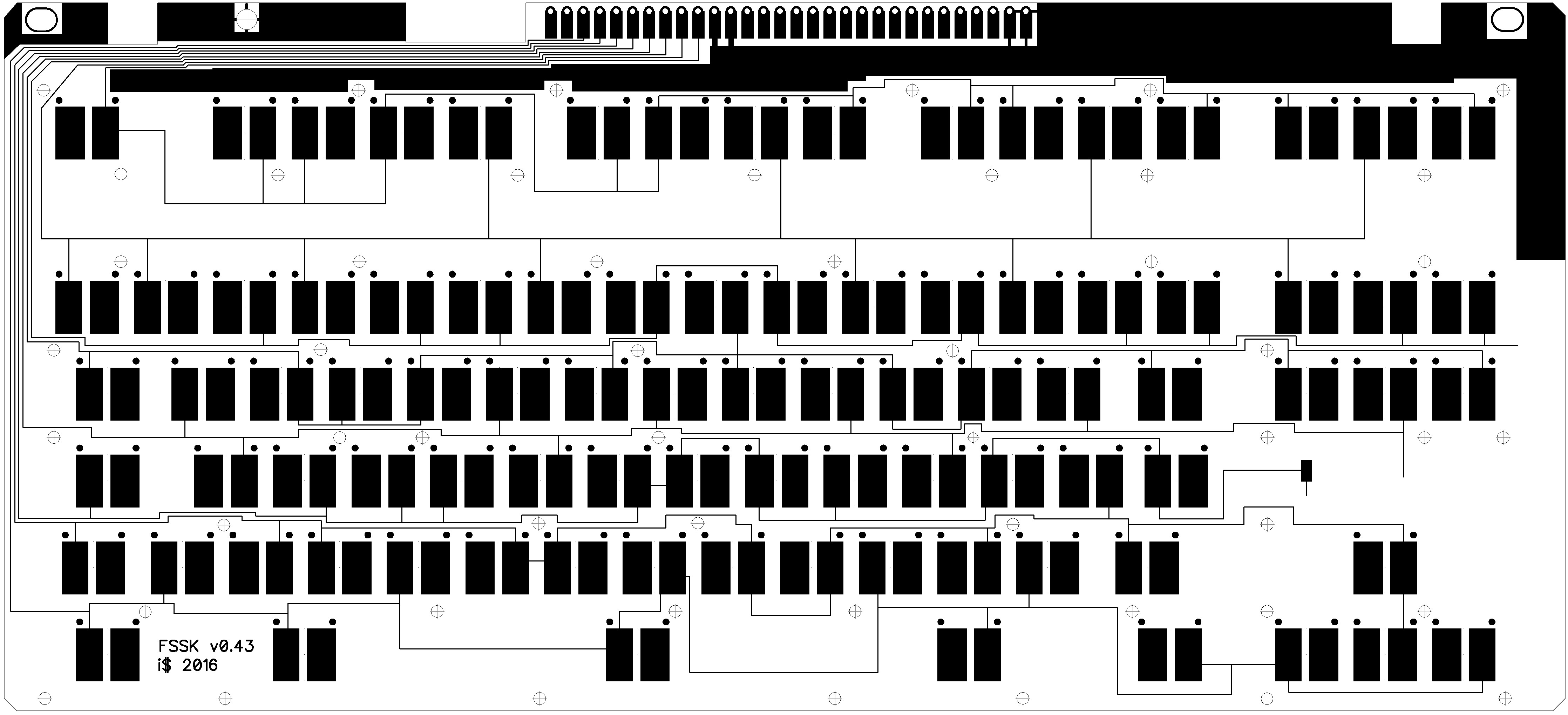

This modified version should allow both proposed options. Let me know your comments:
Layers v0.43.jpg (333.27 KiB) Viewed 9719 times
FSSK - Diptrace v43 - both.jpg (966 KiB) Viewed 9719 times
FSSK - Diptrace v43 - bottom.jpg (794.29 KiB) Viewed 9719 times
FSSK - Diptrace v43 - top.jpg (691.18 KiB) Viewed 9719 times
The pads shall cross the PCB to allow the bottom layer to be connected.
Also notice that the first and second pins are not grounded on the top layer. The connection to the ground is done through the bottom side.

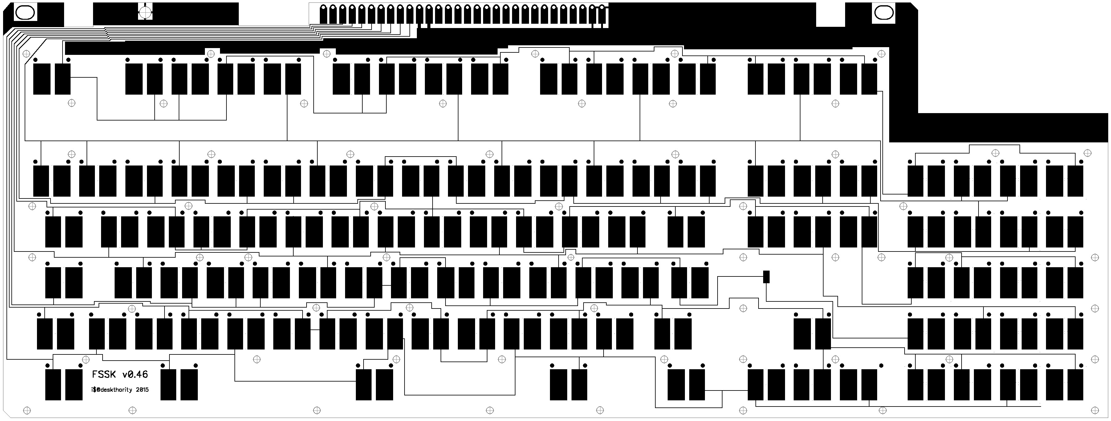

Further to the bullet 2) above, have created the following version 0.45 but I am still not convinced. We may want to take away the "connector" between the areas.
I guess that soldering a cable between the two PCBs (FSSK and NUMPAD) between the plates will not be possible.
Note that the holes in the board limits the position of the potential "connector" pads.
Note also that the "connector" shall be in the bottom side to allow for the mounting once the flippers are in place. It would be impossible to flip the two PCB parts together if the soldering is done on the top.
Again, I do not think this is a good idea, but it was worth check in it.

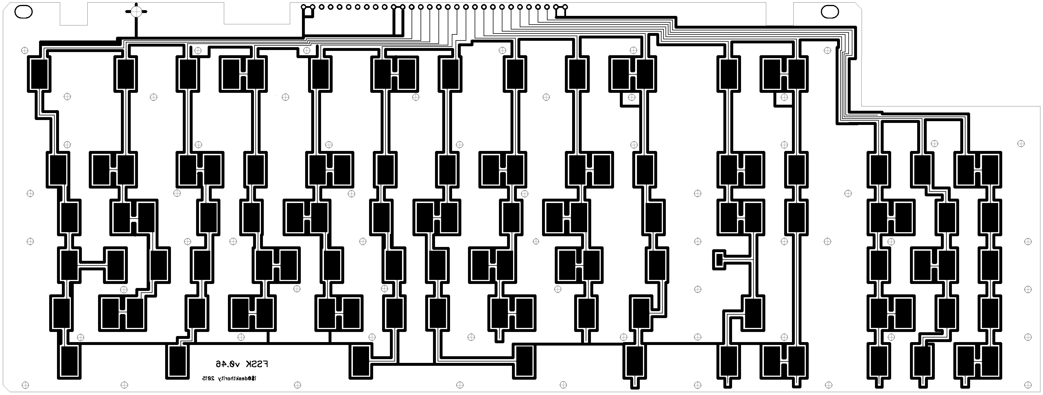

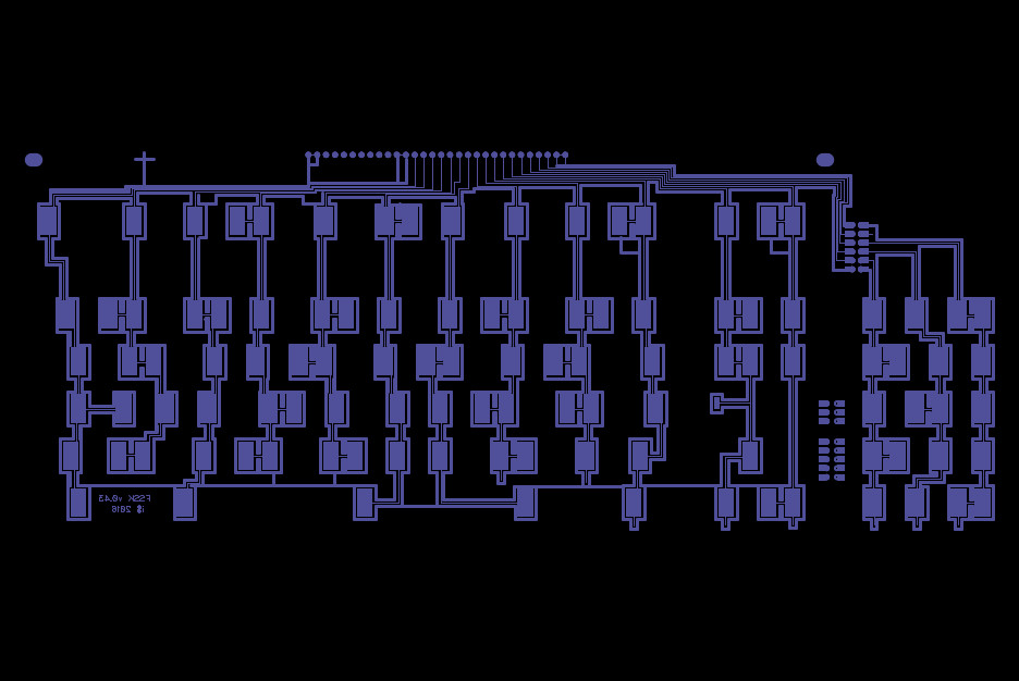

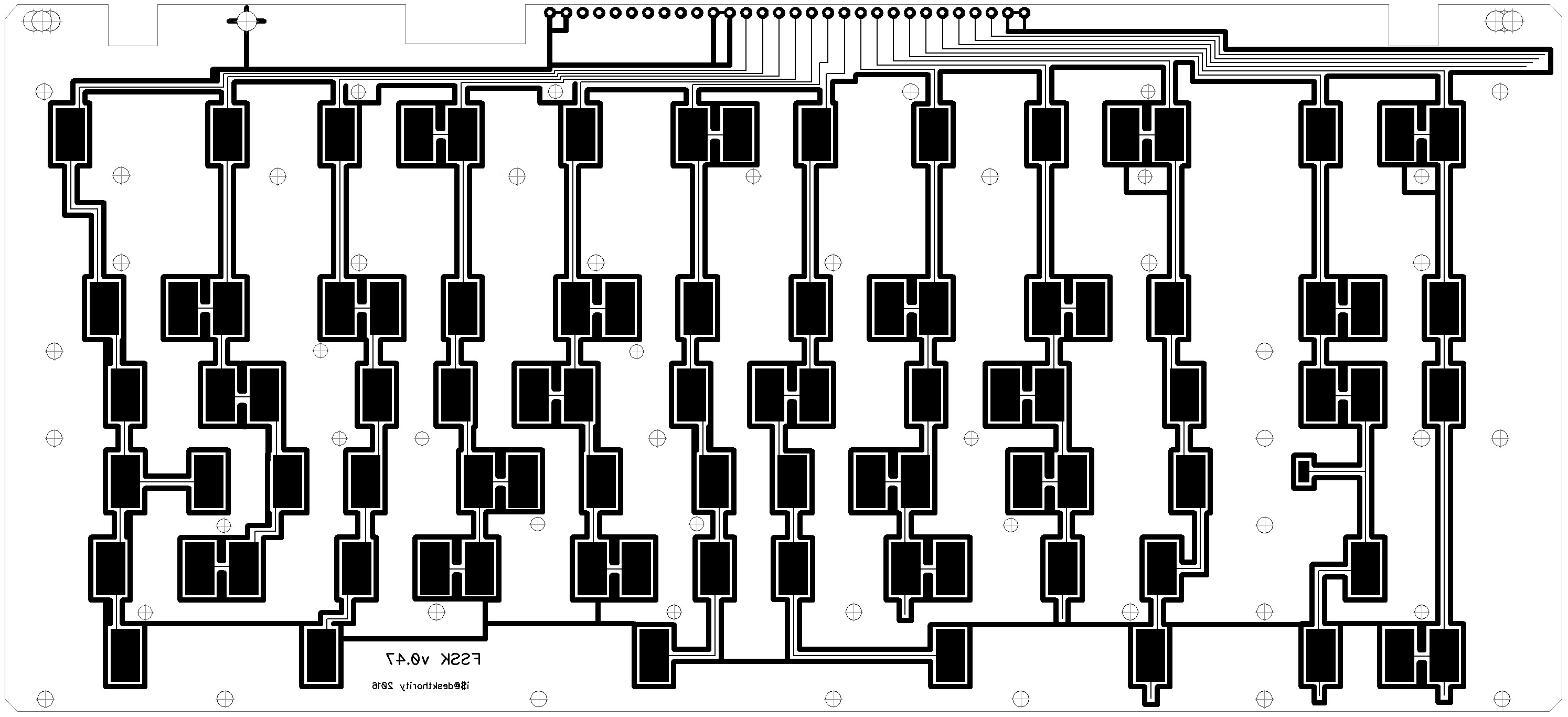

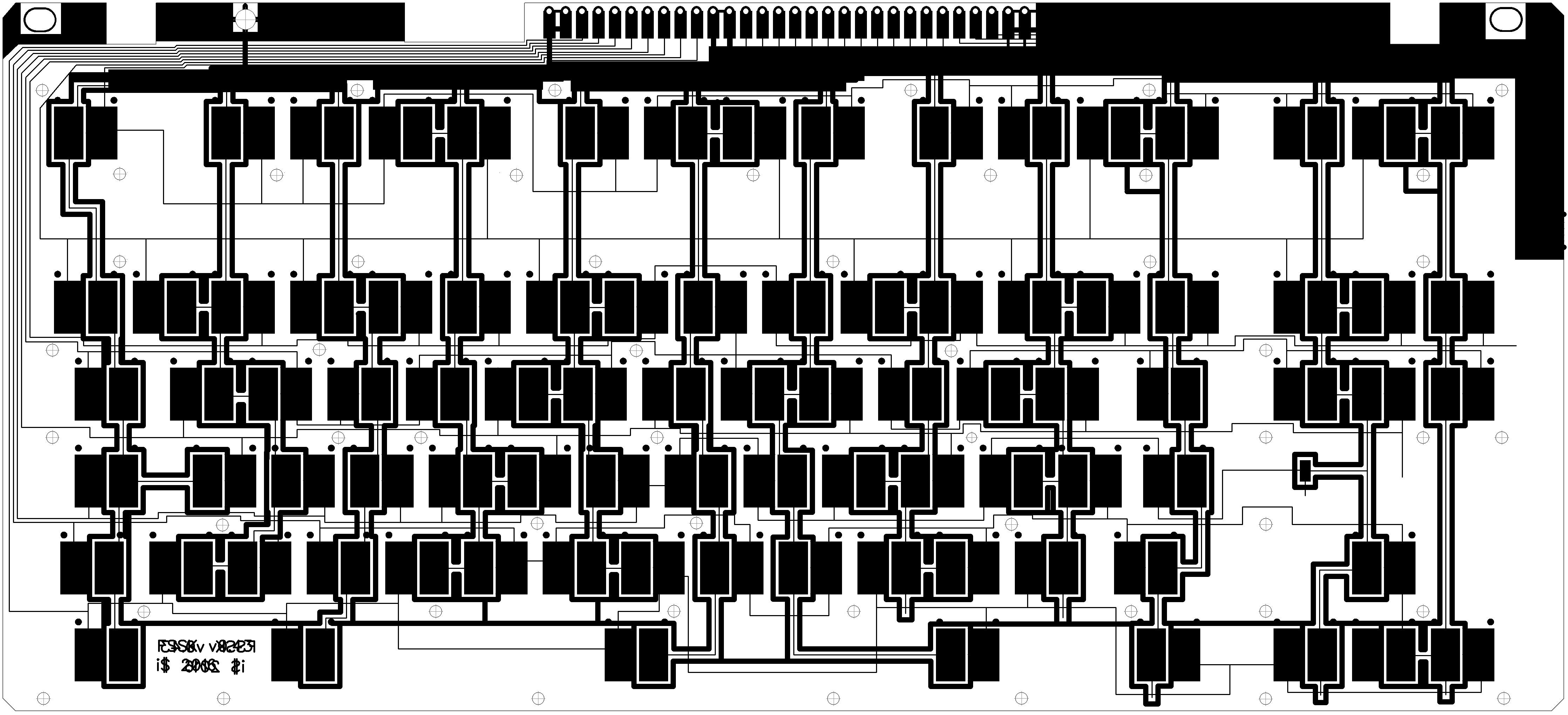

This is the alternative for the FEXT without the connector between the areas. My preference.
Simpler and smaller. If this is selected, there will be FSSK PCB version and a different FEXT PCB version.
Please comment
FSSK - Diptrace v46 - top B.jpg (511.47 KiB) Viewed 9616 times
FSSK - Diptrace v46 - bottom B.jpg (548.29 KiB) Viewed 9616 times
FSSK - Diptrace v46 - both B.jpg (699.06 KiB) Viewed 9616 times
Note (@wcass ;-) )- I need to review again the rows on the numpad to ensure that all the rows cross the columns one time.

I only hope that this will be the final post with the FSSK prototype layout with is already in its version v0.47 !!!
The changes in this version, which will as I said hopefully the latest one, are:
  • 1.- I realised by looking at the gerber files that the mounting holes on the top part of the PCB were not oval. This would have meant manual cutting of the PCB to allow the montage. Diptrace does not offer oval holes, or at least I could not find how to do it. The solution was to add three holes in a row. This trick should do the job.
    2.- I have reviewed the space between the upper and bottom layers to check if there was room to make the holes bigger. This will minimize the risk of misalignment with the real keyboard. I have checked it with printouts, but believe me, it is tricky. Just the fact of presenting the printout on to the wrong side of the metal plate makes a difference !
    3.- I discarded the idea of having a module for the numpad that could be linked to the FSSK. Soldering the interface that I have shown before will be impossible, not to say that the holes will get in the middle. We will stick to the original idea of having two different versions of the PCB.
    4.- I have closed the ground lines in the bottom side when the numpad is not present. This will improve the grounding which is critical for the success.
    5.- I have changed a couple of upper traces which were routed close to the middle holes. I have used "incline" traces to move as far as possible from the bottom layer and the holes.
    6.- I also checked the price for 0.6 mm instead of 0.4 mm PCBs. For 10 units, the different is approximately $100 extra on top of the $180 that the 0.6mm will cost. We will order 0.6mm. Additional to this we will have to pay some import duties that I estimate to be some 20 euros.
The order is waiting review from the producer. So hurry up if you want to contribute to the prototyping phase !!!!
Regarding the contribution to the prototyping:
I have sent an email to the people the have shown some interest proposing ordering 5 units instead of the 10 that I originally proposed. If the design works fine, I proposed to run a lottery among the contributors. The winner would have gotten the prototypes after paying the additional shipping cost.
With the new (estimated) price for the 0.6mm this will not be longer required. Thus, we discard this proposal and stay with the 10 units. As we are very close to the purchasing, please register today using a PM to me. I will answer back with the paypal details to transfer your contribution: (180+20)/8 = 25 euros.
In the above you can read that I have added the import taxes and assumed that euros and dollars are the same. This will add some extra cost, but it will also cover some of the interested contributors that may drop out.
Note that if the PCB works, in order to get it in your place, you will need to add some local shipping costs on top.
Alright, following the files:
FSSK - Diptrace v0_47 - both.jpg (594.01 KiB) Viewed 9567 times
FSSK - Diptrace v0_47 - bottom.jpg (462.19 KiB) Viewed 9567 times
FSSK - Diptrace v0_47 - top.jpg (439.03 KiB) Viewed 9567 times
