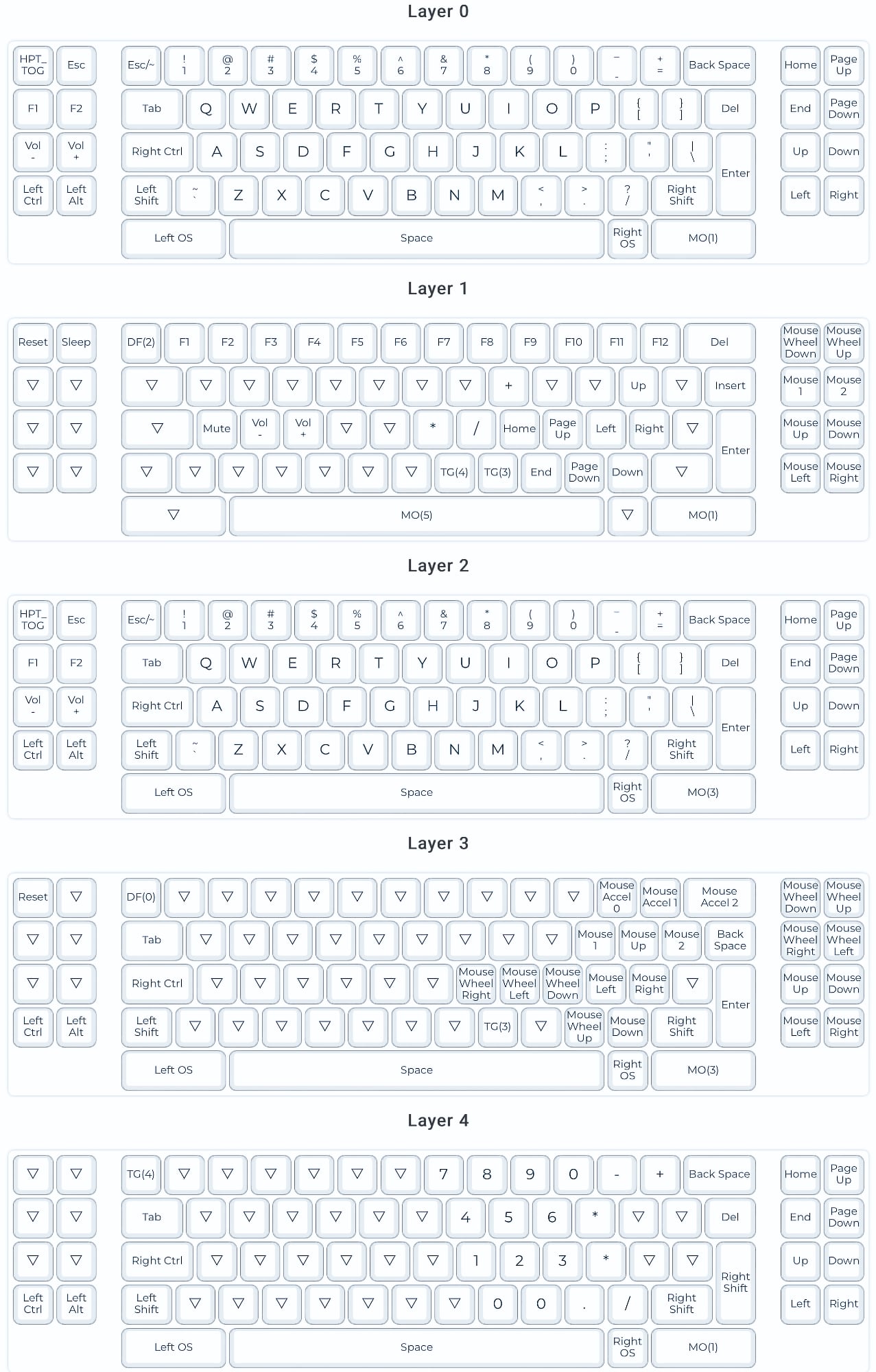

Thanks for the tip. I've tried using KC_NO on the function layer, as you suggested, but it makes no difference, unfortunately. Currently, this is my best attempt:
Screenshot 2022-07-20 at 6.43.55 pm.jpg (319.67 KiB) Viewed 5101 times
I'm using QMK's DF() function—default layer—to swap in Layer 2 when in Mouse mode. Ultimately I get the exact same result however: only releasing the Fn key then holding it again makes the transition "stick". I may be asking too much for the GUI editor.
