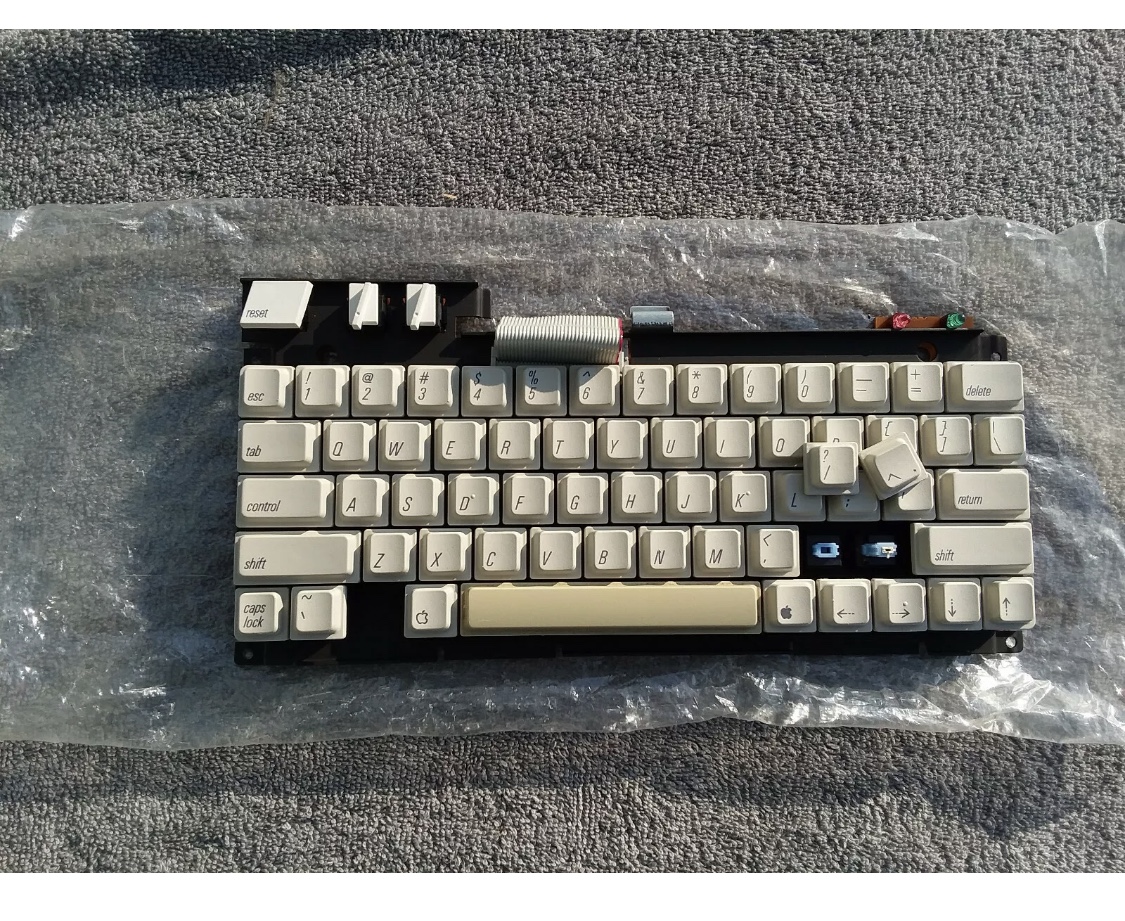

a service replacement apple IIc board just sold on ebay earlier today. shoulda posted it earlier. it looks plausibly NOS, considering its not in an IIc and there’s packaging. i was sorely tempted, but i have too many SKCM blues and not enough fiat currency.
https://rover.ebay.com/rover/0/0/0?mpre ... 3448822817

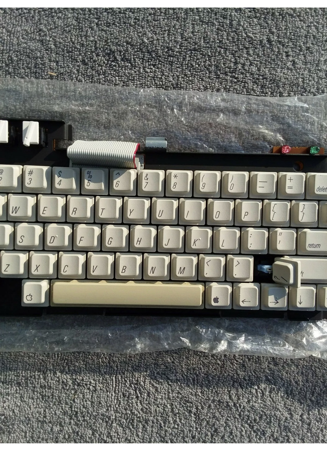

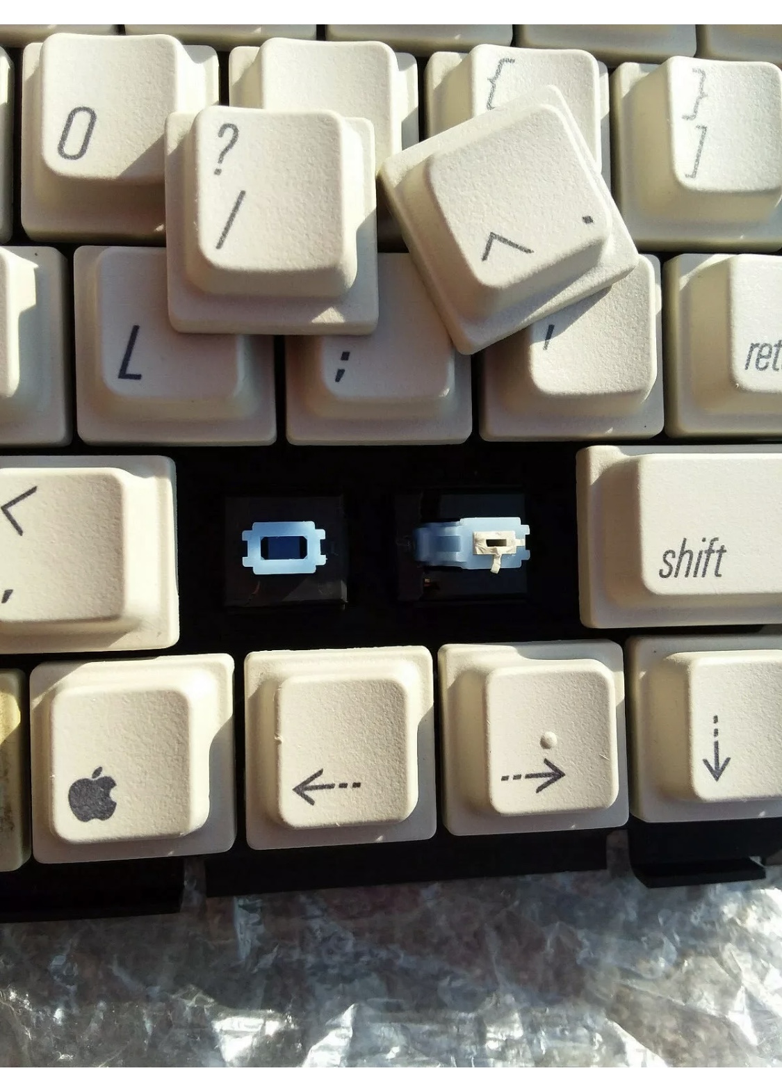

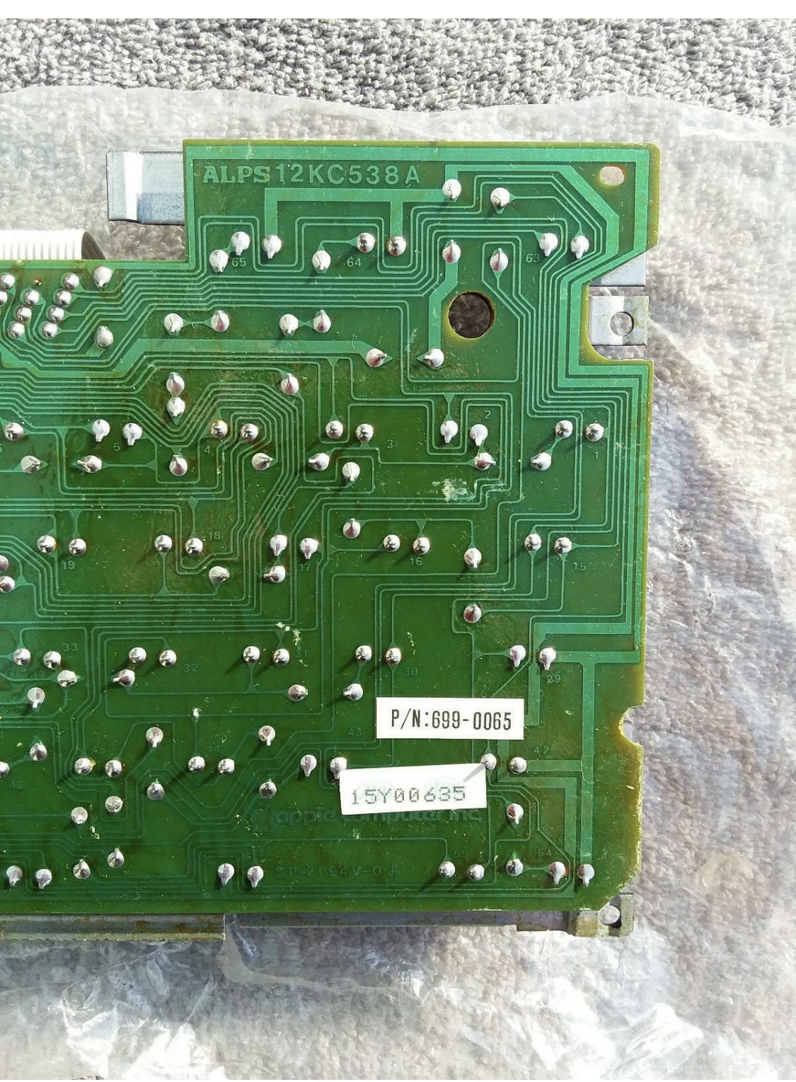

I won that one! I had a real NOS one about 5 years ago, but ended up trading it soon after I got it.
See here: https://geekhack.org/index.php?topic=71488.0
Money shot from NOS board of yore: I was too afraid to open them for fear of damaging them, but I've gained a lot of experience in the meantime and will be doing that for sure this time
I'll post a switch teardown once it arrives and compare to original blues and ambers for you all here.
The stems were definitely lighter in person and almost translucent to some degree. I'm guessing they were only used in those replacement boards as Apple probably was one of the few companies that would care to meet a minimum order quantity and have something similar to their previous custom Amber ALPS. This might have been after production of regular blues was over as well, hence the custom light blue/translucent plastic? Just a theory.

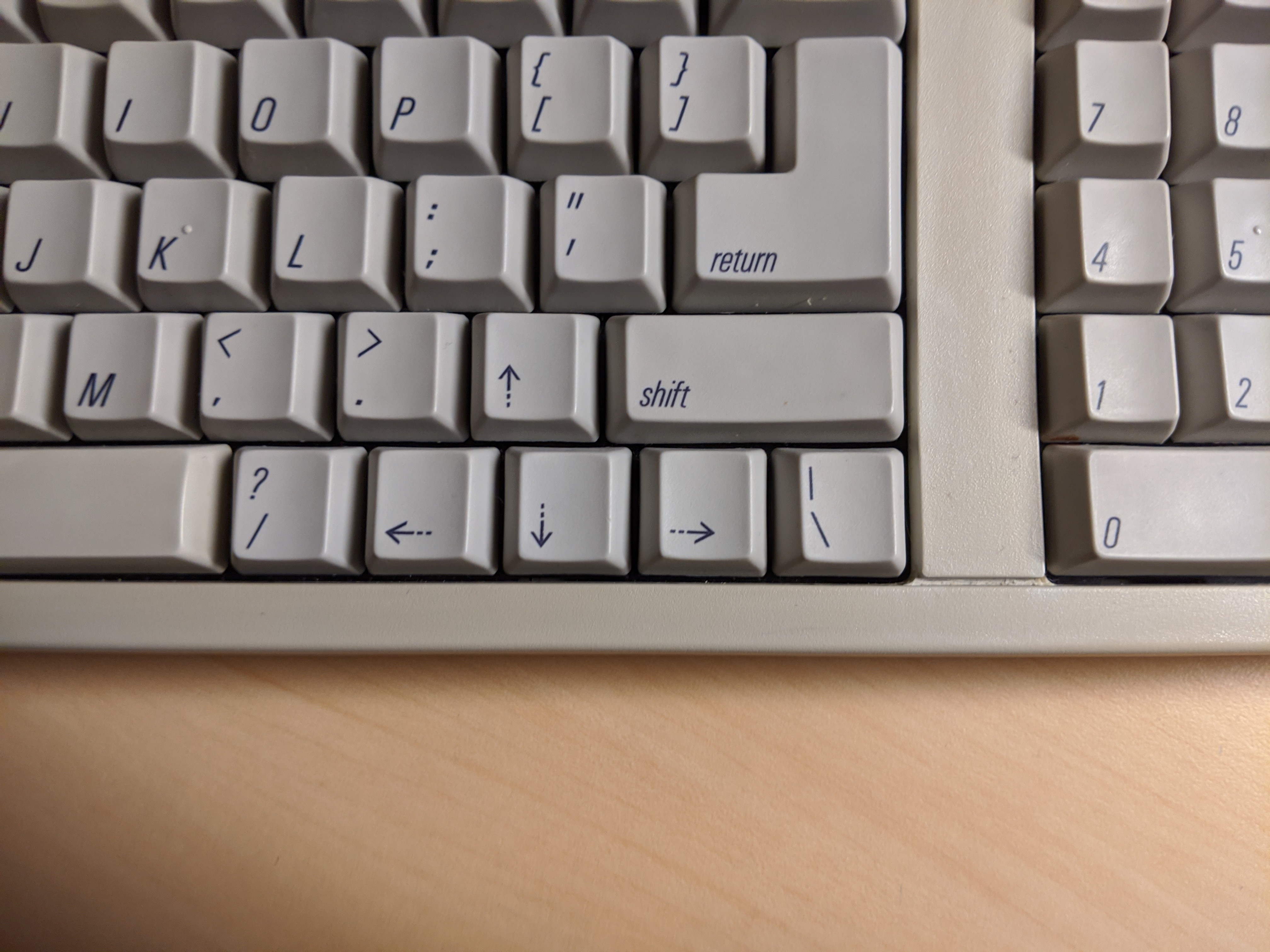

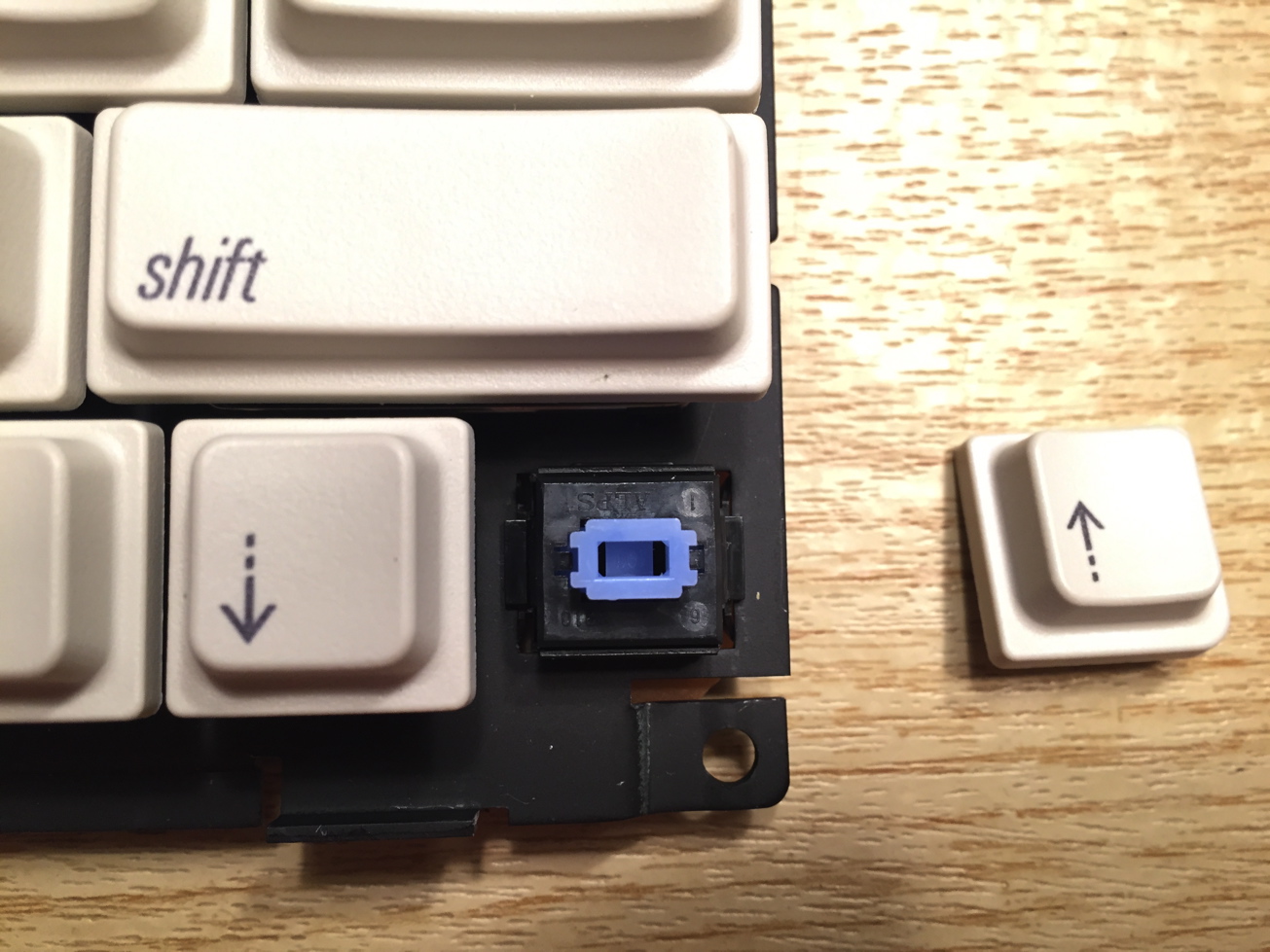

(I hope this fits here since it's an Alps keyboard
The Apple M0116 keyboard has a really weird and bad arrow key arrangement, so I recently changed mine to the one in the picture below. It's much better, and although I'm still not used to where the /? is now, it's much easier to navigate. I'm probably not the first one with this idea, but if you want to improve your M0116 layout, try this!
