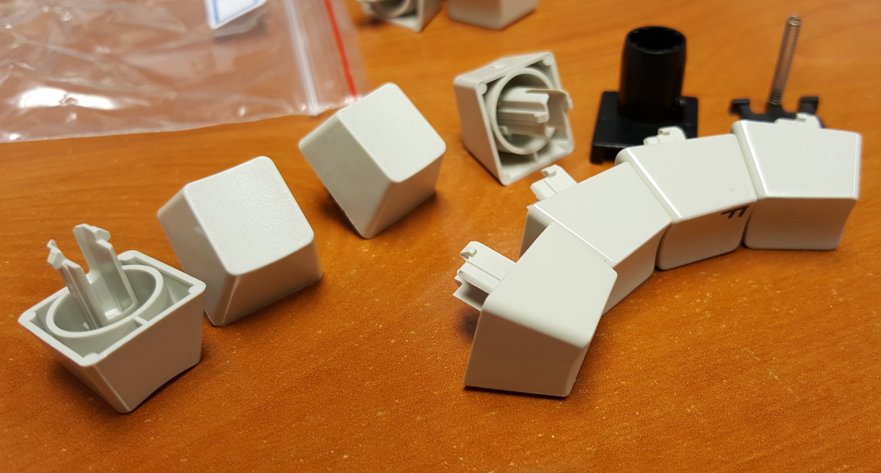

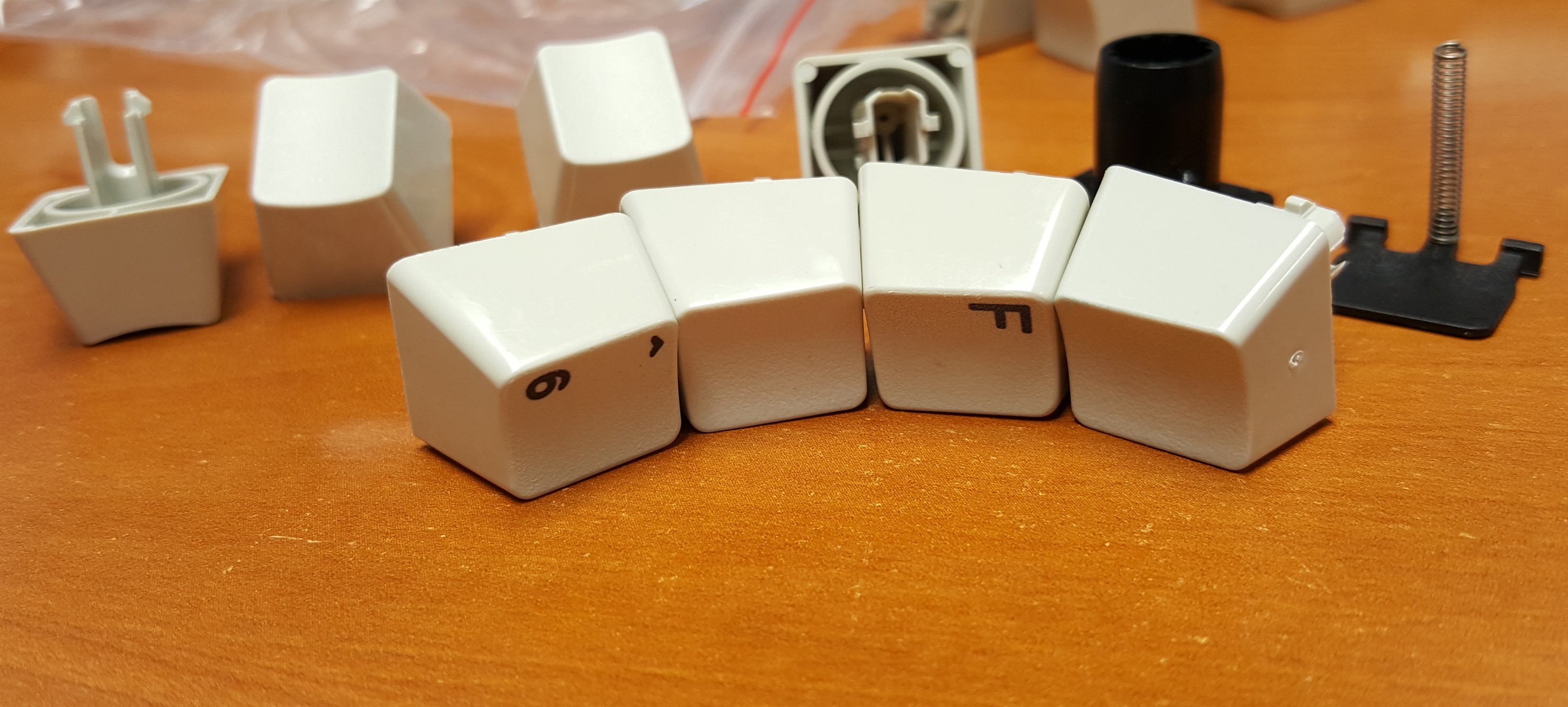

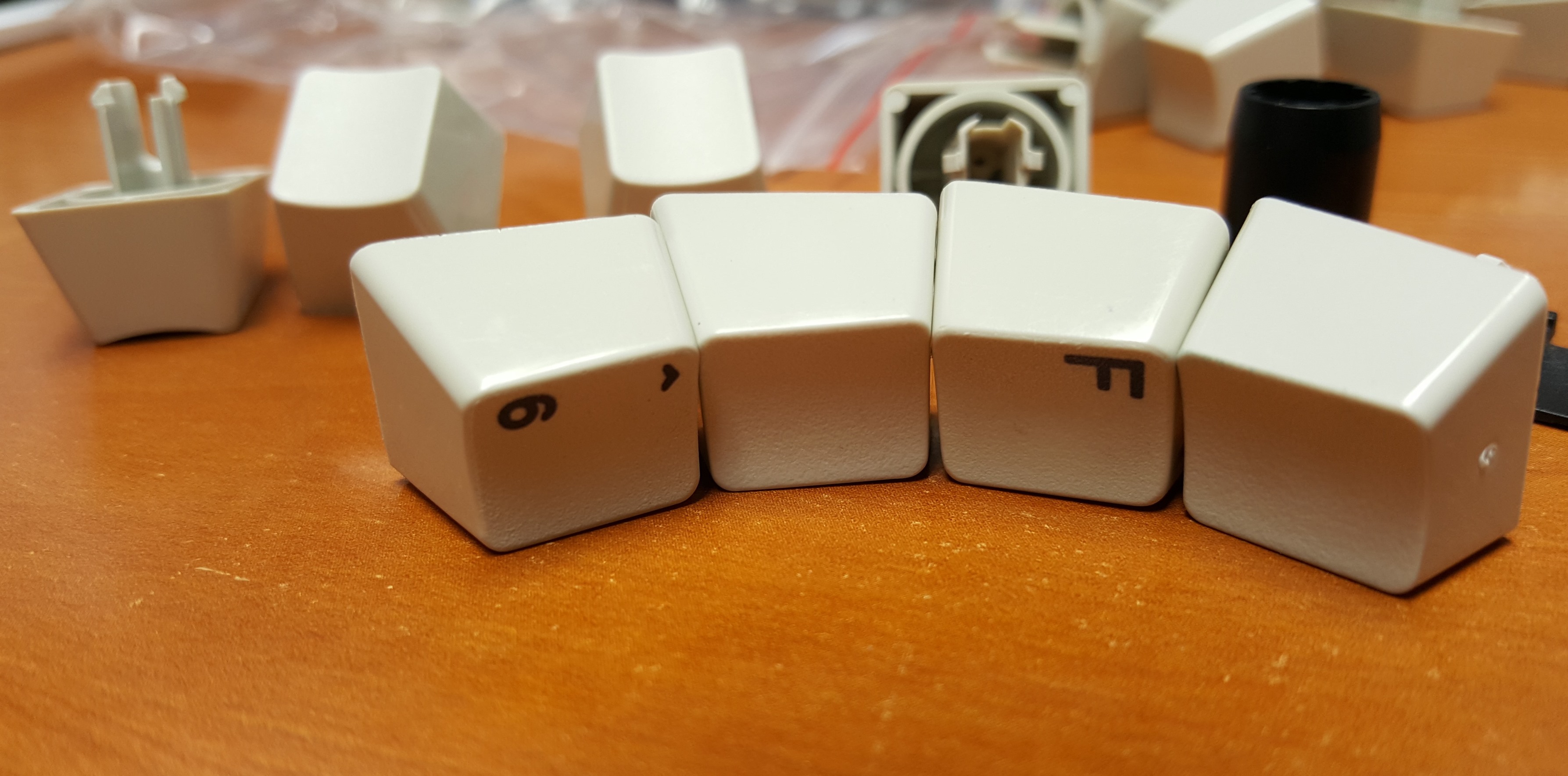

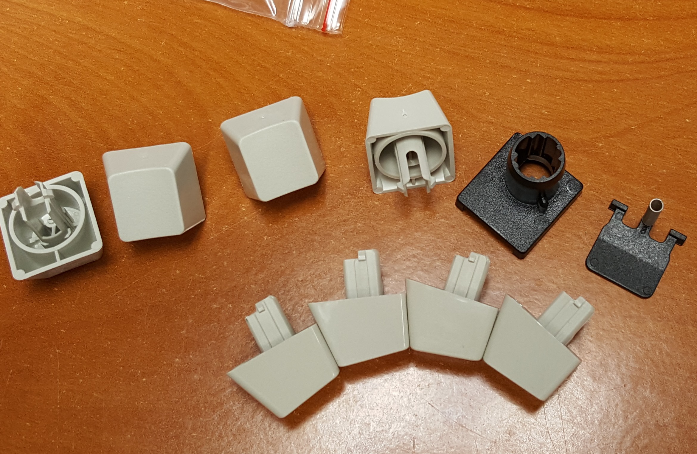

The pearl color is approved and the keys are now going into production! The key color is a match to the original XT set used on the prototype classic case F77 I brought to the various meetups (two keys shown below for color comparison).
The assembled springs first batch should be going out in a week or two. The factory has produced three of the spring attachers so far (from the video posted earlier).
As always please disregard the colors in these photos as they are not 100% accurate. In person the keys are a match.

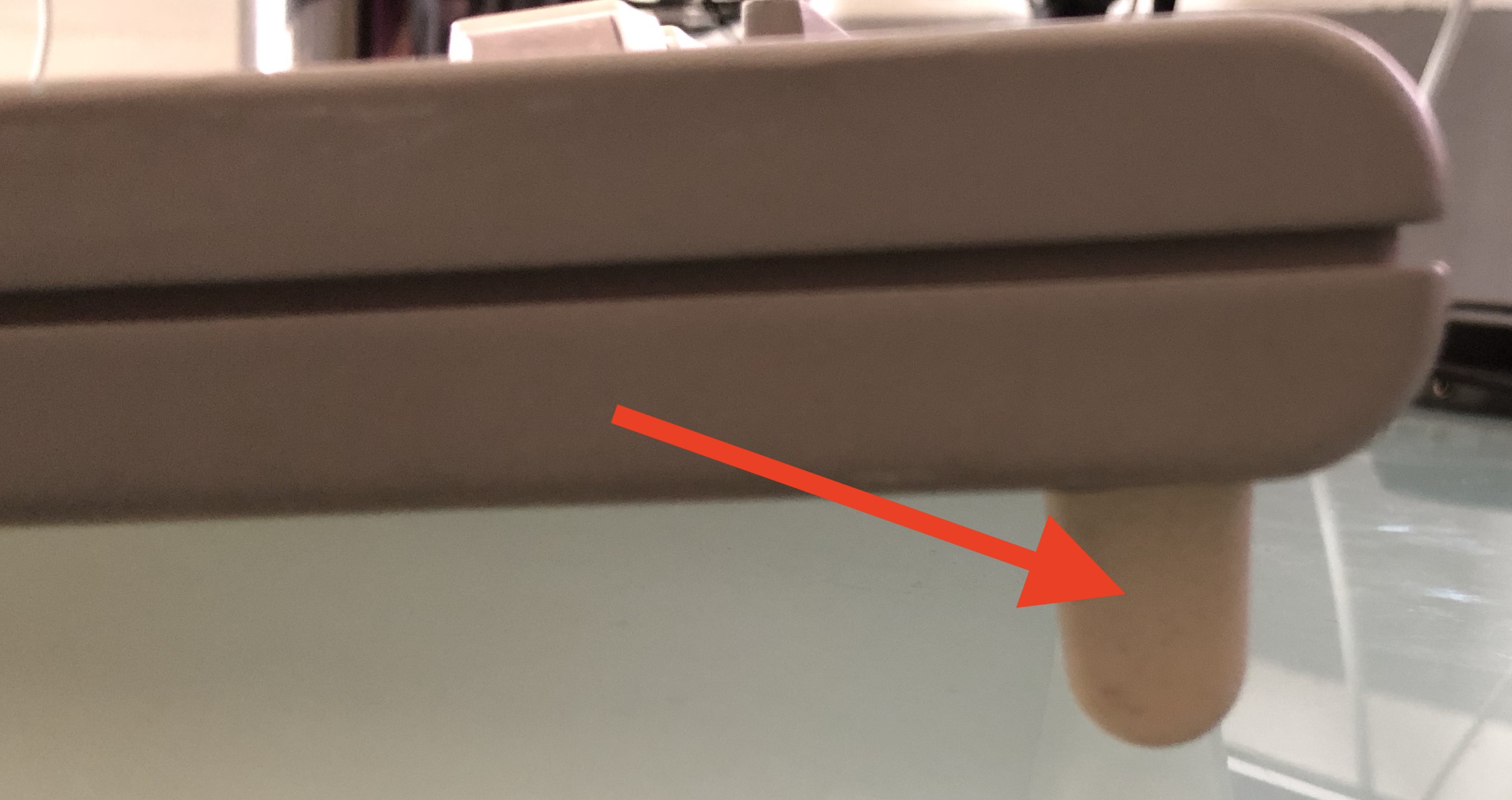

Hi Ellipse,

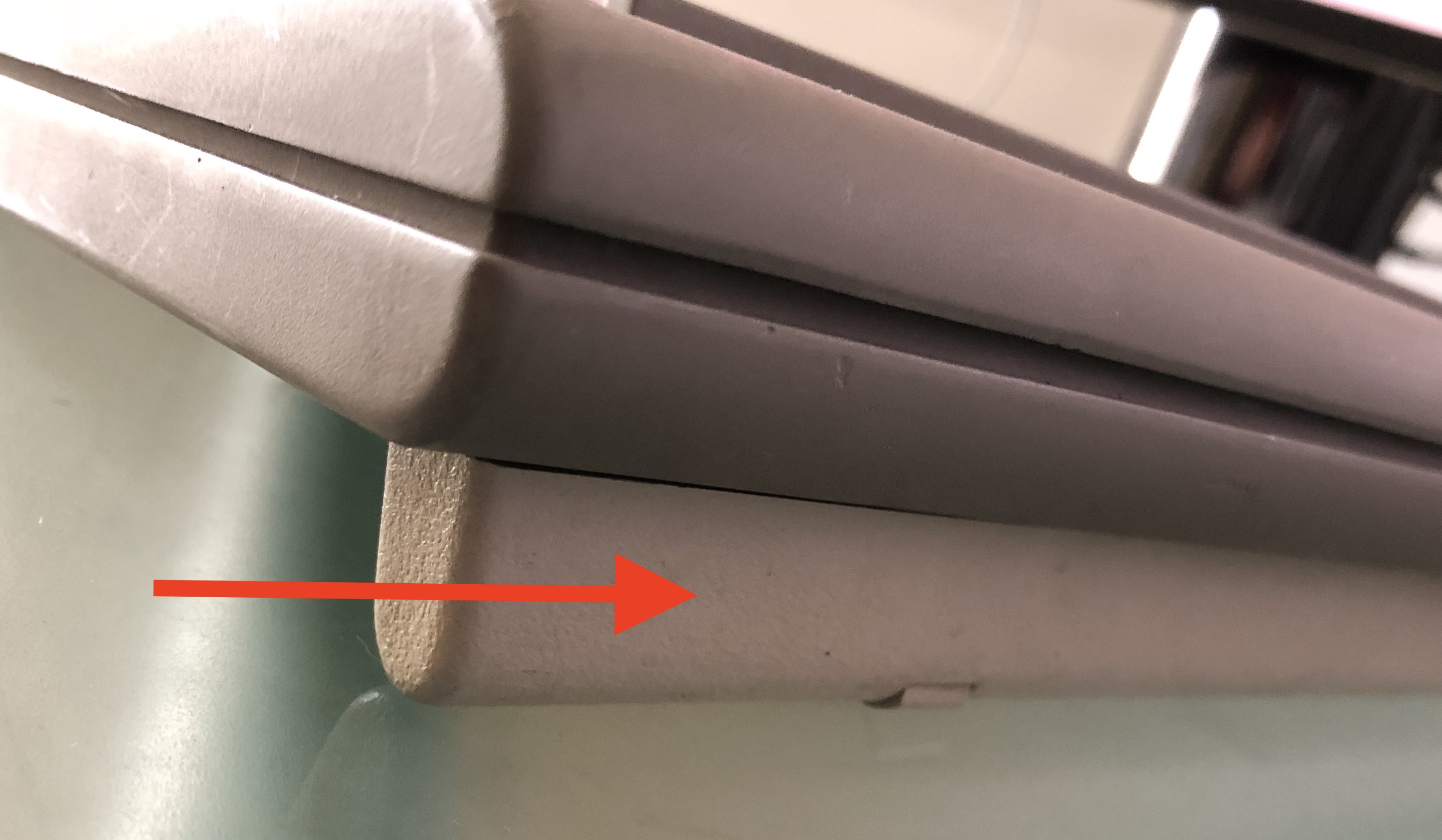

I have seen that there are holes at the bottom of the F77 case at the same location as it can be found on the original. There you can use it to attache a bar to raise the keyboard (as shown below).
I wonder, if these can be still used with such a bar?

04 Aug 2018, 17:04
Yes a bar can likely be used if 3d printed. The holes do not line up with the original bar though.

By any chance, do you have the diameter of the holes and the distance of the center?

The bottom die cast case holes are spaced 333mm and 260mm apart (from the center of each hole, not the edge) for F77 and F62 respectively. 6mm diameter. I recommend a screw and nut method of attachment as the cases do not accommodate the push in metal attachment of the original.

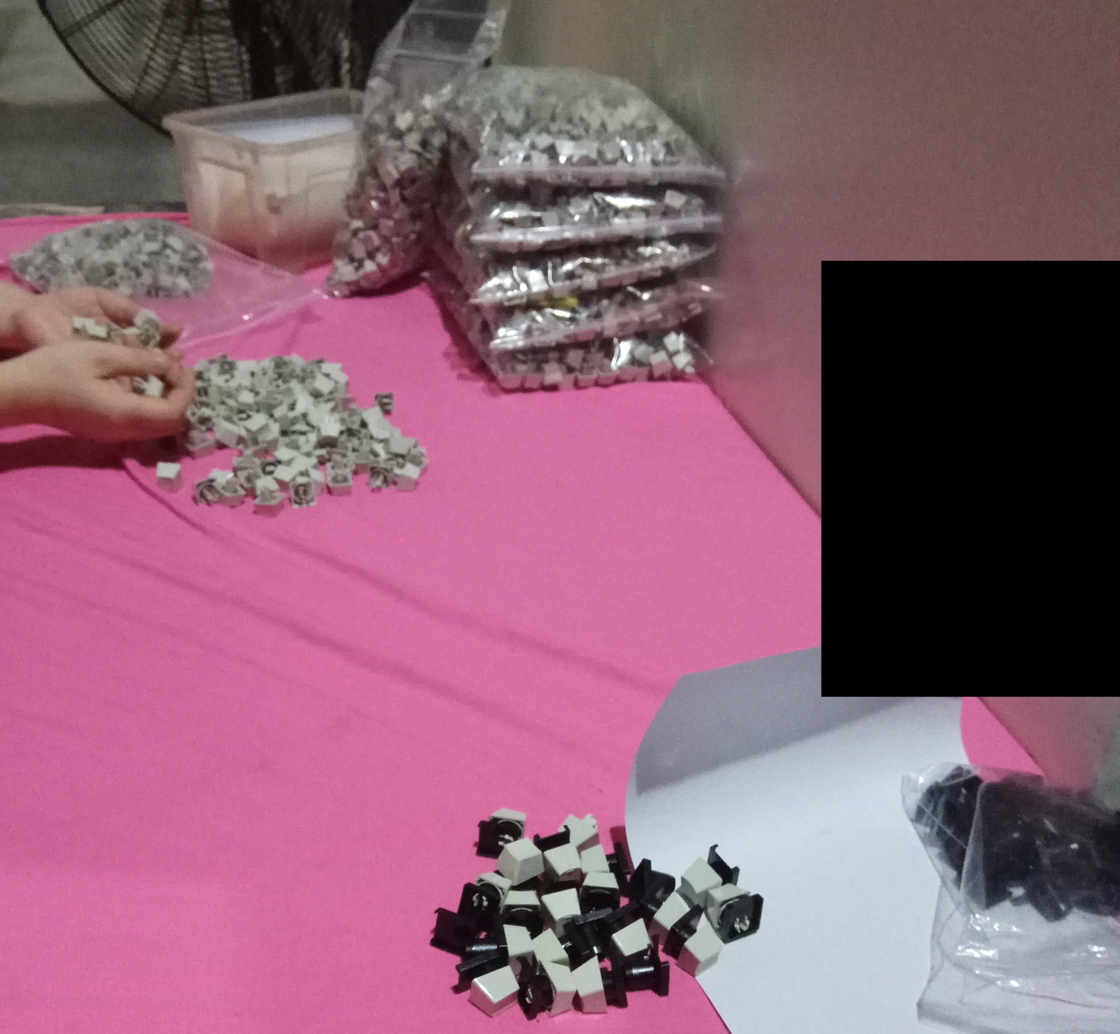

The one-piece keys from the new molds entered production earlier this month. Here is a photo of a QC station for inspecting each key and making sure it fits well with the production barrels.
