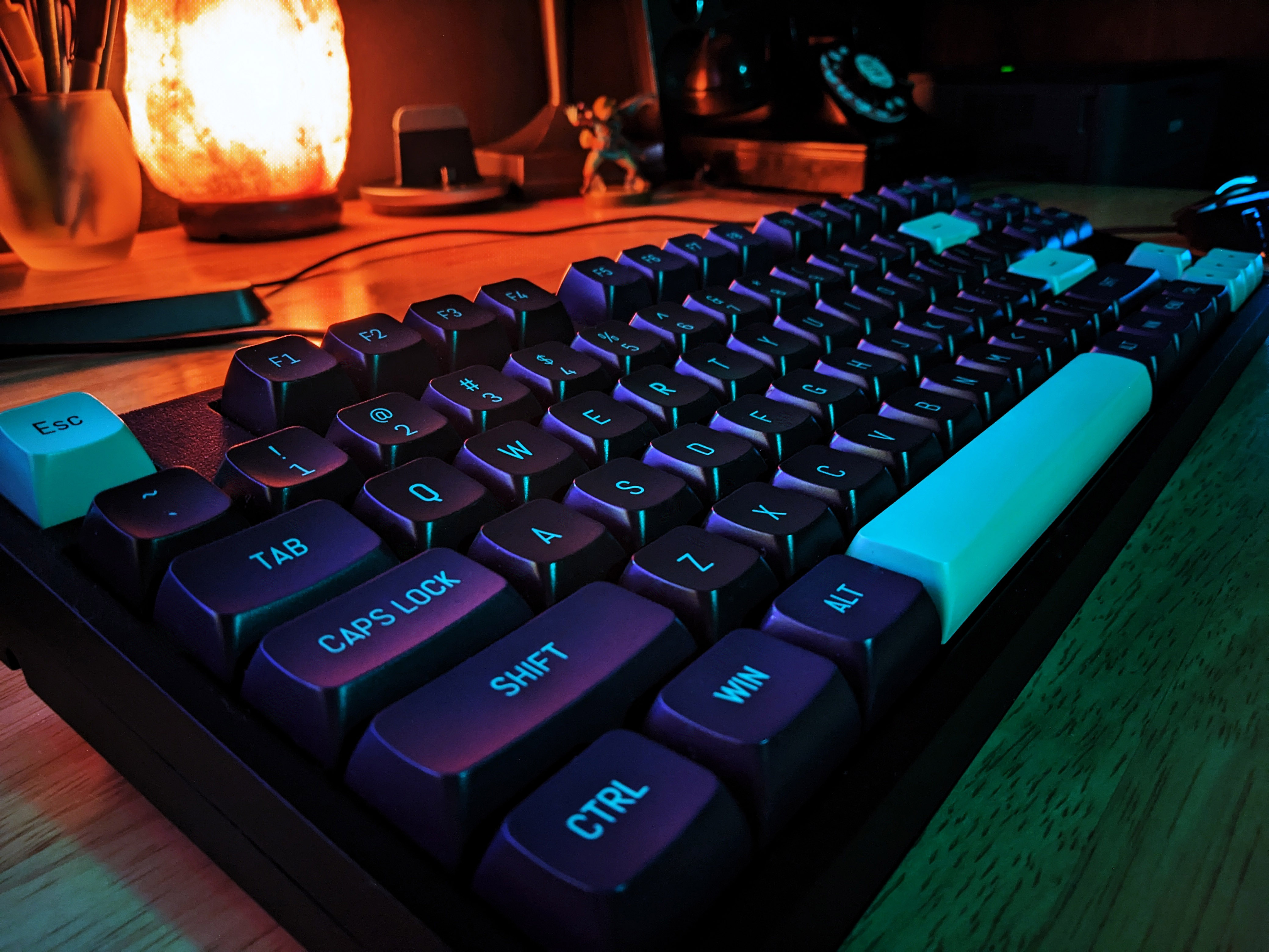

25 Sep 2023, 06:18
I'm really enjoying these PBT's I picked up. I really like the rounded bowl shaped type keycaps a bit more than the traditional shape now.
25 Sep 2023, 12:28
Sphericals have the look, for sure.
But I must be honest: I prefer typing on cylindricals. They have the feel, for me.

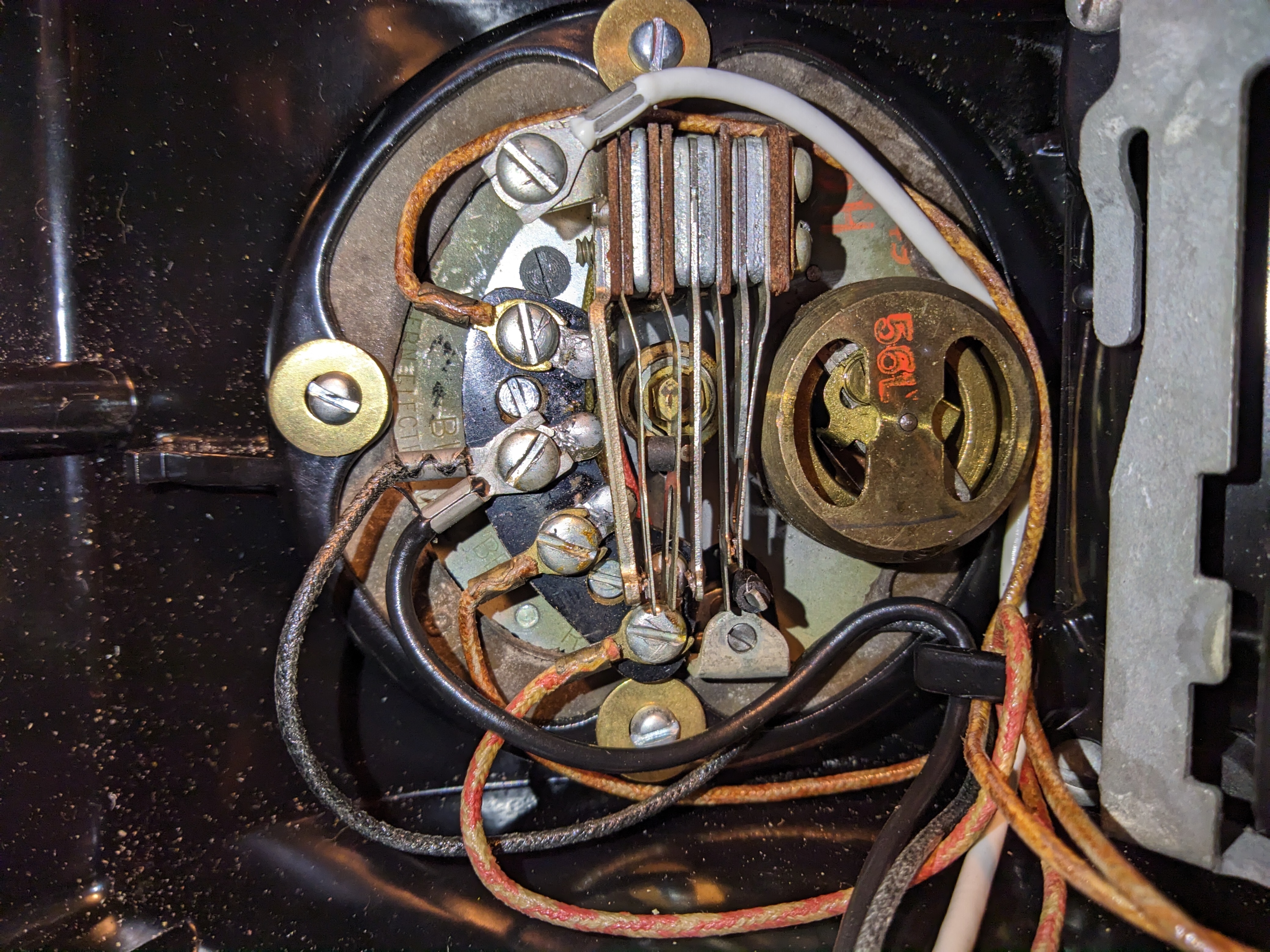

But what kind of switches does use that rotary dial telephone? :lol:
Inxie
26 Sep 2023, 04:14
paperWasp wrote: 25 Sep 2023, 20:56 Very nice!
These kinds :P . One that mutes the headset entirely by shunting it when the dial is pulled back, and the other that flashes the hook switch off and on when returning.
paperWasp
26 Sep 2023, 19:44
They look almost linear. :lol:
Thanks for the picture. Love this kind of antique technical stuff. 8-)

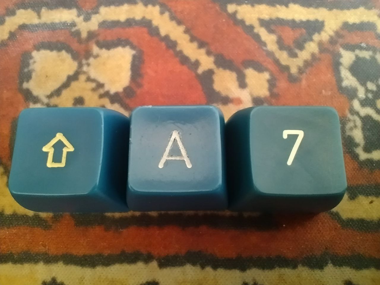

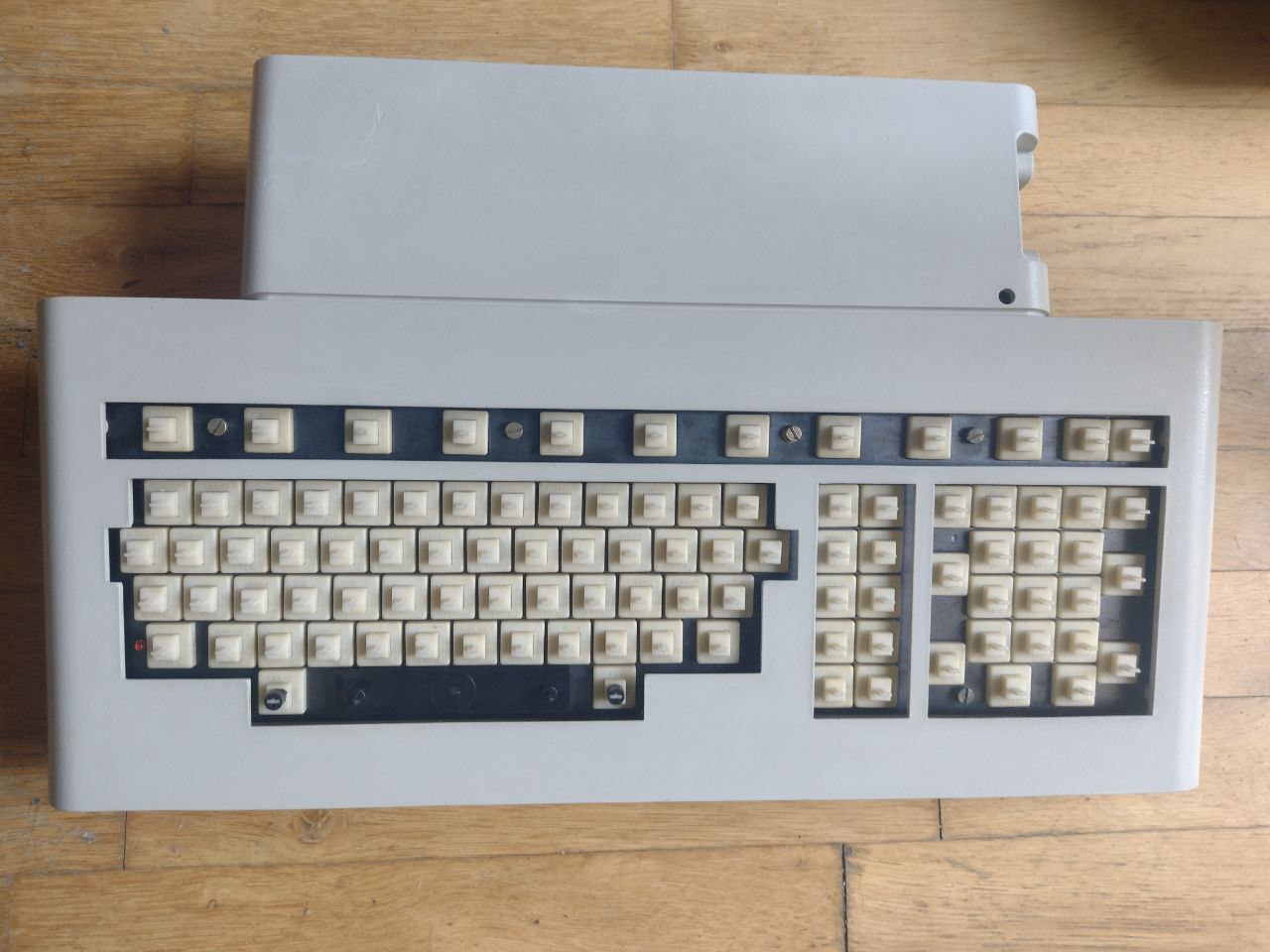

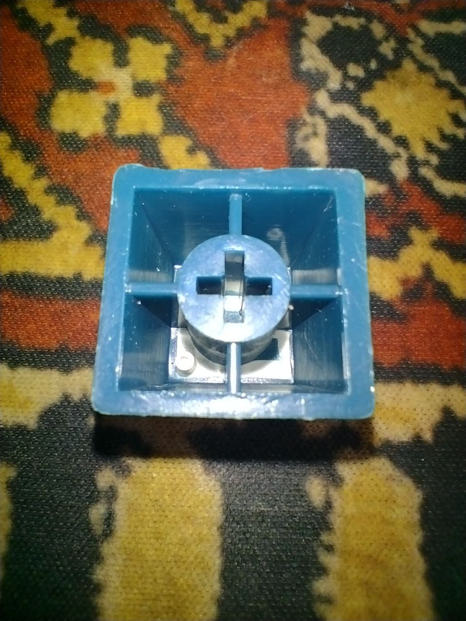

28 Sep 2023, 14:21

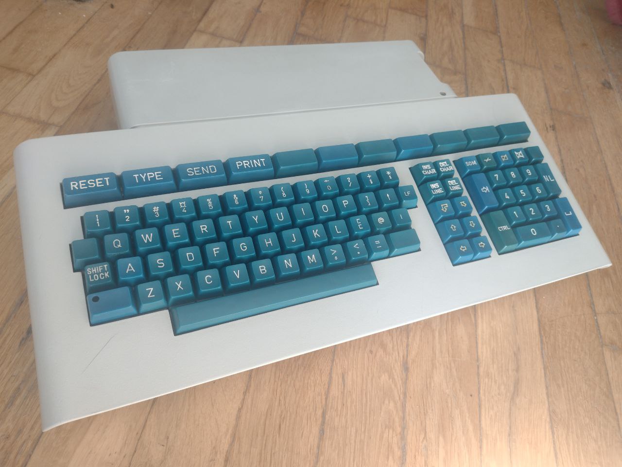

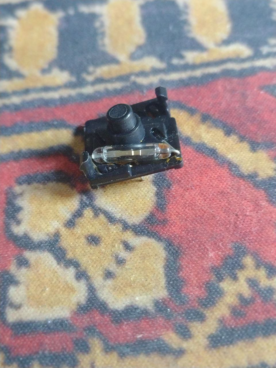

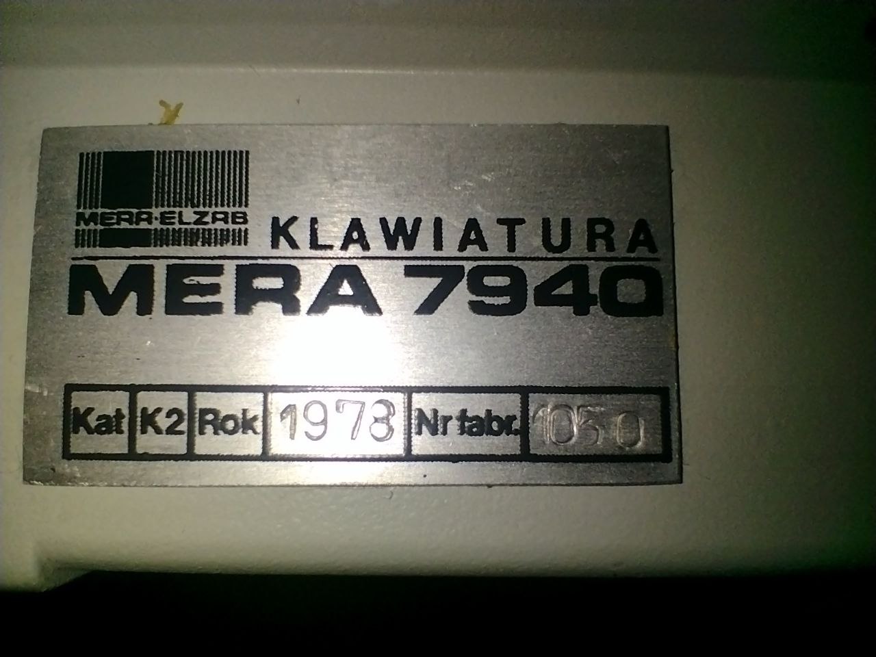

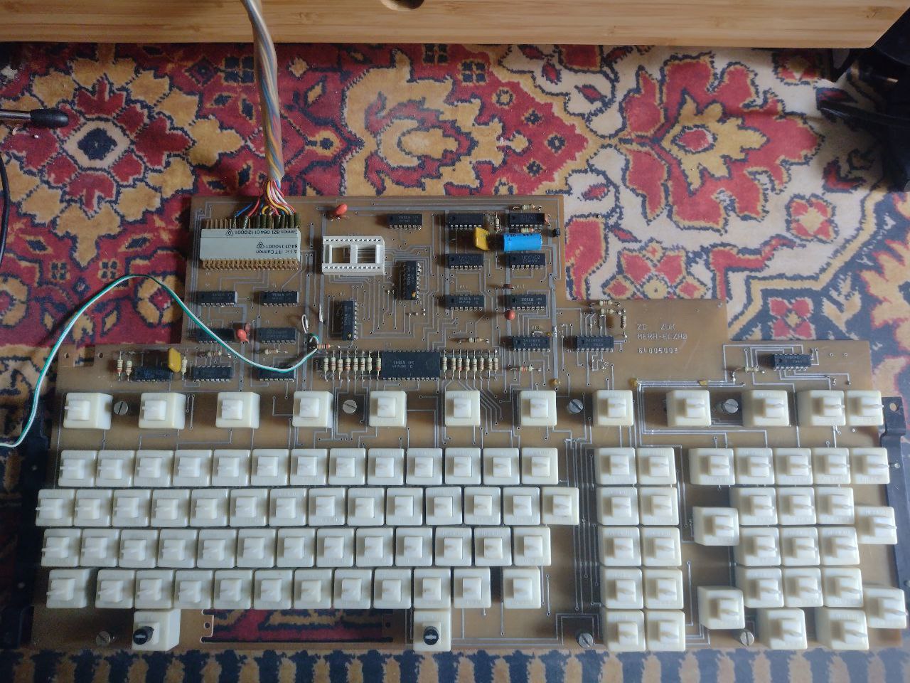

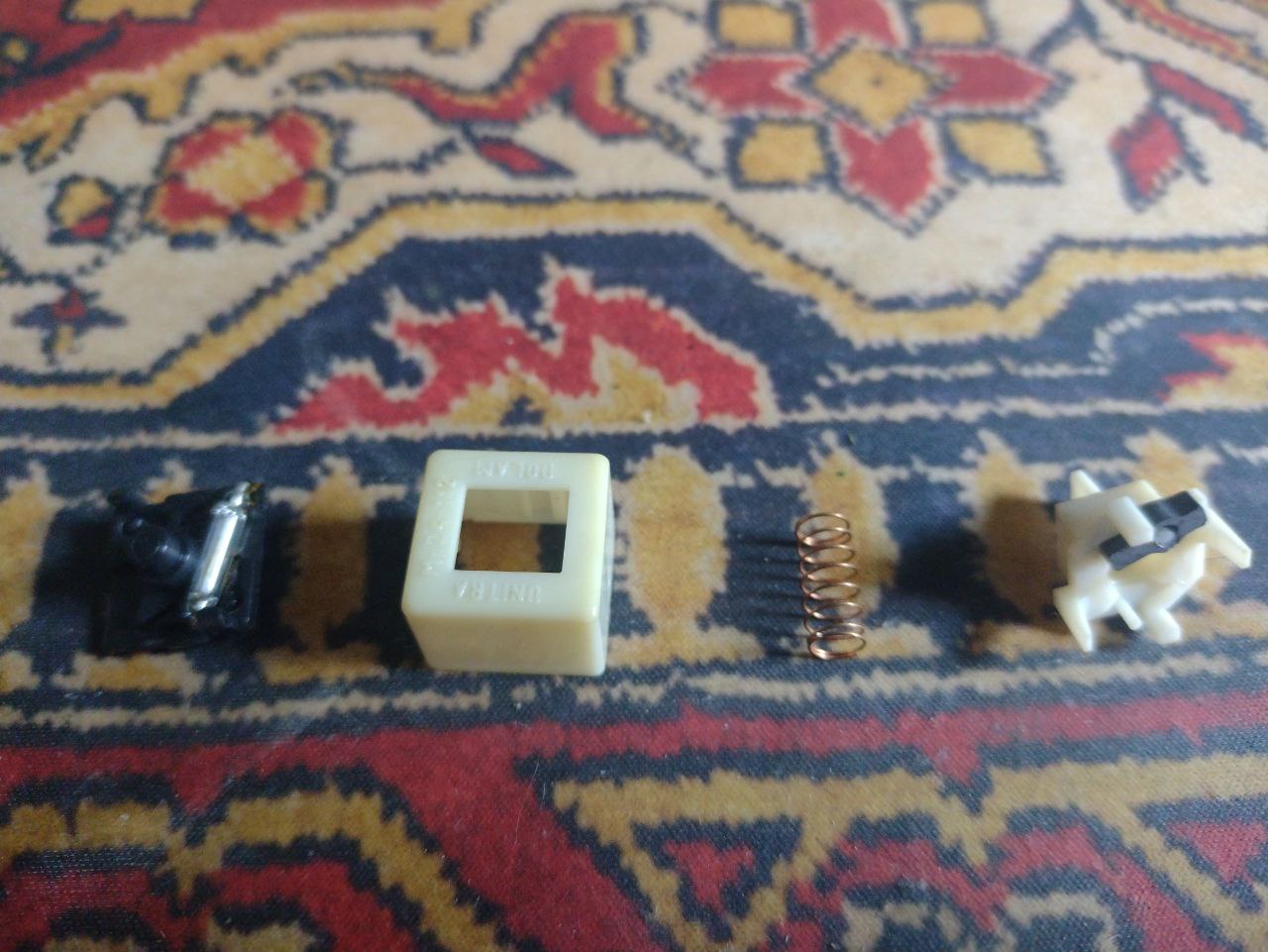

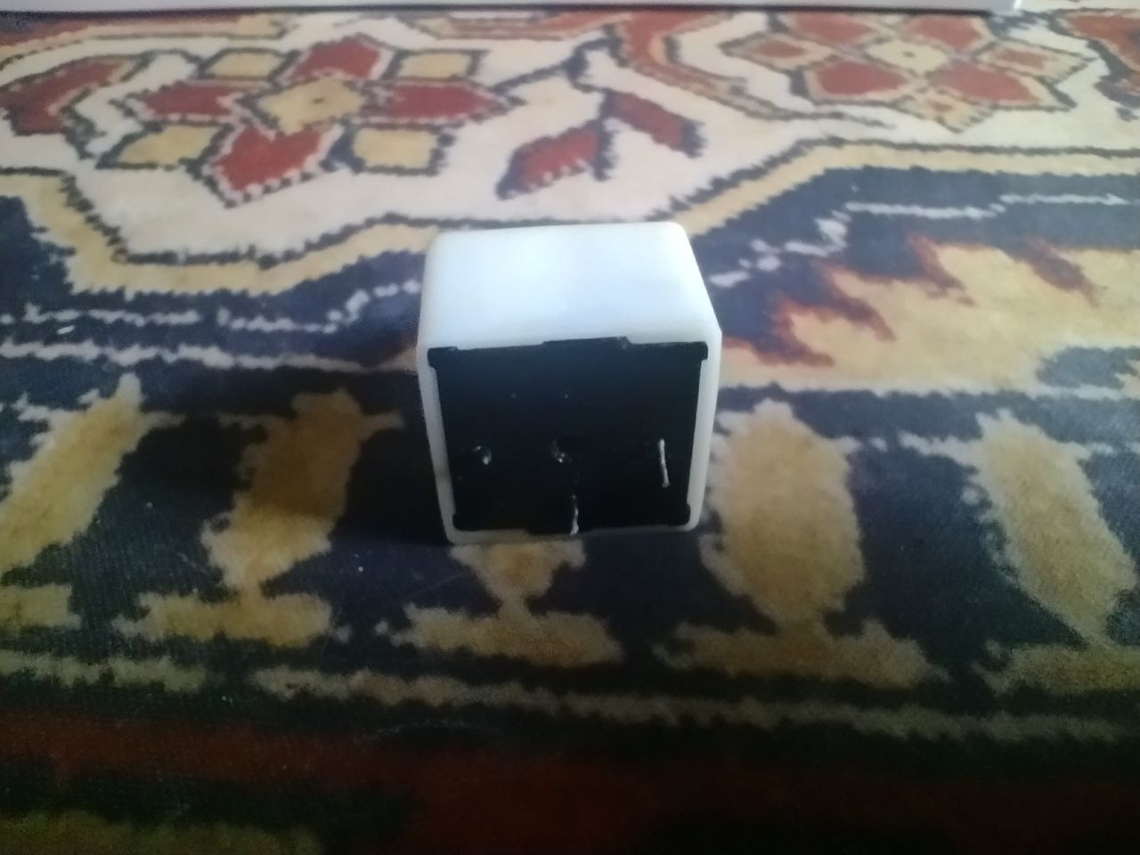

On todays east bloc exhibit we have the MERA ELZAB 7940, manufactured in 1978, in Zabrze, south west Poland:
The keycaps are 1970s thick double shot, im assuming ABS, however the manufacturing process leaves a lot to be desired, with some keycaps being perfectly smooth and sharp legends, while others arent properly filled at all. some legends are yellow, most are white, the choice seems pretty arbitrary, likewise with the shade of colour of the keycaps themselves, some are a deep blue, some are aquamarine:
The switches themselves are M-24-112 magnetic reed switches, manufactured by Unitra Dolam in Wrocław/Breslau, not much too them other than the enclosed housing, four rails which are ungodly bindy, the spring, the magnet and the reed switch itself:
paperWasp
05 Oct 2023, 23:30
The keycap colour is quite atractive.

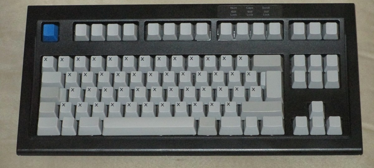

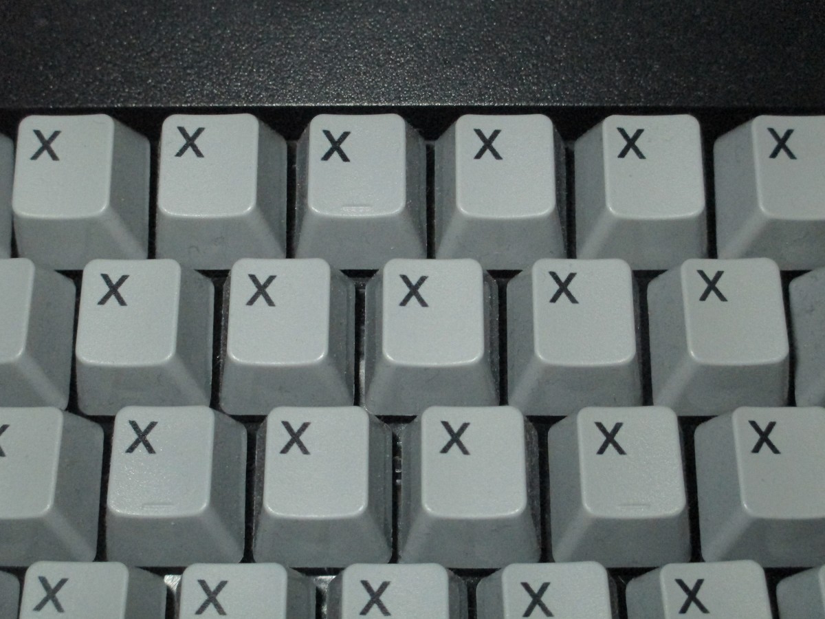

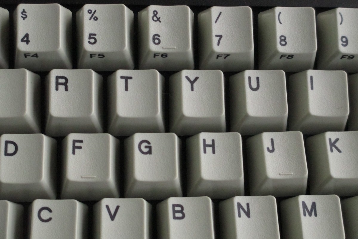

depletedvespene wrote: 10 Jun 2018, 15:11 Whenever I am trying out a new national layout or (or customizing one), this is the keyboard I test it out with:
The XXK is not alone anymore.
Unicomp Mini-X.
Unicomp Mini-X.
Indeed, this is a Unicomp Mini-M. I replaced the buttons with blanks and a large batch of X keys (all by Unicomp).
As is by now my standard practice, which I opine should become an actual standard for everyone, the 6 key in the number row has a HRI bar. On numpadless keyboards (TKL and smaller), this has proven to be very useful when inputting numbers.
Three HRI buttons.
Three HRI buttons.
Initially, I wanted all alphas to be gray and all mods to be blue. Sadly, Unicomp does not provide blue for all the non-1U buttons, so I went with only the Esc key (Fn, actually, as Esc is on the home row) to be the accent.
25 Oct 2023, 16:31

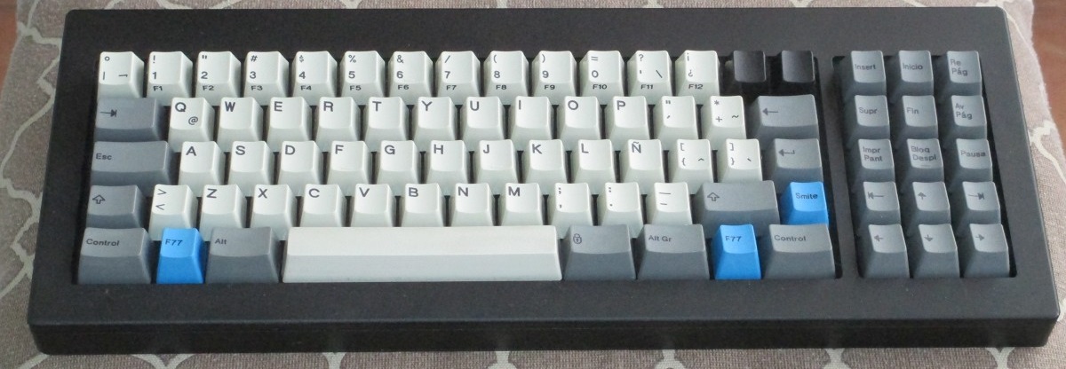

So I finally got off my lazy ass and replaced the blanks in my F77 with Ellipse's es-LA keycap sets. I mixed the cream alphas from one set with the dark gray modifiers (plus three blue ones, and two black unprinted keys for ${REASON}).
F77, esLA layout.
F77, esLA layout.
Looks great, but I would love to have gray alphas instead. This is good for now. ;)
Note the placement of the Esc key. The "Caps Lock vs. Ctrl on the home row" holy war is over, and both sides have lost. Esc on the home row is the way to go; vi forever.
HRI keys: F, J, 6.
HRI keys: F, J, 6.
In keeping with my whi... practice, the F77 also has an HRI 6& key.

Jo3l
05 Dec 2023, 11:15
This is part of my keyboard collection, some are restored, some are still dirty, some are modded with usb interface, and I wanted to share it with you.
05 Dec 2023, 11:18
Impressive presentation. I get the feeling that brightly coloured room contains quite a few showcases, not just limited to keyboards. :D
05 Dec 2023, 11:36
Jo3l wrote: 05 Dec 2023, 11:15 This is part of my keyboard collection, some are restored, some are still dirty, some are modded with usb interface, and I wanted to share it with you.
Nada mal. Cuántas eñes, oyes (i ces trencadas, noi). :-)
