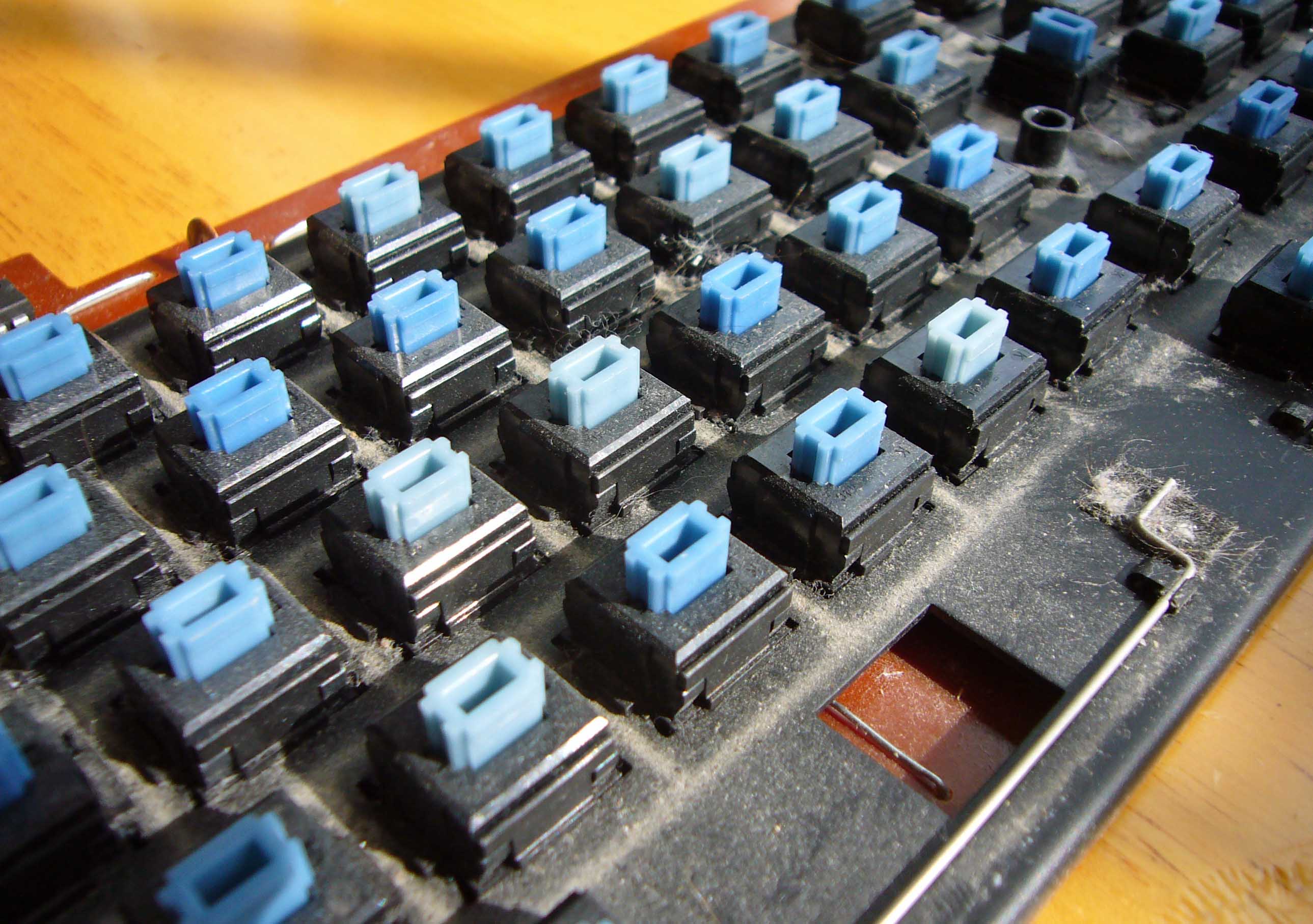

19 Mar 2016, 13:45
lootbag wrote:
more vibrant blue compared to regular ALPS blue which has a bit more grey in the blue.
Like this?
E3E

It's a Focus FK-747.
I wouldn't be too concerned with slider color. It seems that however or whatever Alps used to dye their sliders isn't very colorfast and you can see a lot of fading amid most Alps switches even within a single batch. With Alps SKCM Blue, I've seen colors range from a very muted, almost grey blue, to a very vivid and vibrant ultramarine blue.
Yep, fohat clearly shows this in his above post too.
Also willing to bet that those key caps are pad printed.
Reason being that my Focus FK-555 is also pad printed and the legend is very similar. It's hard to notice, but the 0 on the number pad is a big indicator compared to Alps Electric Dyesubs or DS caps.

E3E wrote: I wouldn't be too concerned with slider color. It seems that however or whatever Alps used to dye their sliders isn't very colorfast and you can see a lot of fading amid most Alps switches even within a single batch. With Alps SKCM Blue, I've seen colors range from a very muted, almost grey blue, to a very vivid and vibrant ultramarine blue.
Exactly, I've also seen a more purple-blue tone slider. Like I've said before I don't think the precise slider color was paramount in Alps SKCL/SKCM series production.
Redmaus
Gotta start somewhere
19 Mar 2016, 15:44
When itzmuluigi showed me a picture of his Filco Zero, I actually thought it was purple.
I guess blue alps came in different shades.

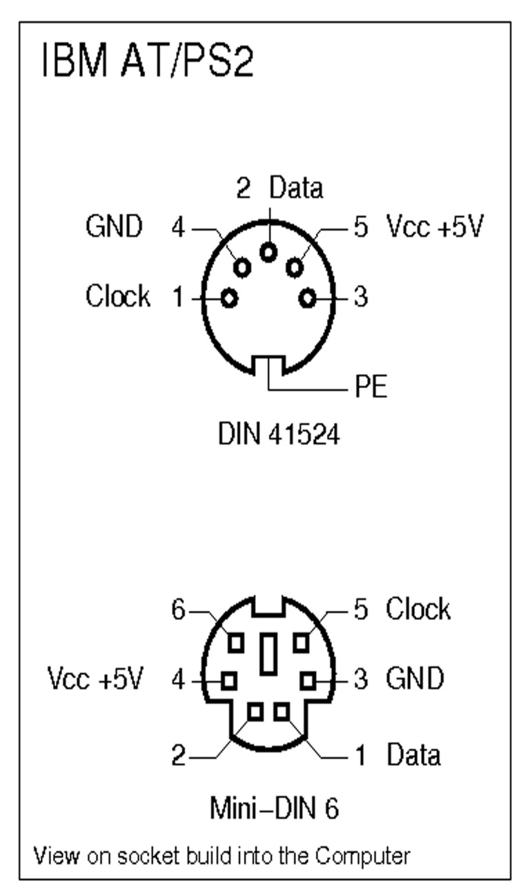

I have several of these: you don't need an ADB adapter. You actually need a 4pin to 6pin cable since it is PS/2 compatible.

No, it's not an ADB port, it's a PS2 port with a 4 pin terminal.

Well ADB is normally 4 pin and PS2 is normally 6 pin but for some reason Filco used 4 pin PS2 cables on their PC keyboards.

The PS/2 connector is physically a "mini-DIN-6" https://en.wikipedia.org/wiki/Mini-DIN_connector but only 4 pins are active as #2 and #6 in this diagram don't do anything. I have seen keyboard cables where they were cut off or did not exist.

I've been looking for one of those! Can't find them anywhere online, I keep finding cables for a Playstation 2 or other 6-pin/4-pin cables like Molex... :x
fohat wrote: The PS/2 connector is physically a "mini-DIN-6" https://en.wikipedia.org/wiki/Mini-DIN_connector but only 4 pins are active as #2 and #6 in this diagram don't do anything. I have seen keyboard cables where they were cut off or did not exist.
Yeah, just seems like a weird design choice though, given the prevalence of PS/2 ports on that era of PCs. You can usually still find PS/2 on modern PCs too. Maybe it really was because Strong Man was trying to cut costs by keeping the ADB port instead of converting them over to using a 6-pin port.

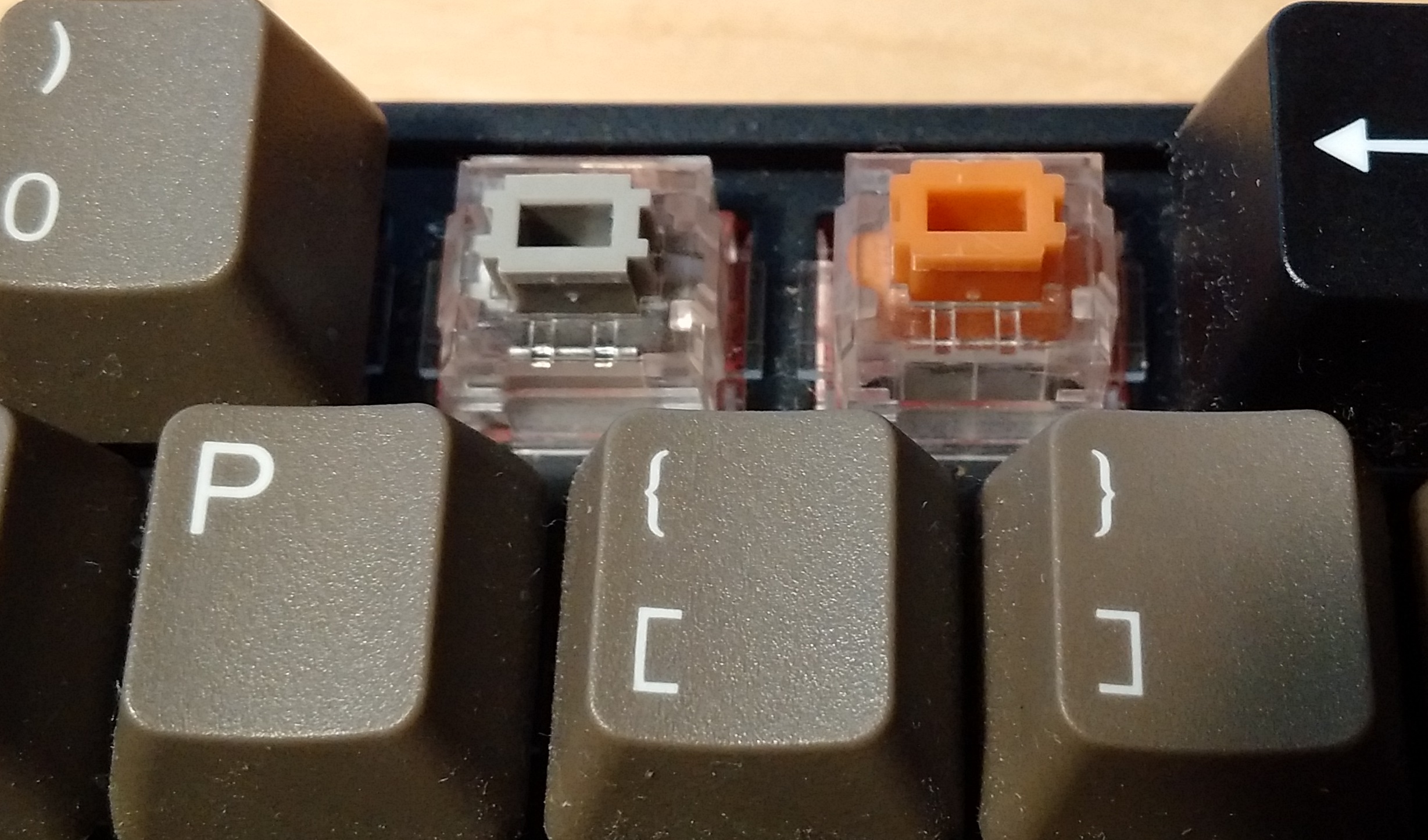

This evening I had some spare time to waste on some vintage Alps keyboards laying around. One is a AEK I with orange Alps and one is an AEK II with White dampened Alps. Both have seen quite heavy use I guess, at least their spacebars are rather yellow.
Since I wasn't very happy with neither of them I tried opening the switches, cleaning them, lubing them and finally I reassembled them. Turns out they've gotten even worse.
I don't know what happened, but some of the switches are, if only a little, clicking now during the upstroke? Even some of the switches I only opened and cleaned (didn't do anything to the springleaf, no lube, no bending) started with this weird behaviour. Is there any common mistake that can provoke this symptom? What makes me wonder is that both switches (orange and d. white) do this now and I got no idea why.
Well anyway, out of anger I decided to get a spring leaf from one of the many Matias QC I got lying around and put it into one of the orange Alps. The result is quite nice: Very tactile, no click during the upstroke (although the Matias leaf comes prelubed) and overall the switch feels quite "new" in comparrison to the other, quite busted orange Alps. If this is closer to what NiB orange Alps feel than busted orange Alps, I can finally understand why orange Alps are so well regarded.
After somebody recommended me to clickmod them (if you read this, thanks again) I tried to use an Matias clicky spring leaf as well and it was basically the same, but a little crisper (I guess "newer" fits quite well again, keep in mind my orange Alps are quite busted). Sadly I don't like to use clicky switches everyday, so I guess I won't be able to use my switches that way. :?
I also tried to use a Matias QC slider in orange Alps, which feels quite horrible. Kind of like an Ergo-Clear with a less pronounced bump (but not grainy like MX Brown) and shorter travel.
But the other way around I achieved a rather interesting result. An orange Alps slider in a Matias QC switch resulted in a crazily sharp tactile bump, of which I'm still not sure whether to like it or not. It's nearly impossible to not bottom out because once you reached the threshold the switch just collapses, hence the bottom-out is quite hard.
A nice side effect is that there is basically no more keywobble, which always annoyed me a lot using unmodded Matias QC.
In the end I'm quite happy with todays progress, I've found two (well three, if I ever decide to get a clicky keyboard again) ways to actually put those Alps to good use. I still don't know what to do with the white dampened Alps though. Maybe I'll try to Frankenstein them as well at some point, I don't know.
Did you ever build a similar Frankenstein switch? If so, where you pleased with it?
Sorry if stuff got a little tangled, especially in the end, but I'm pretty tired
