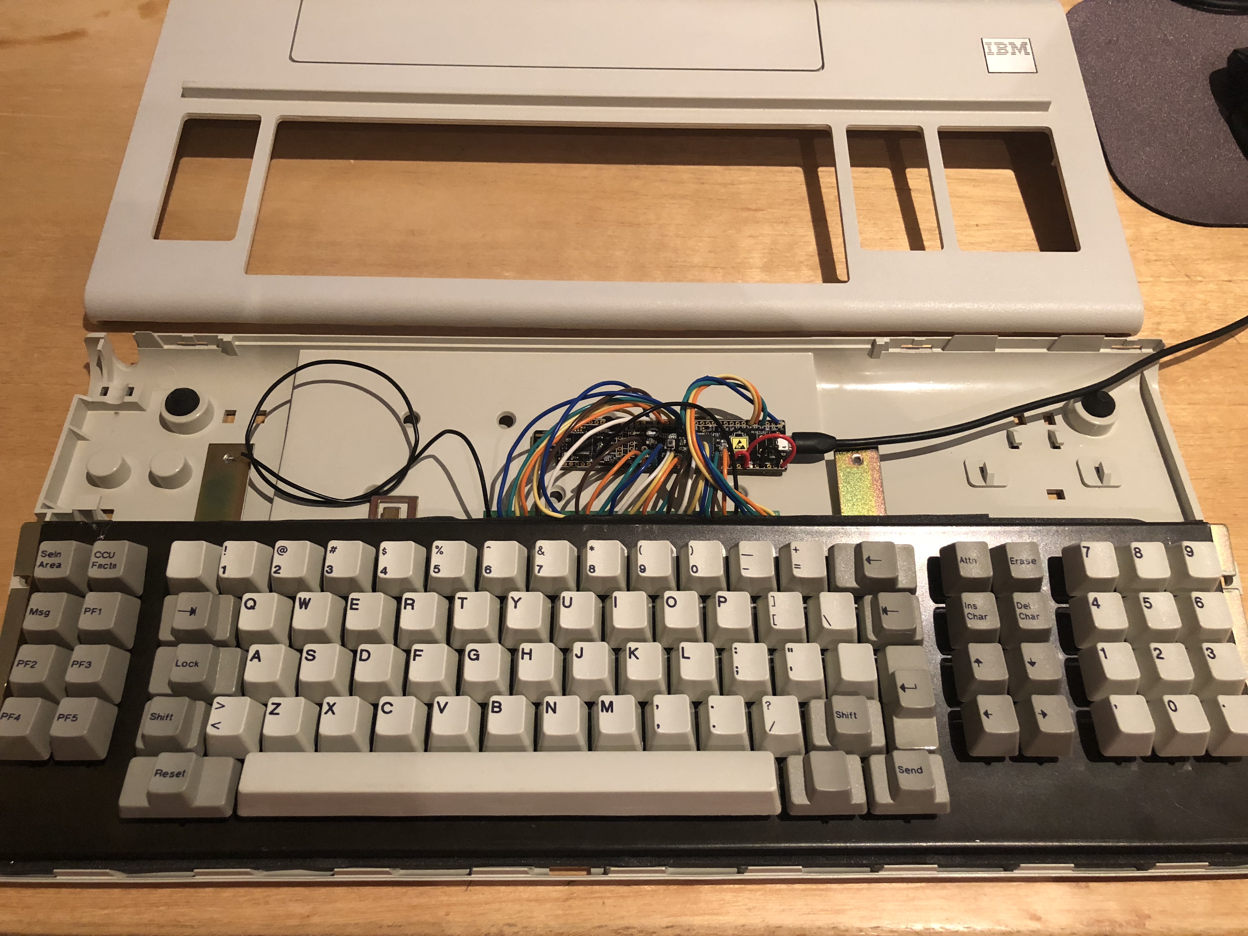

njm
05 Oct 2018, 16:09
Hi DMA, thanks for building CommonSense, it looks awesome and I'm keen to give it a go. I have an IBM model F that looks like a 3178 without the blue switch, but the PCB layout is a bit different. It has 4 rows and 23 columns, as far as I can tell. I thought I'd have a go at getting it wired up using CommonSense on the Cypress board, and I'm trying to figure out the pinouts.
Using the default pins in the current git project, I think I need to do something like this:
- Connect PCB rows to the first 4 row pins (P2_0, P2_3, P2_4, P2_5)
- Connect PCB columns to the last 23 column pins (P1_1, P1_2, ... P0_5)
- Connect both PCB ground & plate ground to controller GND
- Connect P0_2 and P0_4 to VDD
- Connect P0_7 (D0) to GND
Does that sound about right, or did I miss anything? The recommendations in the readme mention that D1 should be grounded too, but I couldn't find D1 in the default pinouts in the Cypress project.
I think I also need to remove C41, C42, and R5 because I have more than 17 columns. Any tips on the best way to remove them?
DMA
06 Oct 2018, 05:00
njm wrote: Hi DMA, thanks for building CommonSense, it looks awesome and I'm keen to give it a go. I have an IBM model F that looks like a 3178 without the blue switch, but the PCB layout is a bit different. It has 4 rows and 23 columns, as far as I can tell. I thought I'd have a go at getting it wired up using CommonSense on the Cypress board, and I'm trying to figure out the pinouts.
Sounds about right. D1 is no longer there, it was there about a year ago :) I'll clean this up.
njm wrote: I think I also need to remove C41, C42, and R5 because I have more than 17 columns. Any tips on the best way to remove them?
Just desolder them. They're pretty small, so just heat both ends and move it away from the pads they occupy.

njm
08 Oct 2018, 14:43
I just finished wiring this up and reassembled the keyboard. After a bit of tweaking the hardware parameters in FlightController it's all working perfectly!
I misread the wiring instructions initially, and thought that I had to wire up the last 23 columns (as opposed to the first 23). Luckily figured this out after wiring up only a few columns. Other than that, it went really well. My wiring is not the neatest, but seems to have done the job :)

Thanks Sandrax. Great work on your 3178 by the way. I think it was your post that gave me the idea to use CommonSense. I was was previously thinking of using an xwhatsit, but wasn't sure if it could be configured to handle 23 columns.
I think I might need to adjust my wiring a bit, as I'm finding it hard to close the case (there's not as much vertical space in there as I thought). I really like the board though, it has a nice feel to it, and it seems like the layout has potential. Interestingly the blank keycaps are not pressable, so I might swap out the one in the top left at least, for a working tilde key.
