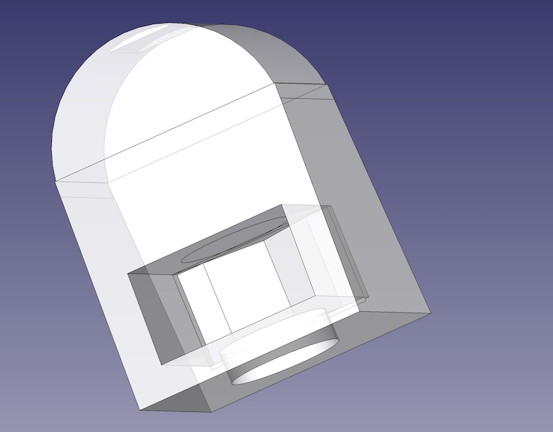

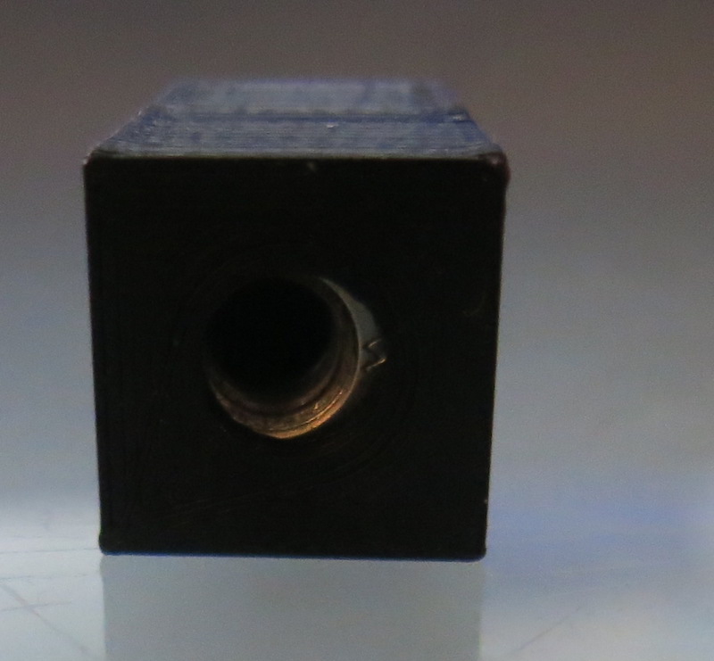

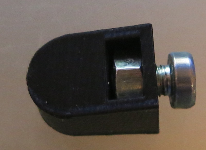

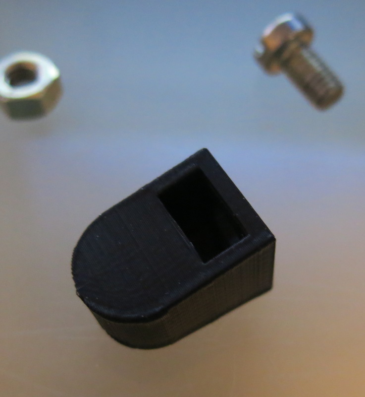

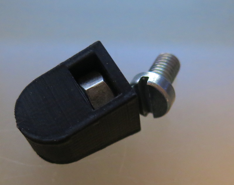

darkcruix
12 Oct 2018, 20:14
A while back, I brought up to build feet for the New Model F, comparable to the ones from the original.
Ellipse suggested to use the built-in holes and single feet for each side.
I have created a sample one that has the same height and similar design like the original (the right color needs to be used, of course).
I'd like to hear your thoughts on it.
Here's what I have so far:
3D Design:
Screen Shot 2018-10-12 at 20.09.26.jpg (49.06 KiB) Viewed 8617 times
Printouts in black:
