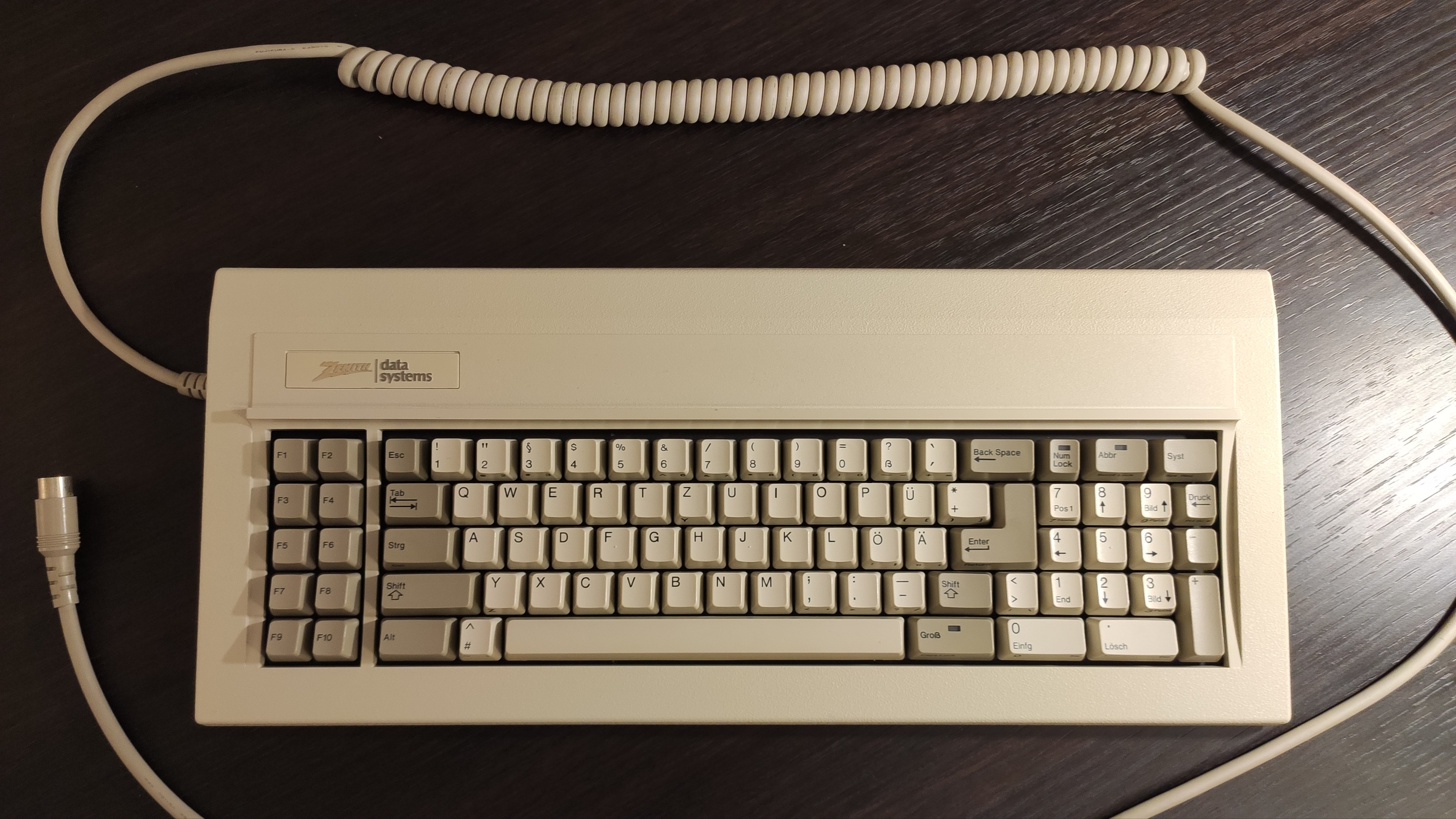

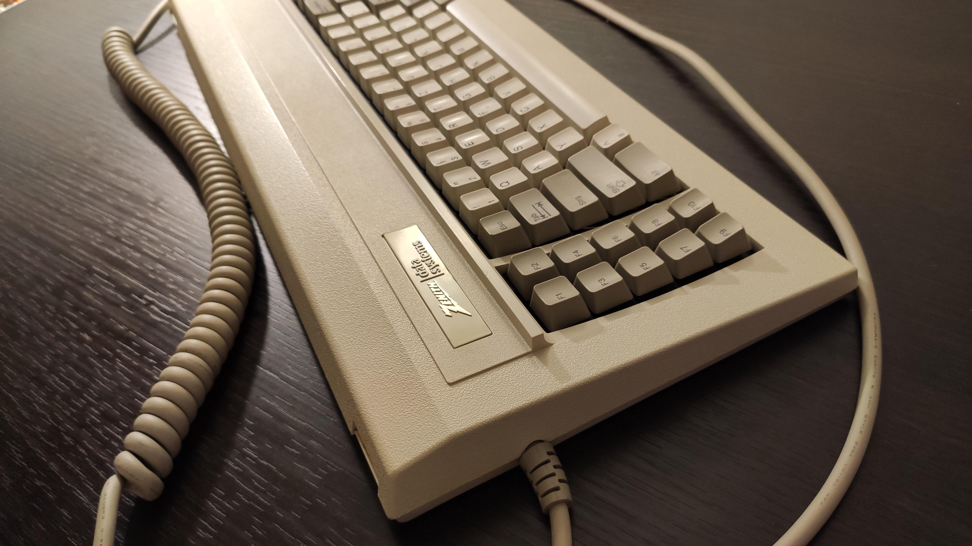

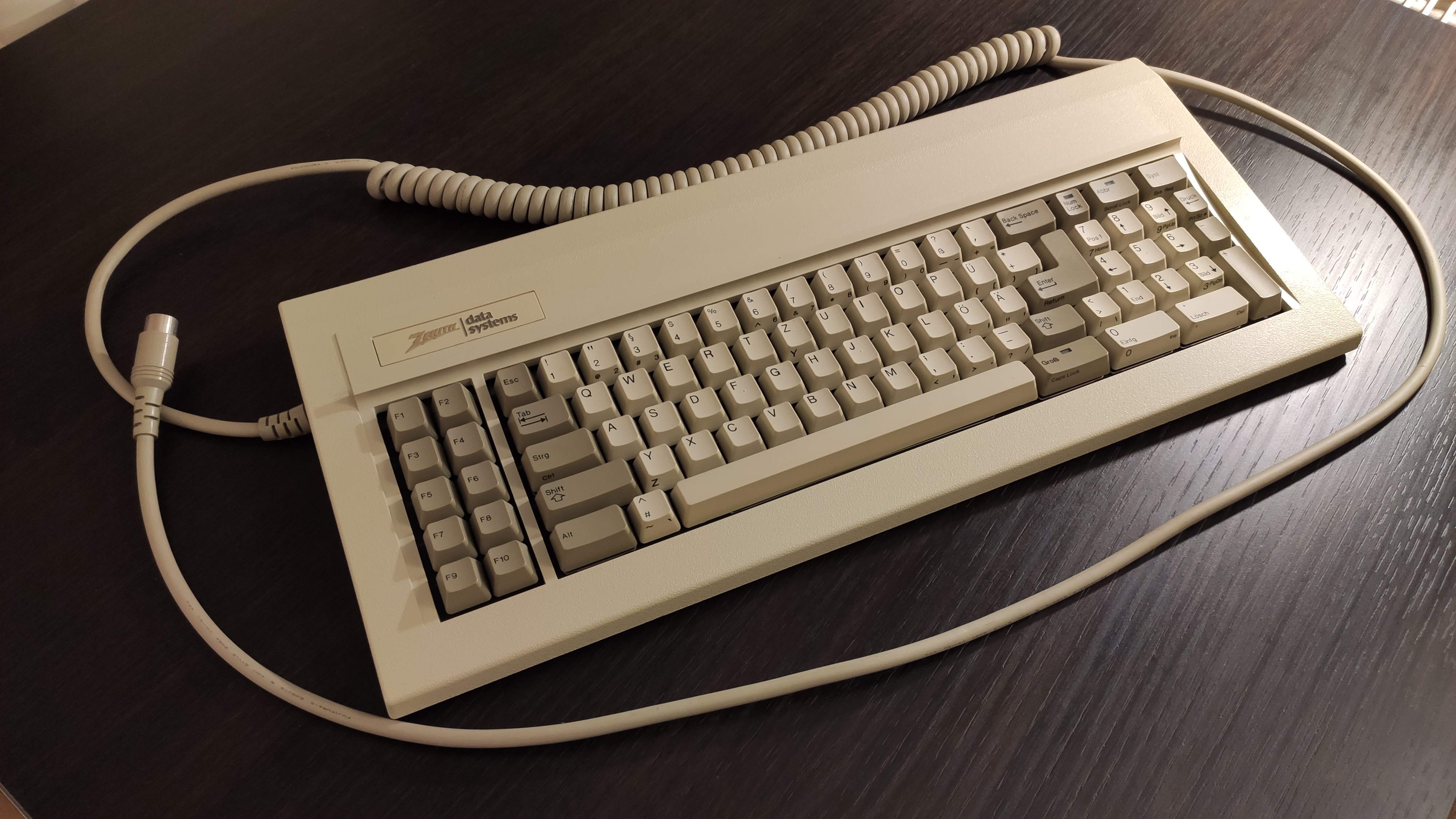

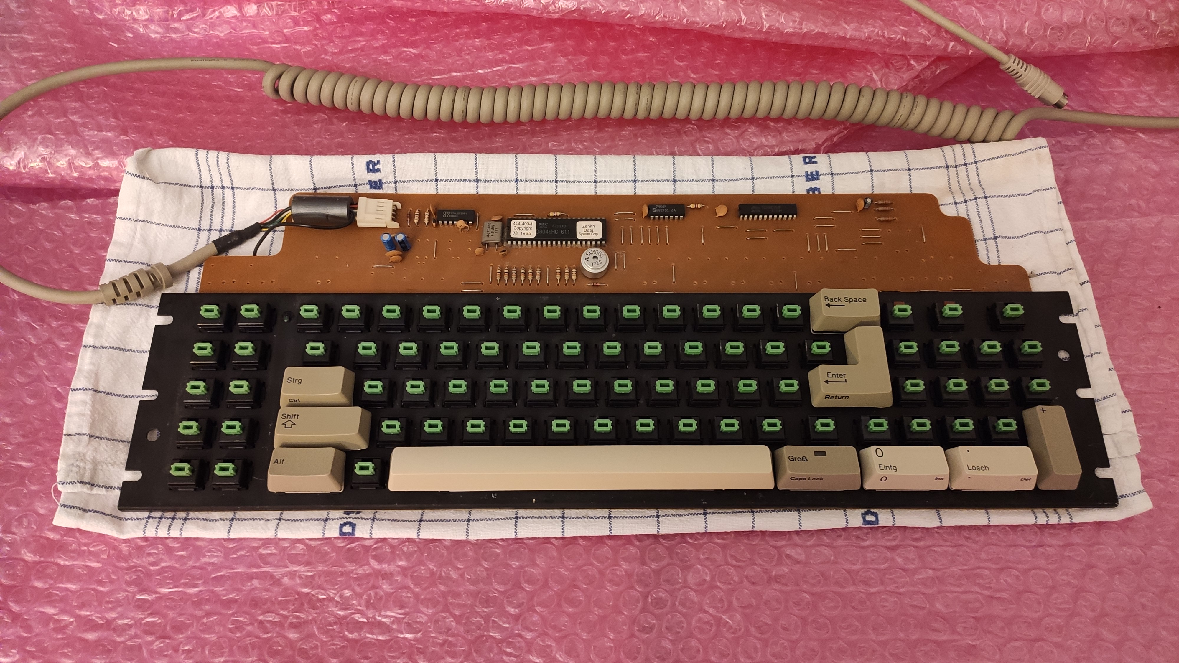

- doomsday_device
so happy that ive found one
*drooling*
*drooling*
- IMG_20201206_013259.jpg (2.15 MiB) Viewed 9096 times
- IMG_20201206_012955.jpg (1.26 MiB) Viewed 9096 times
- IMG_20201206_012939.jpg (1.4 MiB) Viewed 9096 times
- IMG_20201205_231706.jpg (1.45 MiB) Viewed 9096 times
