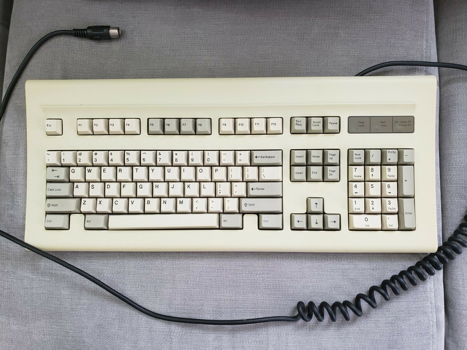

mode1ace
09 Feb 2021, 12:51
I’ve finally got a no compromise good result with nexus sliders.
MT3 works night and day better with them than SA, I just swapped SA Dasher for MT3 Dasher and it’s wonderful. it had some binding with SA, that’s completely solved.
The board uses SKCM orange with modified original housings.

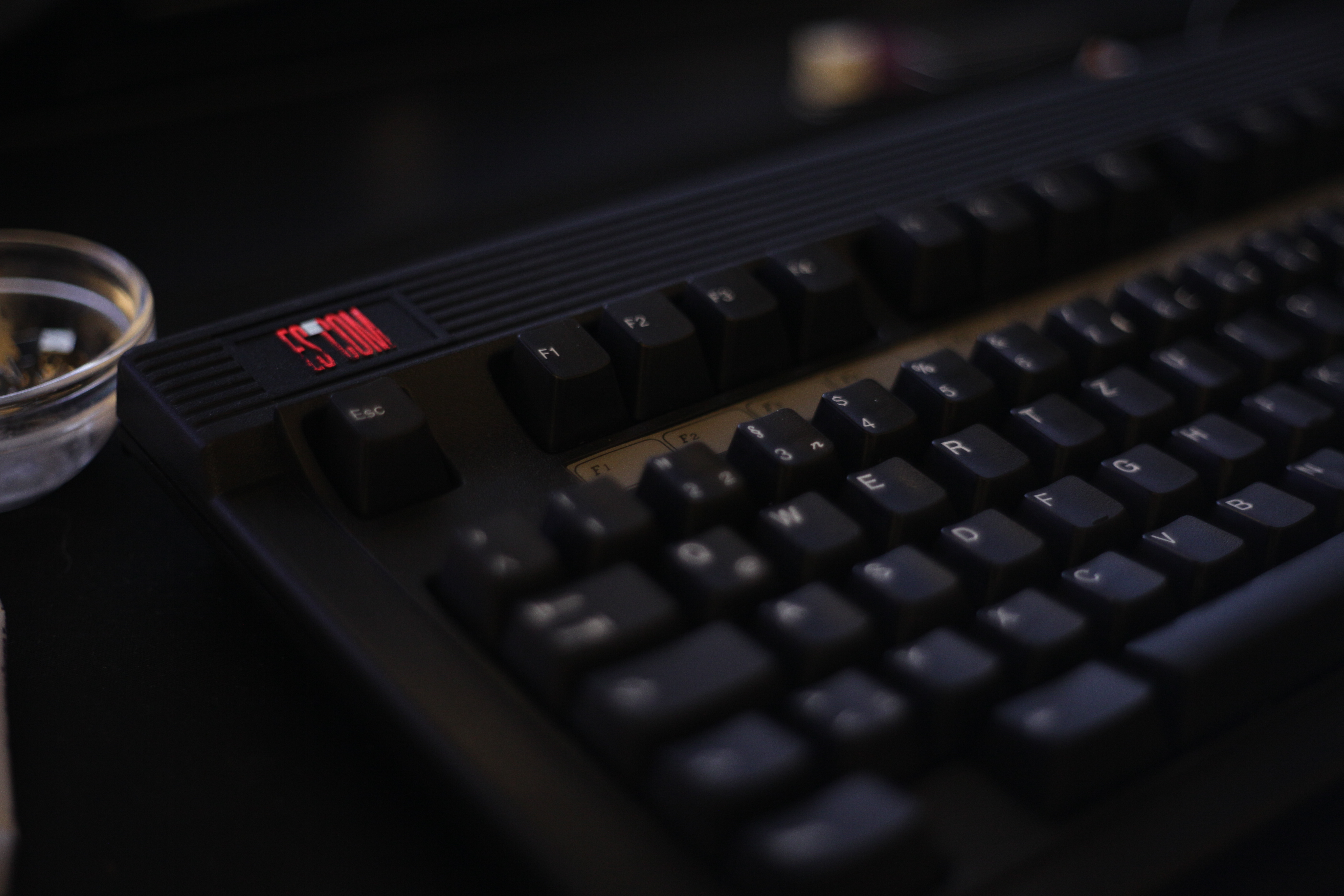

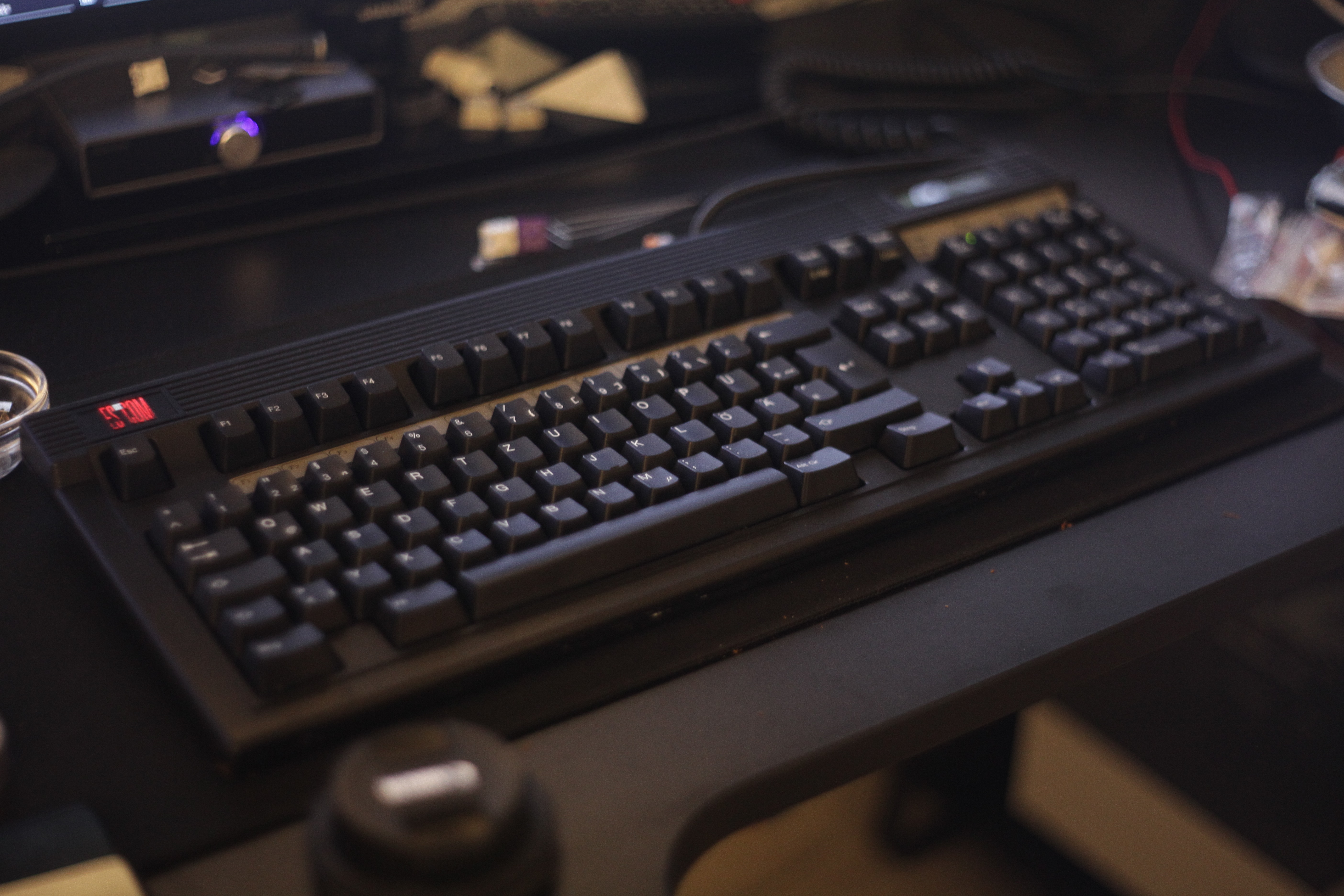

doomsday_device
22 Feb 2021, 21:24
black fk3002 (also calculator is working but not pictured)
kelvinhall05
22 Feb 2021, 21:31
doomsday_device wrote: 22 Feb 2021, 21:24 black fk3002 (also calculator is working but not pictured)
Nice, white Alps too, best switches
doomsday_device
22 Feb 2021, 21:32
kelvinhall05 wrote: 22 Feb 2021, 21:31
they are so good that i linearized them :D
22 Feb 2021, 23:06
Noice, that looks delicious :D .
