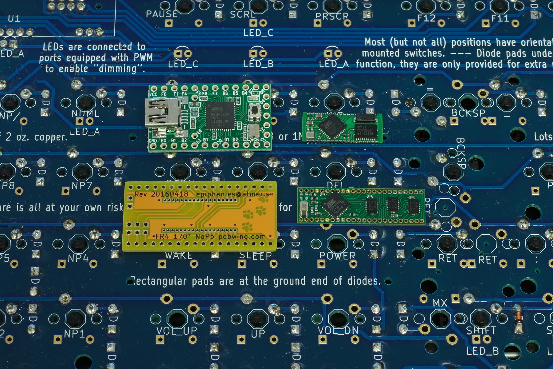

That Kimera looks pretty big still.. Is there any schematic for it? And isn't that a resonator? I didn't think it would run USB very well without the accuracy of a crystal or oscillator.
Why not go small, and I mean small, if you're looking at QFNs anyway? (Perhaps the ARMs don't come in anything larger?). Component wise I figure it's about the same. The ARM might not need an oscillator, on the other hand you need a regulator (which you can benefit from for other functions as well, like Bluetooth modules).
The yellow board is there only because it happens to be pretty much exactly 18x38mm. The photo lies a tiny bit, the Teensy is angled more towards the camera, and may look a bit wider. And I would recommend sticking to 0.05" in place of 1mm pitch... Anyone capable of soldering SMD should be able to solder 1.27mm pitch =)
Edit: Found the schematic. I don't think I get the idea. Sure it's neat with IO-expanders, but they just threw 11 perfectly good ATmega GPIOs away... And that sure is a resonator.

The point of this controller is not to be the smallest size possible, but to be easy to add to any DIY project, and since it is intended to be sold assembled nobody is expected to know how to solder QFNs ;) 0.1" headers will probably be easier for everyone to work with.

But still.. Make it narrow enough to fit between a row of switches. 0.1" pitch will just make it very long... And I really think 0.05" should be solderable by most people. And I would stick to a separate USB connector, and separate multiplexers. Make stuff fit between switches. All that's of course just my 50¢, this isn't my project =)

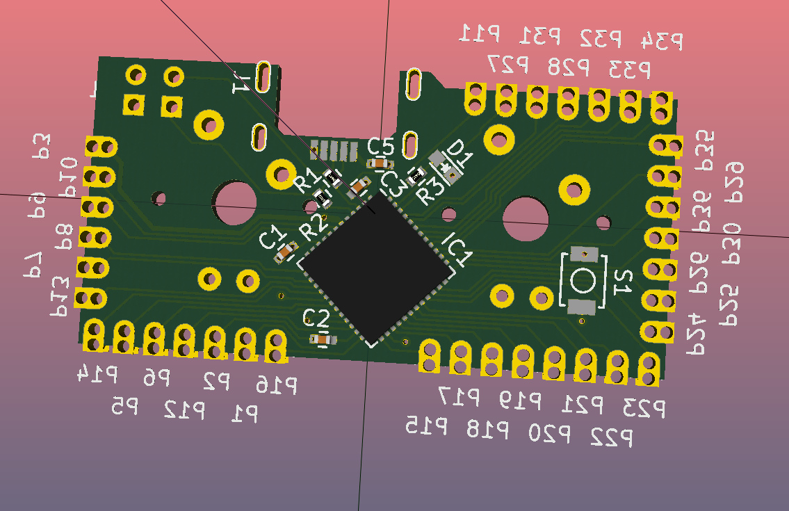

A new benefactor (who is not keen to participate to the forum discussion) worked on this.
Any comments, suggestions, thoughts?

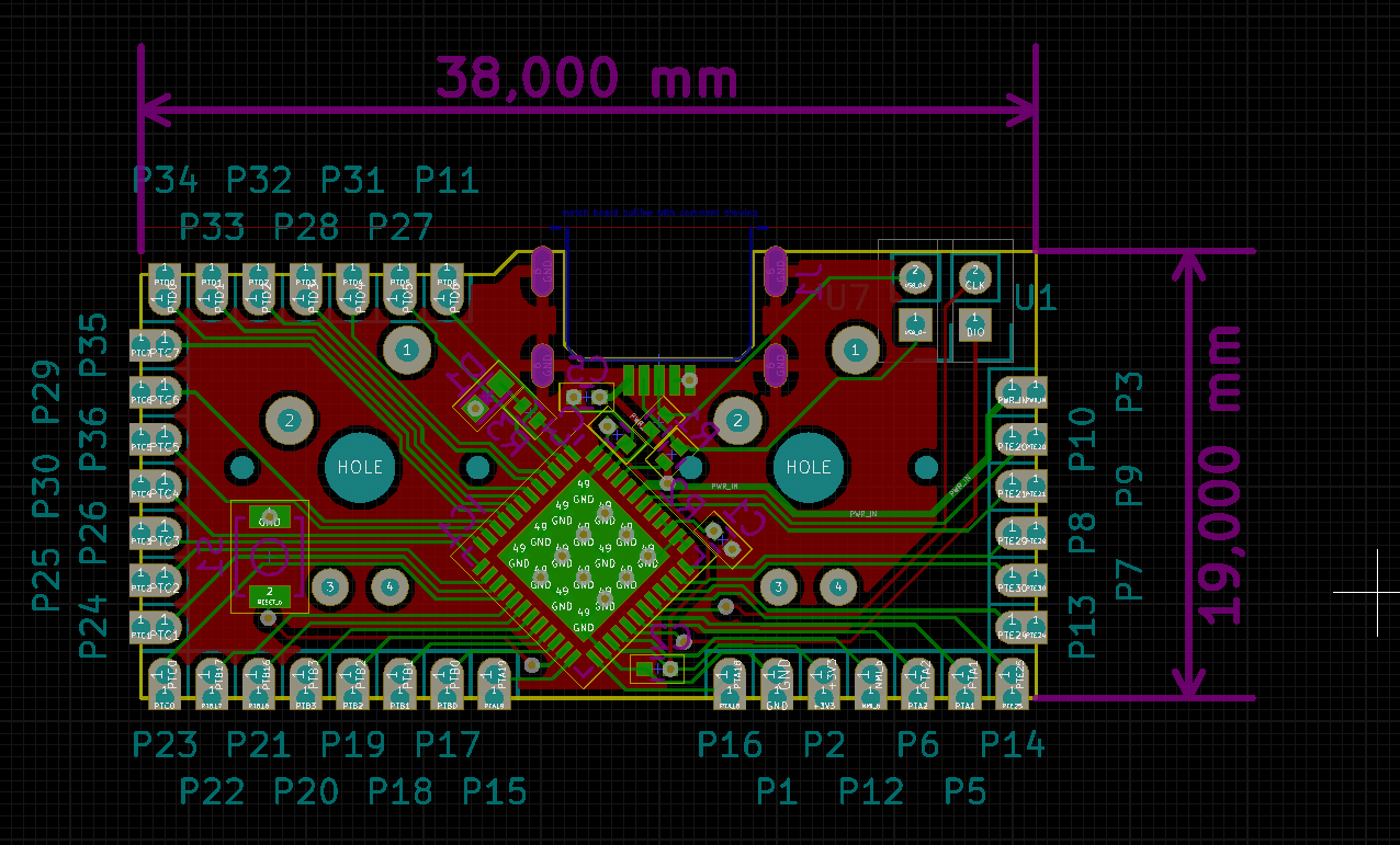

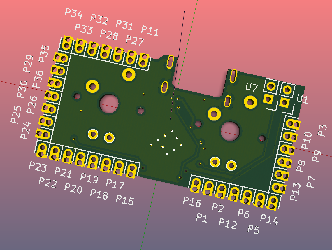

The routing seems good for the parts that he has done already, but:
1. It wont stay stable on two switches if they are not soldered on to the pcb. - Needs solder pads at least on the bottom side.
2. No led support, even if it was soldered on a pcb. - Needs holes and maybe pads too.
3. No mid mount connector making it a bit thick. - Just a personal preference.
4. No usb type c. - Just a personal preference.
5. What is the deal with the crystals and some additional ICs on board? I thought they are not needed with the previously selected IC.

yup the additional crystal is not needed and will be removed. padding on the switch holes is not strictly needed but let's see if we can fit it.

Oh well, routed my version finally completely. I don't have the measurements for alps solder points, but there is still a lot of room to play with. It has even an almost complete ground layer. All pins on the IC have been routed.
Just point me to a proper alps footprint and I'll add the support.
Sorry for not doing this months ago.

pomk wrote: Oh well, routed my version finally completely. I don't have the measurements for alps solder points, but there is still a lot of room to play with. It has even an almost complete ground layer. All pins on the IC have been routed.
this looks good to me, I believe the switches should be upside down though, so the LED is on top.

Agree to disagree on the LED positions? I prefer cherry caps.
The question is not about the switches staying in place, but rather the elf board. If the board cannot be soldered on the switches, as was the case in the pcb you posted, there will be nothing to keep it in place.
