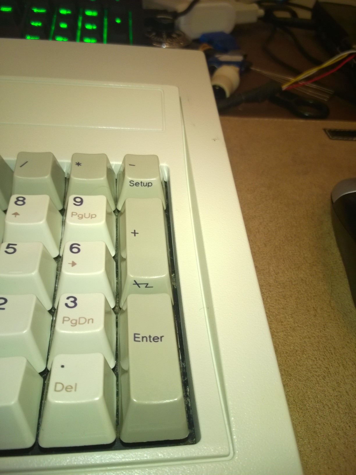

@scottc: No, it's not a Polish letter. There are a few 1395162's on ebay and they all seem to have this weird /Z symbol on the front of the keypad_plus. I don't really know what it means...

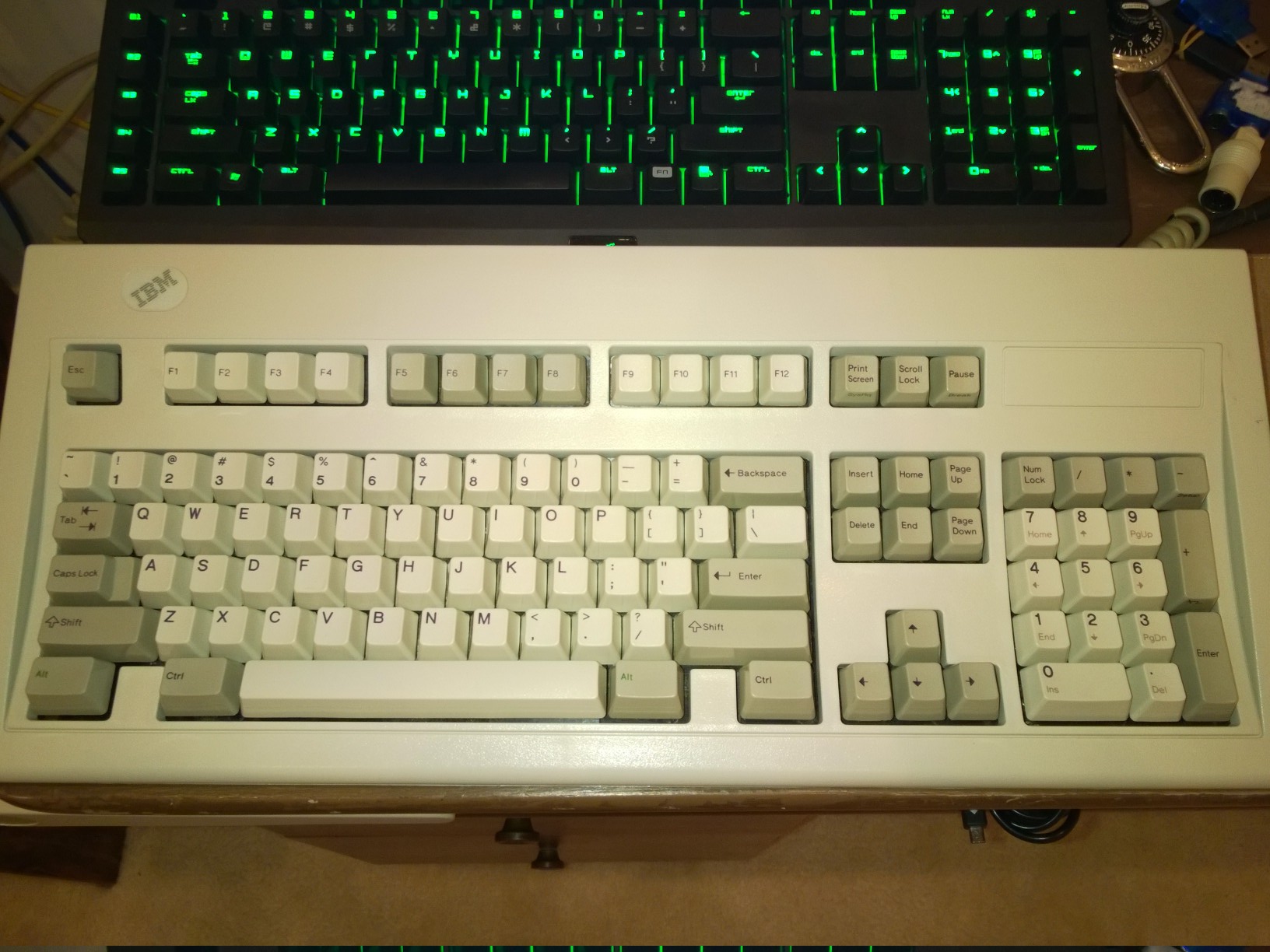

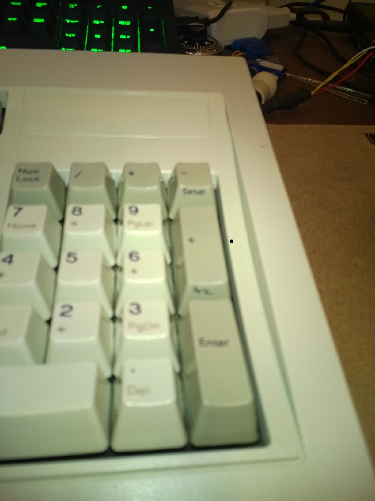

Notice the &quot;Setup&quot; and &quot;\z&quot; on the front of pad_minus and pad_plus.  These are the only two keys that are different from the standard M PS/2 keyboard.
Notice the "Setup" and "\z" on the front of pad_minus and pad_plus. These are the only two keys that are different from the standard M PS/2 keyboard.
Notice I've swapped the LCTRL with LALT to get a CTRL key working...
Sorry the first picture is a little blurry -- unsteady hands...
So I've got a working keyboard with one LCTRL and one RALT key working. The LALT and RCTRL in the picture above do not work...

Here's a better picture...

I have never seen that either, and even detexify ( http://detexify.kirelabs.org/classify.html ) can't find it. And it's not an APL symbol.
Maybe the keyboard was made for some special hardware/machinery, which would also explain the "Setup", and this symbol means some very special procedure of that machine, like cutting something... Nice riddle anyway...

Weird symbol, all right. Looks more at home on a Phonecian keyboard than English! Hard to tell what it is, perhaps a stylisted katakana or hiragana Japanese symbol? But the wouldn't mean anything in the context. Far as I know, Japanese use + for addition, just like us.
