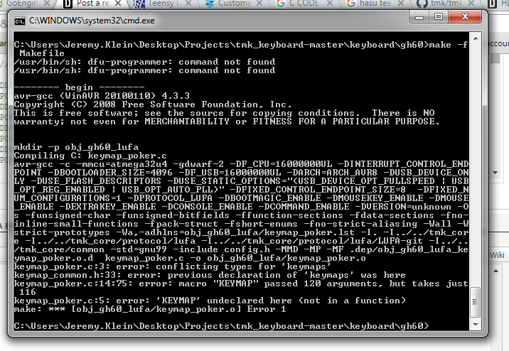

Hello all, thank you for this post as it has gotten me close to running, but I have an error during compile that I need some help with. Below are the files I have modified for my build, I am running a 12c x 10r matrix to run a full tenkey with some added keys with a teensy 2.0

I am pretty new at this and may have gotten in a little over my head but I think I am close here the error I am getting is attached
Any help would be greatly appreciated

The error states clearly, you need to have 120 arguments in your KEYMAP, but have only 116.
Perhaps use KC_NO instead of empty arguments? I'm not clear what do you actually want to have there, but I don't think empty arguments (two commas one after another as empty argument) will work.

Forgive the fact that I am new to programming, I see the issue with the arguments my question is where is my coding error that needs to be corrected to get that taken care of?

23 Jan 2016, 00:21
See my edited answer above.

thanks laser I will change those arguments and see how it goes,

23 Jan 2016, 09:31
I think I found the mistake:
In your keymaps[][MATRIX_ROWS][MATRIX_COLS], remove the last comma in the first four rows.
And for the empty arguments, make them "NO" instead of empty space. (If there is no switch on that matix-crosspoint, the TMK way to do it would be to change the KEYMAP macro to do it; but you can change that also later, once it compiles with "NO" in the keymaps array.)
I am not sure about the following: maybe your MATRIX_ROWS and MATRIX_COLS are not set to your correct values.
metalhed73
26 Jan 2016, 02:04
thank you all for the help, got it figured out.....now much wiring ahead

Hello everyone, i came into an issue when i tried to flash the code to the teensy (I have the teensy++) when i flashed the software, the keyboard inputs "279" then for some strange reason the computer acts as if the "CONTROL" key is being pressed. Even when the keyboard is unplugged. I really hope i didnt fry my teensy, or anything else. :( Can someone please review my code to see if i messed up anywhere :( I have been working at this for about 4 hours...

http://imgur.com/a/AoFrT what the keyboard actually look like.
EDIT: added photos

you do not seem to have changed anything from the original g60/poker, right? maybe you can point out what were your changes.. I didn't spot anything suspicious..
Maybe try to comment out in the makefile the following three options:
#BOOTMAGIC_ENABLE = yes
#MOUSEKEY_ENABLE = yes # Mouse keys(+4700)
#EXTRAKEY_ENABLE = yes
Also not sure about the teensy++ if that will run out of the box, since I only tried it with teensy2.0 so far..
Otherwise no wanting messages during compilation?

You have 'F0' instead of 'F10' on the second layer. There's no such key as 'F0' (this is actually kinda written in the error message you posted ;)
Halvar
12 Feb 2016, 00:50
Replace f6 by F6 and F0 by F10 in the first line of your second layer in keymap_raf.c .
Also delete the trailing comma in this line:
       NO,  TRNS,TRNS,LCTL,          TRNS,     TRNS,TRNS,TRNS,TRNS,TRNS,         DEL ,     BSPC,TRNS),
I don't know if that's all, but that seems to be what the error messages that you're getting are about.
flabbergast
12 Feb 2016, 00:52
Ah yes, missed the other ones :) /me should get some sleep.
mastermachetier
12 Feb 2016, 01:04
Halvar wrote: Replace f6 by F6 and F0 by F10 in the first line of your second layer in keymap_raf.c .
flabbergast wrote: Ah yes, missed the other ones :) /me should get some sleep.
Wow thanks guys !! I feel like an idiot now haha.
