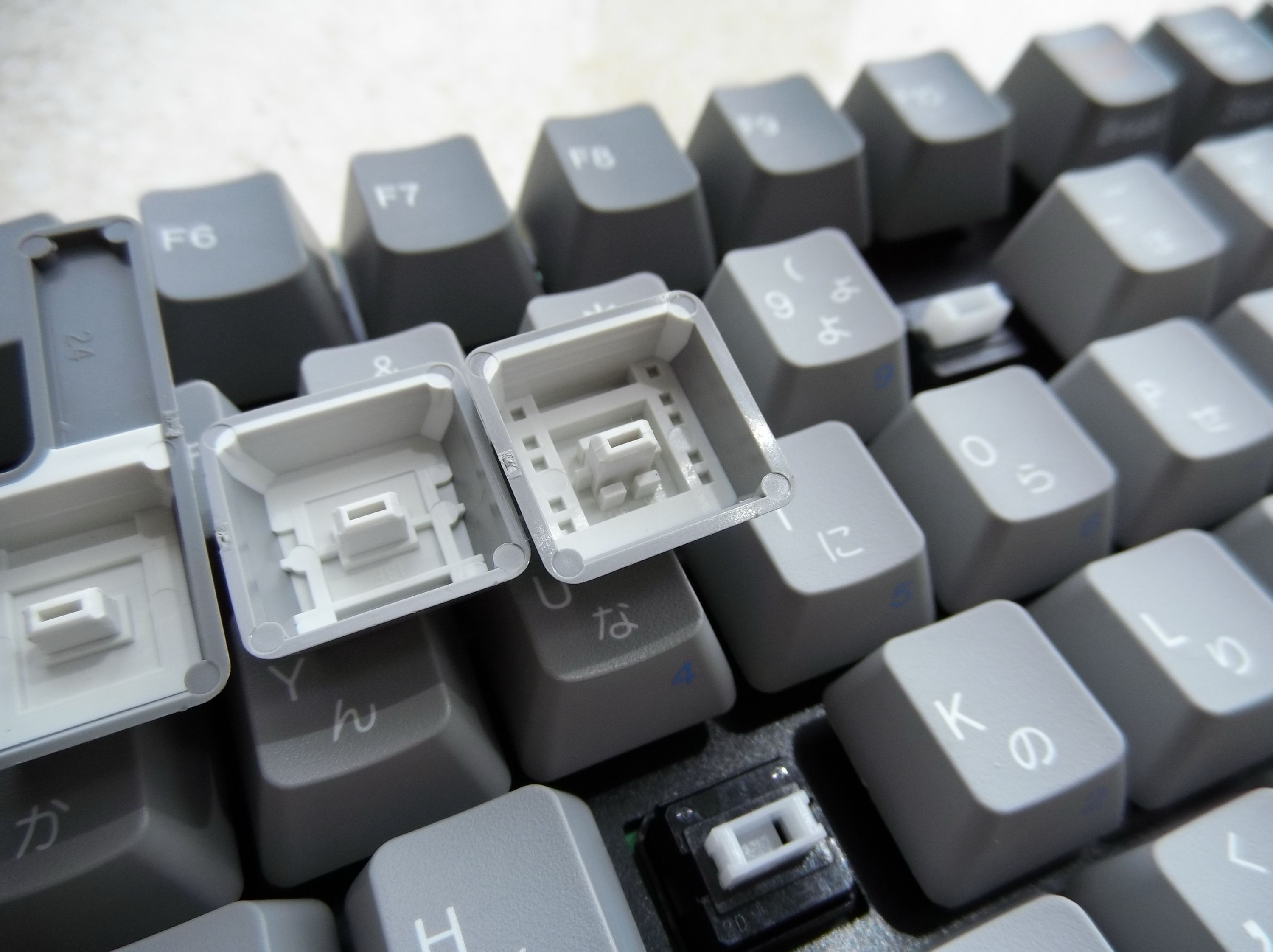

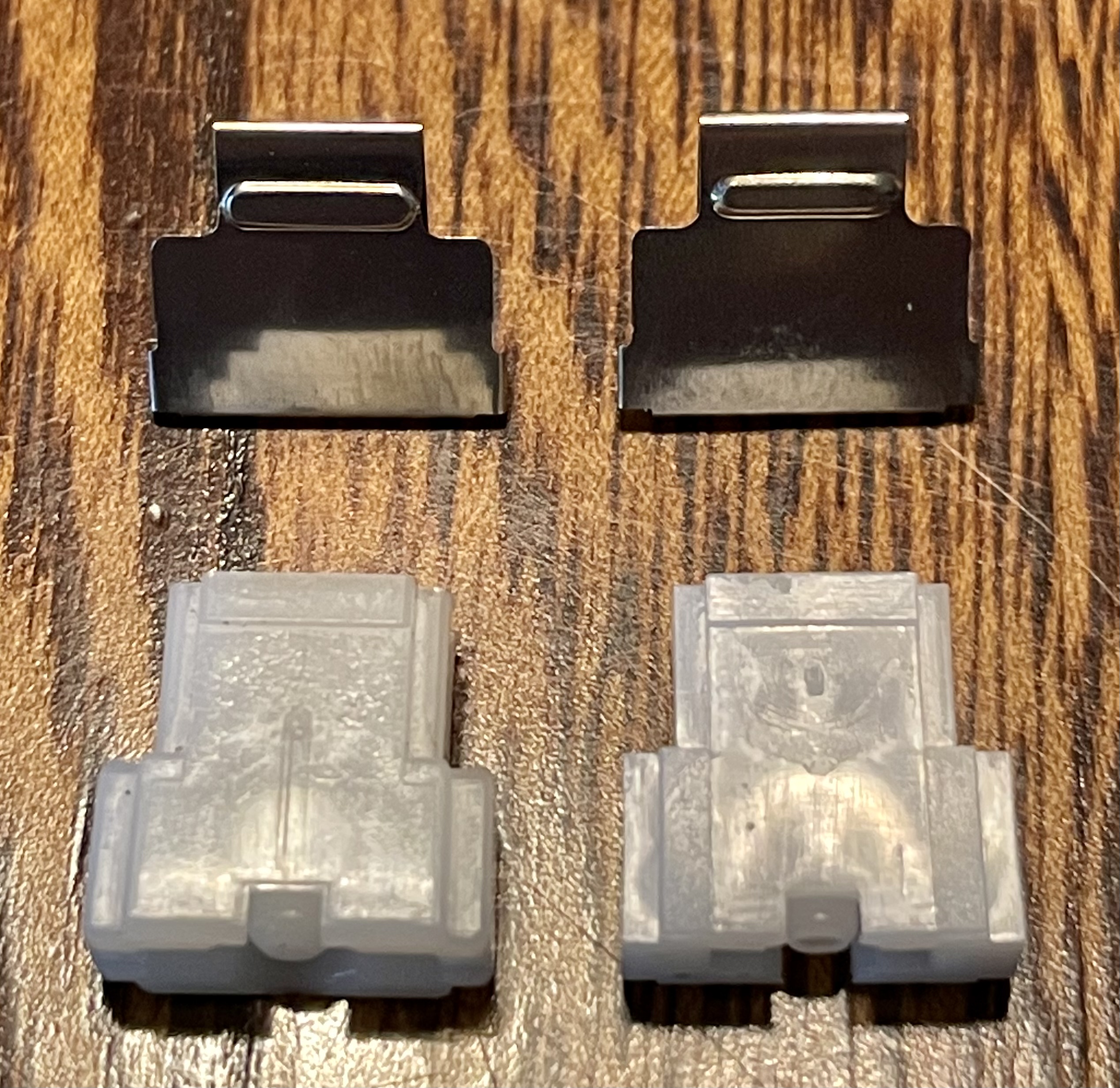

Yes it should work without issues. Alps clones should also work. Below is a picture of pine white alps with the original slider on the left and a Matias slider on the right. The Matias sliders it slightly smaller but works.
- Polecat

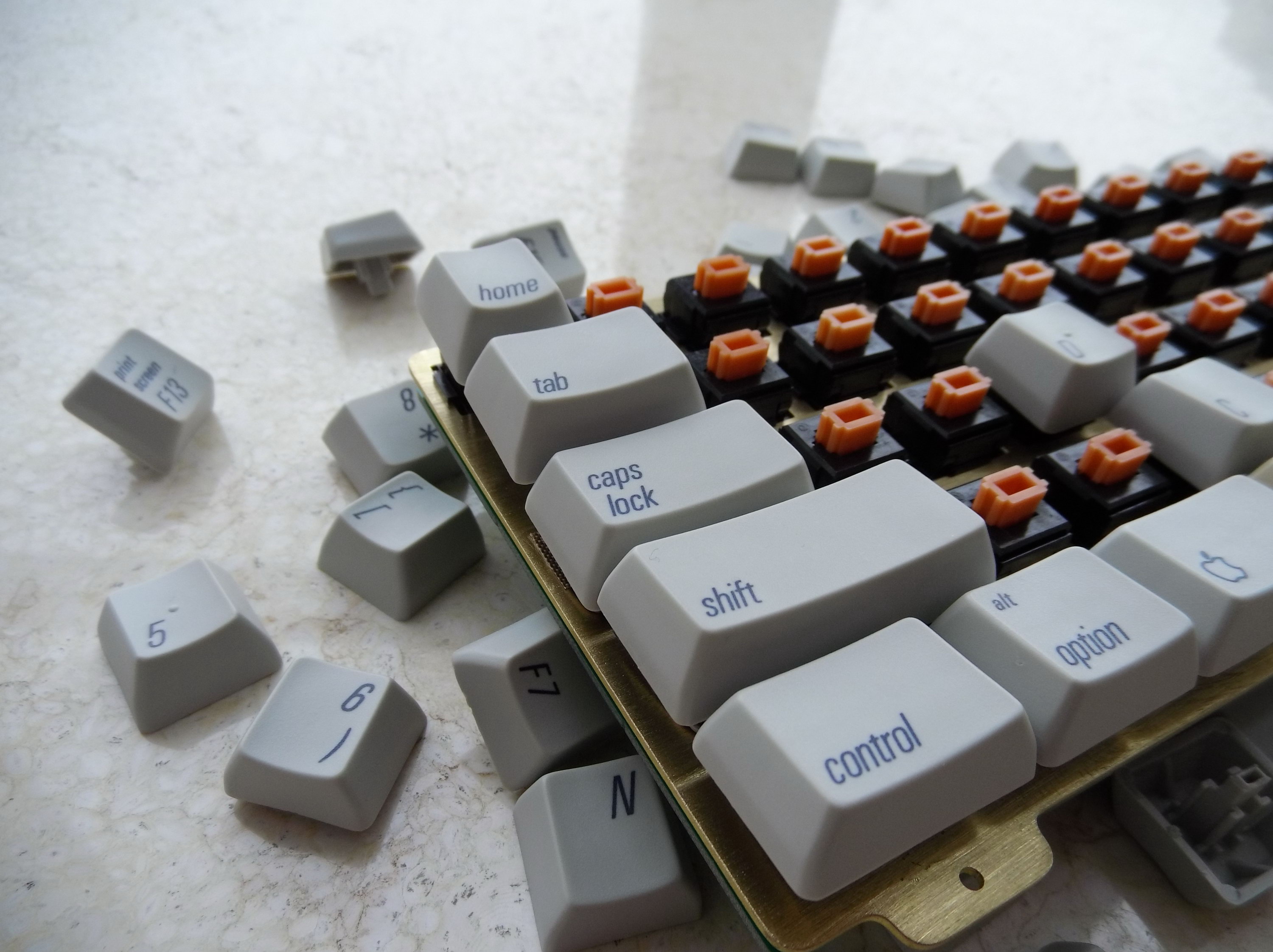

Wait, are those really Alps switches? Those are what I've been calling the "mystery switches", from 1992-93. Unbranded upper and lower housings, 1x mold numbering, and complicated Alps-style switchplates. They feel and sound like early SKCM switches, nothing like SKCM from 1992-93. I've found those in Datacomp keyboards, and they are hinted at in the wiki in a couple places. But who actually made and sold those, and why is the Alps branding missing?thefarside wrote: 16 Sep 2022, 05:24 Yes it should work without issues. Alps clones should also work. Before is a picture of pine white alps with the original slider on the left and a Matias slider on the left. The Matias sliders it slightly smaller but works.
edit: here's a wiki link with some photos of the mystery switches.
wiki/Datadesk_Switchboard
Note they're described as "incorrectly molded", but I find that hard to believe, considering how many must have been made. I would suggest that there were no Alps markings because 1) these were not made by Alps (someone else bought their tooling perhaps?) or 2) that someone specifically ordered them from Alps with no branding.

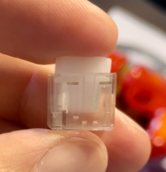

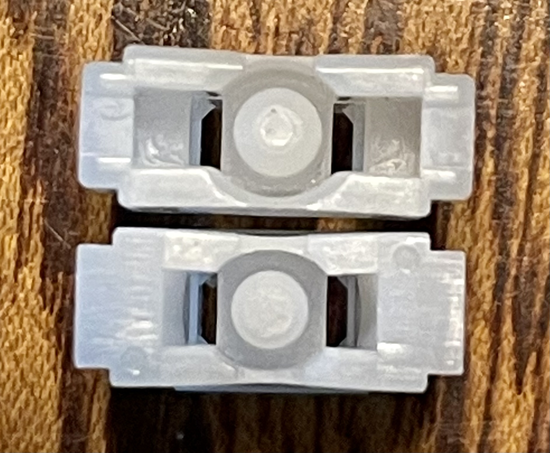

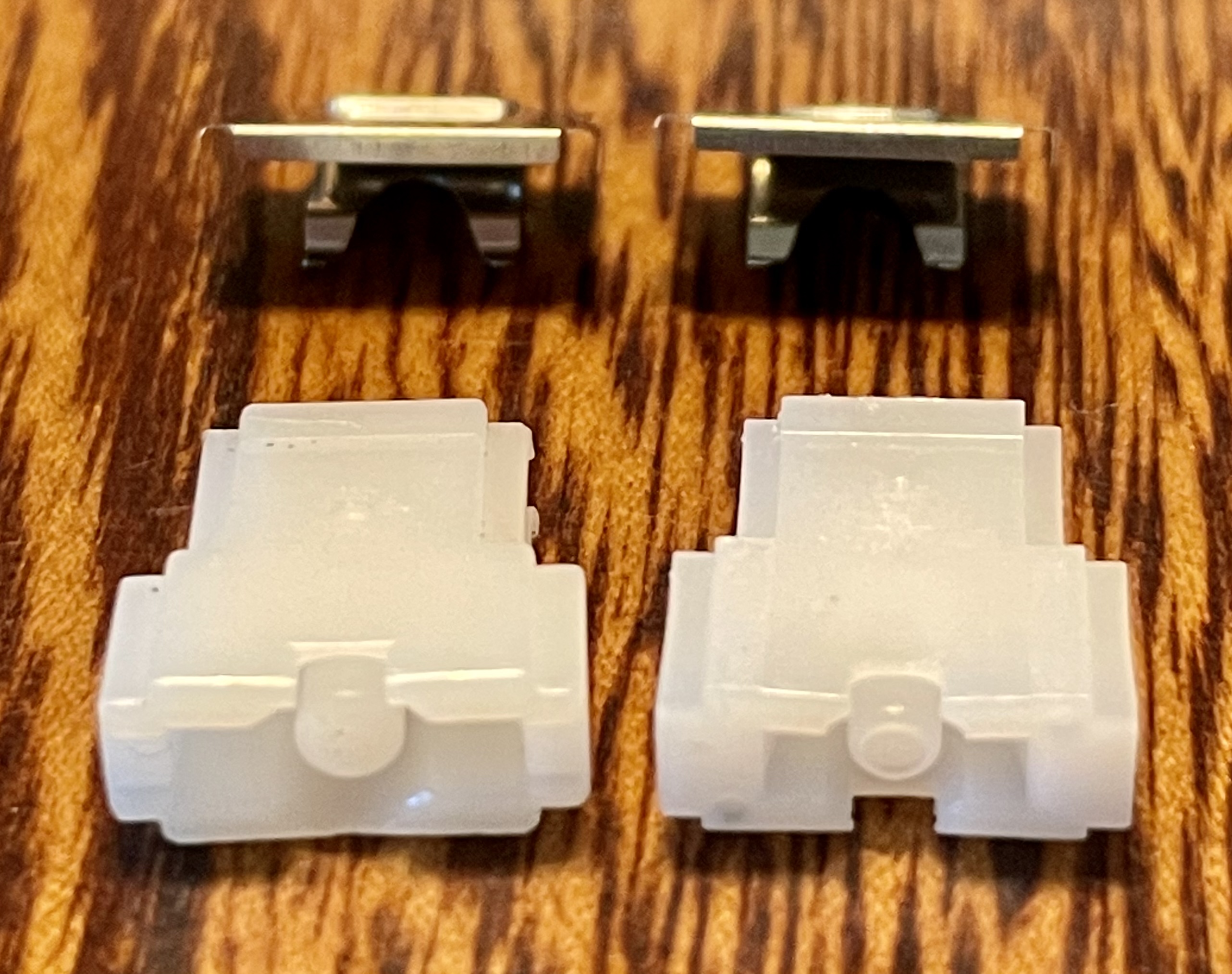

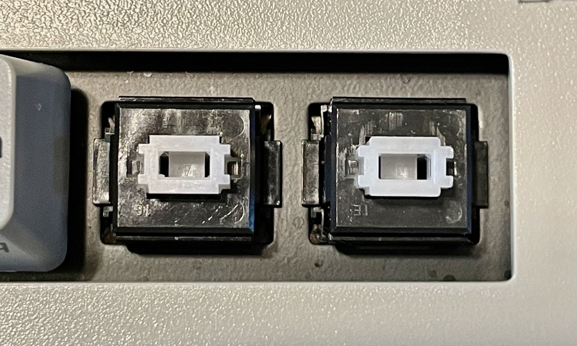

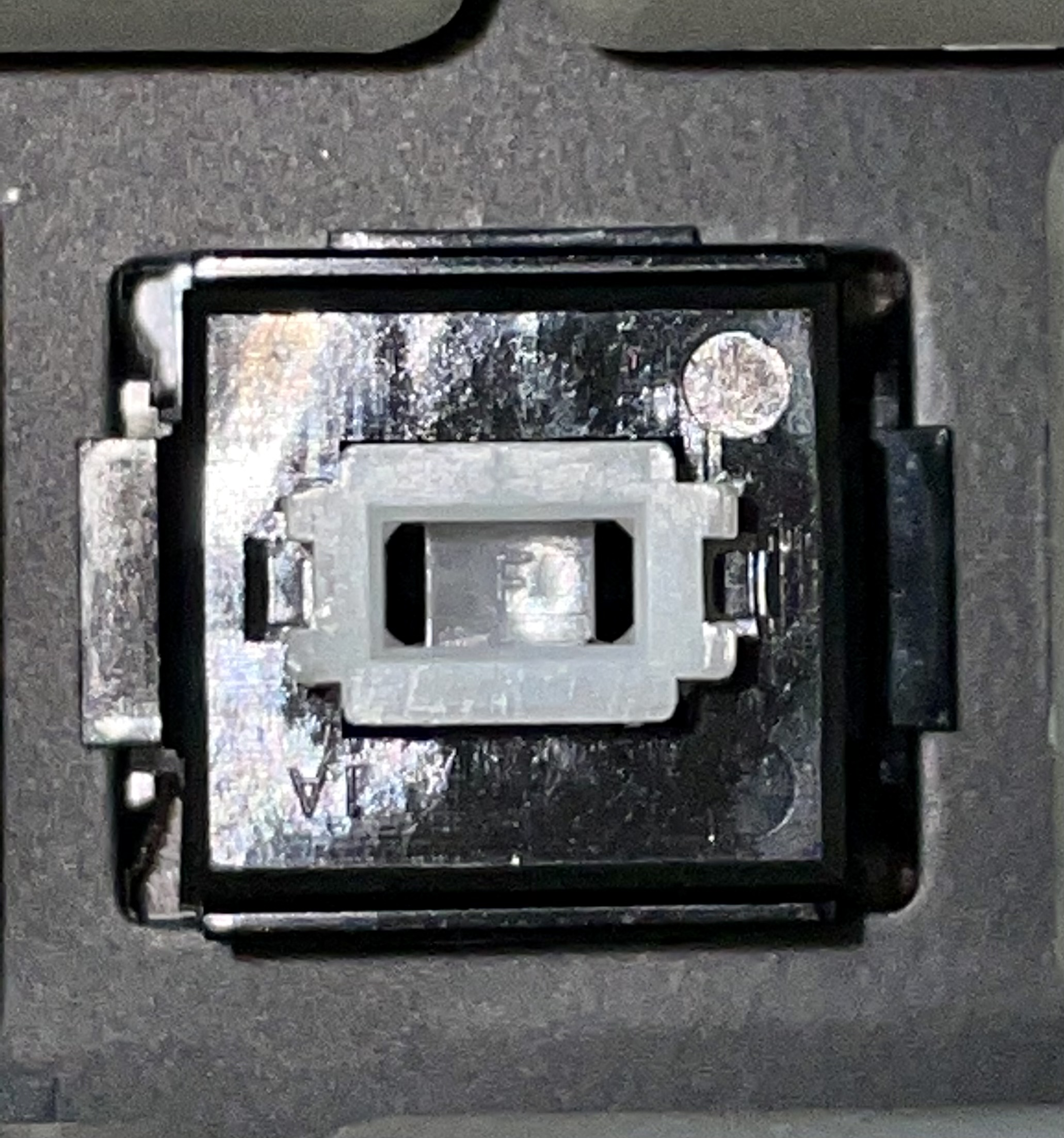

That keyboard is a Datadesk Mac 101-E. Below are some more pictures for reference. This was an eBay find with one picture that looked rough/dirty. Turns out it was perfectly preserved with two covers and the outside cover was dirty. Inside appeared NOS. The inner cover was a membrane plastic molded to the keyboard to cover the whole thing.
The stem on the left control key broke off and I wanted to see if Matias parts could be used as replacements for alps. I learned:
- Alps sliders are bigger than Matias and won’t fit in Matias top housing
- Matias sliders fit in alps top housings but are more wobbly but feel the same
- Matias housings can’t be used with pine alps due to the smaller simplified switch plate

Yes, it's the click/tactile leaves that determine the switch type, not the sliders. The slider color was only different so they could tell the switches apart visually once they were assembled. That's why I was confused by your questions. If you have a better set of sliders in a different color you can use them, but changing just the sliders won't change the sound or feel of the switches.amigastar23 wrote: 17 Sep 2022, 06:55

Thank you, that's great information on the mystery switches. They do indeed sound and feel like early Alps SKCM. I'm really hoping we learn the truth about these. I have four or five Datacomp keyboards with them, and there are other examples posted here in various places.thefarside wrote: 17 Sep 2022, 12:16
Sorry for the confusing post! The Matias slider was on the right side. I presumed the switches were alps because they looked, sounded and felt like genuine pine alps.
Hope this helps! If there’s anything else I can provide just let me know.
We need to compare the dimensions to genuine branded Alps switches to see if the parts interchange. That would help to confirm whether these switches were built using older Alps tooling, rather than being clones. I think someone suggested that Forward might have made these. Datacomp is another possibility, especially considering they have been found in Datacomp keyboards.

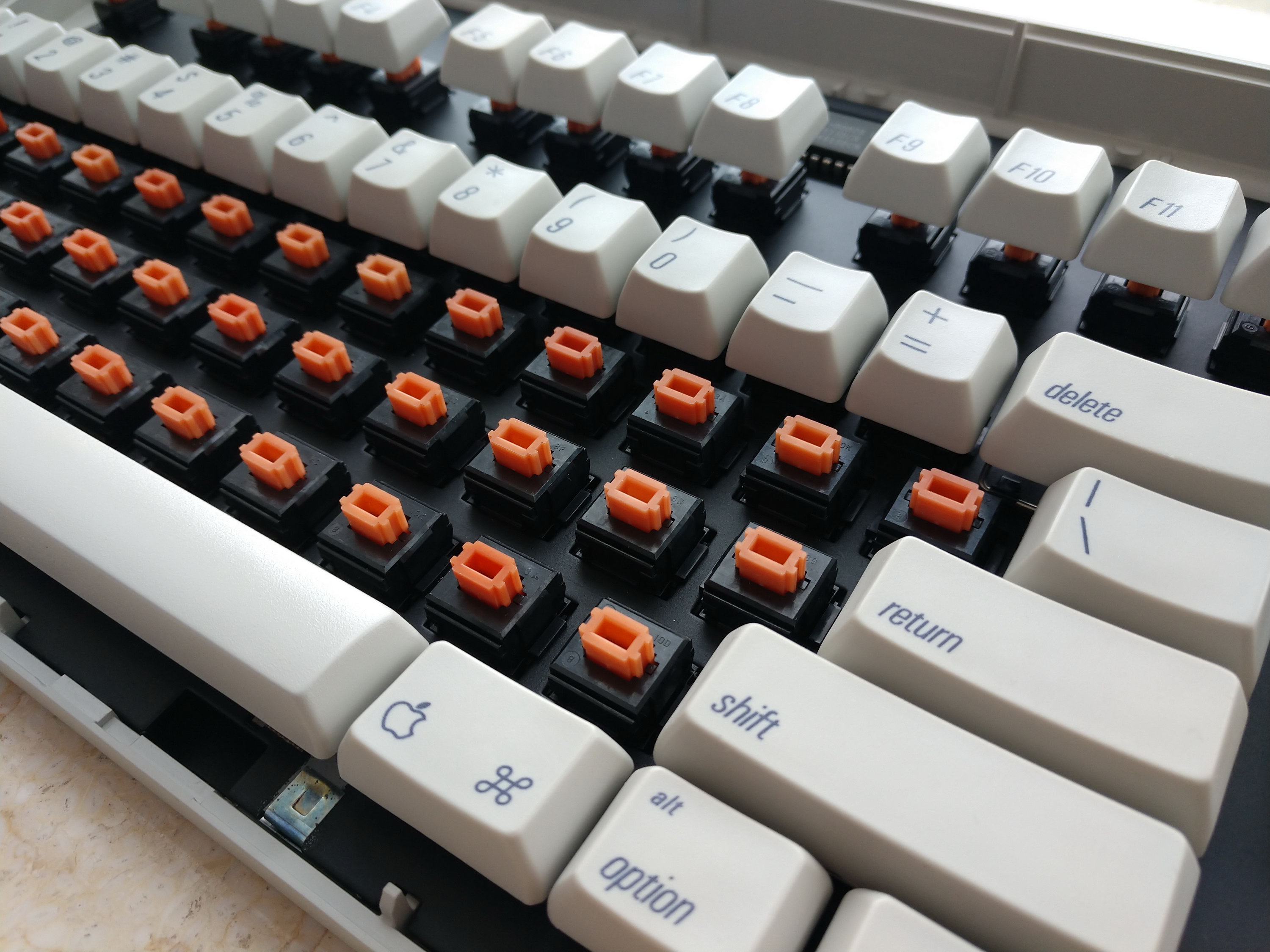

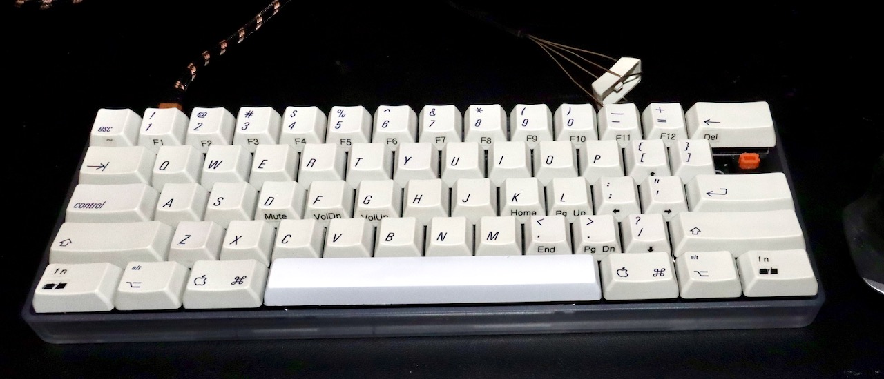

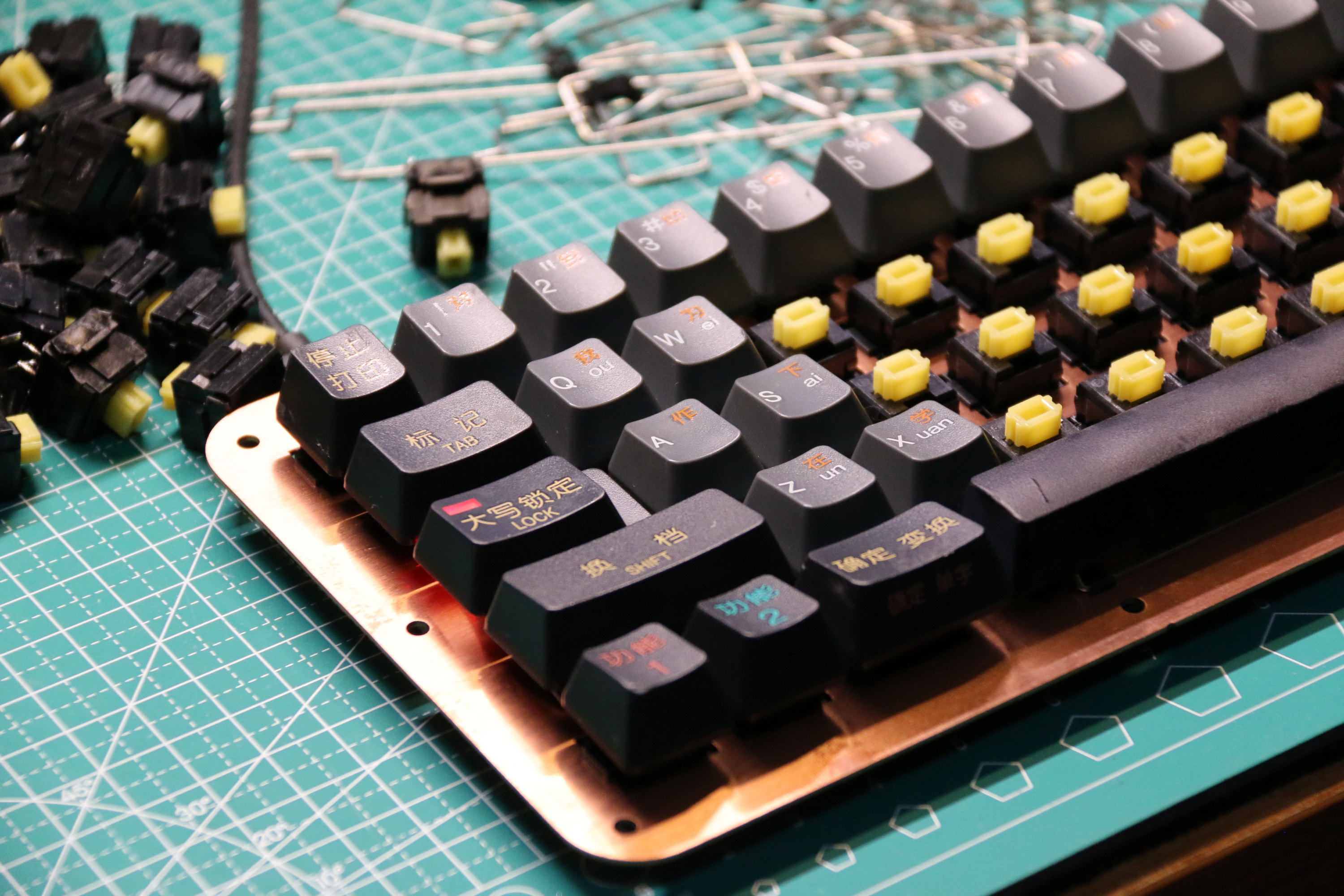

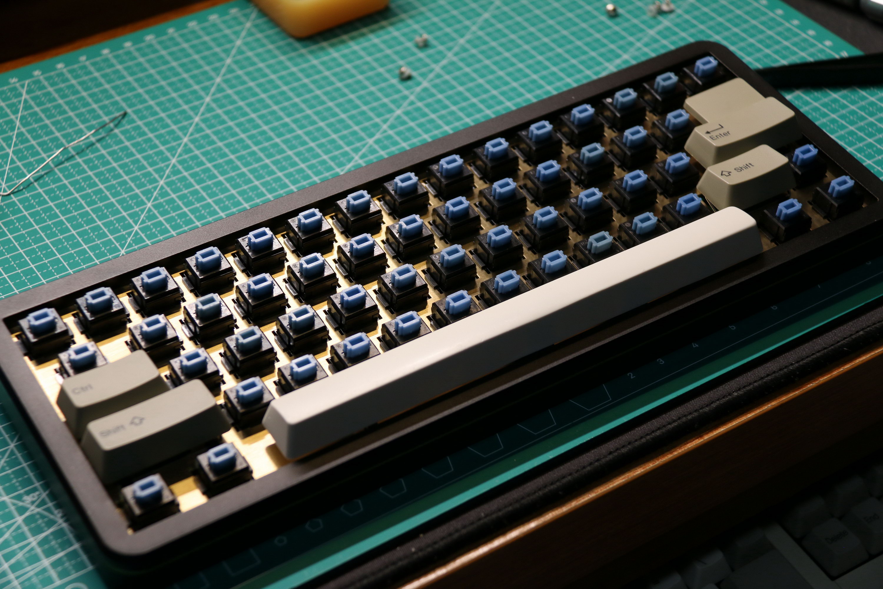

Speaking of the AEK - I just finished a Alps64 based on an AEK with Tactile Orange switches.
I used the original caps in an Acrylic translucent case.
- IMG_4799.jpeg (139.84 KiB) Viewed 10656 times

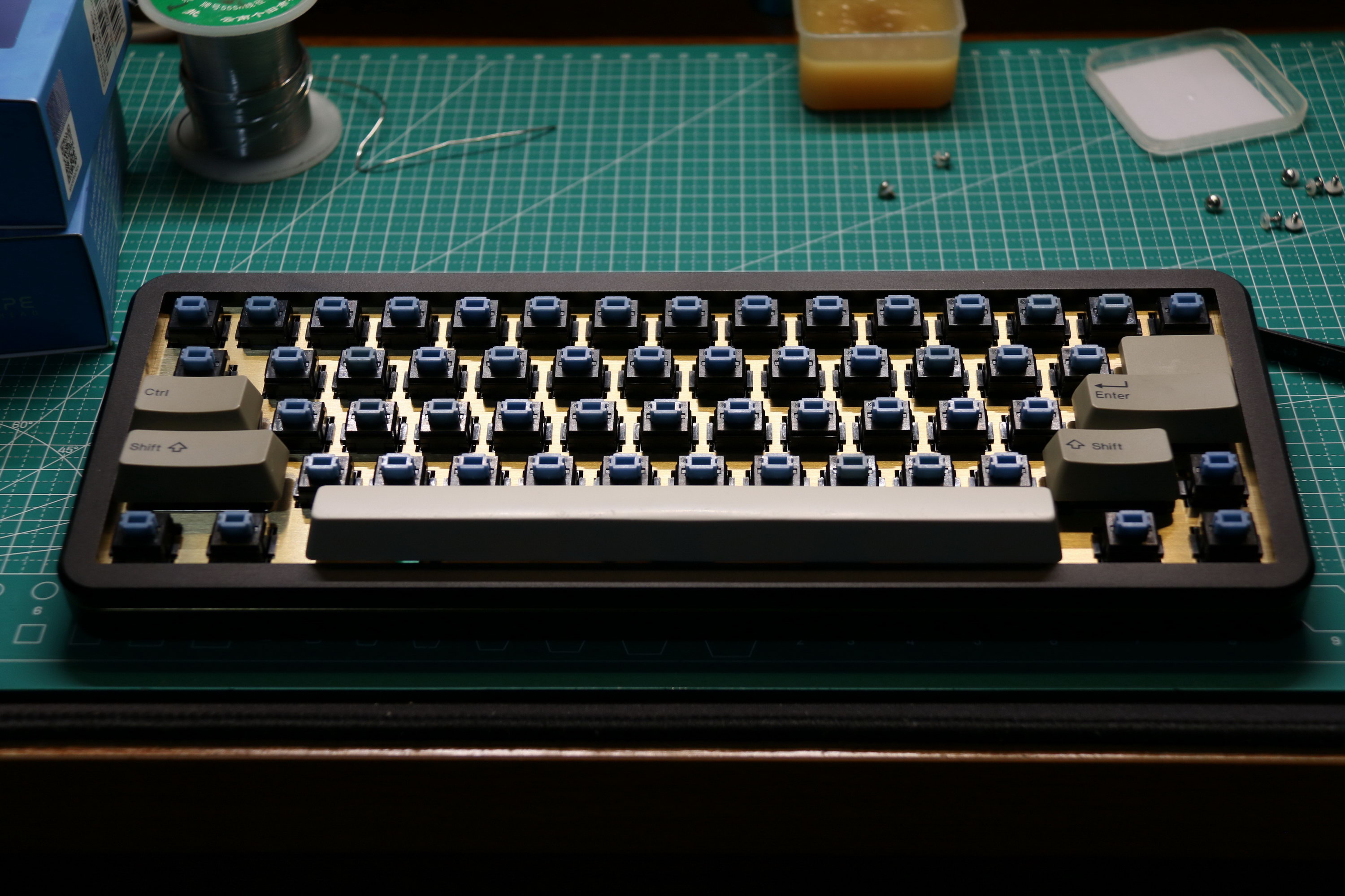

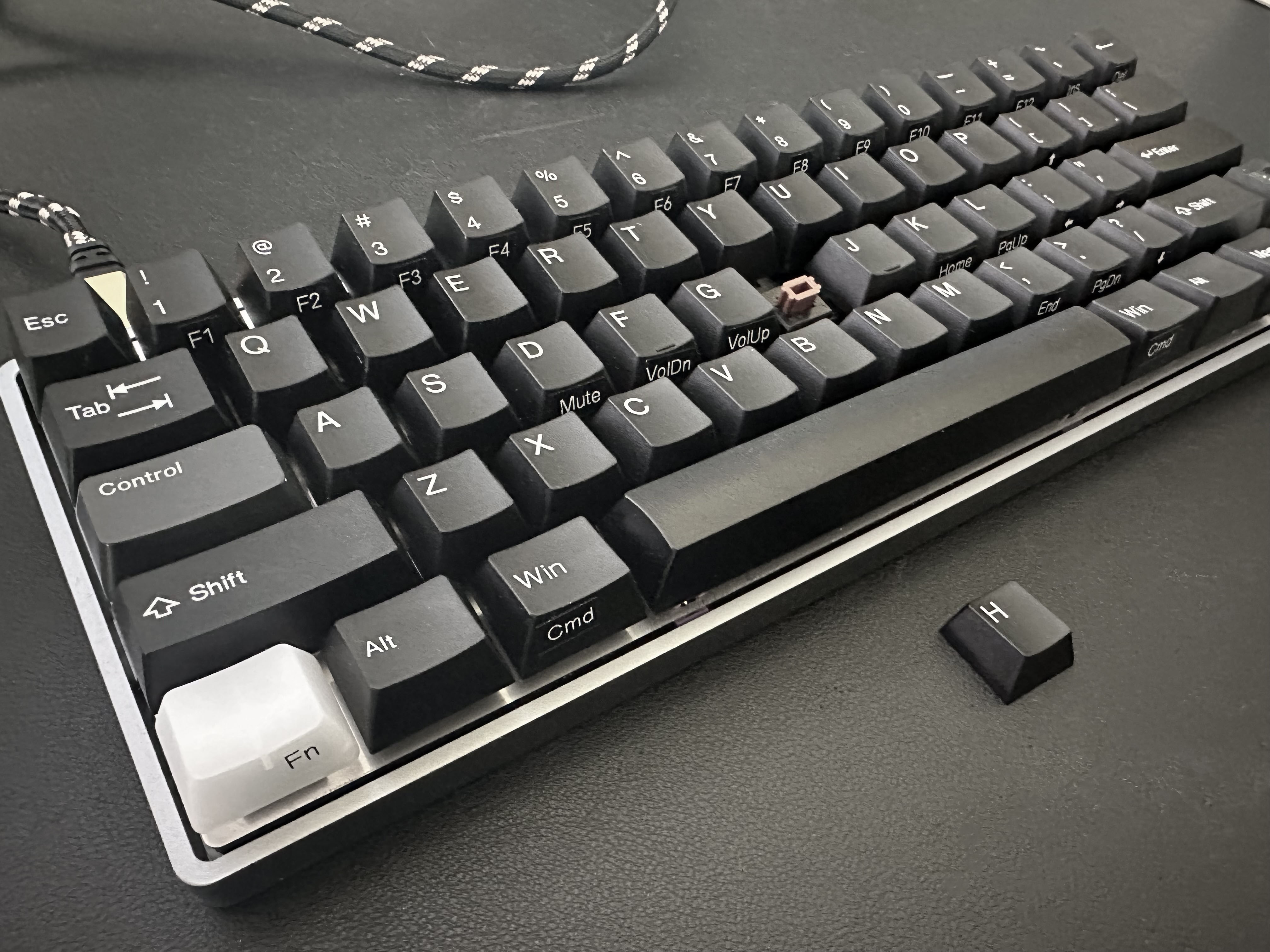

Just wanted to share another Alps based build. This time it is a HHKB inspired 60% with Tai-Hao black keycaps. The switch I've chosen is the Brown Alps using a stainless steel plate. The case is anodized aluminum in a dark gray finish.

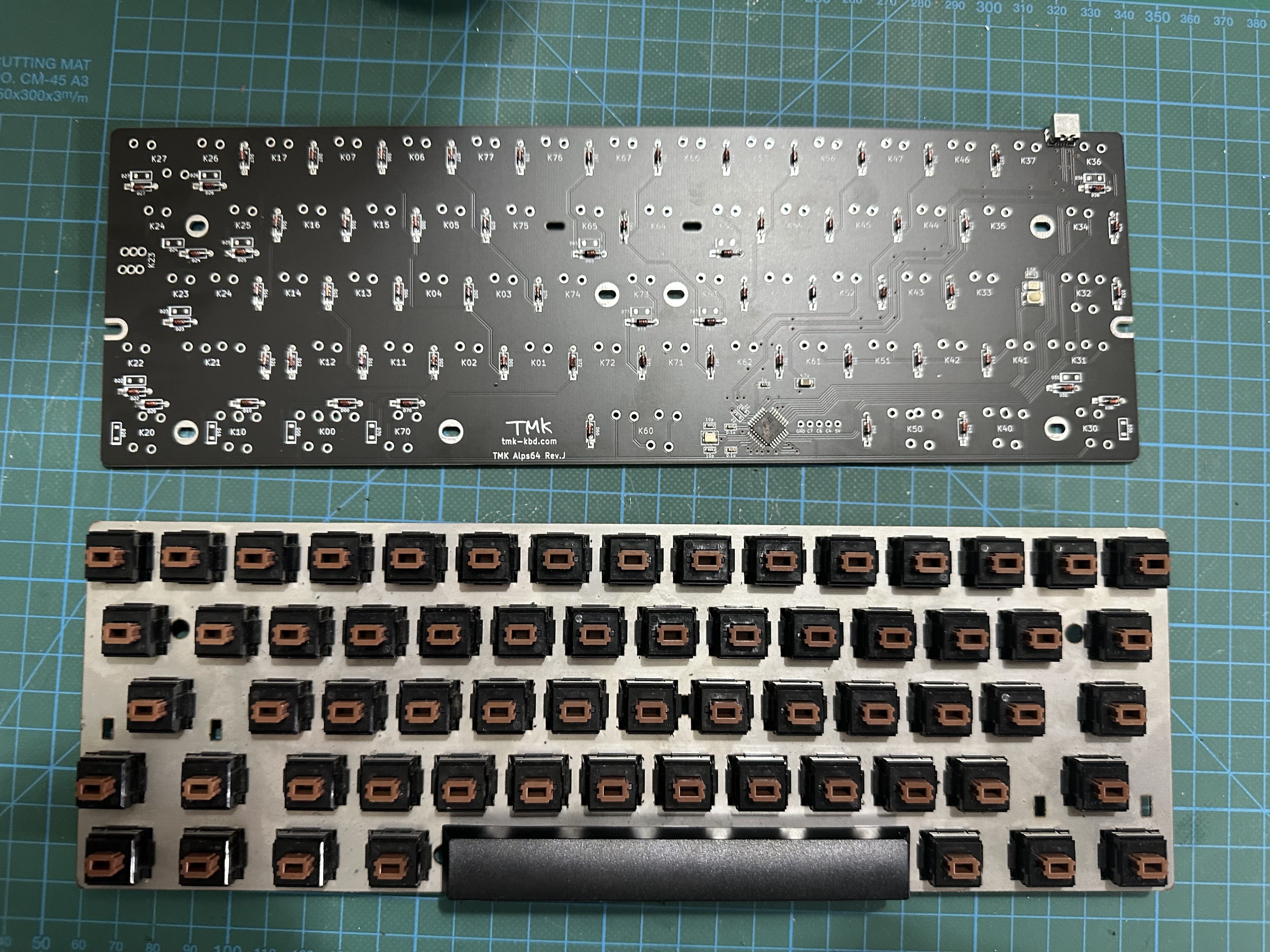

I did a respin of my 130% PCB design to accept ALPS switches, and added an OLED feature. This was a mistake; I implemented before research, only to discover that the OLED can only be wired to specific pins on the controller. I had to cut the tracks to the OLED and two of the lamps and bodge it together.
I also discovered that apparently Teensy++ units are now formally extinct as a new-stock product, so I now have eight "reserved for the next switch I want to commit to" PCBs (four MX, four ALPS) that cry out for them. It's really a problematic niche. Since my matrix design is designed for easy-to-decipher, rather than efficient (23x7 + 2 pins for encoder + 2 for OLED + 3 lamps = 37 GPIOs), most of the cheap STM32 "coloured pills" and the RasPi Pico are insufficient.
Also tried using JLCPCB's "aluminium PCB" feature as a cheaper substitute for plate building. They offer a 1.2mm thickness which I think is right in the recommended range for switches to snap-in. That worked out well, it doesn't seem notably flexier than a metal plate and it looked better out of the box. (Unfortunately, I should have designed the plate in reverse, so I could mount it metal-side-up instead of green-coated-side up)
Grand total: Five PCBs + five plates + shipping = 150 USD, or roughly what you'd pay for the plate alone from a water-jet shop.
I built one out with a new box of Matias clicks and the Tai-Hao Dolch caps I bought a spare set of back when they were exotic and had to be ordered via Massdrop or something. It's a plastickier sound than I remember, although it's probably because the case isn't bolted together tight yet. (I'm reusing the sandwich from the original MX-mount design, but I need to figure out something to do with the OLED)

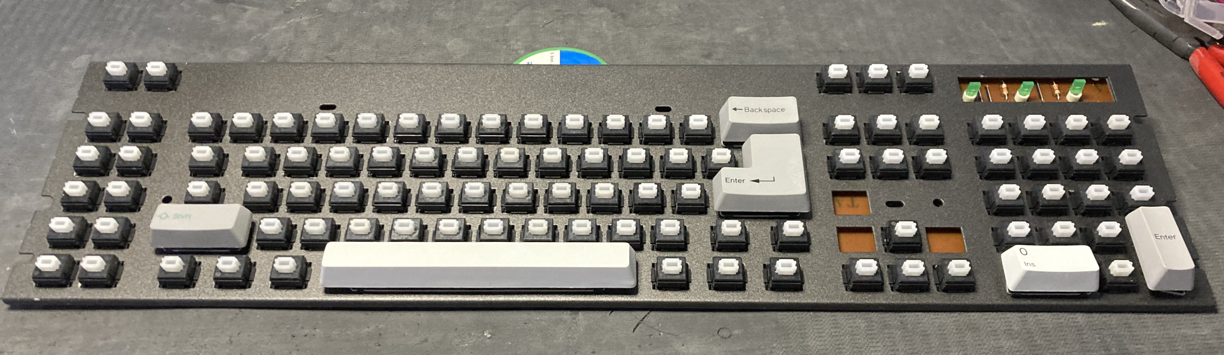

The keyboard is a Northgate OmniKey 102. This one had a blue label with block lettering. August 1989. Serial 01968x. Has a ribbon cable. Picture taken with a potato. Hammered black paint from Behr. Matte clear coat.
I'm still working on the case.

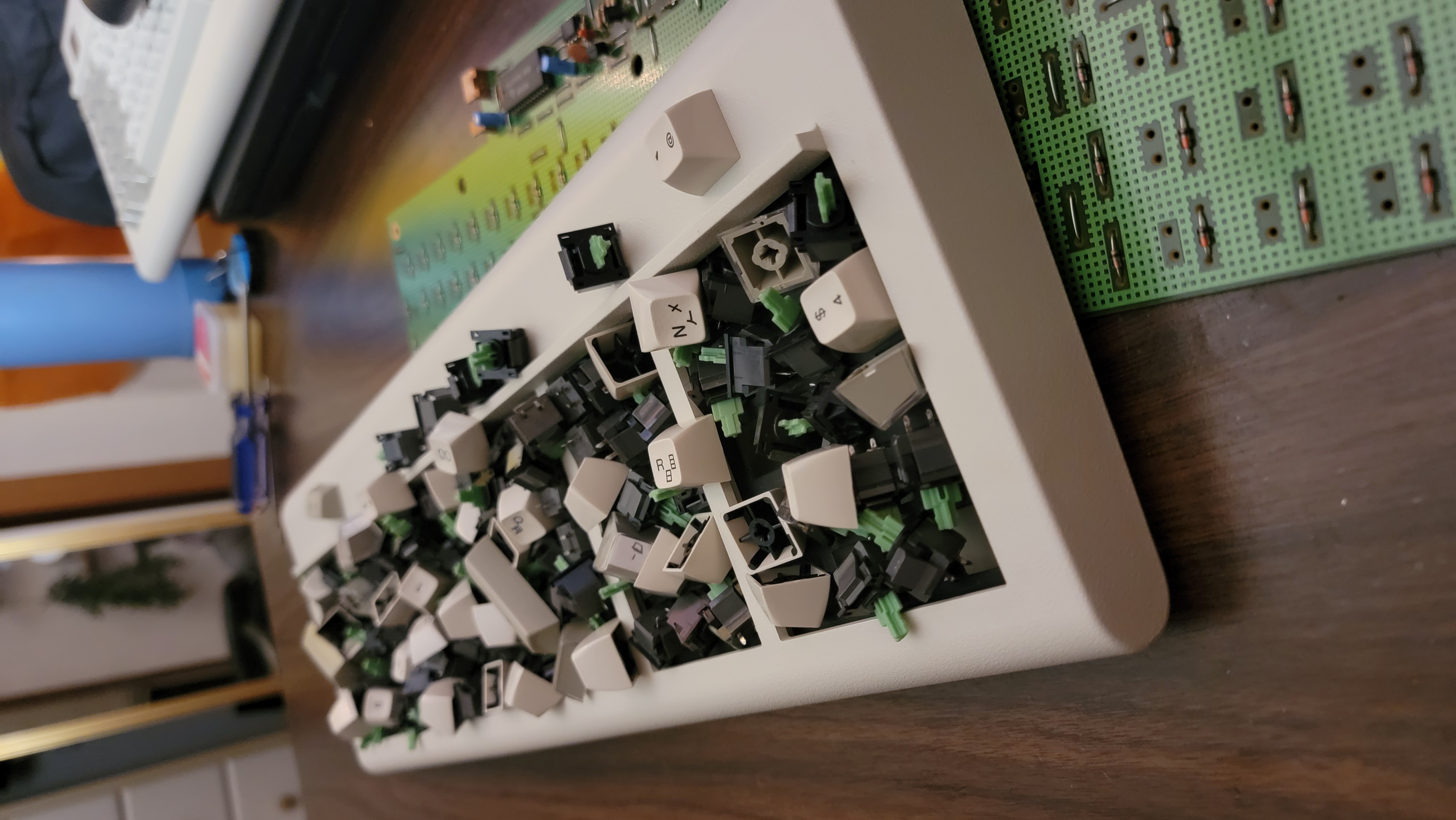

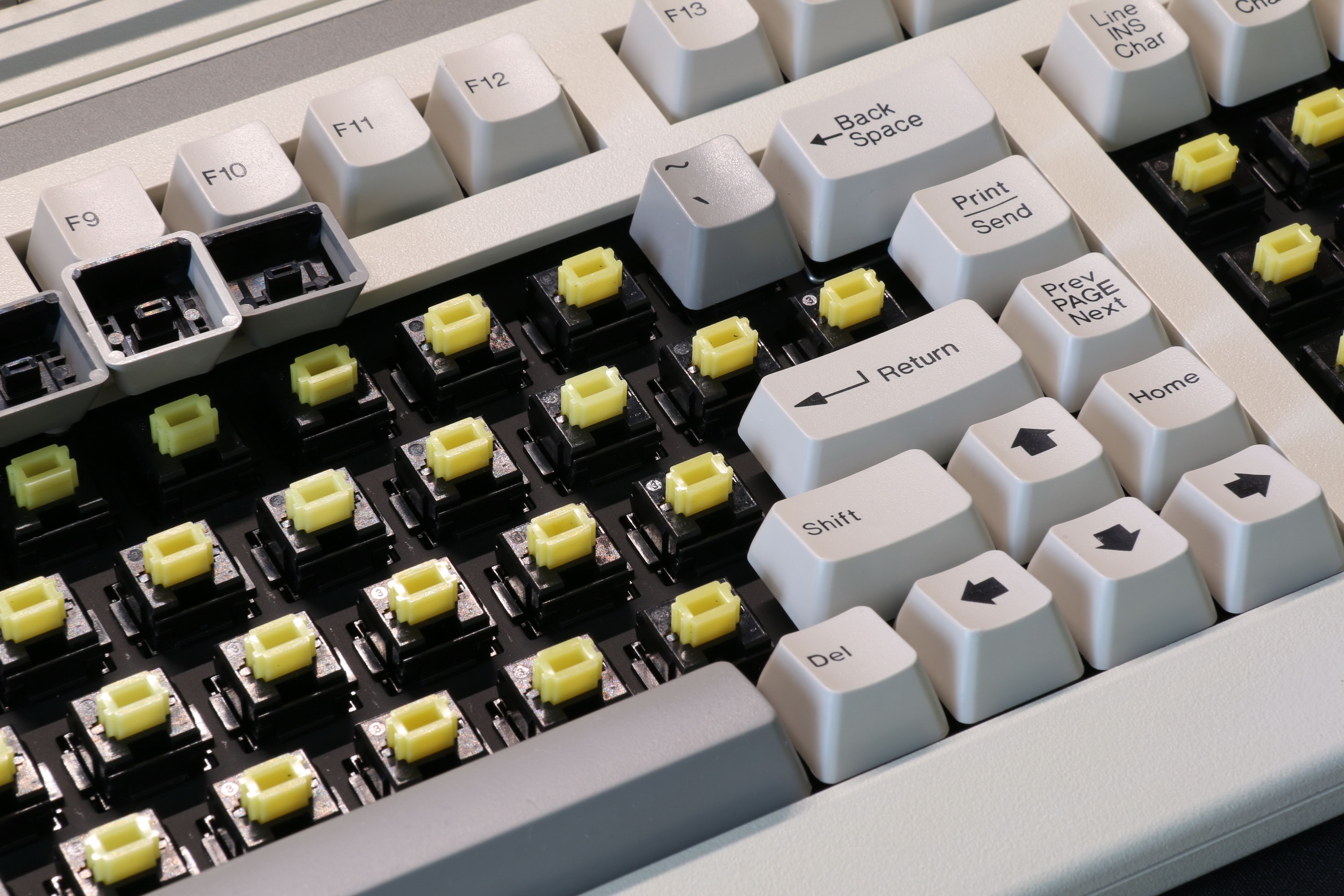

So, I just finished restoring a DC-2214 with blue alps. After top cleaning, the switches feel smooth and they have that characteristic blue Alps click and thock. But... that pinging. I have never heard a complicated Alps board ping this much, only some boards with simplified Alps. Is this something specific to this chassis, or maybe to this version of blue Alps (white switchplates, shiny springs)?
- Polecat
My DC-2214 came with white Alps originally. I transplanted blues for the alphas, from a DFK-777 donor board. Sorry, I don't know which switchplates are in the blues, but it's definitely pingy. It's not objectionable to me, and I don't remember if the whites were pingy or not. But it's easy enough to find out, since the rest of the switches are still original, I'll check it ASAP.engr wrote: 07 Nov 2022, 16:23 So, I just finished restoring a DC-2214 with blue alps. After top cleaning, the switches feel smooth and they have that characteristic blue Alps click and thock. But... that pinging. I have never heard a complicated Alps board ping this much, only some boards with simplified Alps. Is this something specific to this chassis, or maybe to this version of blue Alps (white switchplates, shiny springs)?
- engr
- Location: USA
Thank you, that's what I suspected. Switchplates probably won't matter, but the springs might. The ping is tolerable, I am slowly getting used to it, but it was strange to hear it in a complicated Alps board.Polecat wrote: 08 Nov 2022, 05:21 Sorry, I don't know which switchplates are in the blues, but it's definitely pingy. It's not objectionable to me, and I don't remember if the whites were pingy or not.
