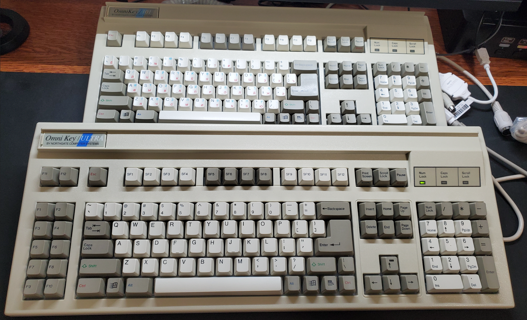

So, I finally got an Omnikey Ultra-TP in near-mint condition from eBay, and I have been trying to figure out how to program it.
I could not find a manual online, to I tried the instructions for programming the Avant Prime/Stellar keyboards (which are supposed to be the rebadged versions of 101P/Ultra-TP), and they did not work. I opened the keyboard, and sure enough, the EEPROM (24C16 chip) has been removed, because then tend do go bad on these keyboards, and the easiest way to get the board functioning again is by just removing them. Which also happens to remove the programmability feature.
I could probably transplant the EEPROM from my Avant Prime (it has no extra keys, so I don't use the programming feature on it), but ideally I would like to find a replacement. I see Atmel 24C16 chips are available on eBay, but my question is: can they be just used as drop-in replacements, or is it more complicated that that, i.e. some sort of programming is required?
These two look so adorable together :')
