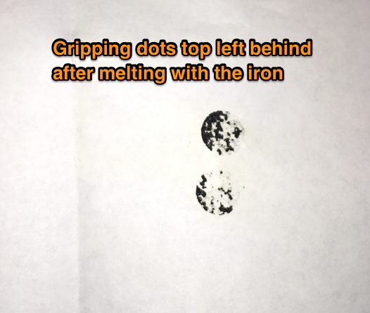

Update: my athletic tape spacebar landing pad experiment didn’t last. The noise reduction was eliminated in just a few days. So now I am trying another attempt with the standard round gripping dots. I cut two dots out from the sheet they are shipped on and took an iron to them. I folded a piece of regular printer paper in half, put the dots in (with the film/paper covering their adhesive side still in place).
It turned out to be a happy mistake. When I went to retrieve the dots from inside the folded printer paper, the heat had made them stick to the paper, so when I tried to remove them the top surface of the gripping dots torn off and stayed behind on the printer paper. While this was not part of my brilliant plan to reduce the height of the gripping dots, it worked very well to do that. The adhesive side was still fine and the sponge side was thinner. I placed the dots on the spacebar landing pad and so far they work great. Significant reduction in spacebar clack and no noticeable reduction in key travel.
