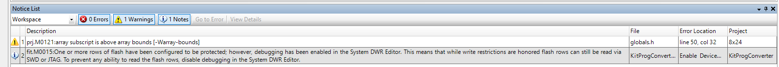

I am trying to get the 8x24 project to work on a beamspring. I built the bootloader and the 8x24 project first without any changes - the build worked all fine. I then changed Config.h on the 8x24 project to reflect 24 Columns and 4 Rows and changed switch type to Beamspring. When building the firmware I get this warning:
I was still able to flash it though on the cypress controller.
FIRST QUESTION:
Does this warning message have any impact on the usage of the controller?
SECOND QUESTION:
In Flightcontroller, when loading a predefined keyboard initializing file (I used 5251.cfg), in Key Monitor, the matrix changes to 16x8. So I am assuming this can't be used (Since I need at least 23 columns to match the beamspring)?
THIRD QUESTION
To get around it, I reset FC by disconnecting and re-plugging the keyboard, I went in to Hardware settings and tried changing values. Uploaded Config until I got it to Scan. Are the predefined initializing files just to get the hardware settings or is there something else that I need to do?
FOURTH QUESTION
After setting thresholds (I set them on Min values for the beamspring) , and adjusting values (reducing each value by 25% for beamspring). I am able to receive output for most keys (not all). But I see several key presses are generating multiple outputs. In Layout, I can see that several keypresses end up highlighting 4/5 cells on the matrix. I tried adjusting threshold values, that helped a bit but when I applied changes, and went back to Layout, I have the same problem again. I have both the PCB and Cypress board also ground to Chassis.
Any suggestions on how to fix it? I maxed the debouncing steps as well, didn't help with the problem.

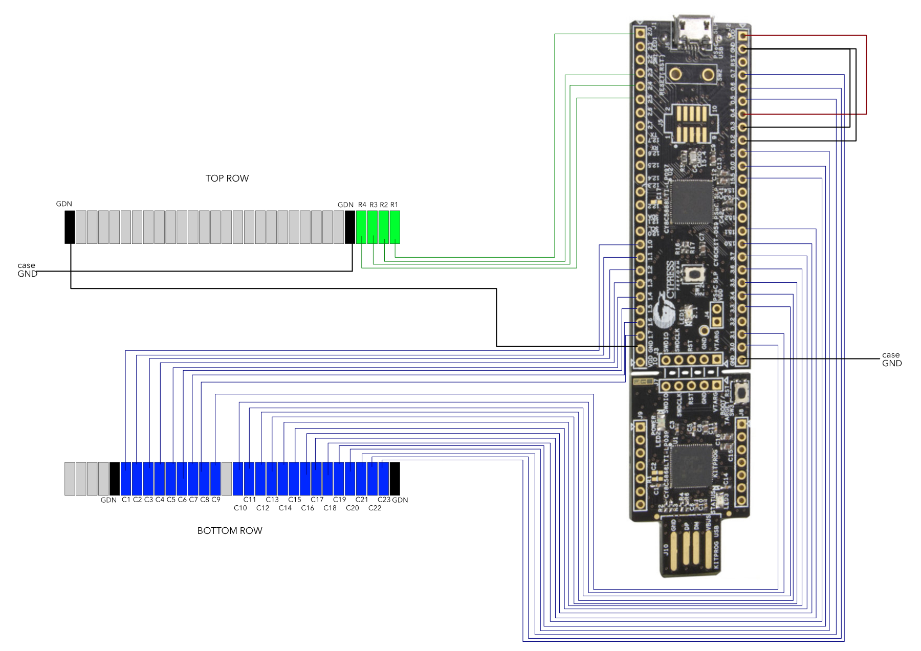

I am pretty much at the same stage as kmnov2017. I have a 5251 with a 23x4 physical layout and wired everything up according the below diagram.
PinOut 5251.jpg (793.38 KiB) Viewed 14480 times
When I compile the firmware (8x24) with settings:
COLS: 24
ROWS: 4
I get the same warning and have a hard time to get key presses registered at all
Likely my wiring is incorrect or I am just too stupid to understand the readme. Any help would be appreciated.

@darkcruix when in doubt you want "star ground" - i.e. everything having it's own ground wire converging on one point. This should not matter for this project though.
Please double-check you connected ground on BOTH sides of the PCB - on newer beamsprings there are no vias so PCB grounds are separate on each side, and having a floating trace which weaves around all the keys can cause all sorts of trouble, especially in beamspring (because it's flippers are down at rest, allowing the signal thru - unlike model F).
I can't really check the actual mapping you have from the picture you posted - it looks nice, but as you probably noticed when soldering, 30 parallel long wires of the same color are not easy to trace. It looks close to what it should be, but..
Also please define your matrix for the firmware with EXACTLY THE SAME DIMENSIONS as your physical matrix. For model F it doesn't really matter, but for beamspring all unconnected columns will appear pressed all the time, tripping the safety checks on startup.

09 Aug 2019, 00:38
The 8x24 project still has the old pin assignment in PSOC. We realised this when all three of us (PancakeMSTR, Darcruix and I) all had three dead columns. A closer inspection revealed that the PSOC PIN settings hadn’t been updated to reflect the new pin out proposed by DMA on github. Changing the pin assignments has fixed the problem.

kmnov2017 wrote: 09 Aug 2019, 00:38 The 8x24 project still has the old pin assignment in PSOC. We realised this when all three of us (PancakeMSTR, Darcruix and I) all had three dead columns. A closer inspection revealed that the PSOC PIN settings hadn’t been updated to reflect the new pin out propped by DMA on github. Changing the pin assignments has fixed the problem.
damn. did I forget to save the project or something? I'll fix that. Eventually.

darkcruix
09 Aug 2019, 16:52
At first, I am writing this with my 5251 and CommonSense as controller. Below is just a little write-up of my experience.
I did read the full documentation and followed the steps. While I am far from being an expert, I have to admit, I had some troubles getting it to work in the beginning due to a few reasons:
  • The grounding is paramount
  • The connector on a BeamSpring needs a tight fit or you need to solder the wires
  • There were a few Columns it didn't detect and it took us a while to figure out the reason (see earlier posts)
  • Enter the right rows and columns in the project
Once all the above is sorted, the rest of the process is reasonably simple and works after following especially the Threshold process.
Apart from DMA I'd like to thank kmnov2017 for comparing results and tips & tricks.
Not everyone will get this working out of the box and some initial "getting used to" is definitely something to mention. The versatility of CommonSense is awesome and also the FlightController is easy to use, imho.
