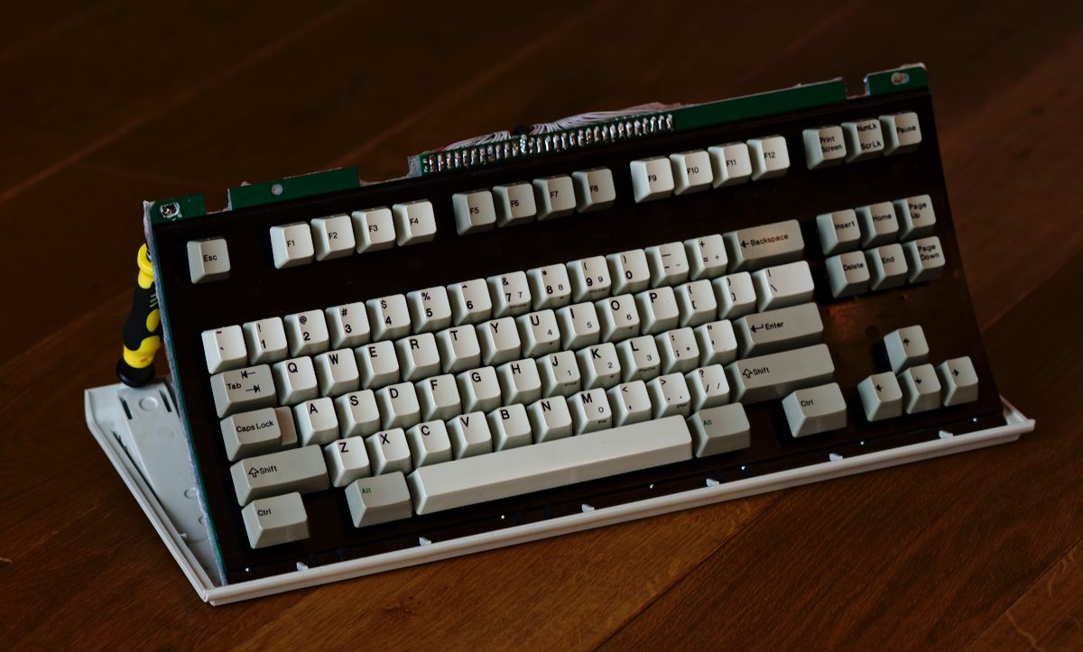

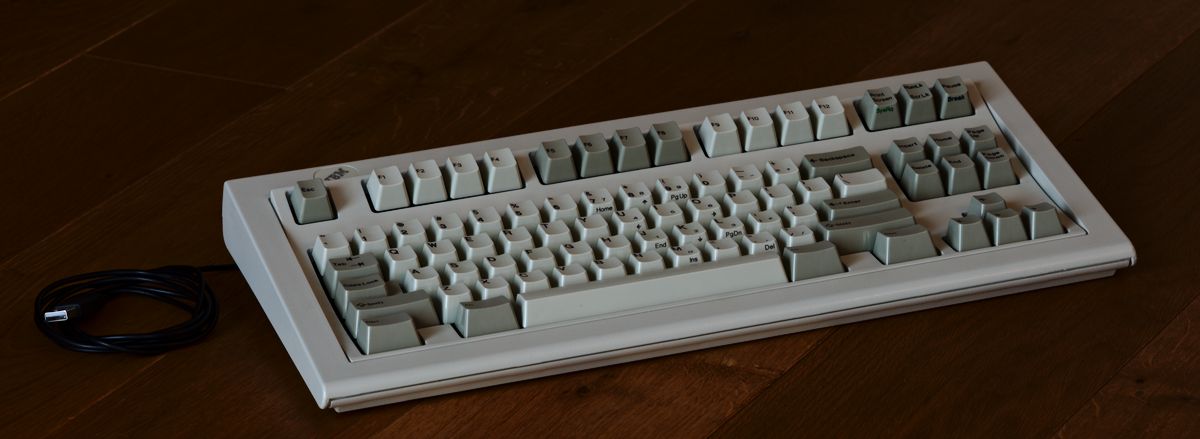

Here come the pictures:
First things first - The ID:

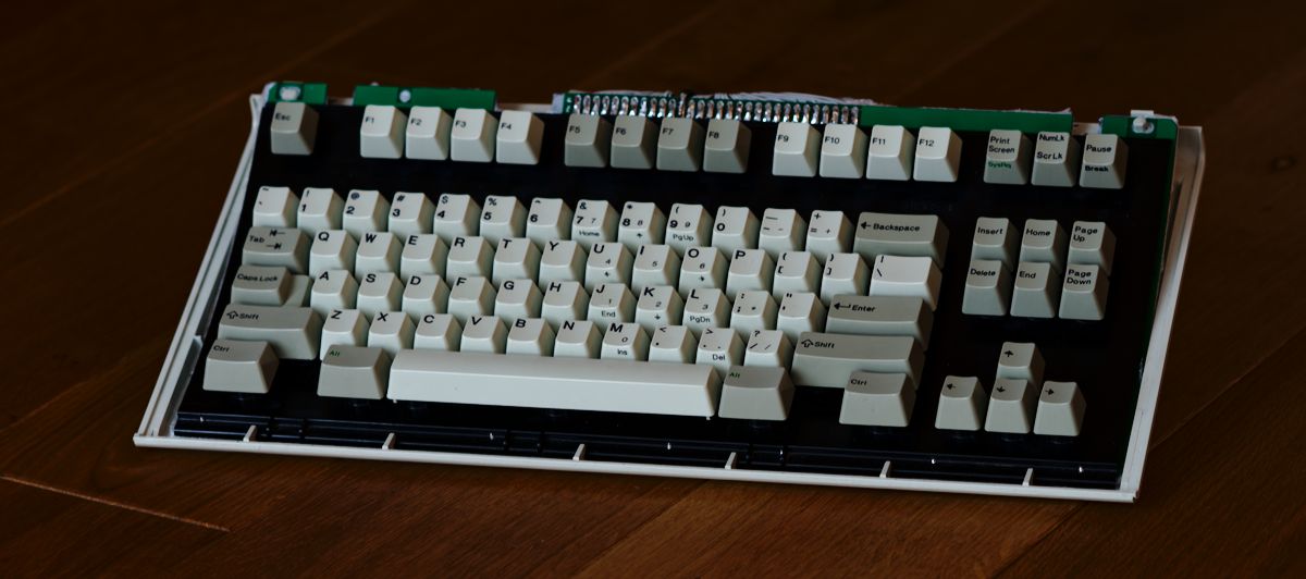

The keyboard, in its new live as the 0001fssk:
Opened:

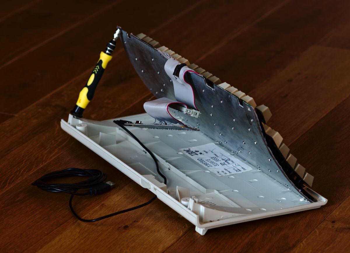

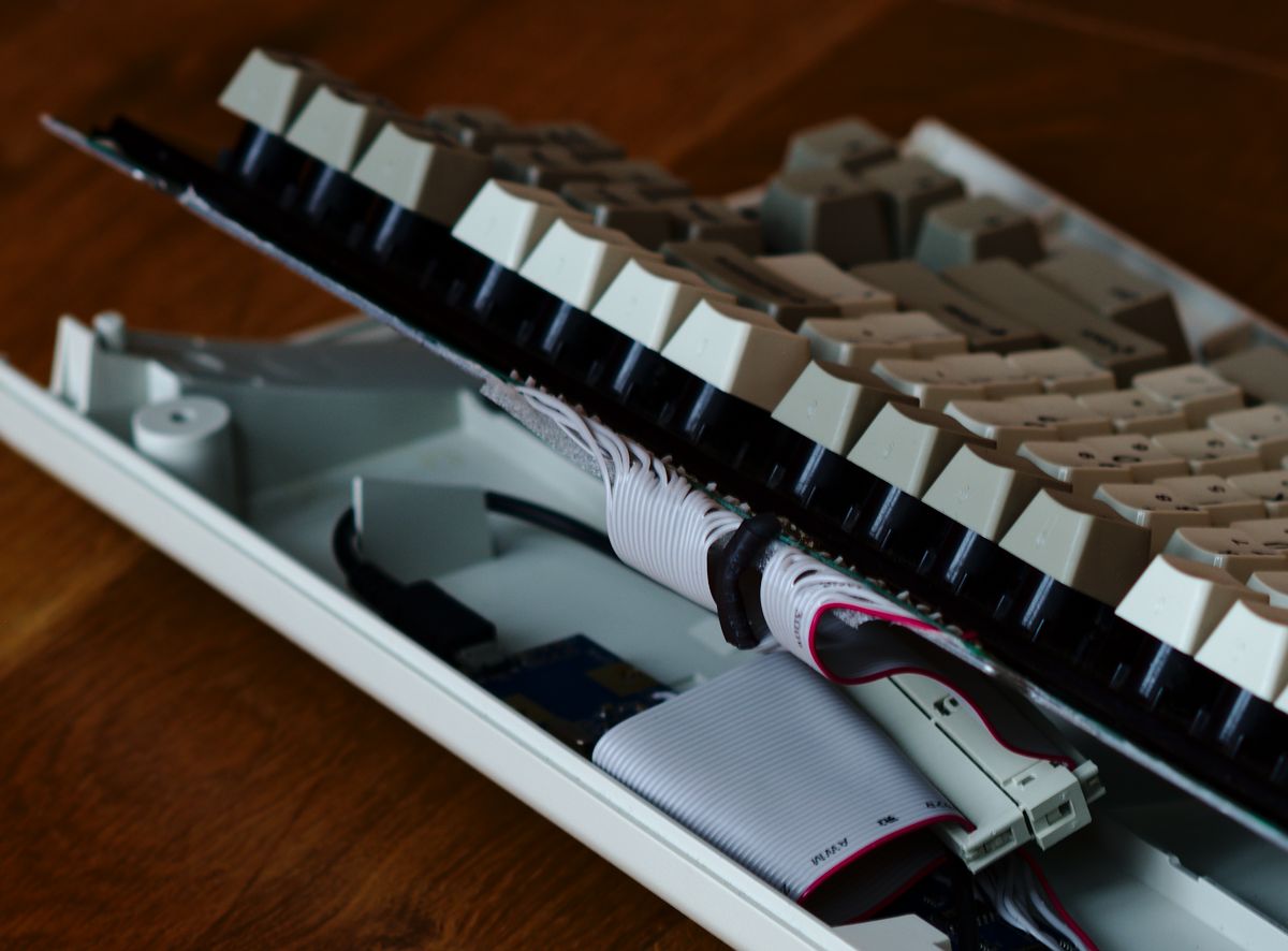

And here you can see what I meant with the connector to the controller:
I have used a 40 wires flat cable, I guess it is the same connector that the IDE devices used (parallel ATA)

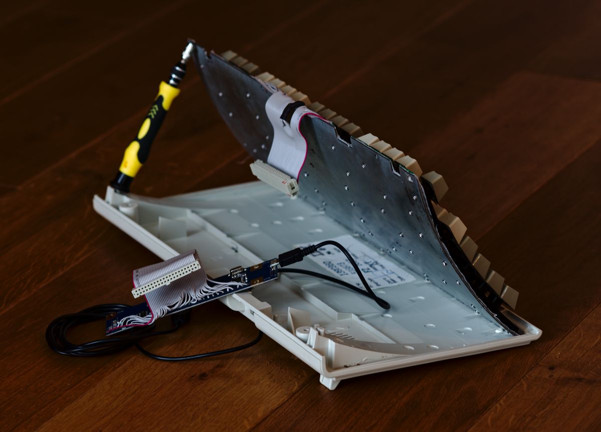

Some more details on the connection between the PCB and the controller in this post
Here you can see the controller disconnected. It is very easy to do. I was afraid that this setup would affect the performance of the sensing or it would not fit in the assembly. None of the two risks realised. It is just perfect. It allows to manipulate the PCB without being attached to the controller, test it and check it. It was a great idea that I guess that future fssk owner would like to use also.
Note also that out of the 40 cables in the controller, only 30 are used. In order to ensure proper separation between the rows and the columns I have grounded the 10 cables in the middle. The original F controller, and therefore the xwhatsit and our fssk controller, has two GND ground cables only. I linked all these 10 spares into a single "cable" that I have grounded.

In the following you can see the controller disconnected from the PCB:
idollar
i$
24 Jan 2016, 11:37
There are only female connector to these cables (that I know). I have used the mounting male to connect on one side. The bits that are suppose to go into the PCB fit the other female connector. In other words, I have used the male-PCB plug to link the two female connectors. This is the point where the pairs are crossed. As I have said before, this is not a problem at all. It just need a different xwhatsit configuration. The one that I am using to type this post :-)
In the picture above you can see this make-PCB connector, standing vertical on the female one, connected to the fssk with the parallel ATA cable.
I post the same picture that I have posted in the post before to show how the make connector looks when plugged into the female connector linked to the parallel ATA. I hope that this clarifies the setup.

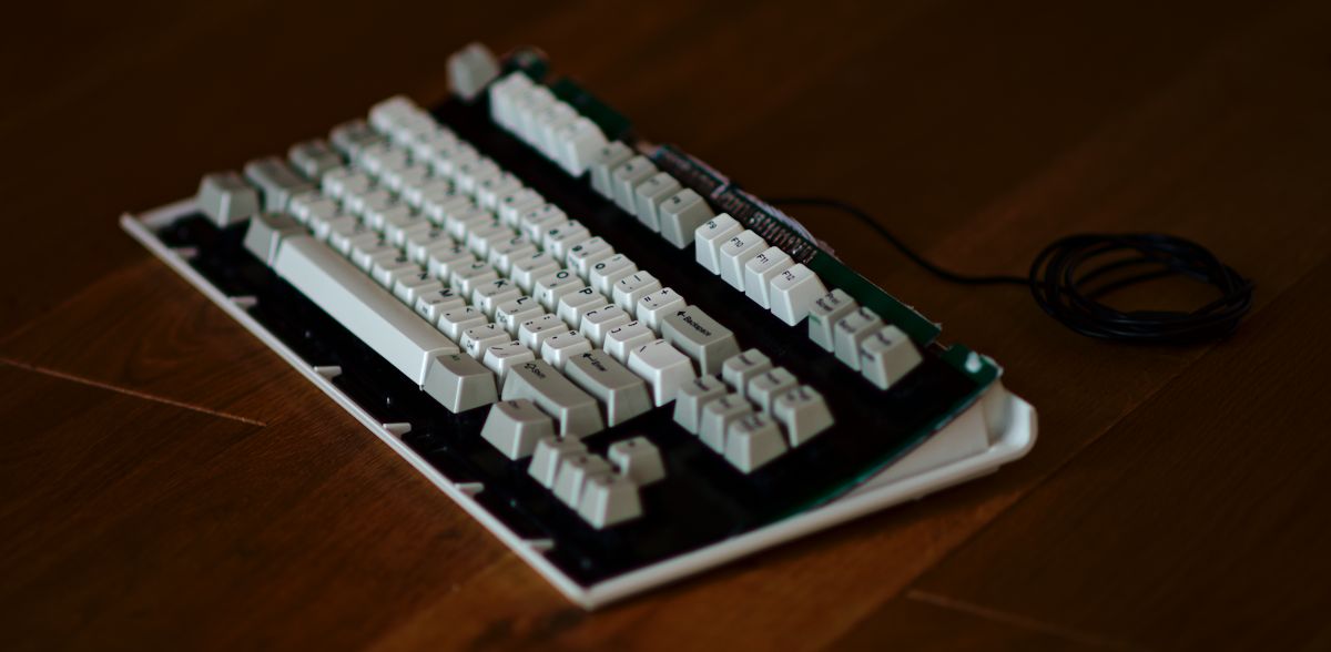

This is a different view of the front assembly:

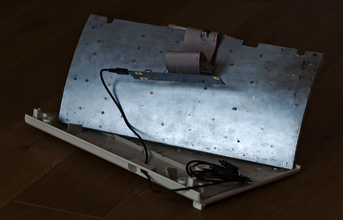

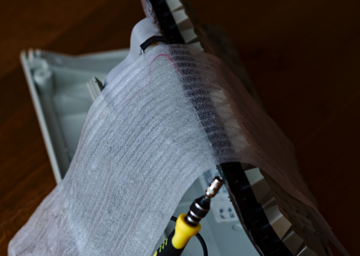

The following shows the very thin layer of foam that I have added between the metal plate and the PCB.
I also isolated the metal plate with wide tape, to ensure that the bottom pads of the PCB would not short-circuit.

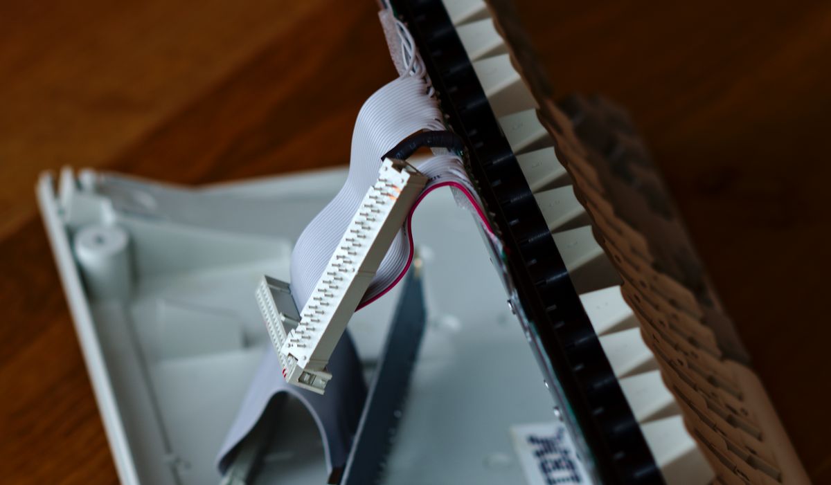

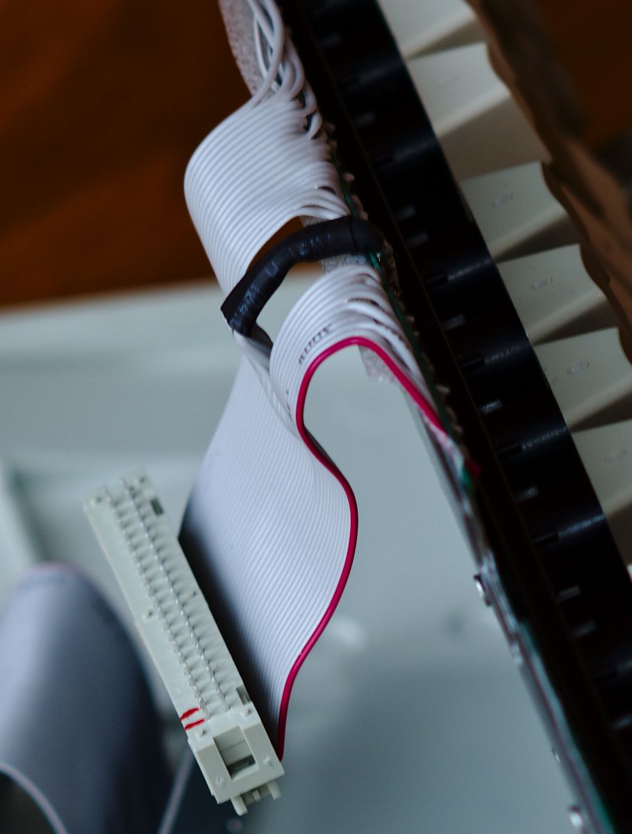

In this post, a closeup of the cable and the controller just before the assembly closes.
As you can see, the length of the cable and the position of the connector is key: I first soldered the cable, measured the position for the connector with the assembly on the case and only then placed the connector (pressed). I am just thinking that some people may be interested on the length of each section. I will post the information.

In this post, you can find another view of the connector, the cable and the controller.

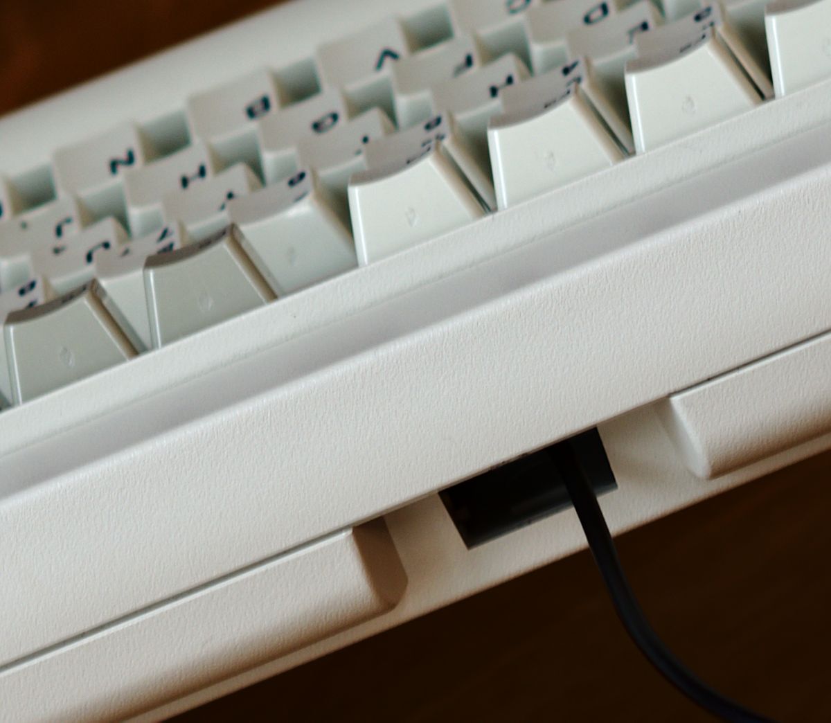

And finally, the hole for which we need the plastic piece.

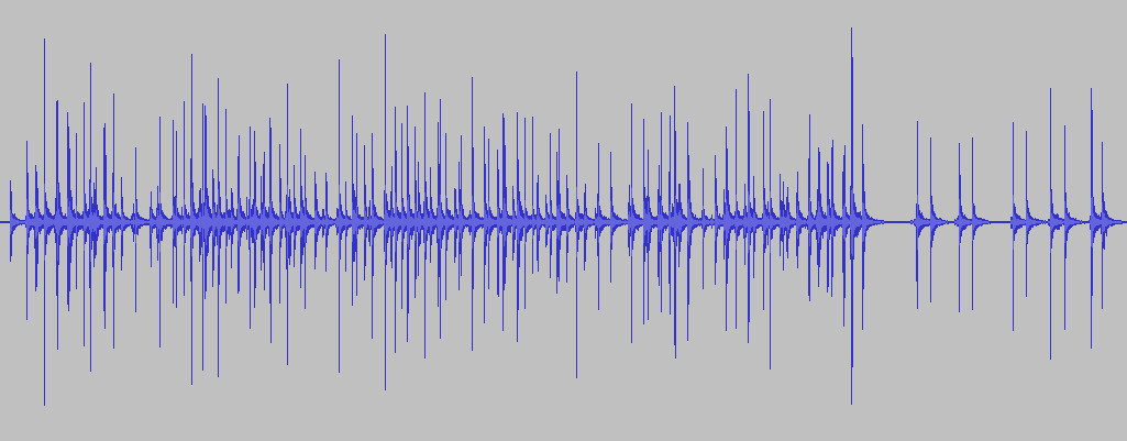

The end of the picture shows spacebar clicks. You can clearly see the clicks and the clacks :-)
How do I post the audio file ?... MP3 attachments are not allowed :-(

24 Jan 2016, 13:02
The sound of the 0001FSSK:
I cannot post a comparison with a regular SSK. The other one is at work

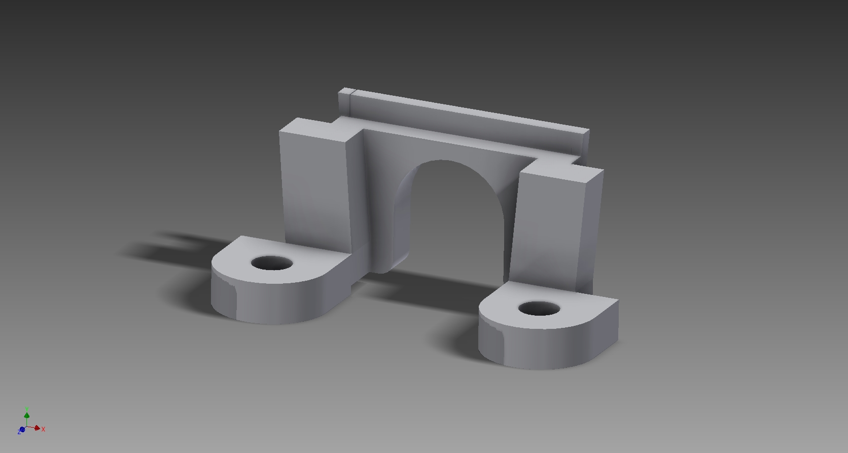

My idea was to "cut" the piece in the middle to allow the cable to go through. We could glue these two parts together, but there may be better options to deal with the issue of the size of the USB connector.
Okay, well, I made this. It's based on the cable insert in Model Ms with an attached cable. The back should not be perpendicular to the base pieces, but should be set back a few degrees. I have not tested this. It may not work. Still a work in progress. (Can't figure out how to share the .STL file for a 3D printer... feeling lazy.)

XMIT wrote:
idollar wrote:
XMIT wrote: No promises but I'll see what I can do.
Thank you XMIT
Nice :-)
I have a couple of comments if you allow me: the cable is smaller than what you have designed. It will be a regular USB cable ( from 3 to 5 mm in diameter ?).
In order to let the cable go through in the middle, I thought to make an insert consisting of two mirror parts that one could glue together.
There is a picture in one of my previous post showing the cable leaving the case.
EDIT: This one:

[ XMIT ]
25 Jan 2016, 01:16
Right well, what I drew was the actual Model M cable stop insert. Often times this is one piece, and the cable itself has another piece that snaps onto it (or wraps around it) that fits into the cable stop insert.
There is no standard for USB cable thickness. They are all over the place.
I'll think about this some more but maybe I can offer some other solution that works with multiple size cables, incorporates some strain relief, etc.
Thanks for the photo. I do have an SSK here - and many Model Ms - to play with for fitment. This part of the cases, the cable exit areas (using the two holes that the controller uses for securing the SDL connector) I think are identical.
